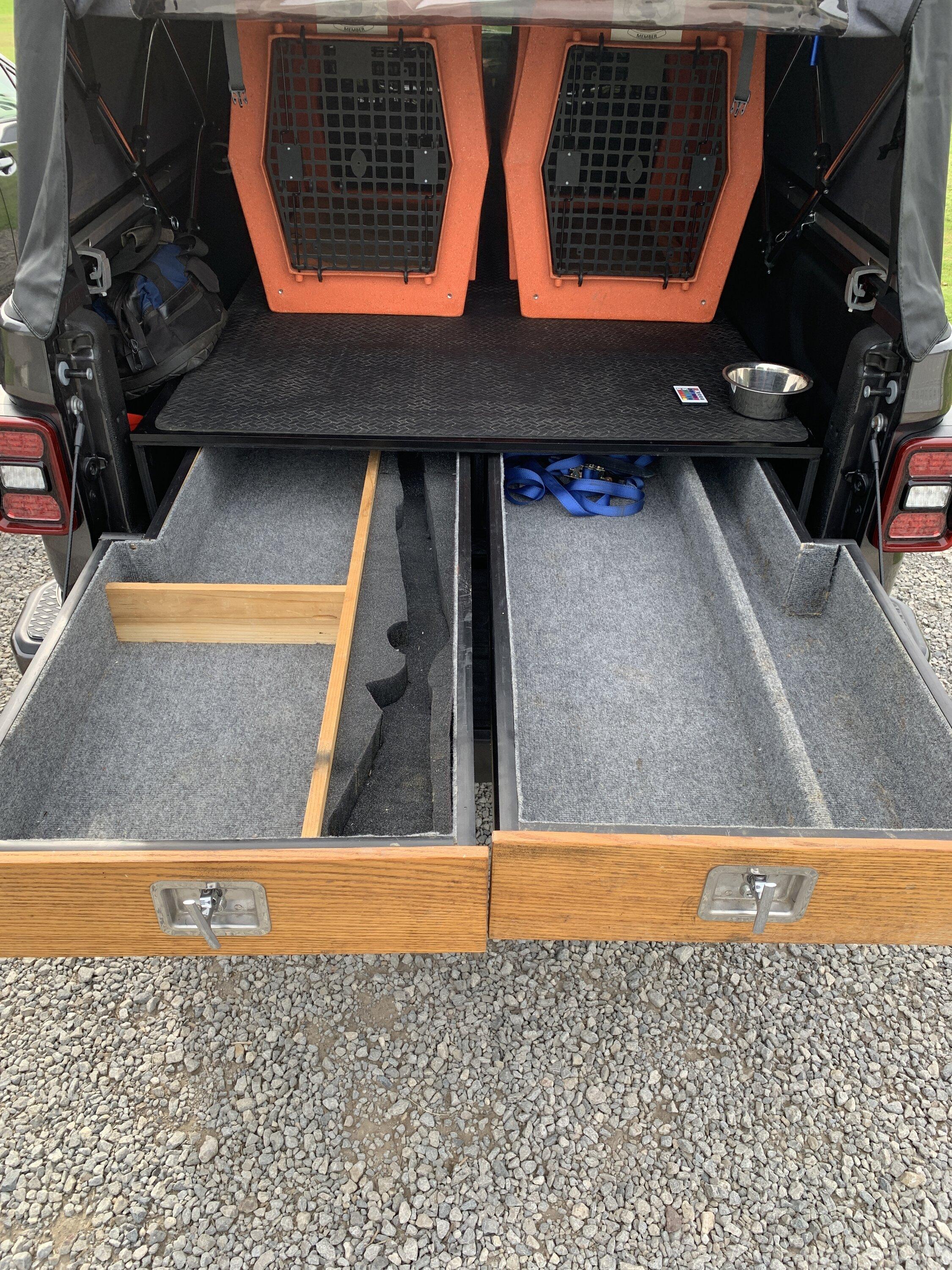

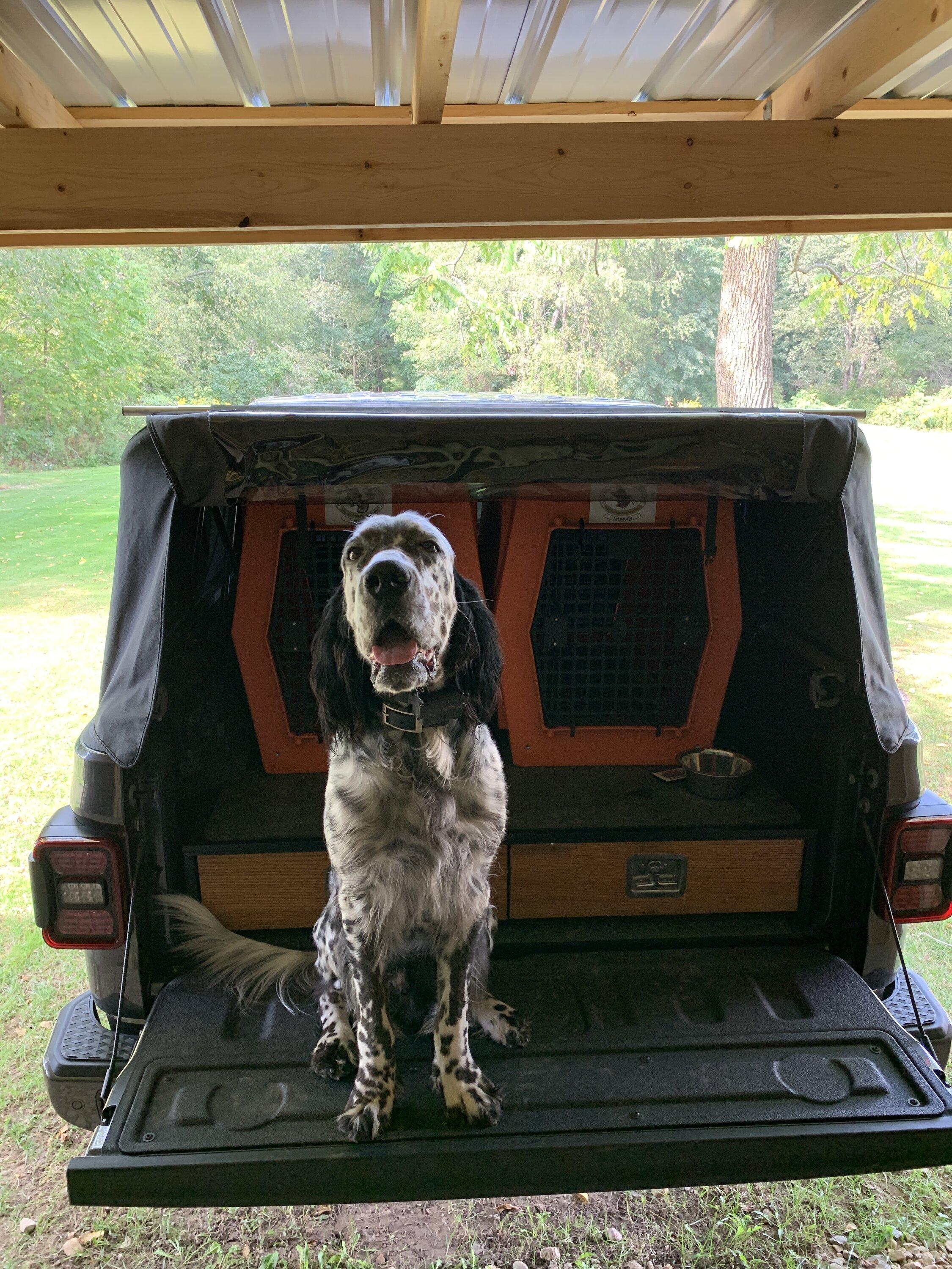

Those are awesome drawers - any more info on the build?
Thanks - 3/4" plywood construction 48" wide and 58" long x 8" high. the height is what was important to me, tall enough for most items and does not take up the entire bed depth with the tonneau on. the sides are notched for the wheel wells and the drawers lined with carpet (not necessary but nice). On the left side I carry all my recovery items, tire repair, rags etc towards the cab - towards the tailgate goes my commonly used hunting items and dog collars and such. On the right is cleaning rods, space for shells, jackets, and anything else that you might need.
The drawer bottoms have those plastic corner protectors you would use on drywall and small dolly wheels mounted on the ends so you pick up slightly when opening or closing and they roll right in and out. This works super slick and really makes the drawers very useful and fully loaded are no problem to operate.
Also I used that foam rubber pad from Tractor Supply top and bottom of the box to keep things from shifting around.

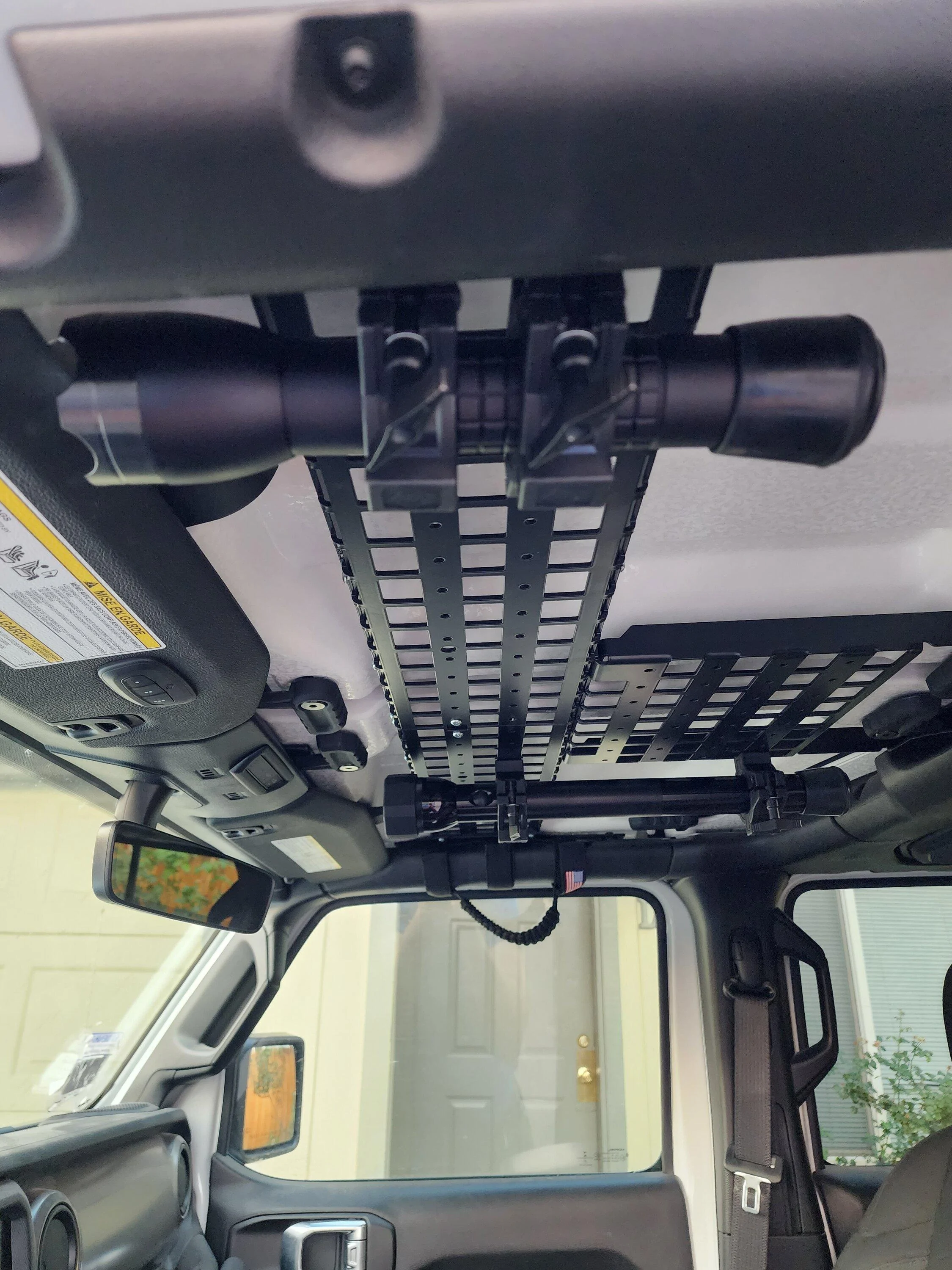

? Perhaps.
But years ago when I worked as a bouncer I learned to appreciate the Maglite. Old school. Simple. Feels good in your hand. Never breaks. Hard to lose or misplace (at least the 5 D cell and 6 D cell version). Adds a sense of confidence when you check on a noise outside. And when you are bored spinning it in the air and catching it after a 360° rotation makes the time pass.
All my Maglites are LED or have had the LED upgrade. They all have the crenellated strike bezel. And they all have the glass breaker end cap. They are multi functional.
I have a new fangled million squared lumen rechargeable flashlight the has a Cree something or other LED bulb but I always grab the Maglites to do stuff.
And quite honestly everyone who sees them knows deep down inside..... that I'm an old geezer set in my old geezer ways. ?????

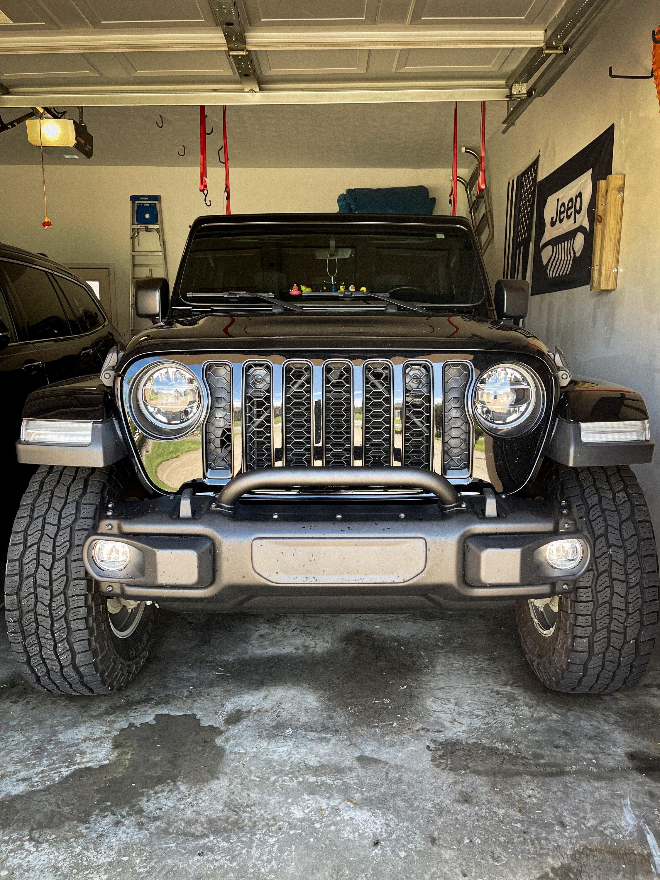

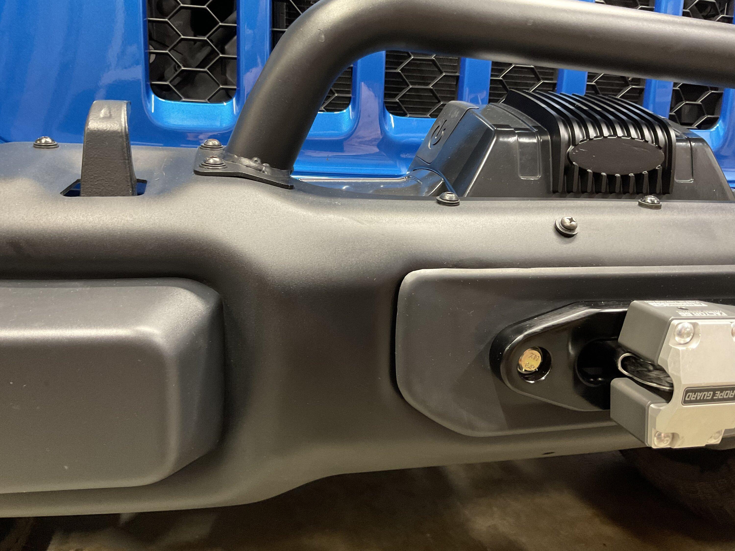

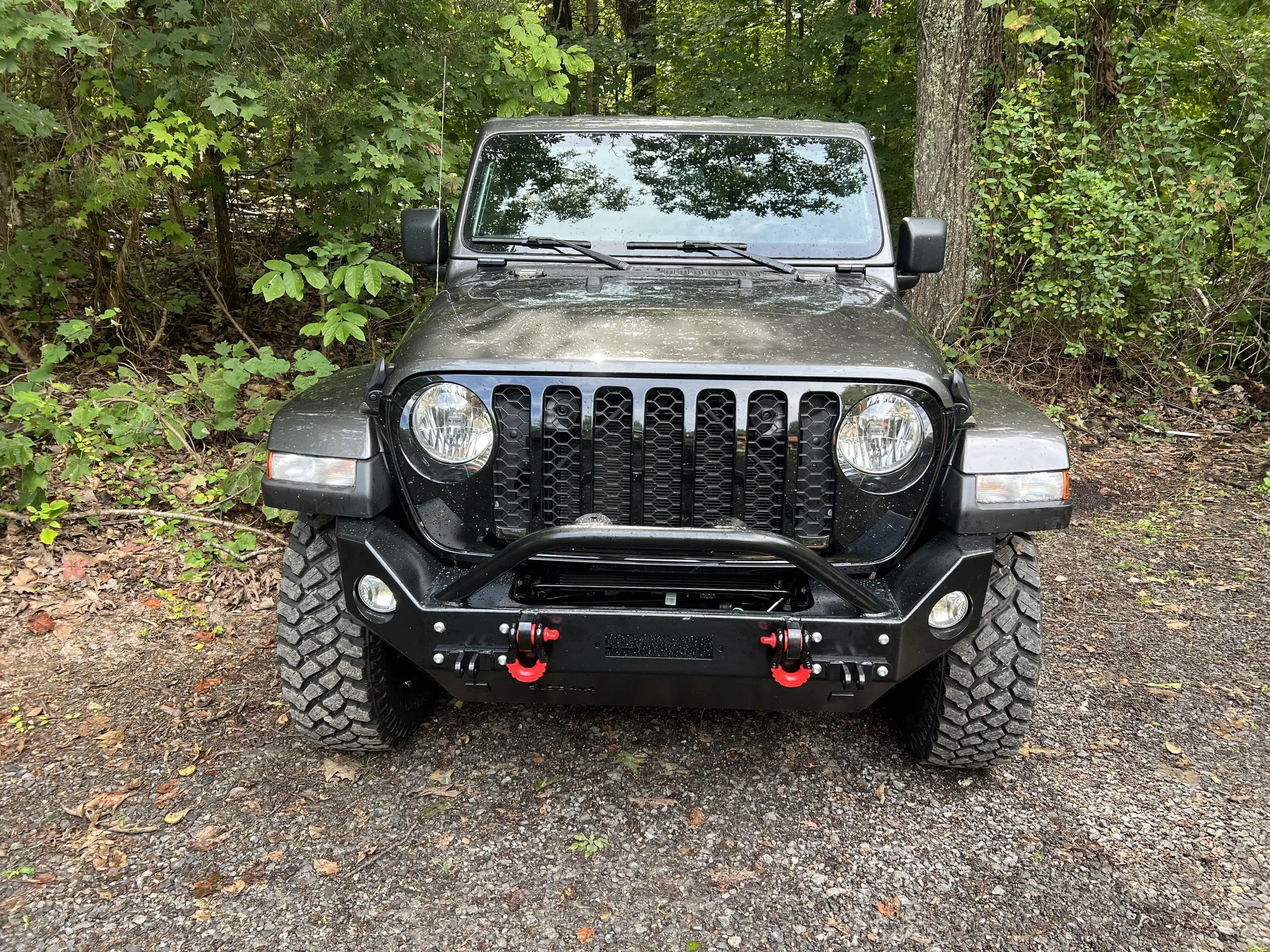

Added the Mopar grille/winch guard bull bar to the steel bumper for a little more aggressive look.
Jeep Gladiator What did you do TO your Gladiator today? [ADMIN WARNING: NO POLITICS, NO GUN TALK] 593301D9-D089-4900-AC14-5EDB32859425

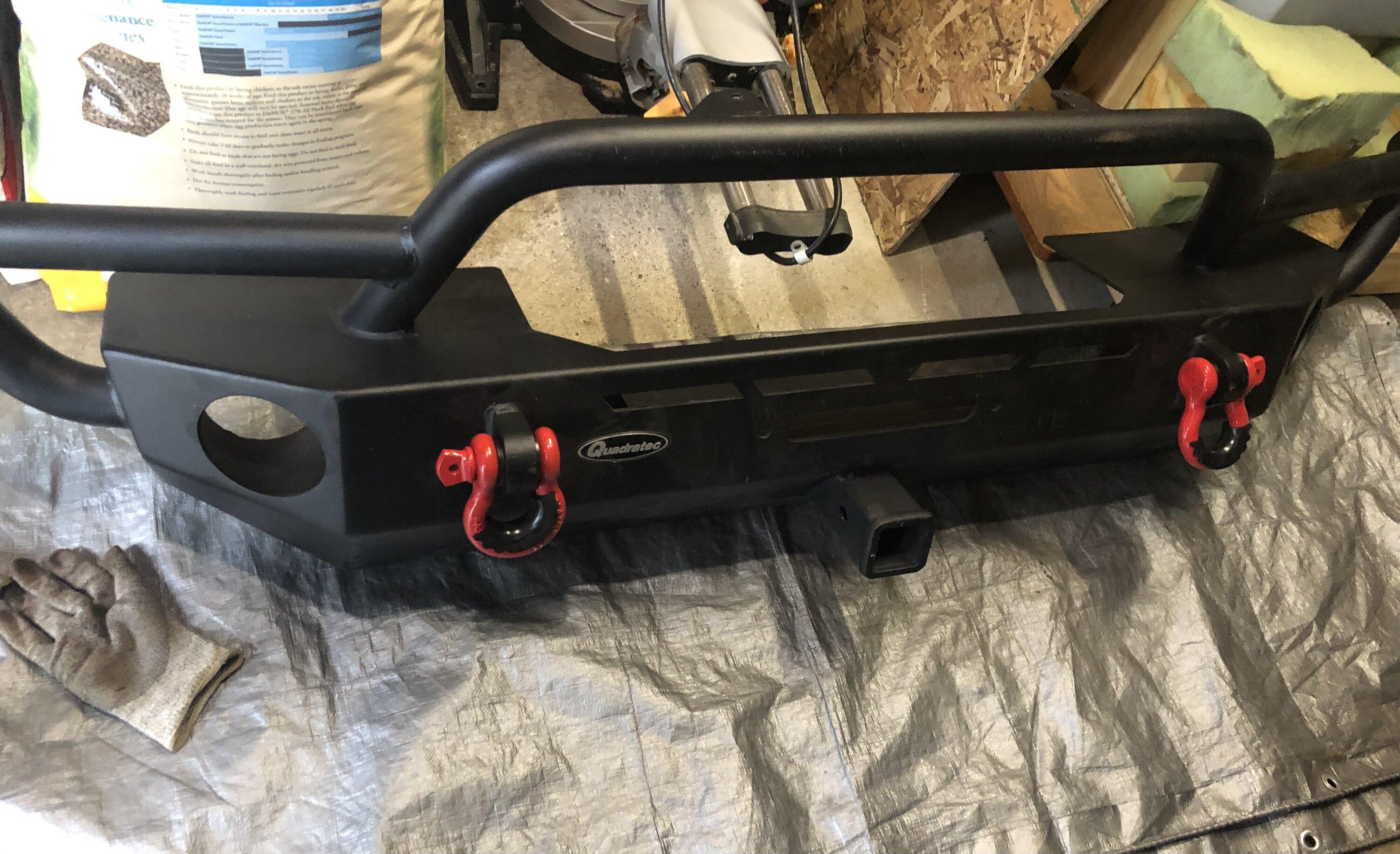

Sanded, wire brushed, primered, and painted knockoff steel bumper that developed a quarter size rust spot next to plastic trim under Hause lead. I thought a rock caused it, but the repair ended up revealing a spot under the paint roughly 1.5 by 4 inches. We’ll see how the rest holds up when it was installed less than a year ago. As a heads-up for anyone in the same situation, VHT bumper and trim paint is a close match.
I have multiple spots on mine 1.5yrs old. repair looks good. I was told about $300 to powder coat it
