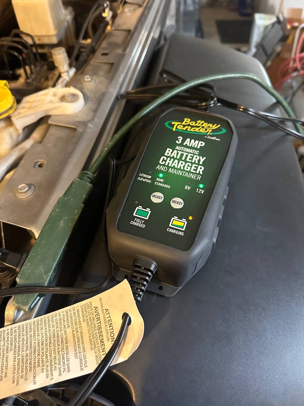

Bought a battery maintainer. Historically, before we moved, it had been in the driveway and my solar panel maintained the batteries. Now in the garage I’ll use this when it’s going to sit for a week. I probably won’t hook up the pigtail permanently as I won’t use it every time it’s in the garage. But who knows.
I need to do this.... Sometimes my Jeep sits for several days out of the week. On my 3rd set of Mopar batteries in less than 3 years.
