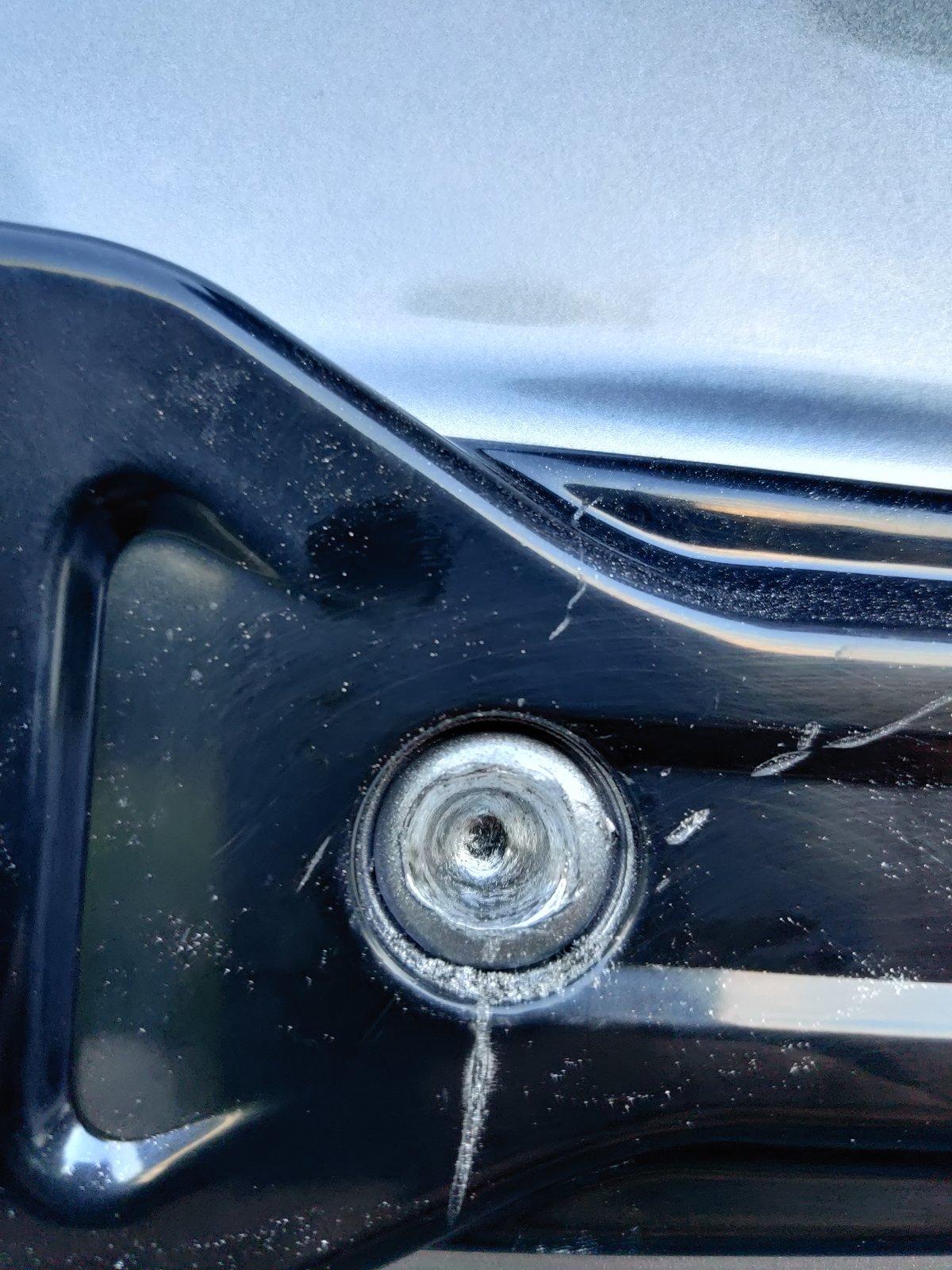

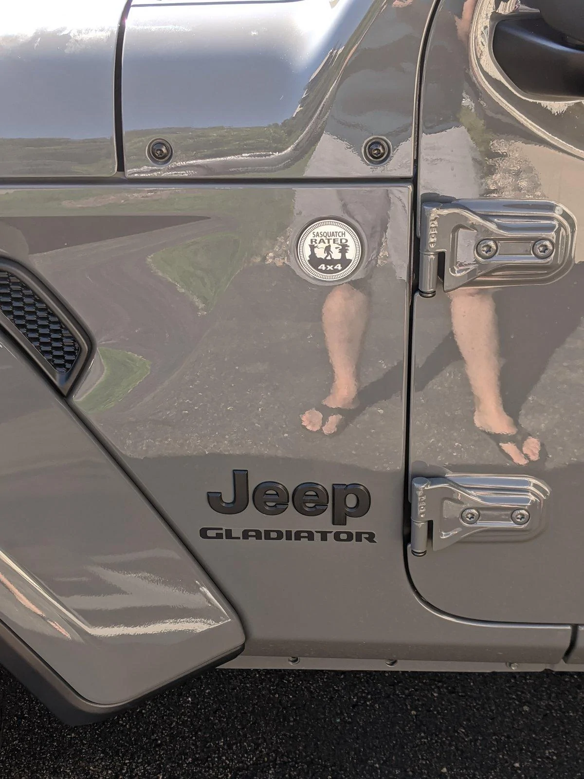

I tried to do that yesterday when I was running out of options. I used a t55 and gave it a few good hits with the hammer but the teeth on the t55 was just tad too wide. I'm gonna sit on it for a few days and decide what to do.
The bolt head is ruined, so clean the paint off and tackweld a hex head to it and get it off.
You start hitting one of those impact drivers with a hammer and you miss on that aluminum door - it’s going to leave a mark!

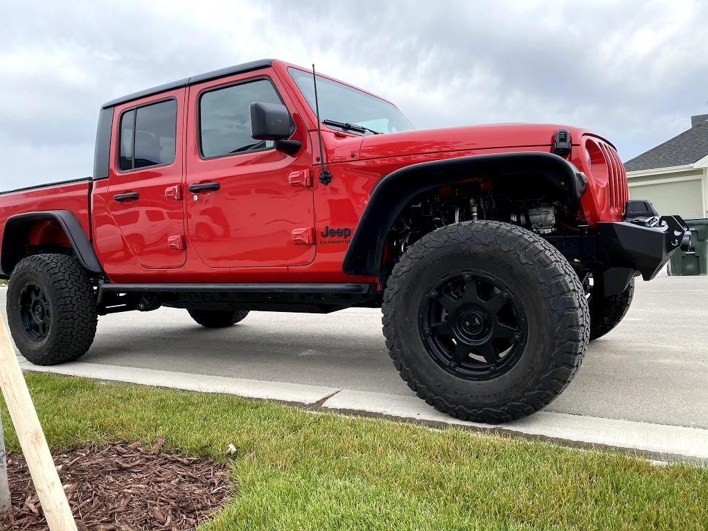

I Picked it up from American Vintage 4x4 in meridian Idaho. Had the Clayton overland 2.5" lift w/ Fox 2.0's, Synergy Sector Shaft Brace, JKS Quicker Disconnects & Motobilt Full belly Skidplate installed. The steering is night & day better. The lift is under rated. I didnt get a before measurement, but it seems to me its a good 2" taller then it was & it was already leveled 1.5" up in front.

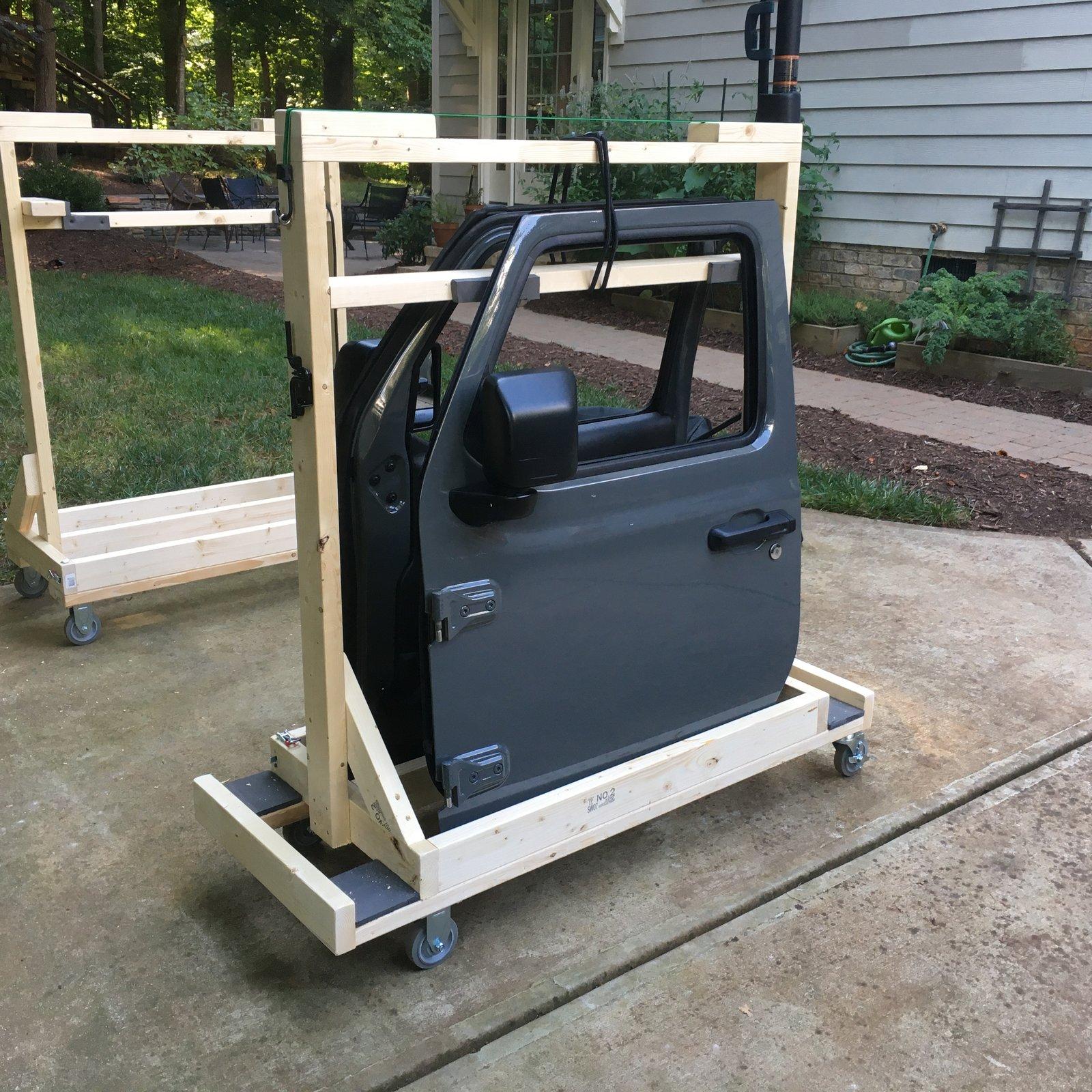

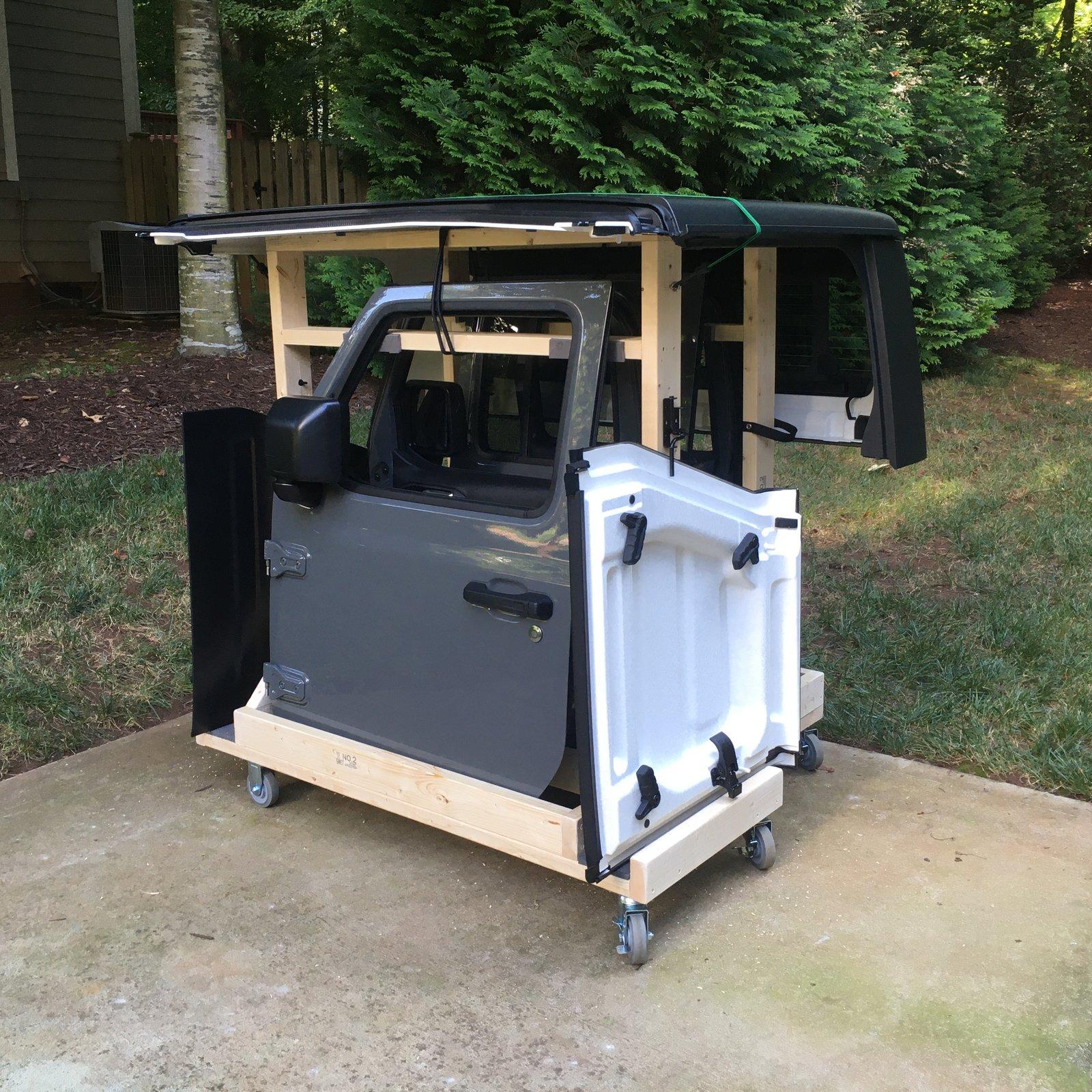

Not today, but over the weekend. Finished up a door, Freedom Panel, and roof cart combo. Pretty happy with the way it came out. Can be stored in a narrow spot in the garage but can move easily when fully loaded. Also can use it just for the fronts off, all the doors off, or latched together for everything off.

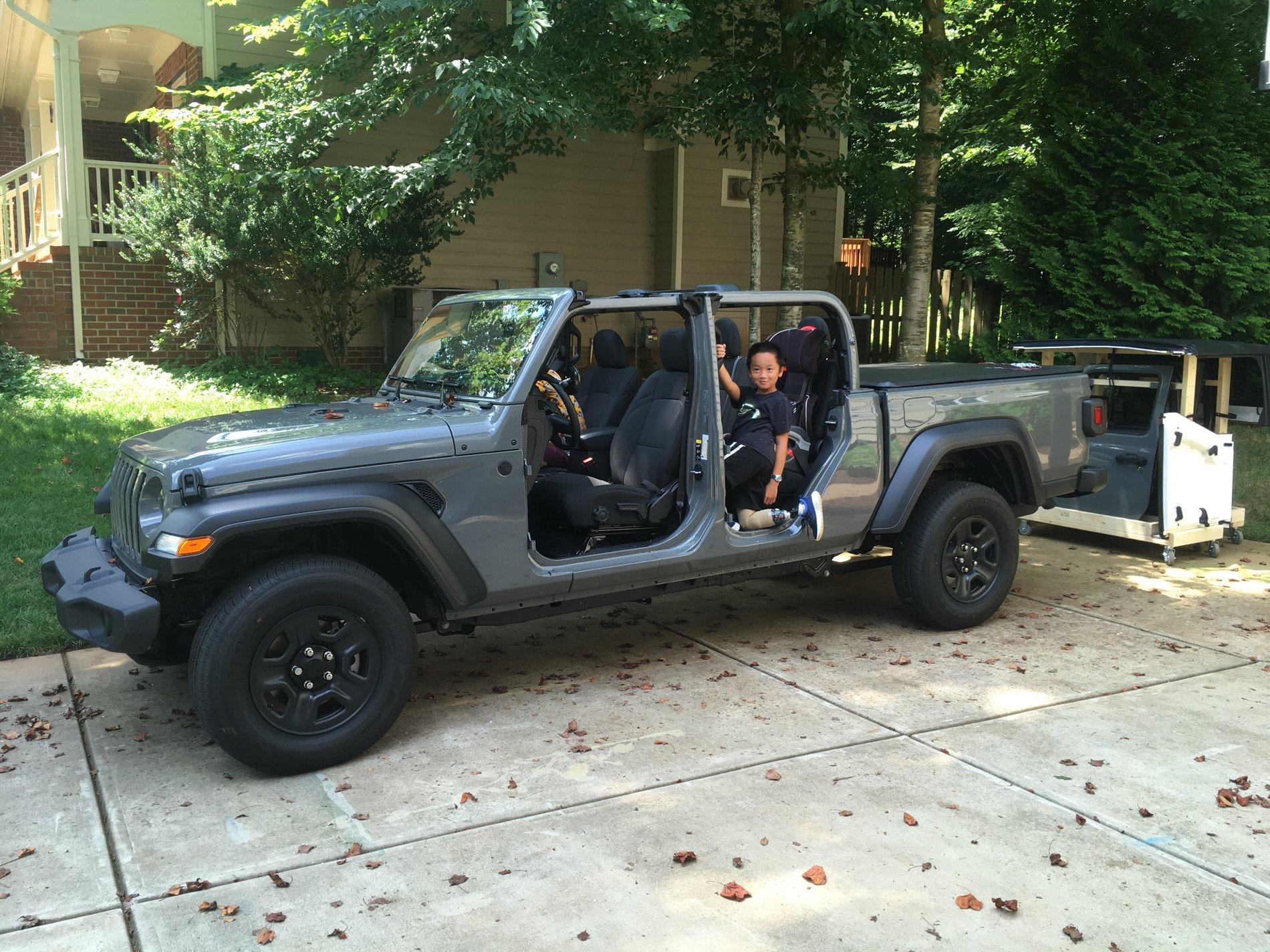

Off course we had to test it out...
I had my mechanic friend come over and he said he wanted to drill big enough bit through and by time it reaches the thread it will break loose but he wouldn't continue because he said I needed a bigger bit. To be continued.

If you can find one try using a left handed or reverse twist drill bit, they will often take the bolt out with them as you drill for the extractor.
SWEET! Nicely done. Bet you could sell plans............
I just watched a video on it .. that's a great idea. Thanks

JTRs don't really sit any higher stock...its the tires mostly.
I put Rubicon springs on the front of my Overland. I gained 1.125" height in the front measured at the receiver. Just shy of an inch measured at the bottom edge of the running board. When I got in the truck to drive around the section and settle things in, I could tell just sitting in it the front was higher.
When I got back, I put Sport S max tow on the rear and LOST .5" height at the receiver. The max tow springs are about 3/4" shorter than my Overland rear springs to begin with but held the weight a bit better so didn't settle as much, leaving a half inch loss in height of the rear.
BTW - Overland stock tires make my truck sit the same height as Rubicon stock tires - I swap back and forth and it doesn't even throw my speedometer off. Measured height, truck parts to ground remain the same.
But Rubicon springs did make my truck sit higher in front by a tad over an inch.
This right here is about the best advise you can be given... I bought a norseman extractor set with left handed bits sized appropriately for the extractors. Only 1 fastener has proven too much & its quite small & in a mid 1930's 5" wilton vise that I dont think has ever been apart.

Once you start drilling, you are committed to drilling it out.
If there is any way to get a bite on it, I would try other methods first.
You might consider stopping by an auto body shop or a friendly dealer.
They have the hammer impacts because they use them to take off doors on regular cars.
It works well because when you hammer it, it forces the torx bit down into the bolt head and has less of a chance to strip it.
You can also try a one size bigger torx and try to hammer that into the bolt. You will probably ruin your torx bit, but at least you might be able to work it loose.
I have tried every trick in the book. From working on airplanes in the Navy to engineering some of the biggest superyachts in the world....use drilling as the last option as it's the most invasive.
D
Very true, but the back of the item has to be rock-solid otherwise you flex the part, or it moves, and you lose the advantage. I use the hammer impact a lot, almost daily in my work, I've broken them and broken their bits. Unless the part is back by something heavy or rock-solid, they don't work so well.
Here I am milling out a bolt after the impact failed.
I have had to remove three this way in the past few weeks and had it centered so perfectly, all that was left was the threats and a foil-thin layer of the bolt I just peeled out.
If I can get the item up here, if it will fit, if there's room, it's not on a car or truck, this is my solution. I control the exact depth and can dial in center near-perfect.
But it's a last resort........ yes.

Installed Rubicon take-off FOX shocks, Rubicon front springs and max tow rear springs.
Didn't like the DROP in height at the rear, liked the gain of height (1.125") at the front, though.
Maybe I should have put the Rubicon rears in, too.
was gonna try this one out
I think I'm gonna give this a try tomorrow. It's in stock.
