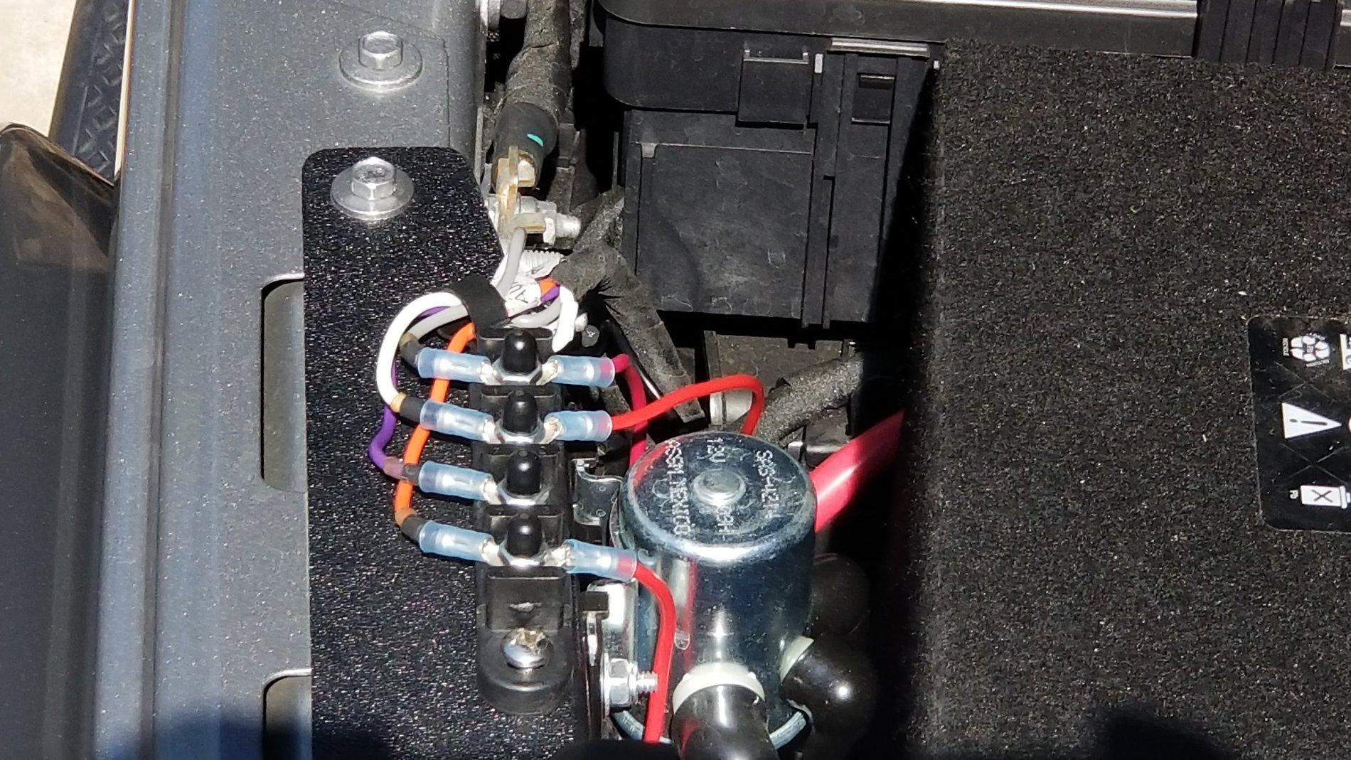

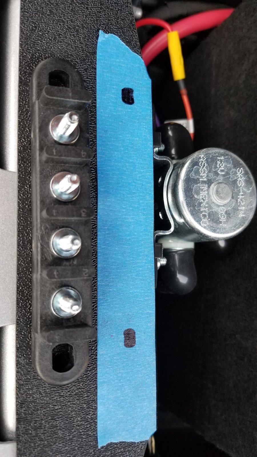

Added Aux switch terminal block to clean up the wiring and allow flexibility in the future to easily reassign or combine. Bought a Fastronix 4 stud junction block kit on Amazon and mounted it on top of my DIY ABS winch cutout switch bracket. I wanted to go with a Badge Glow kit, but it interfered with my existing bracket.
Used painter's tape to trace the mounting hole pattern. Drilled small pilot holes and used license plate screws to hold down the terminal block.
Jeep Gladiator What did you do TO your Gladiator today? [ADMIN WARNING: NO POLITICS, NO GUN TALK] 20201017_172510
Then, I crimped ring lugs, routed the wires, and screwed them down. I covered the top of the posts with small rubber vacuum caps. Plenty of clearance for the hood and Redline hood struts.
Clean!

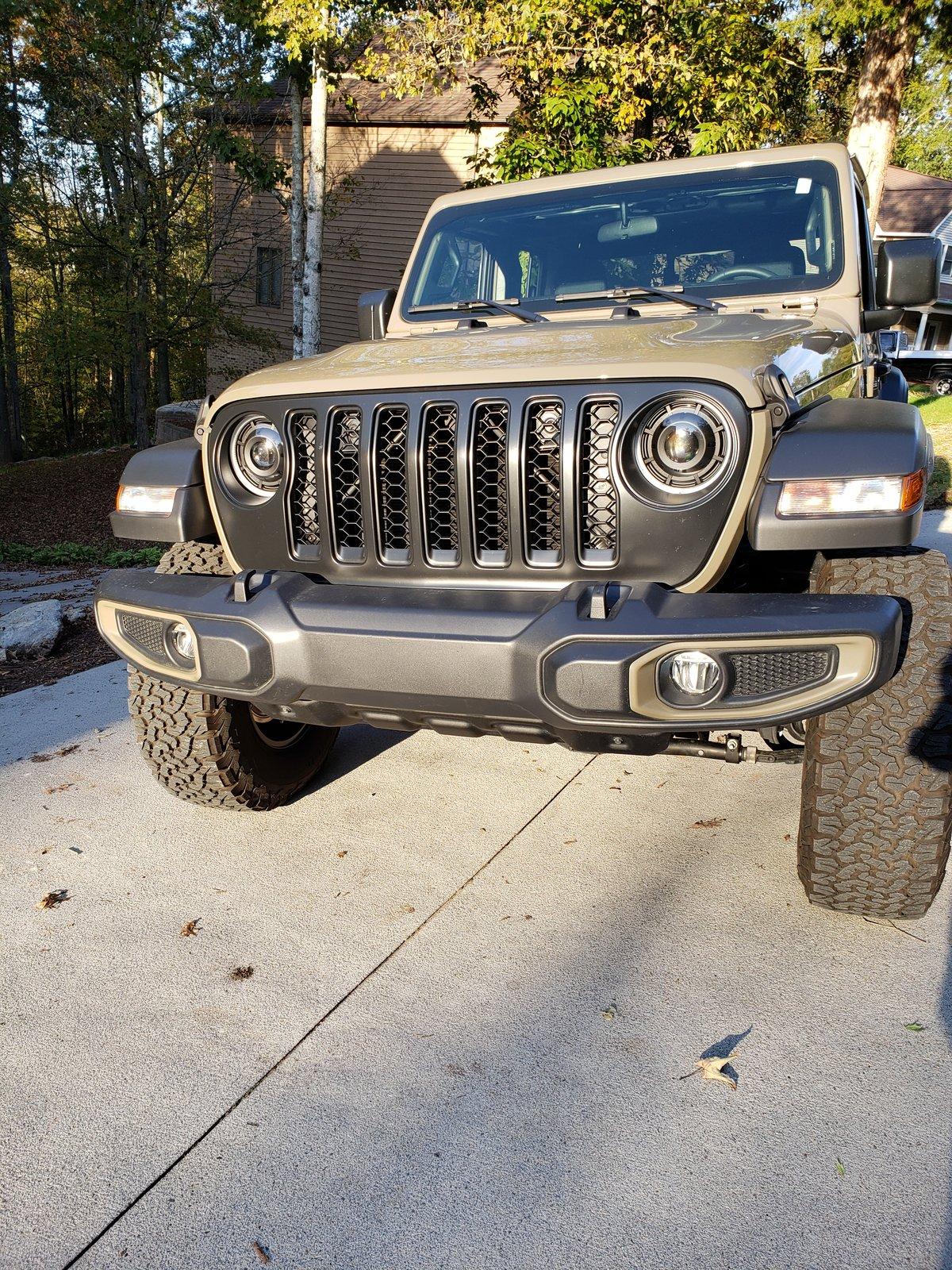

Installed Oracle Oculus headlights that I bought from @aureovin. Connected the halos to Aux 4. Leaving them turned off until I can get some LED turns turns installed. Cant handle the halogen/LED mismatch. Also installed a Rubi takeoff plastic bumper with metal skidplate. I painted the bumper inserts Gator to kind of break up all the black I have going on out front. Reasonably happy with how the paint turned out.

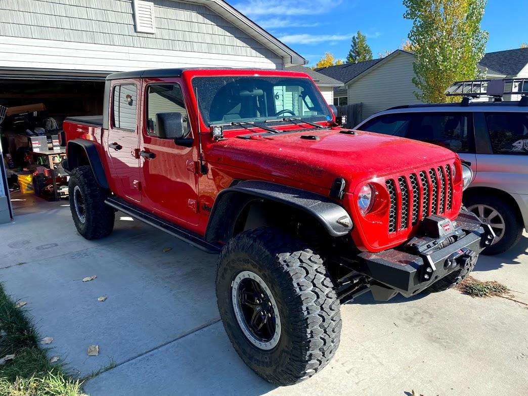

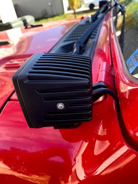

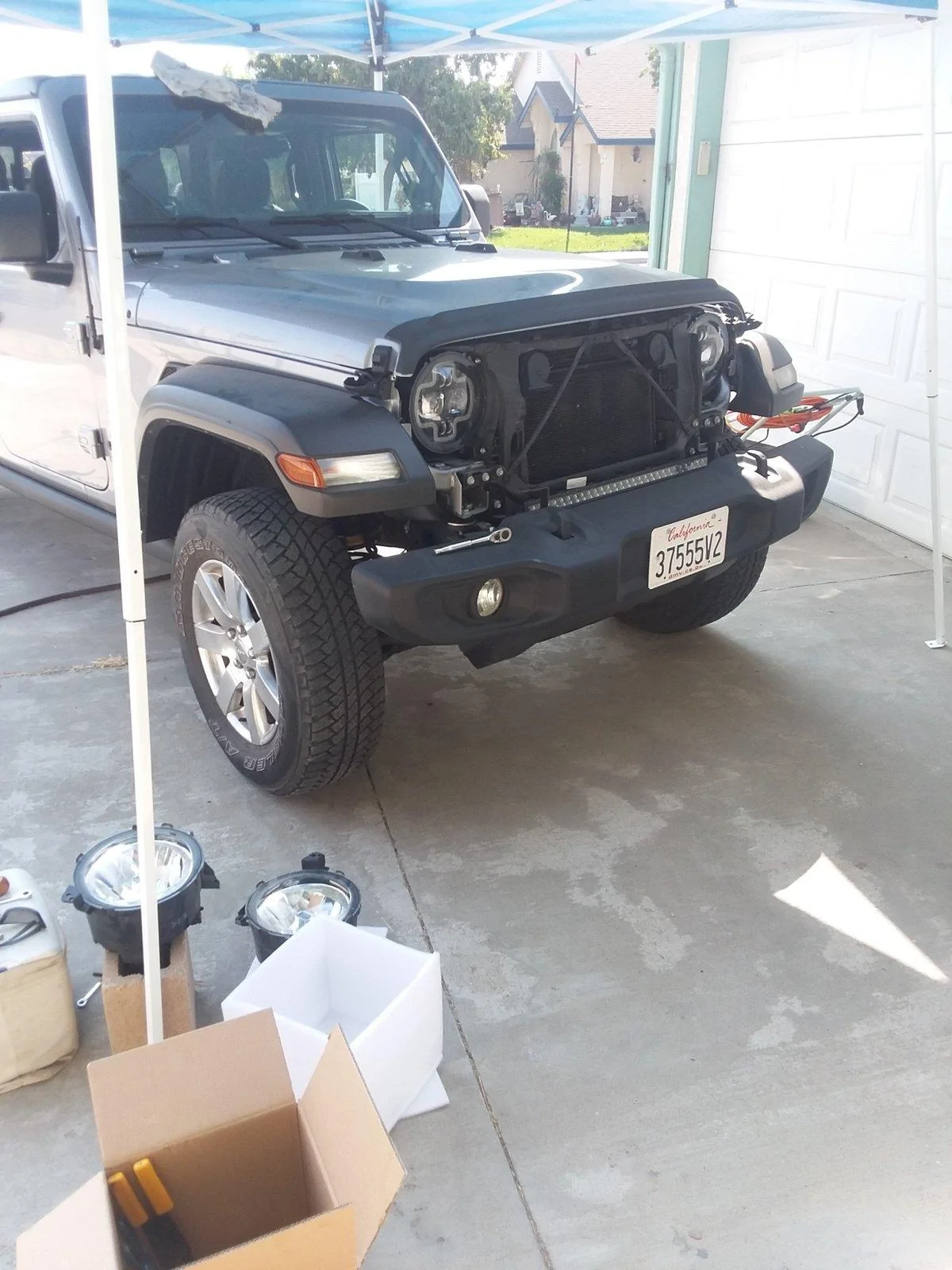

Thanks to winning some lights at a local jeep swap meet months ago & then prime day having some decent looking mounts that I scored for 10 bucks I finally got around to installing some after market lights.

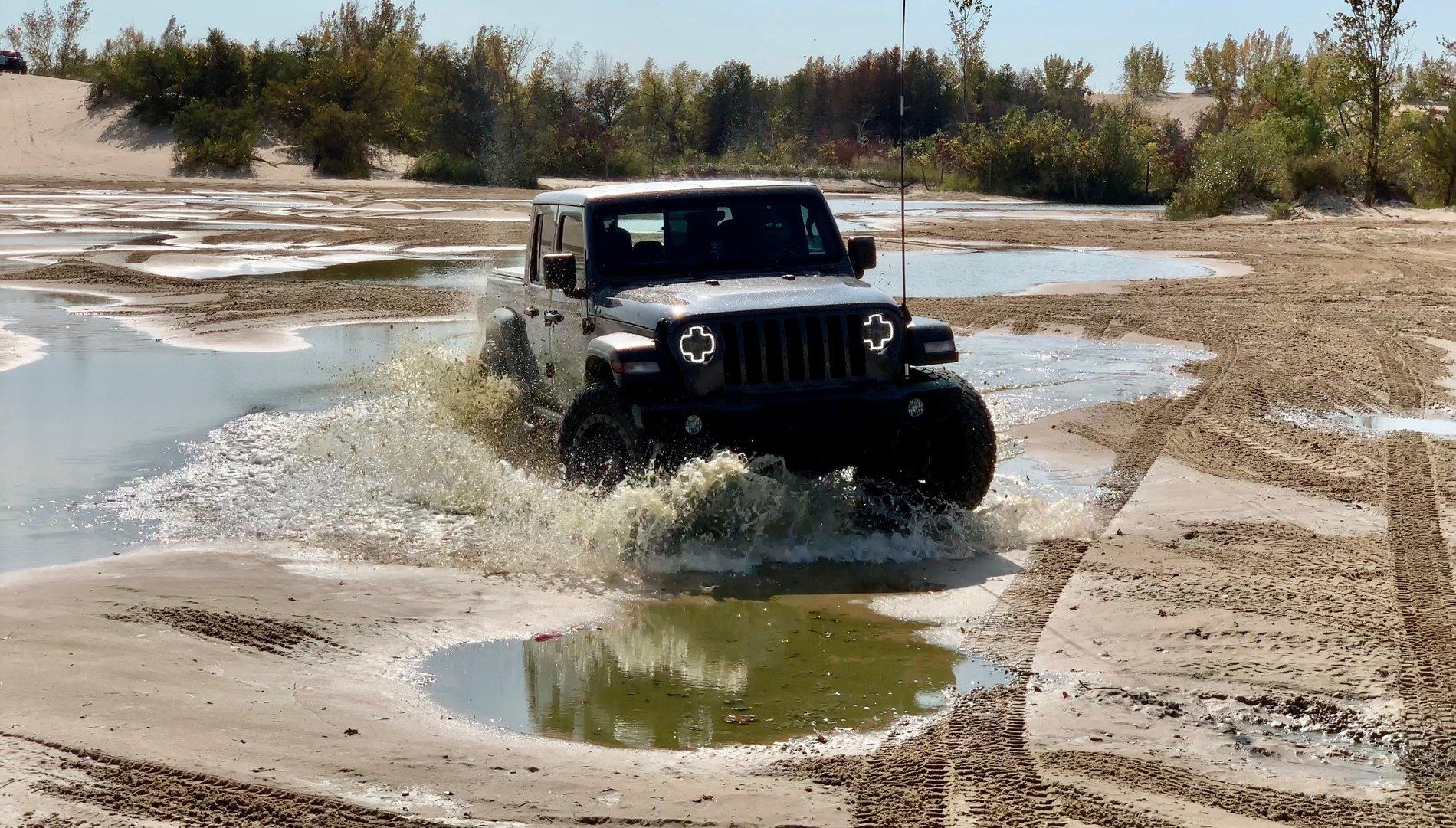

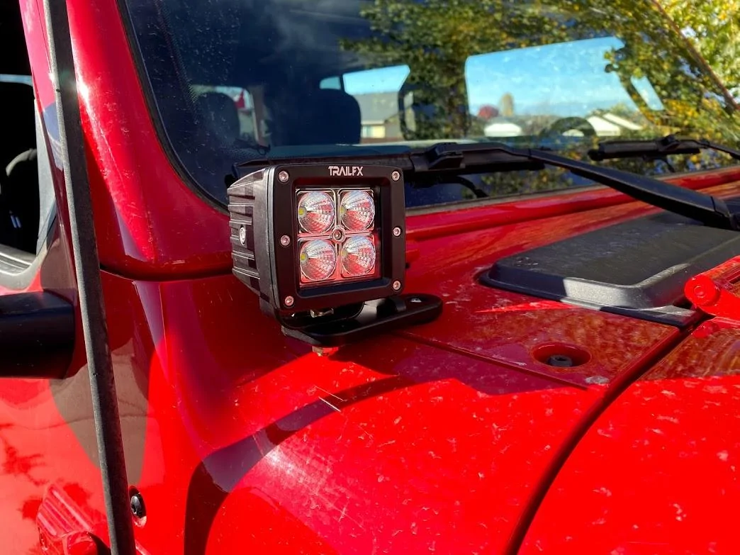

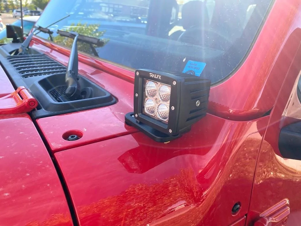

2020 gladiator

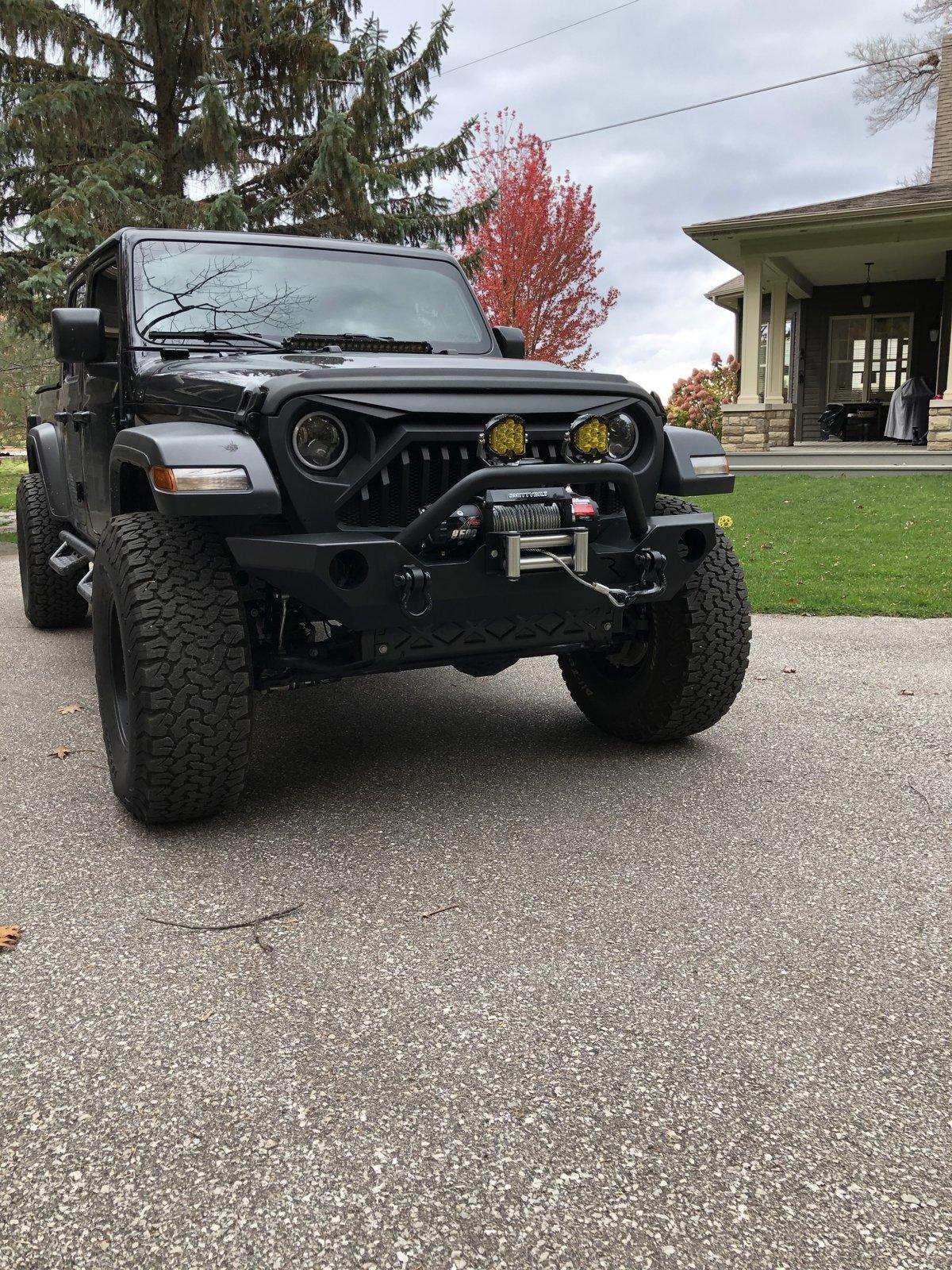

Installed my rampage rock rage front bumper , smittybilt xrc 9500 winch and some lights on the bull bar . Super easy install . I think I will add another set of those lights on the A pillar . I have 4 x 6” small light bars to install next for the rear and side step lighting . Never enough time lol
Halo Fog lights have also been re installed , I forgot to bring the aftermarket mounts for them to the cottage when I did the install but got them squared away today . The lights on the bull bar also have a nice orange halo DRL
