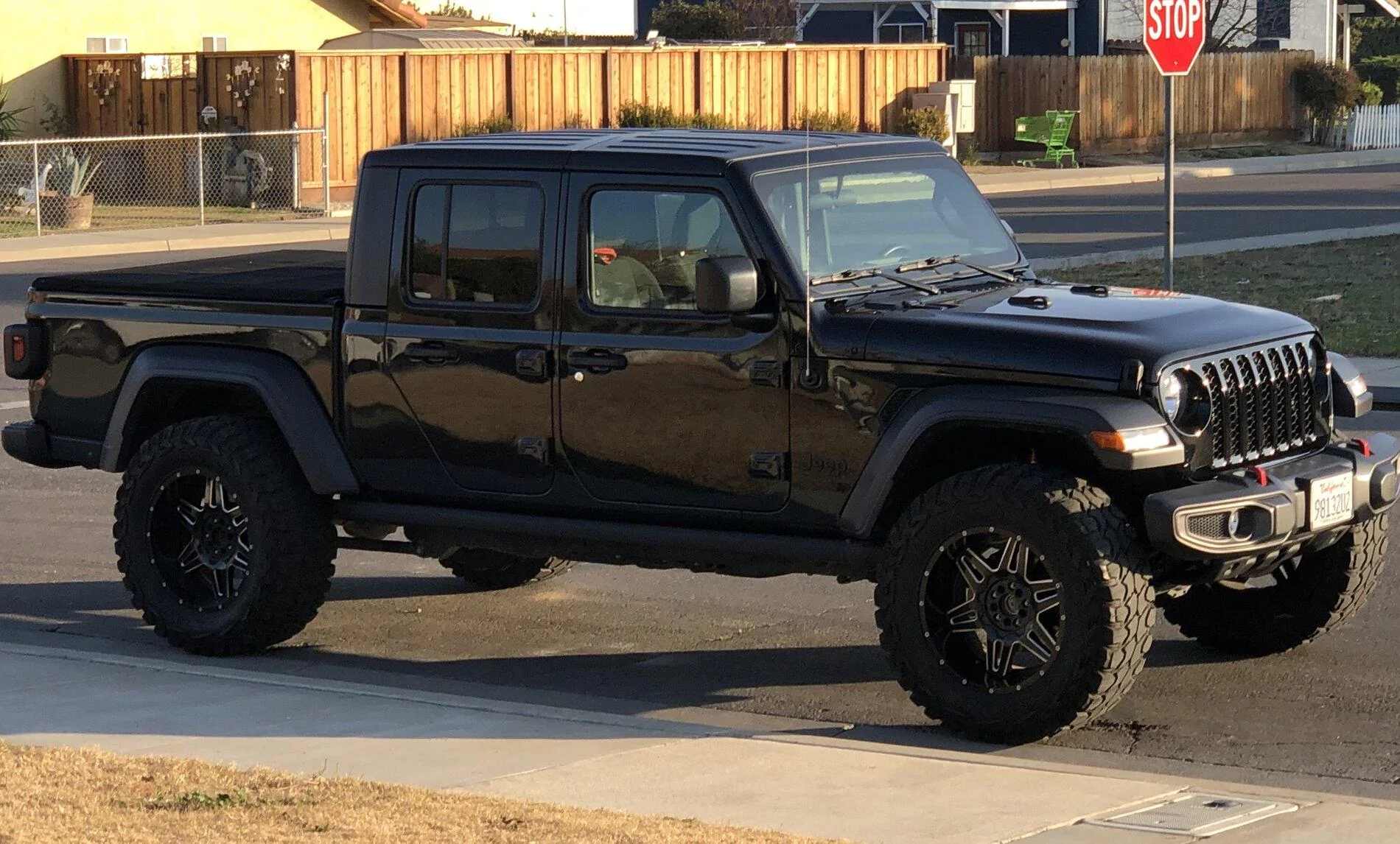

After a couple weeks of trying to decide, 35" BFG KM3's installed. Will be going in for a gear swap to 4.88.s. Almost got 37's but too much had to be done for that to work.
BFG KM3s are tires that get better looking as they get bigger.

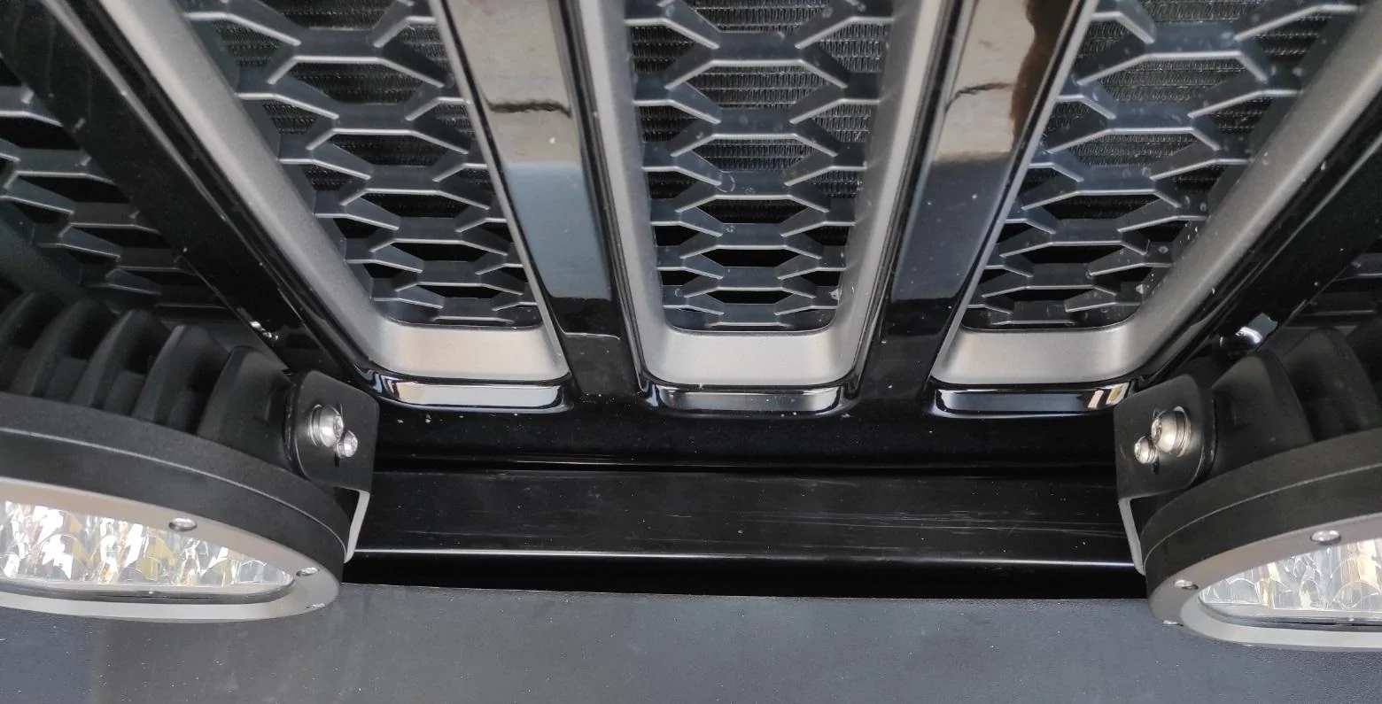

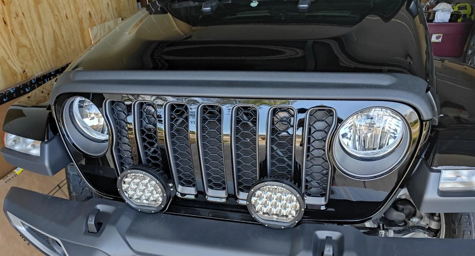

Today, I finished up the Auxbeam lights. I have the 'plastic wonder' bumper, so I used a piece of non-punched unistrut through bolted through the frame. Unistrut came black from the supplier, as well as the end caps.

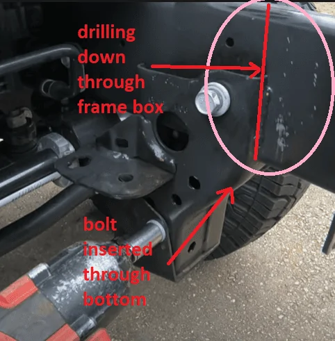

Now that it's all closed up I've referenced a video and attached a photo from another user and made some notes. It's really pretty easy (I'm not a mech or fabricator by any means). Here's a video I found which shows the areas of concern.
Notes:
1) There are two push pins on the top which hold the plastic filler panel in place. (VIDEO 4:57) I drilled 1/4" holes in close proximity (the frame box is only ~2" wide) to them and continued drilling down through the lower part of the frame 'box'.
2) To assemble, remove the 'air dam' on the bottom (two hex and several push pins) then the steel cross shield (two bolts).
3) The ends of the frame box are open, so it's possible to insert the bolts through the bottom up to connect to the spring nuts in the unistrut. Pls. ref. attached photo.
Jeep Gladiator What did you do TO your Gladiator today? [ADMIN WARNING: NO POLITICS, NO GUN TALK] Screenshot 2021-01-15 145535
Once you get under there it will be very clear. The beauty of the method is the connection is to spring nuts, and the unistrut can move laterally, so if your drilling's off a bit (like mine ?) it can be easily compensated for. Just to be clear - removal of the bumper and filler is not necessary.
Hope it helps. I bought the material from McMaster-Carr.
