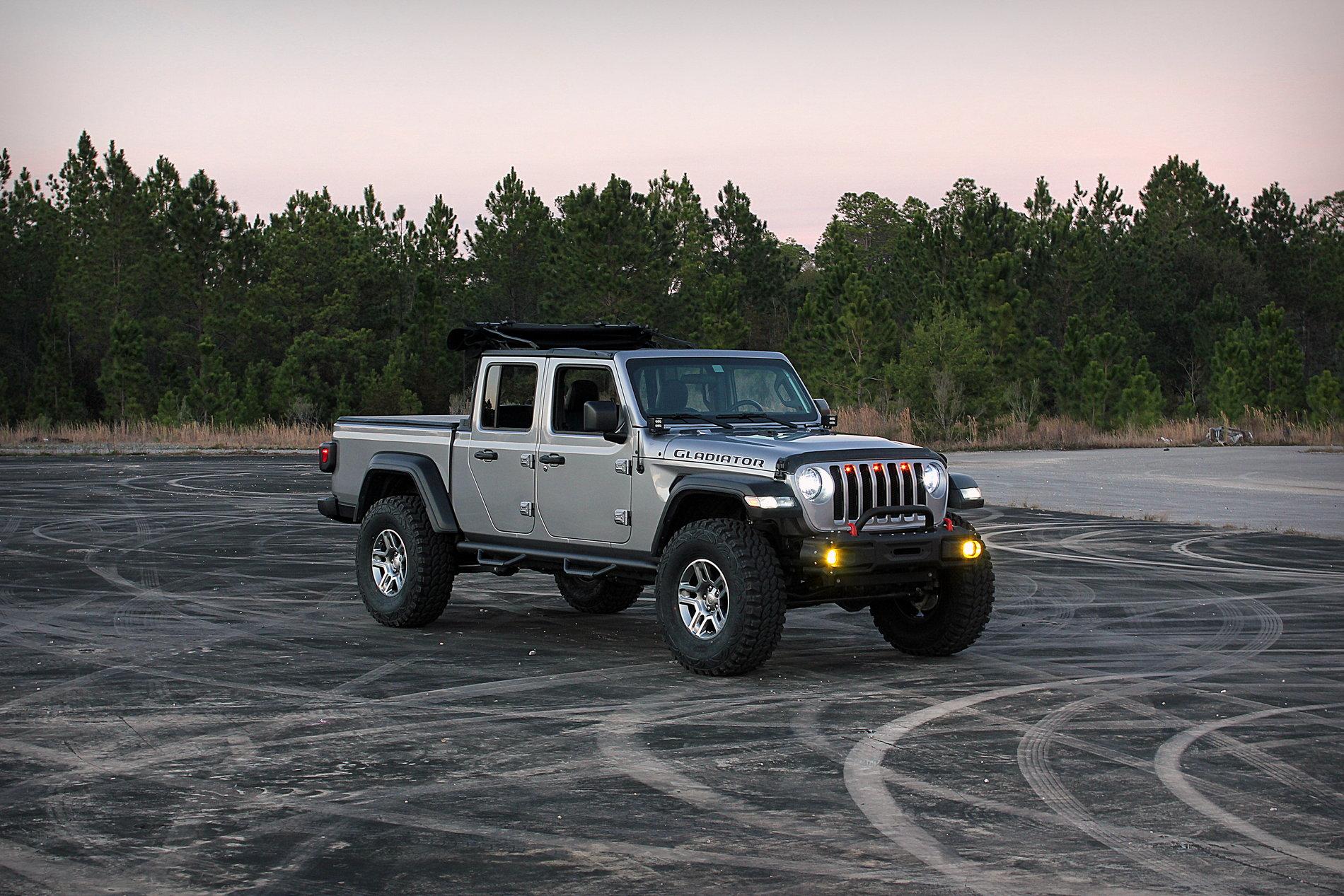

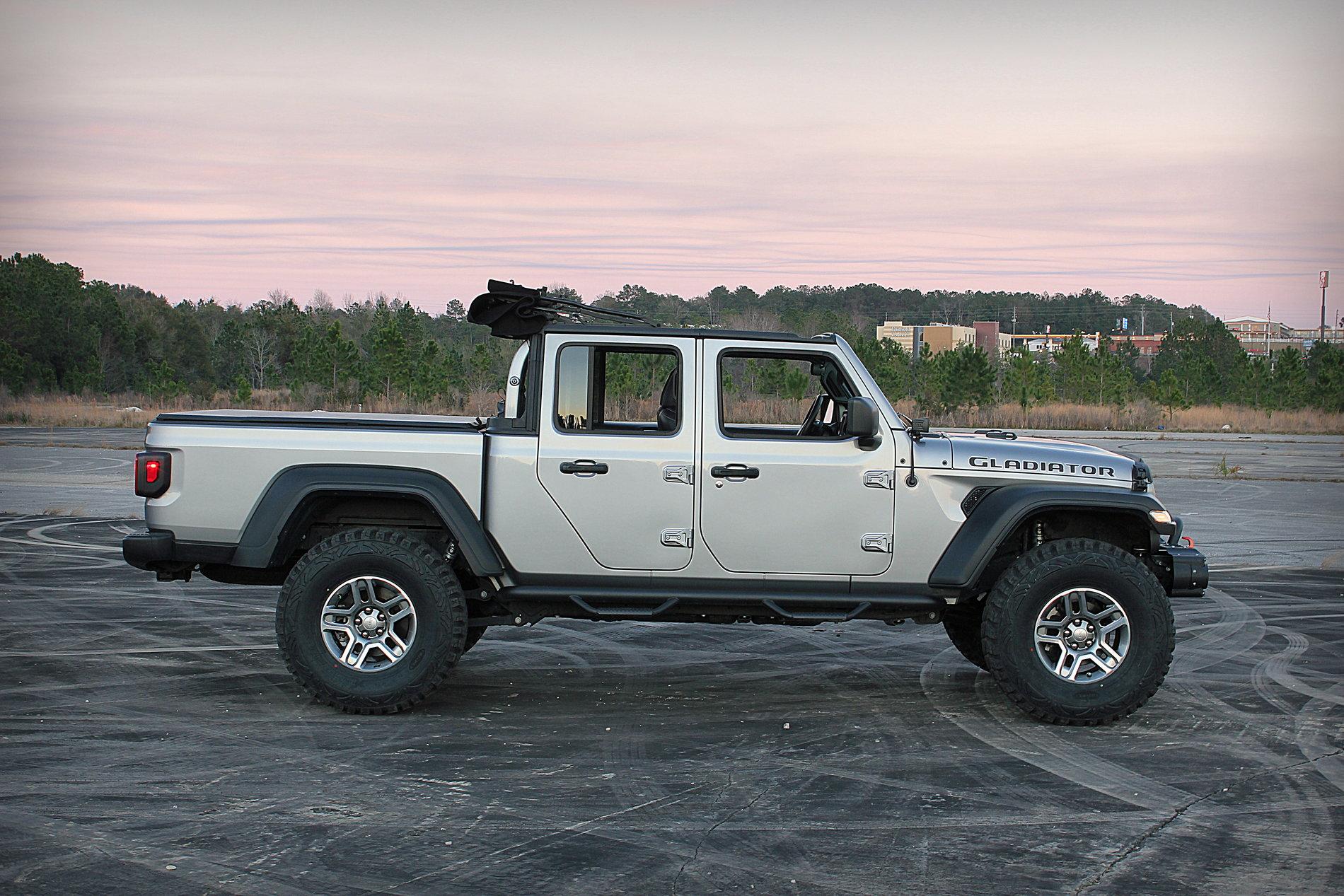

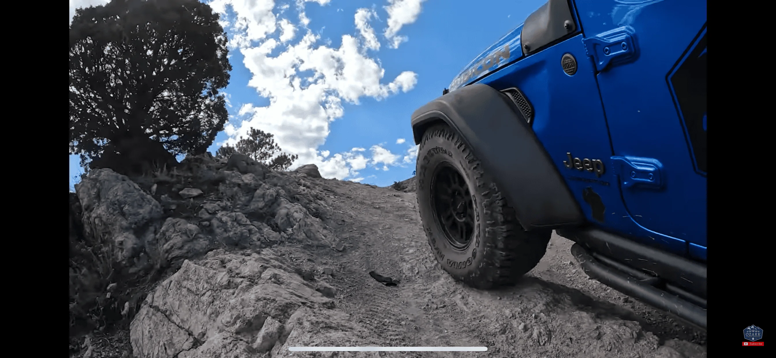

Below is a photo of the wheels on a JT.
Jeep Gladiator What offset and back spacing should I get on my wheels? CF52C348-D18E-421E-B8B6-37299387DBD6
Jeep Gladiator What offset and back spacing should I get on my wheels? 46A46C05-5752-46A2-9B32-7F0A9554885A

I’ve looked up the rim on the manufacturers site. I think it comes in -12 and -35. Keep in mind this is a 9 inch wide rim not an 8.5 that you can get by running on 12.5 wide tire.
Wheel width doesn't matter in this instance. Offset doesn't change as wheel width changes like backspace does, because offset is measured from the center. A -12 rim offsets a 12.4, 12.5, or 13.5 tire the exact same amount whether that wherl is 7 inches wide or 10 inches wide. It's the primary reason I prefer offset to backspace as a measure.
And in case you don't believe all that (which you should because it's true) the pictures I posted above are of 315/70r17s on a 17x9 wheel at +6. So the 9 inches vs 8.5 comparison matters even less because I don't have 8.5 inch whes

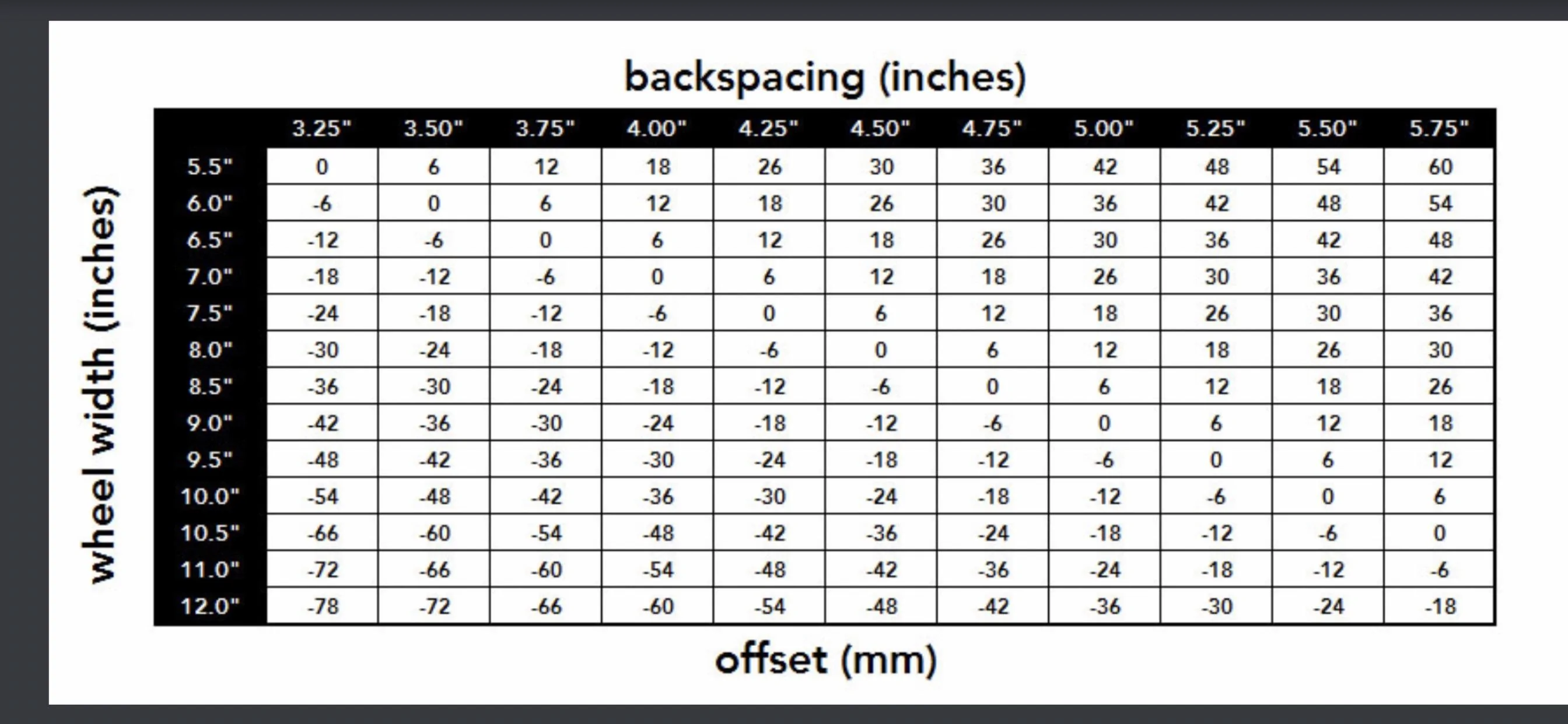

See my previous posts with the table…the difference is 1/4 inch. Not that big of a deal.
Jeep Gladiator What offset and back spacing should I get on my wheels? D1445199-2AE4-4F86-9871-3A82276E06CB

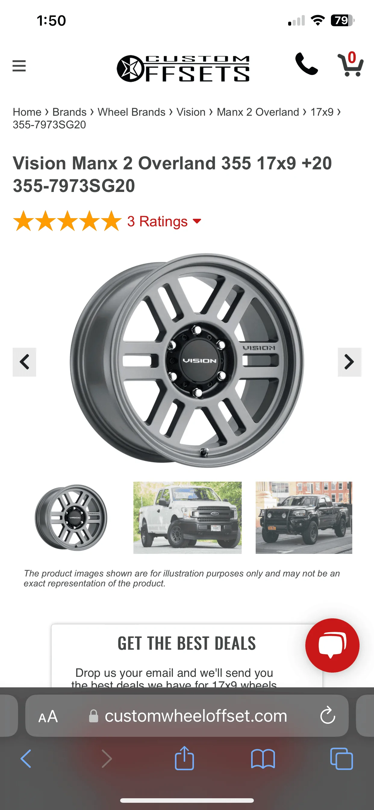

If anybody has any advice whether the below wheel would fit, that would be great.
https://www.procompusa.com/product-...with-5-on-5-bolt-pattern-flat-black-97-7973f/
FYI. I called them and left a VM but they haven’t responded. I also emailed ProComp a few hours ago and hope they respond.
