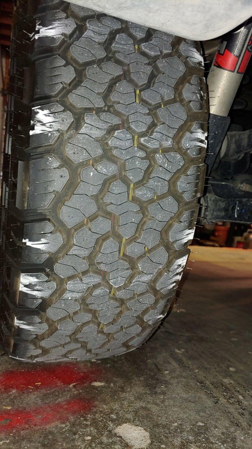

I agree that chalk test isn't "God's word". Obviously you still gotta tweak but it gives you a damn good foundation based on the weight of your vehicle. No one else can really give you that unless they have the same configuration.
40,442
53,858
Yup.
It's a very solid basis for a starting point.
Anything else is just semi-random numbers.
All I could possibly give is based on the weight of my truck and the exact tires I have.
