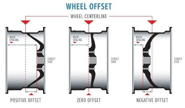

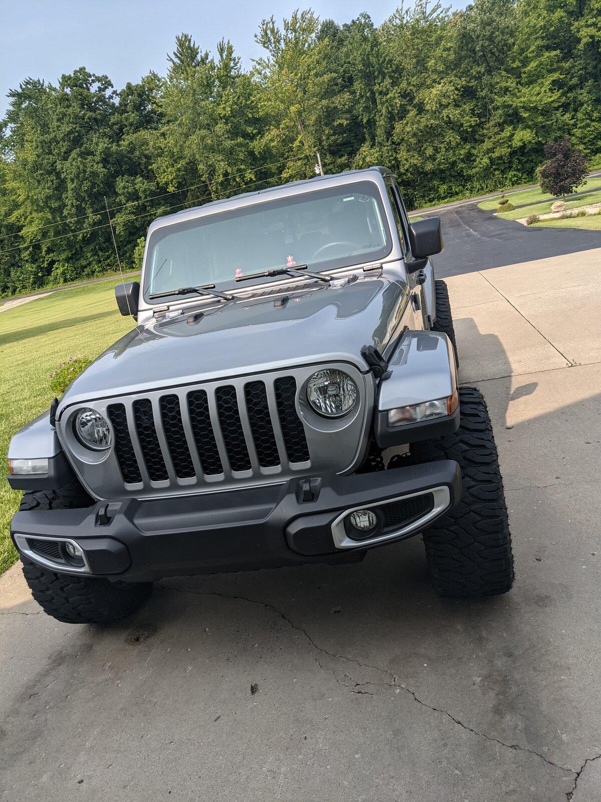

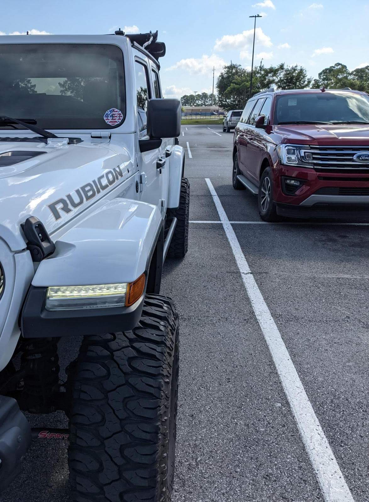

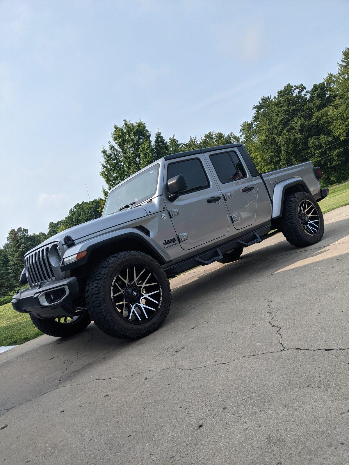

The factory wheels are 44.45 mm offset.
The icons I bought are -6mm with 4.5" of backspacing.
The offset will be dependent on the width of the wheels you pick. The factory wheels are 7.5" wide while the icons below are 8.5" wide. If they were both 0mm offset the icons would stick out by 1/2 the difference in width (.5"). The deep lip look you mention is probably with 10" wide wheels or more.

Negative numbers will stick out further, positive numbers will be under the fender more
Huh…

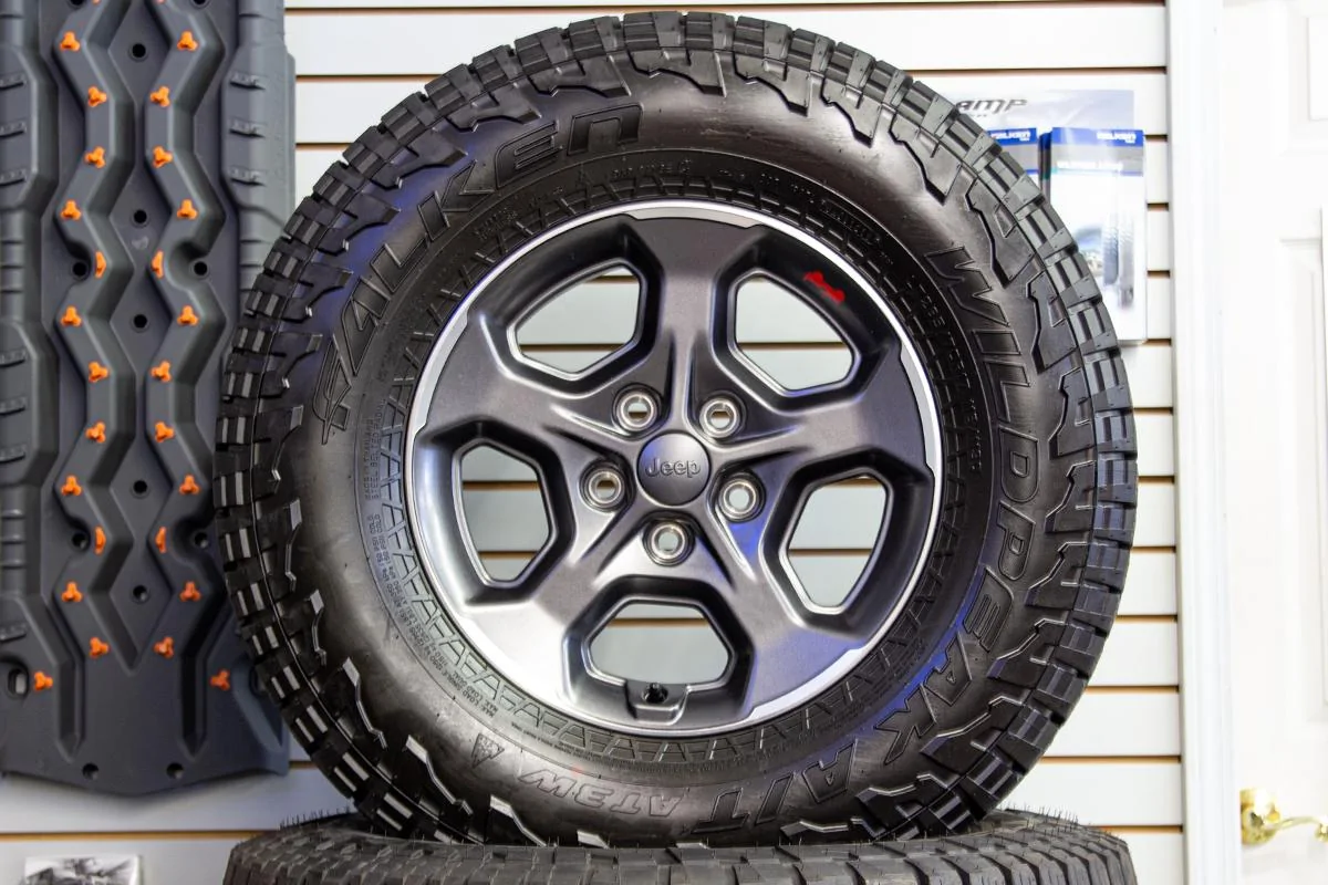

Are the stock wheels 44.45mm positive or negative offset? I thought they were negative.

Take a look at the wheel below. It is most definitely a positive offset.
Jeep Gladiator Wheel offset for deep lip look? jeep-gladiator-rubicon-factory-oe-wheels-and-tires-close-u
