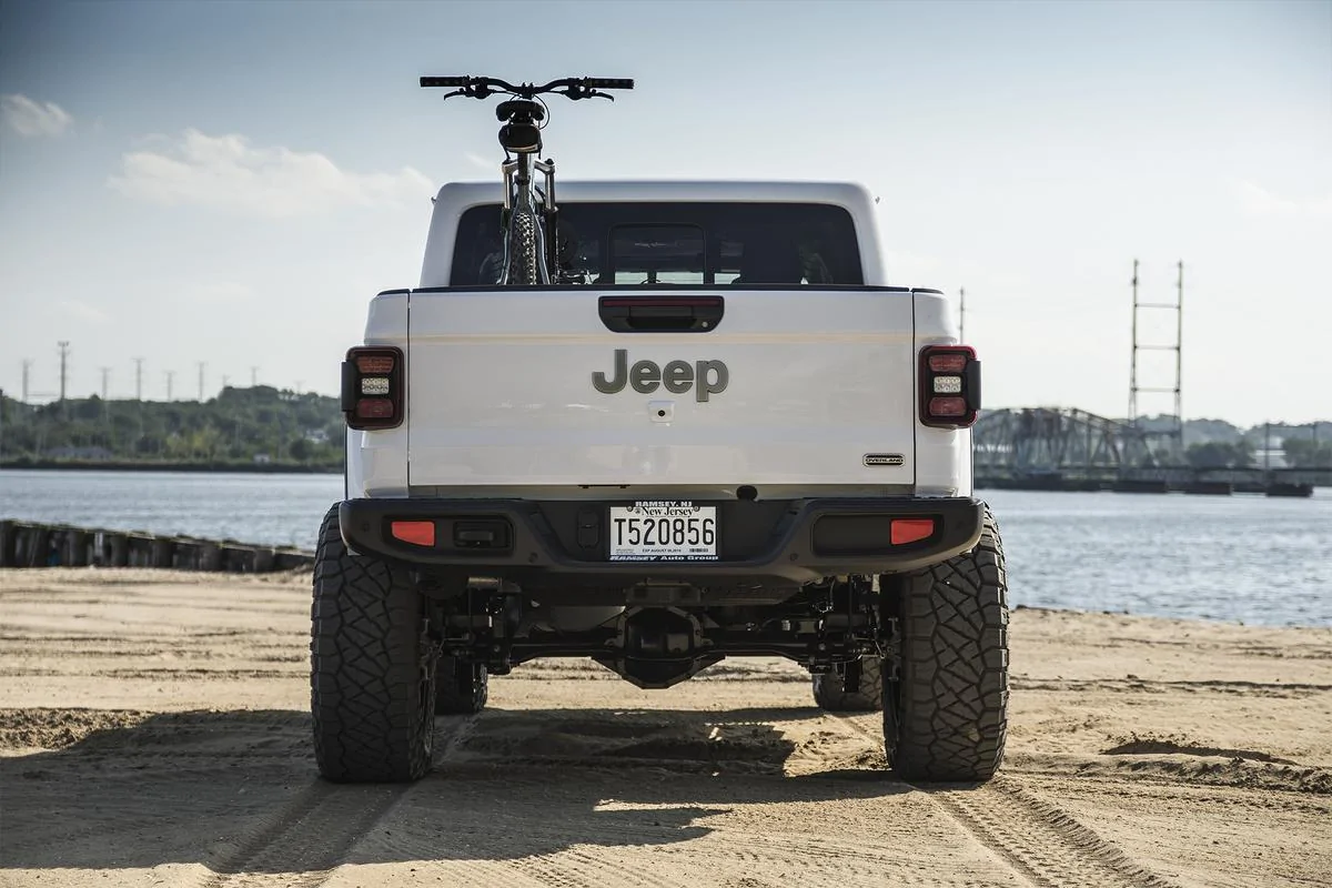

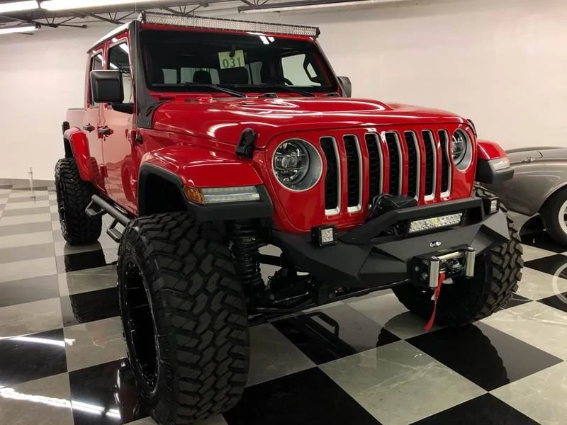

Can someone tell me what offset this could be? I believe that this would be a negative offset... The wheels I want are offered in 0, 10, -12 and -25. The attached picture of a Jeep in south Florida has the stance that I desire.
Anybody have any idea?
Depends on the wheel width too... those look like 12 wides above.
Here's a pic of my 10 x 20's with -25 offset.
They dont stick out quiet as much as the pics above.
I saw that earlier on IG. Looks good!
It also depends a little which trim you have, as the Rubicons have wider axles. It’s mostly personal preference until the tires contact something...
