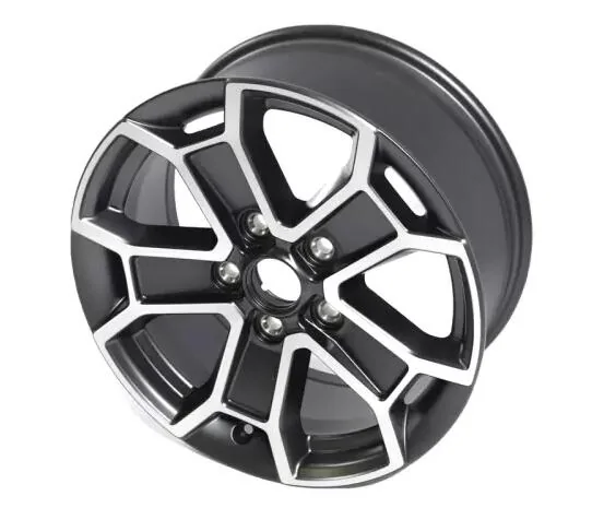

Does anyone know, if any, whats the offset on these rims?
Jeep Gladiator OEM rim wheel offset? Screenshot_20240916_130501_Chrom

Roughly +44mm, or 6" of backspacing.

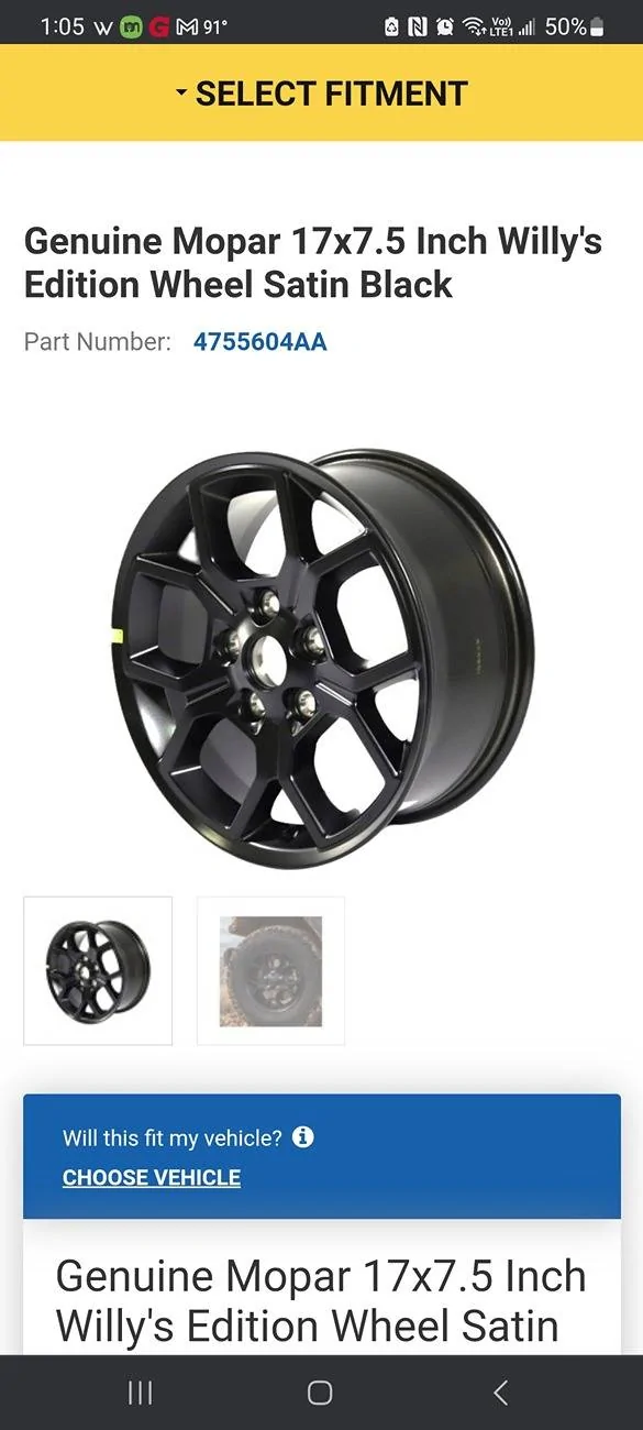

What's the Mojave? This is what I have on the'24 Mojave X. I just haven't been able to take the wheels off to look and I can't see it behind the brakes.

About +37mm, or 5.7" backspacing

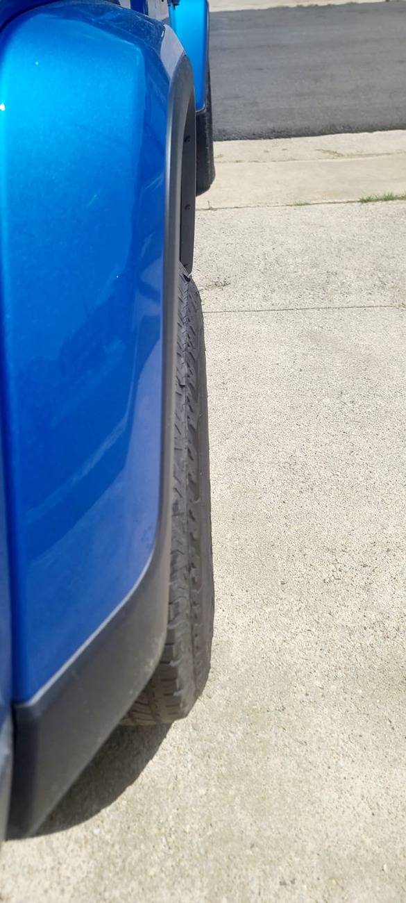

To expand a bit further on why i'm asking,.......
I have these rims on 245/75/17 tires and they pretty much come up flush to the fender (sideview pic added) . So if i put 285's there, I reckon it will protrude a couple of inches outward, right?....So I was asking myself, is there an offset on that rim I don't know about?
I'm actually looking for the oem look of the Rubicon in therms of tire size.

So my 0 offset Methods put each side out about 1 3/4 inch over factory. The actual tire might stick out farther due to the wider rim.
