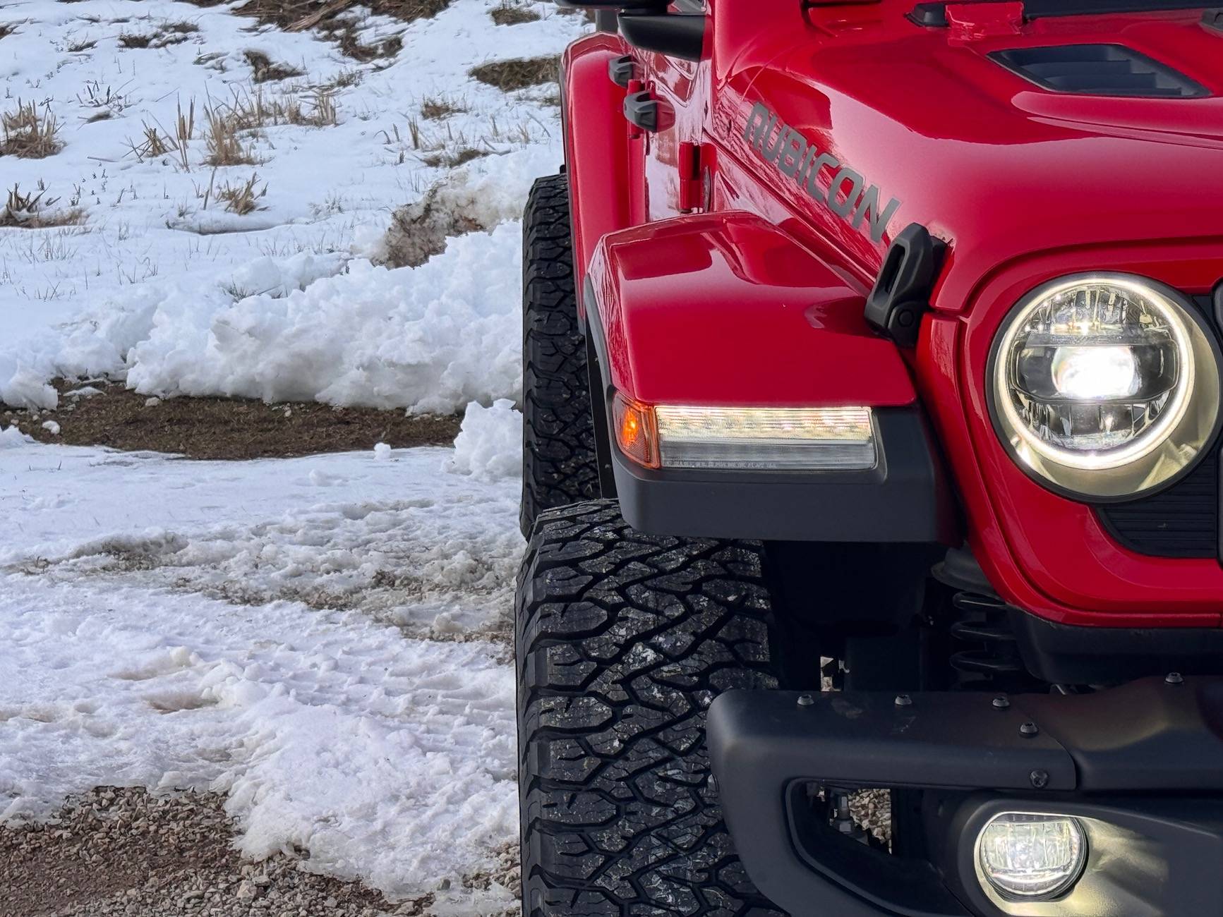

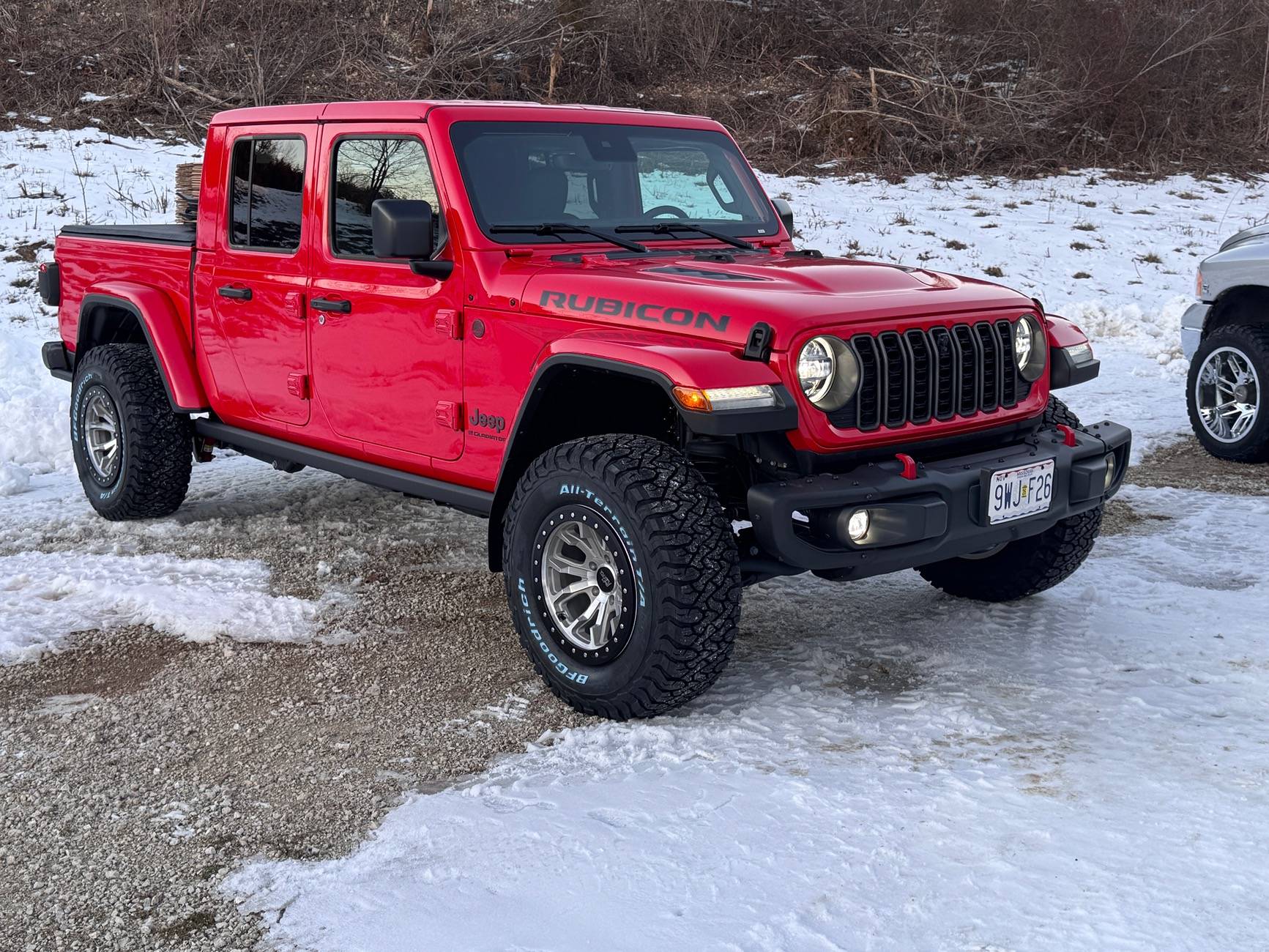

Jeep Gladiator What is the Oem wheel backspacing/offset?? IMG_0844
Jeep Gladiator What is the Oem wheel backspacing/offset?? IMG_0847
Well, I got the new tire and wheel set up on. It looks as expected and no where near rubbing anywhere. I think though I want to get the beadlock rings. Not that I want nor need the beadlocks but the simulator is really thick and can see the wheel behind the simulator. In total it’s probably .75” out from the tire. Posting for future onlookers that are curious as I was. 285/70-17 on a 17x9 with 3.5” backspacing (-38mm offset)
