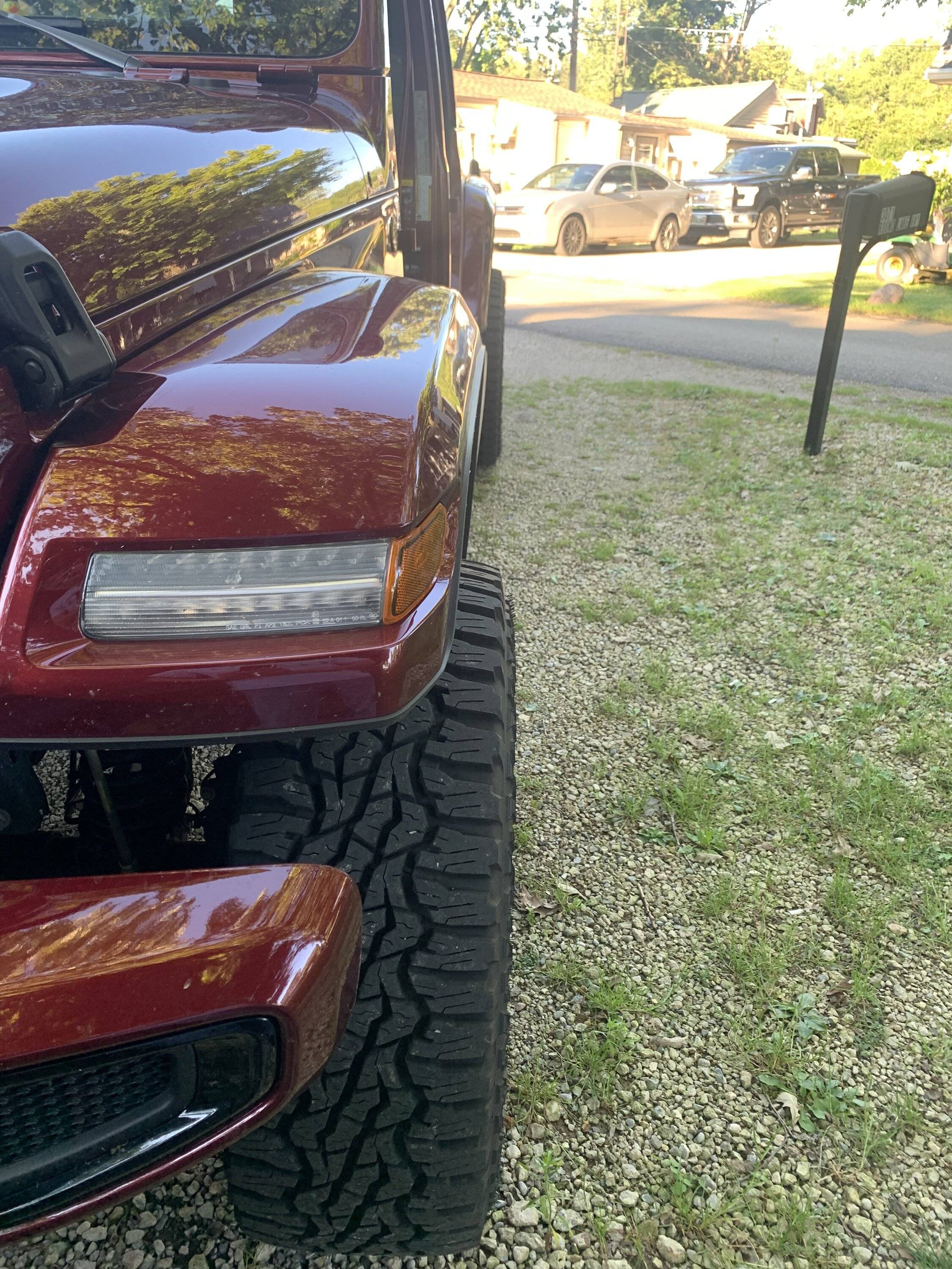

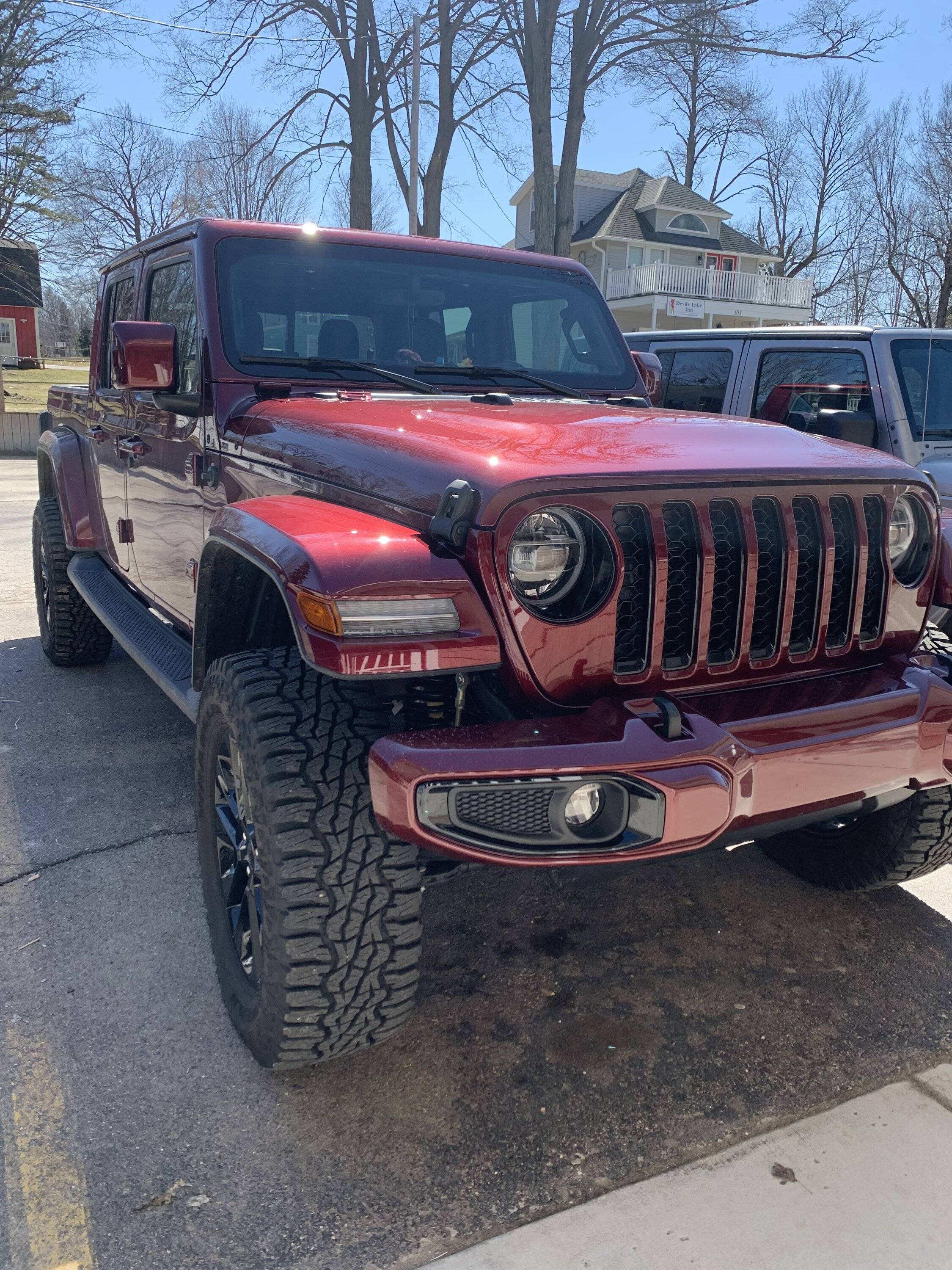

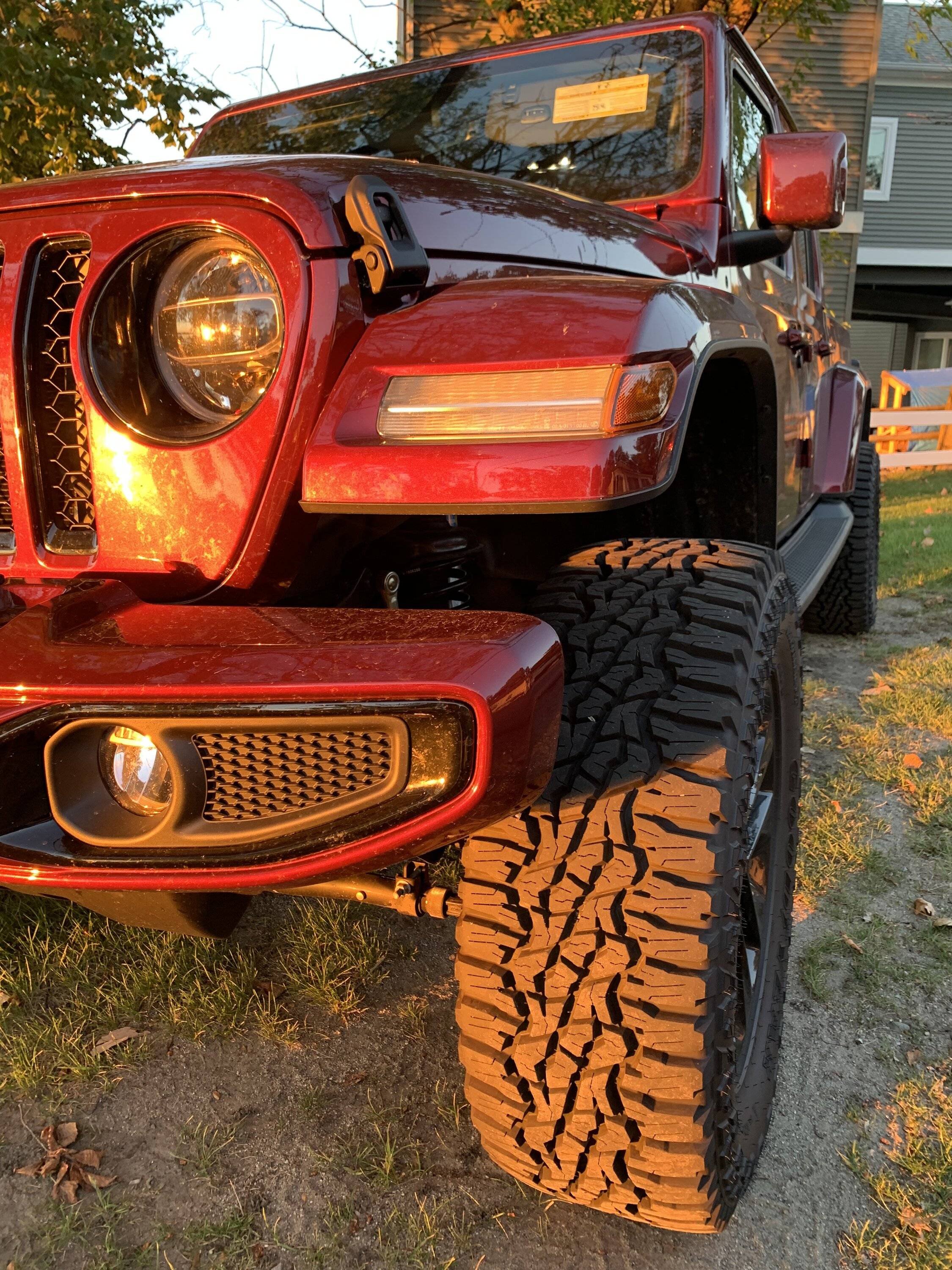

I have 8” wide wheels with wheel spacers that make them equivalent to +6 offset. I also have wide axles. And 12.50 wide tires.
So would a 7” wheel with a 1/34” spacer be less poke?
Wheelin98TJ
Ryan
Jul 27, 2021
3,904
4,623
Devils Lake, MI
2021 Jeep Gladiator
Bean Counter
Stock wheel? I think they are all 7.5” except the ones I have.
If so, it would have about the same amount of poke.
I have 1.5” wheel spacers.
