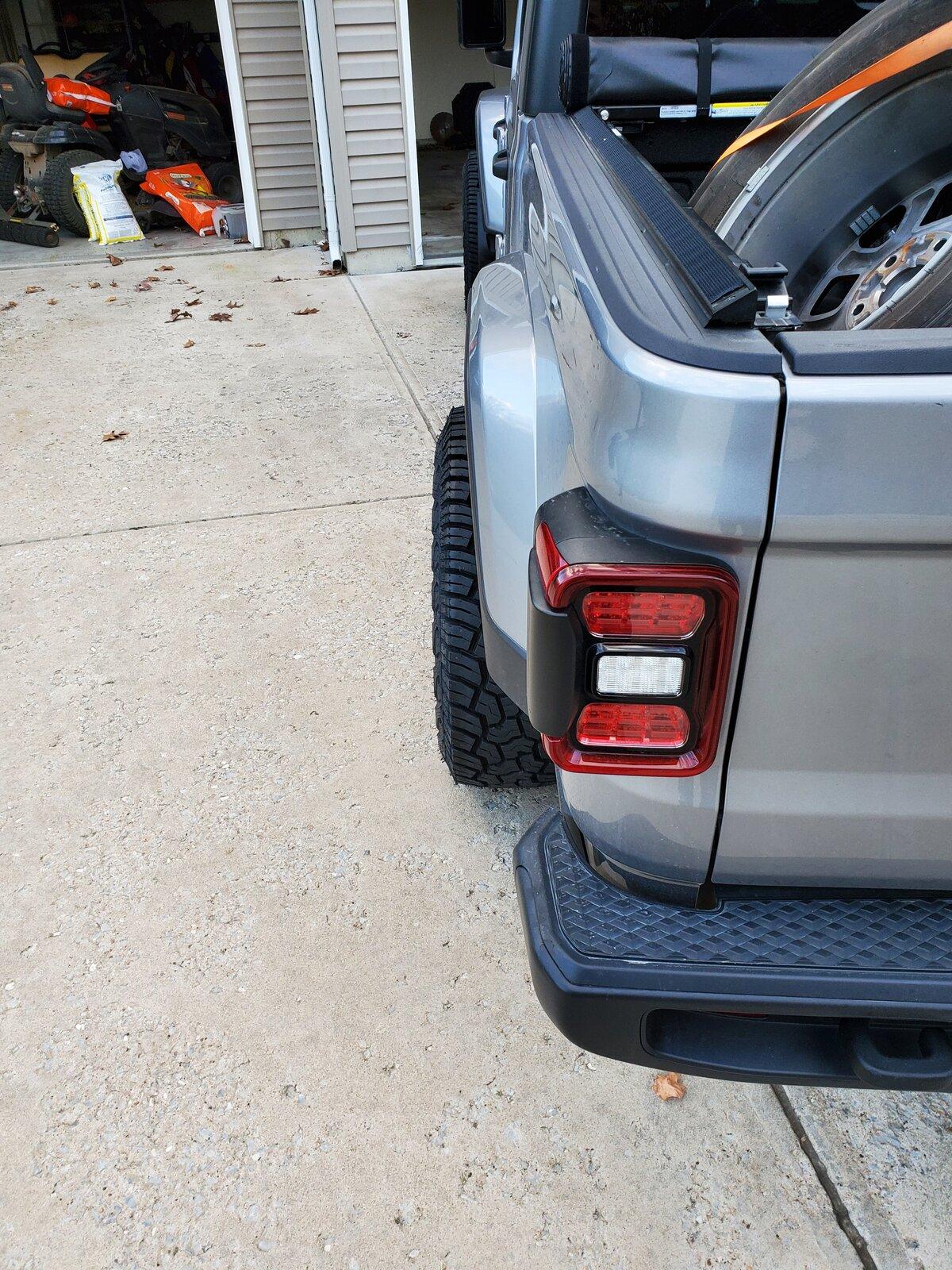

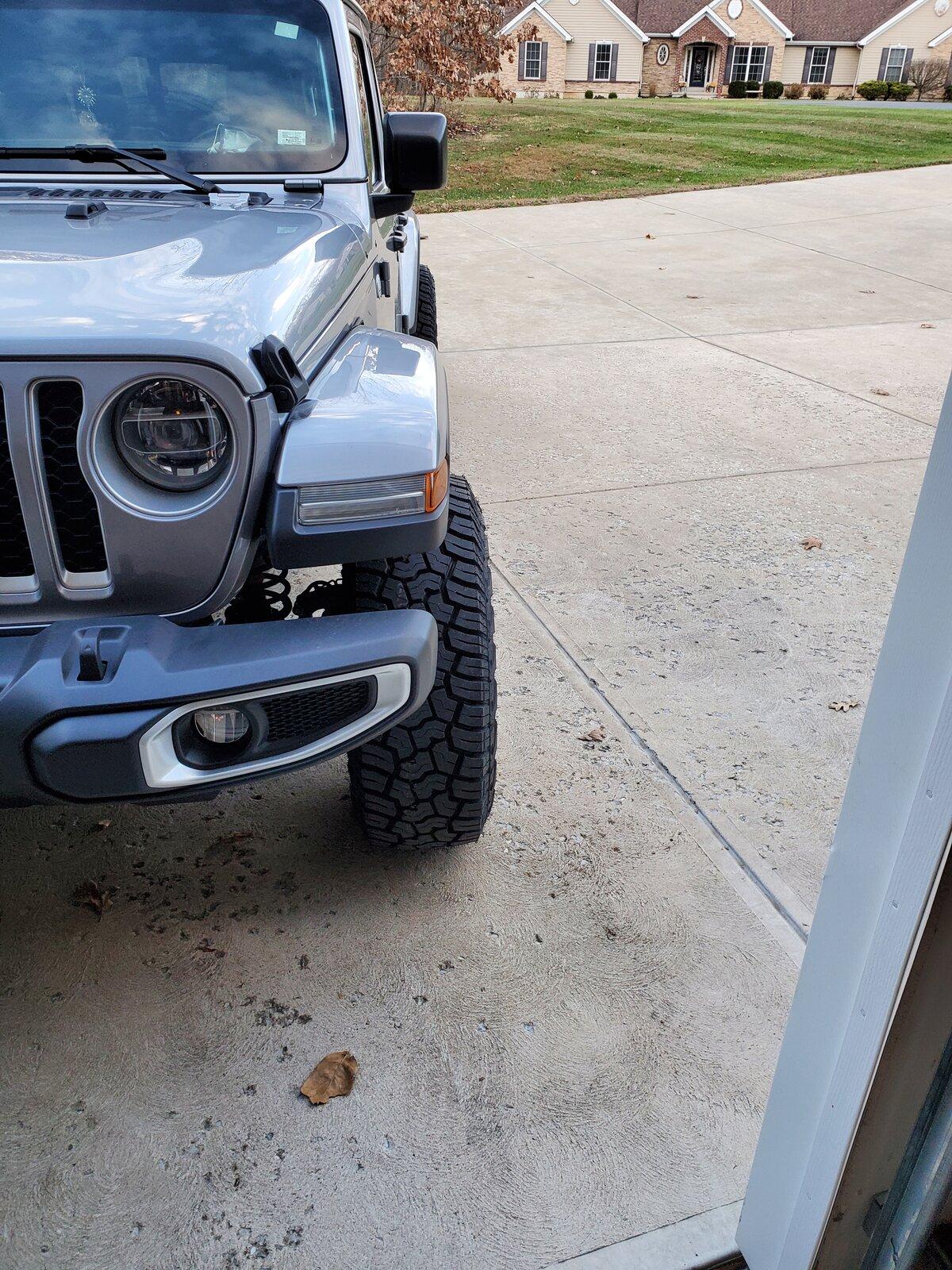

Great info! Looking at a 17x9 with 4.5 BS and -12mm or a 17x9 with 5.0 BS and +1mm. Hard to decide!
That is a -12 17x9 4.5bs, 285 tire width. For me personally I would've liked closer to 0 offset but the deal on the wheels was too good to pass over a half inch. Now I just need to do a bit of lift for it to look better IMO, oh well, could have worse problems lol.

Thanks for the pics. So would the 5.00 BS with a -12 offset stick out more or less than that with the 4.5 BS?

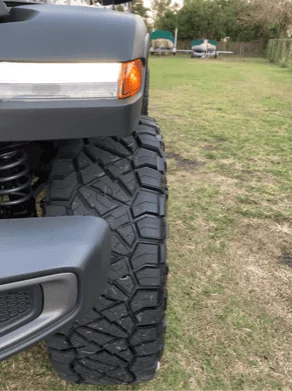

the -12 offset wheel will stick out a 1/2" more. Silverslayer has a 11.5" wide tire on a -12mm offset wheel. I have a 12mm offset wheel with a 12.5" tire. Here is the math on my situation: factory wheel 37mm offset with 11.5" tire: equal with edge of fender. New wheel 12mm offset with 12.5" tire. 37mm - 12mm=25mm or .98" going out from wheel. 12.5"-11.5"=1" for tire. 1" divided by 2 = .5"; .5" on inside; .5" on outside for the wider tire. So, .5 (tire) + .98 (wheel) = 1.48" further out than factory. Look at the picture, about 1.48" out past the fender.

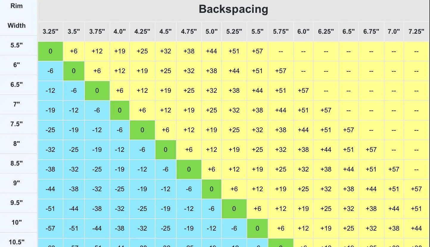

Just use a simple online calculator to convert between backspacing and offset. There are a few online like this one: wheel offset backspace calculator
Backspacing is easier for most to visualize. More backspace means the wheel moves inward towards the frame.
Offset is more commonly used nowadays. A higher value offset moves the wheel inward towards the frame. Positive offset wheels have more backspace than negative offset wheels.
