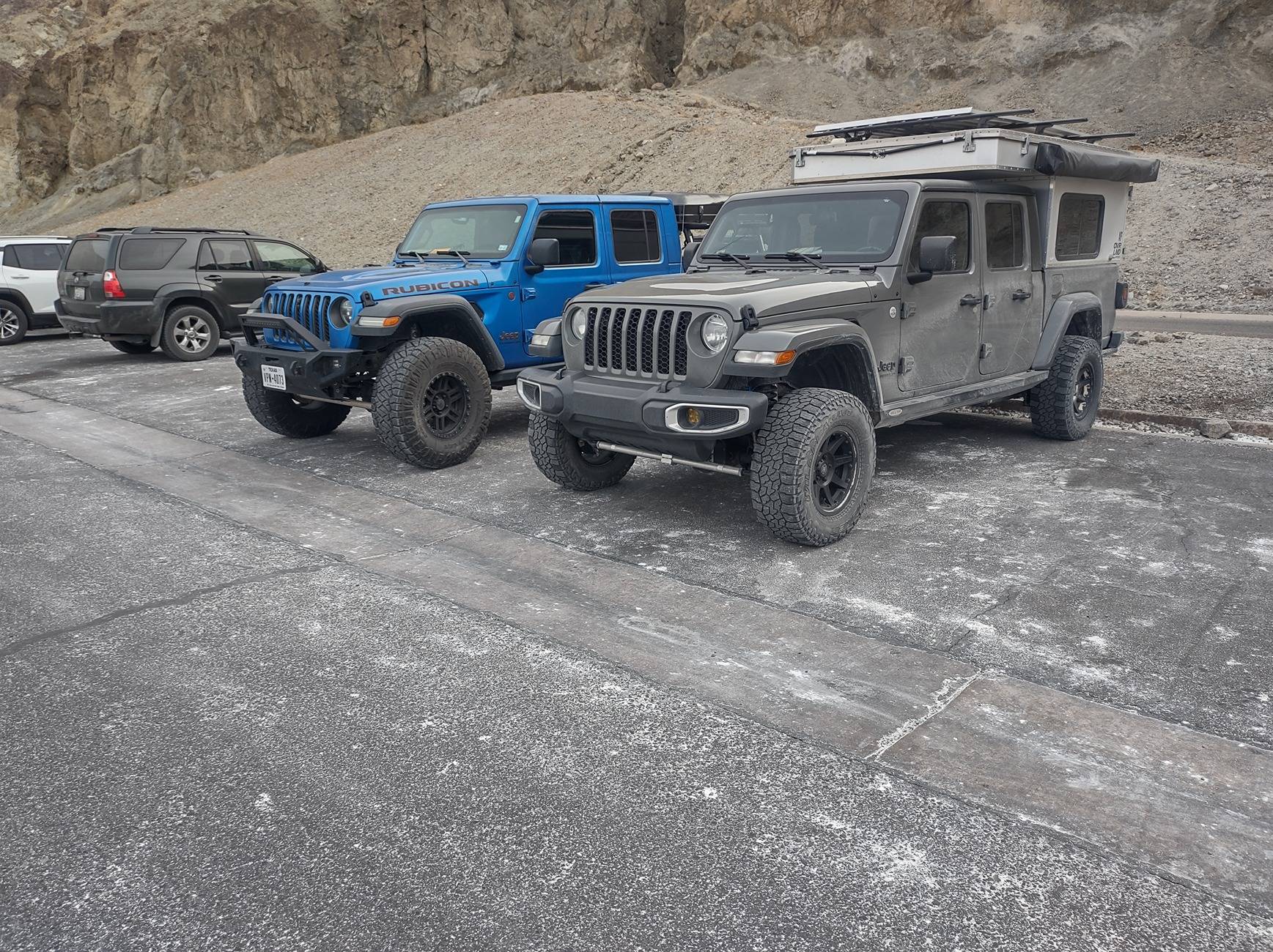

I have max tow and cast iron knuckles. Shouldn’t be a problem with-18 offset, right?
It won't be a problem. Just be aware your tires are going to stick out about 1.25" more than Free2roam's pictured here that has narrower axles and -12 offset.
