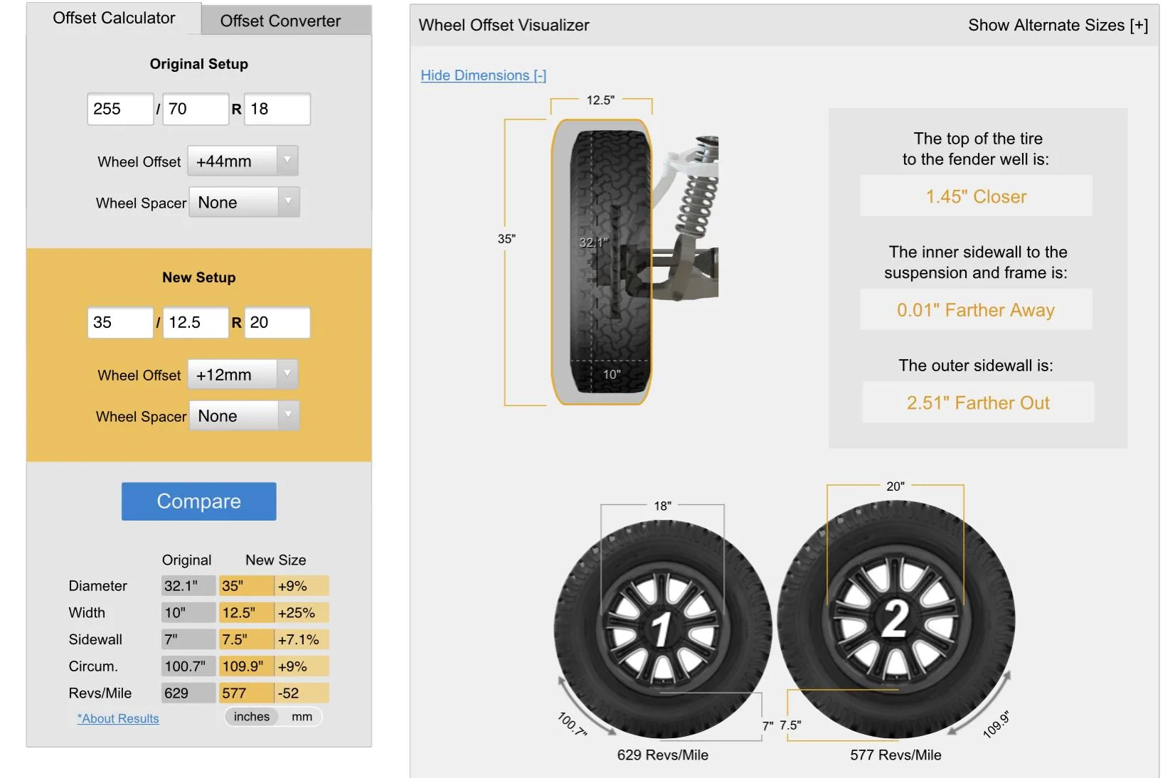

Like the look of a little dish to a wheel as well as a little outside the fender. At the same time, for practical (and legal) reasons I didn’t want to go crazy with it. After hours on the calculators I came up with a 9” wheel with 12.5 tires and a +12 which gave me a near identical back space. Because of the wider rim and tire, it will still stick out a little.
Problem is: almost all my image searches here, custom offsets, trailbuilt, extreme terrain and any other show what seems as the MAJORITY with 0 to typically minus 6 up to maybe -12. Then there are outliers at -24 to -44. Now I’m second guessing my purchase (which hasn’t arrived yet.) I prefer the look of the negative offset (to a certain extent) but don’t want to get crazy outside the fender. Anyone have any pics for comparison of positive offset wheels? They seem to be few and far between.

I think the +12 at 9" wheel is going to give you exactly what you want. I didn't want Poke and went AEV +25 8.5" wheel. It will look very close to stock. (that's with Rubicon which i believe has a bit wider axle). I don't have them installed yet so no picks sorry.

Search for AEV Savegre IIs or some of AEV’s other wheels, they are +25

Thank you. It’s surprising how few images you can find of positive offset setups. I’ve probably seen hundreds in trying to pick a wheel and have come across a small handful at best that wasn’t negative offset.
