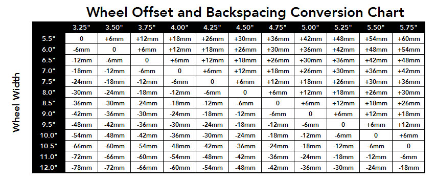

Here's an offset/backspace reference chart for quick reference:
Jeep Gladiator Backspace and Offset | How do they relate? 1595087108448
