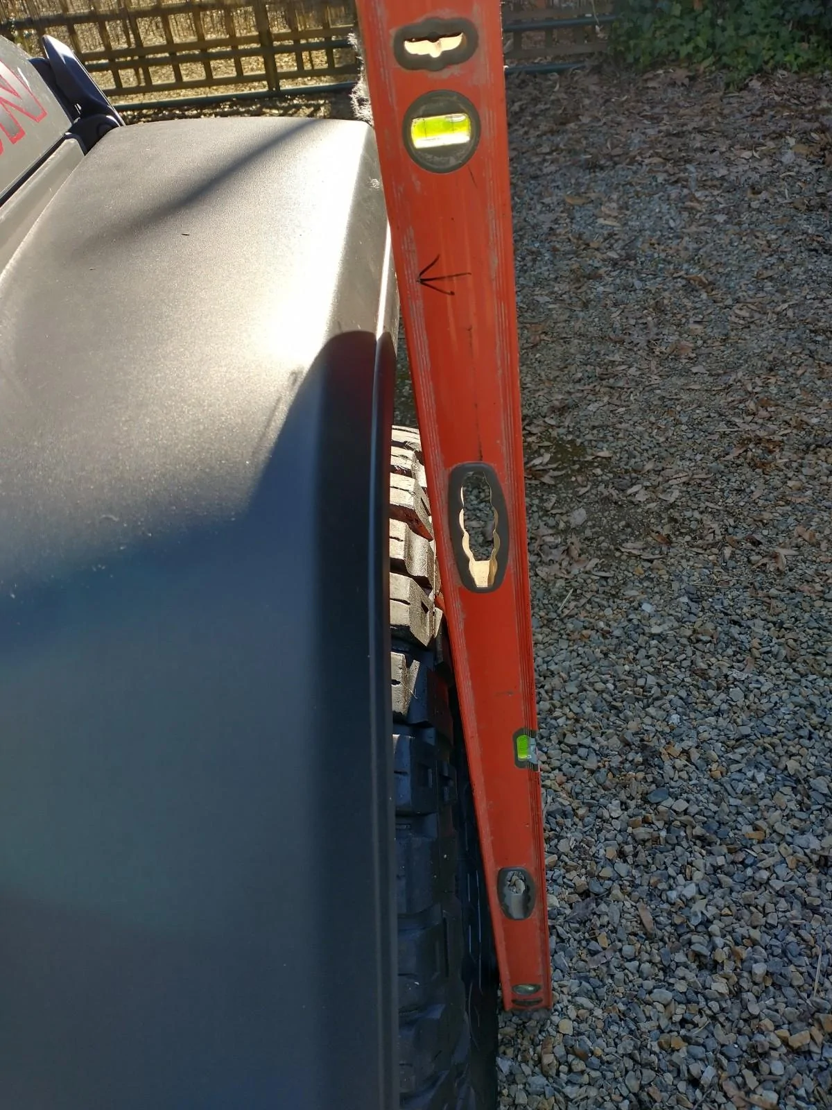

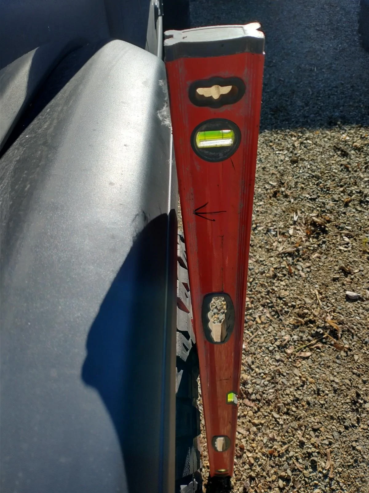

35x12.5/17 Nitto Trail Grappler on stock Rubicon wheels (+44.45 offset),<1/4 inch poke from sidewall lugs. Tread (aka: where the rubber meets the road), no poke.
