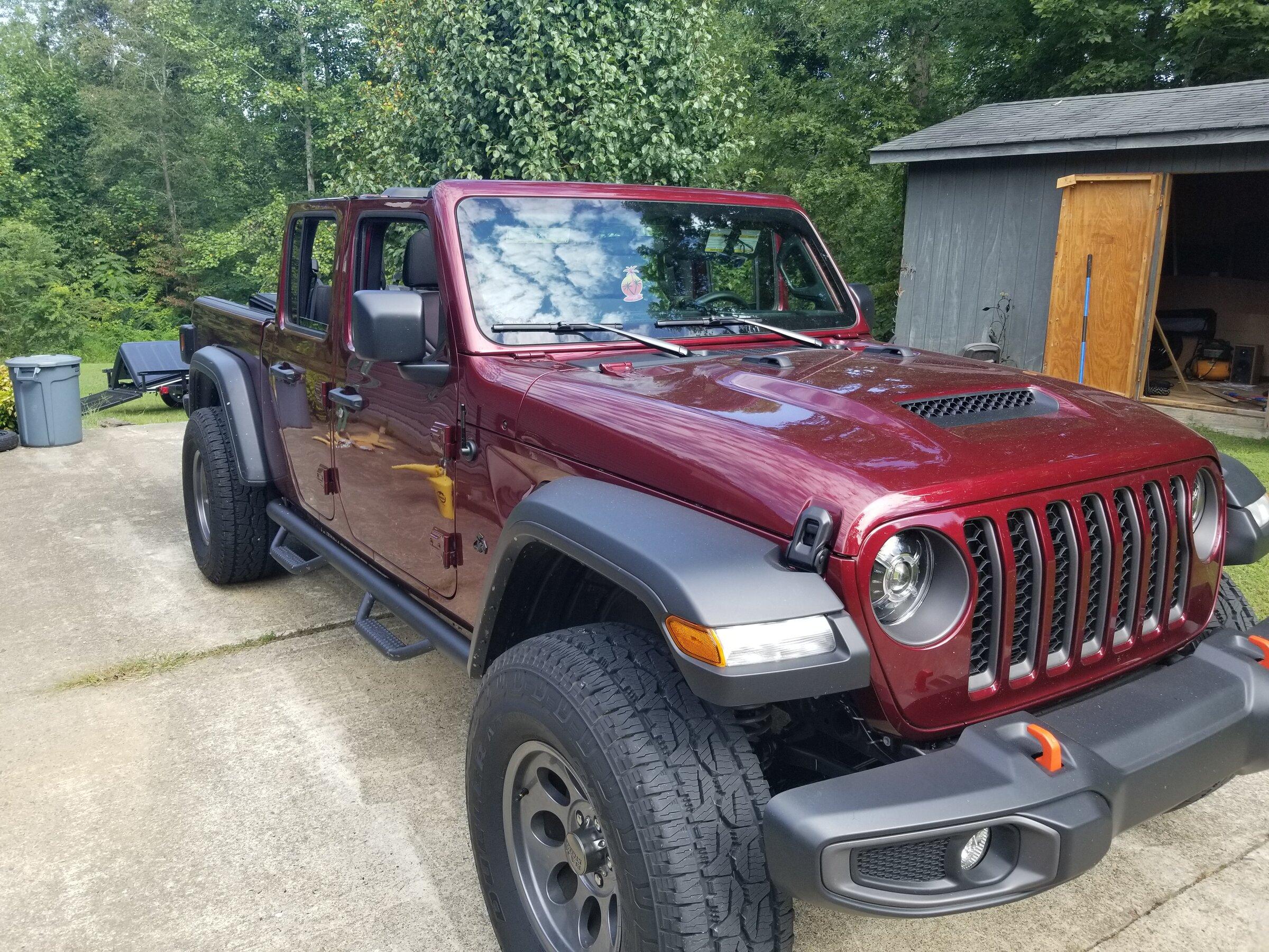

unsocbl
James
Aug 8, 2020
439
861
Charlotte TN
2021 Gladiator Willys Eco-diesel

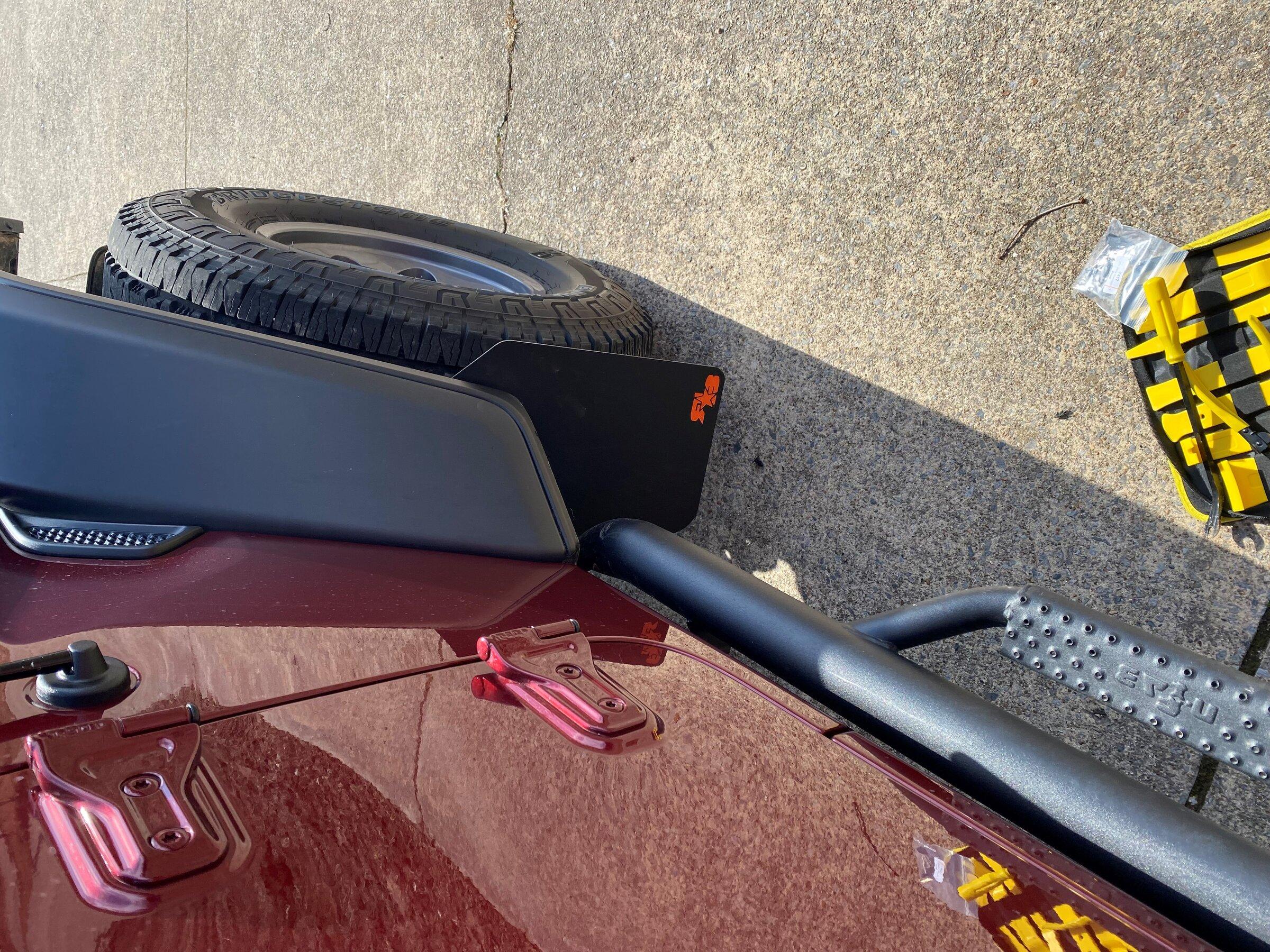

I have the Quadratec Baja Xtreme (4.75) and 315-70/17 tires...they stick out way too much (about 2")
Jeep Gladiator Rubicon backspace= 6.0"/+44 offset? 20210829_095501
. Just added a set of Roblokz and will see if that helps the messs they make:
Jeep Gladiator Rubicon backspace= 6.0"/+44 offset? rokblokz

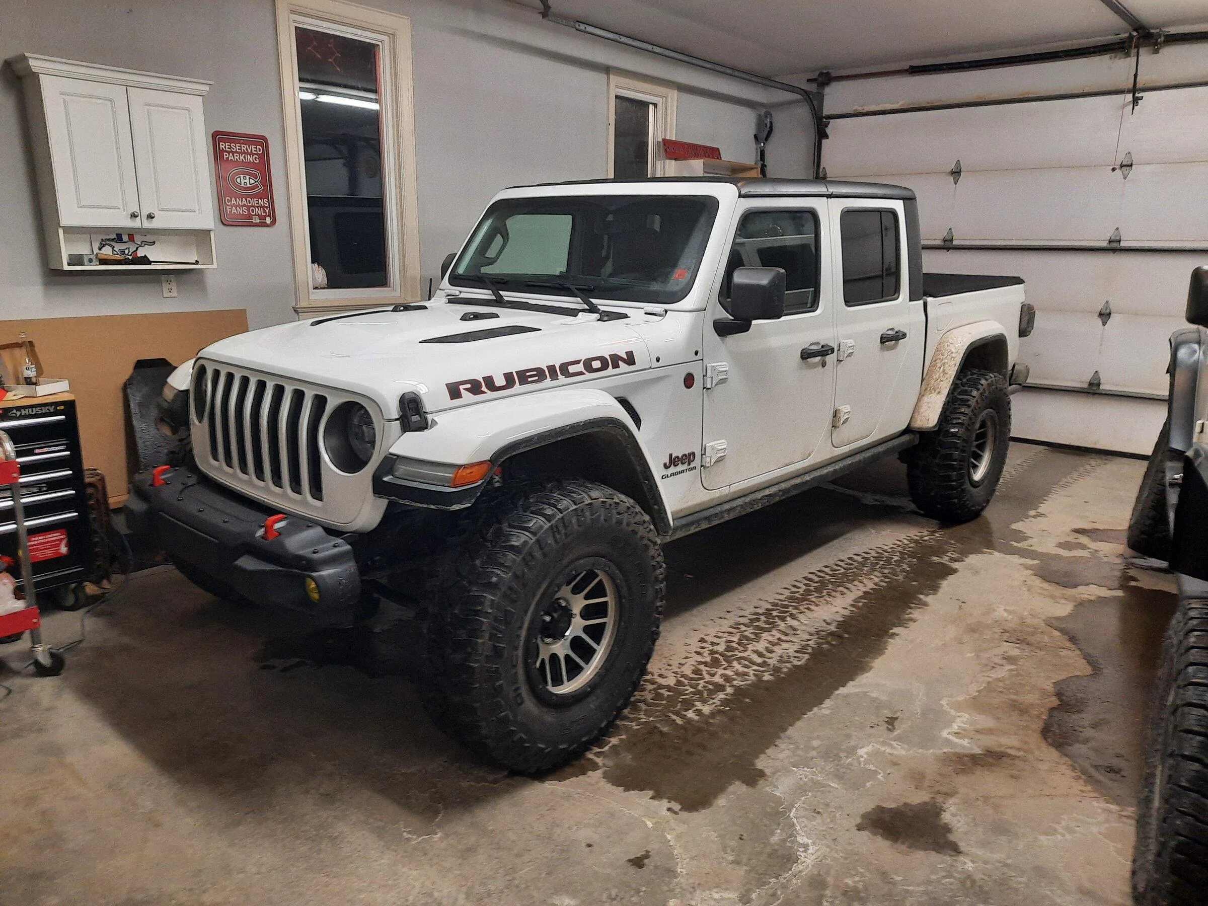

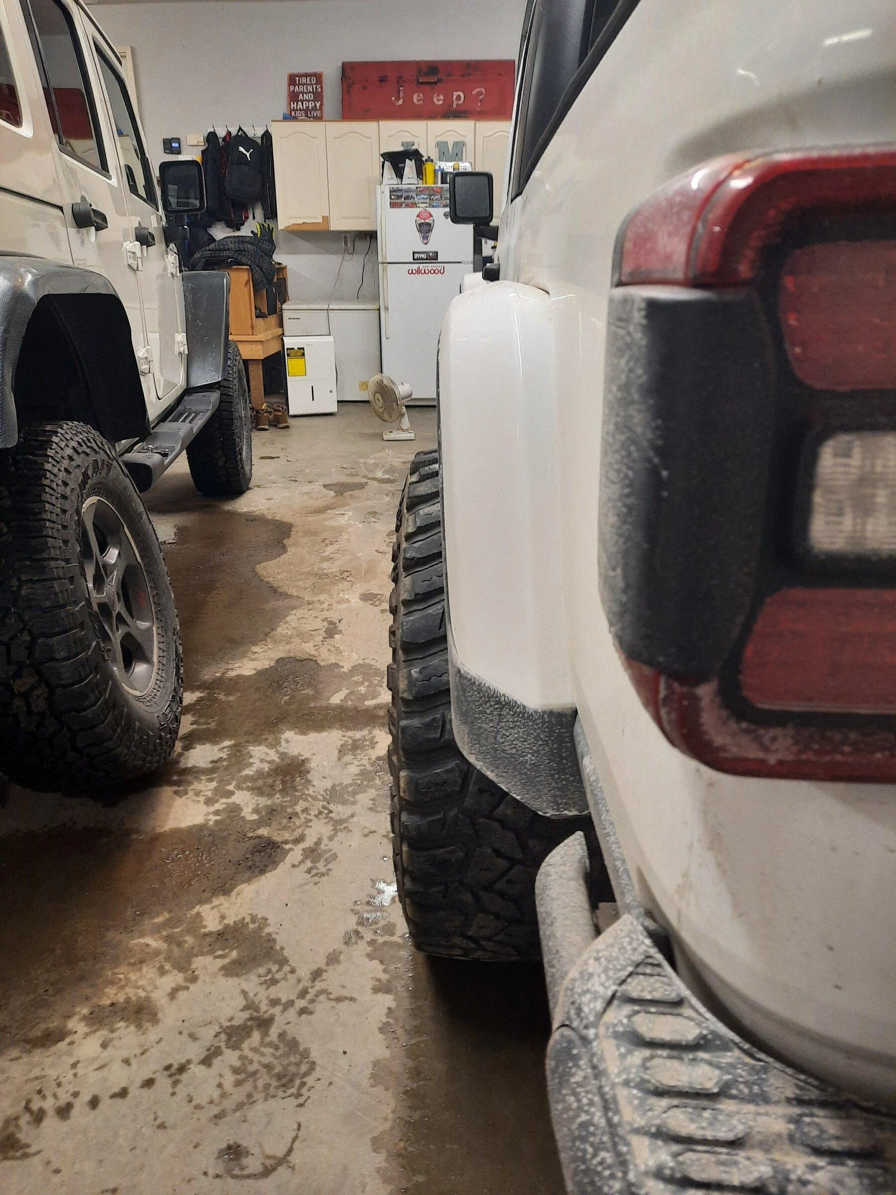

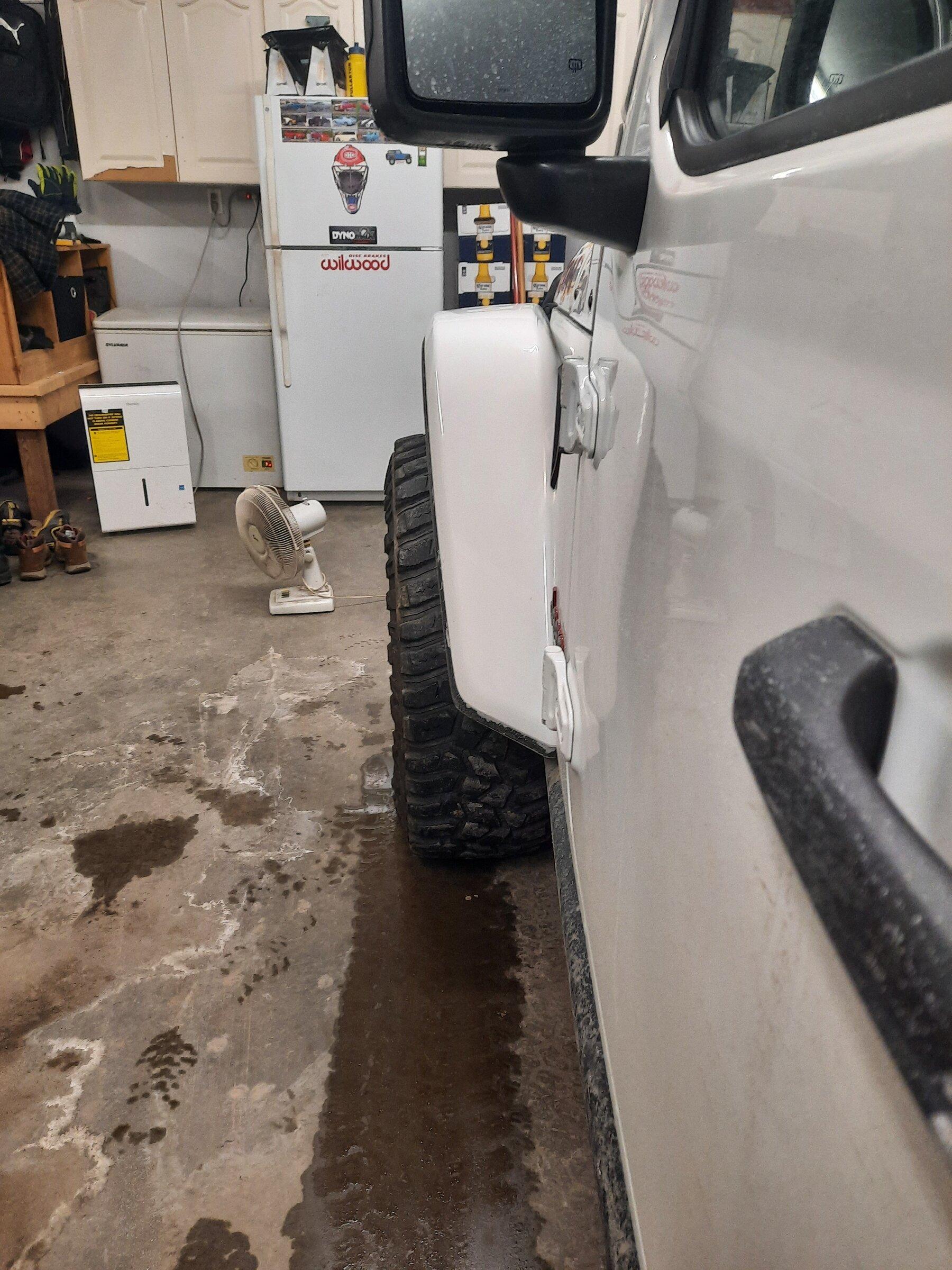

In my opinion, 17x9 4.75bs stick out too far with the wide track axles. I'll be looking for something with a positive offset.
Jeep Gladiator Rubicon backspace= 6.0"/+44 offset? 20220122_175739
Jeep Gladiator Rubicon backspace= 6.0"/+44 offset? 20220122_175732
Jeep Gladiator Rubicon backspace= 6.0"/+44 offset? 20220122_183249
