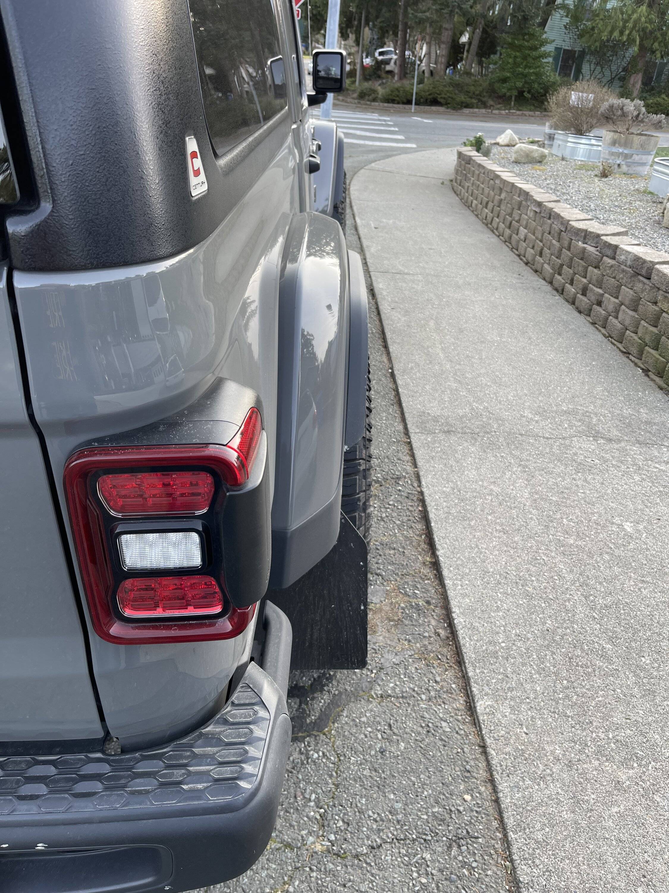

0 offset. Will likely want flare extensions and mudflaps. But they tuck/articulate nicely into the fender. Will need minimal bump stops 1/2” front and rear is conservative if you have a tall 37” tire. (Diesel has longer front bump stop jousts than gas…)

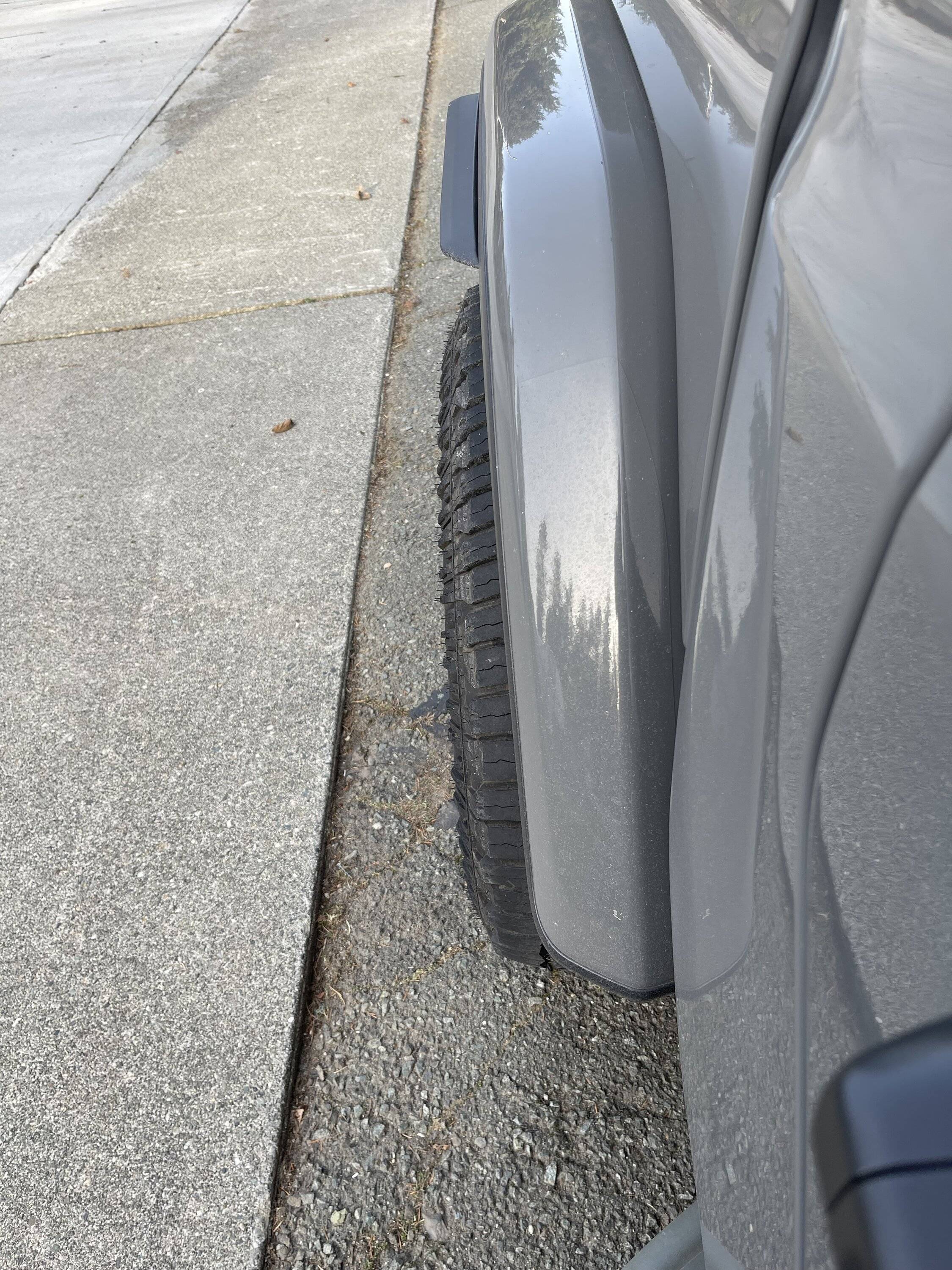

What if I want a little “poke” so there is a little more aggressive stance?
Just a point of reference - not sure what you would consider a little poke, but this should give you an idea on what 0 offset looks like with 37" KO2s (I'd consider that a little poke, but ymmv).
