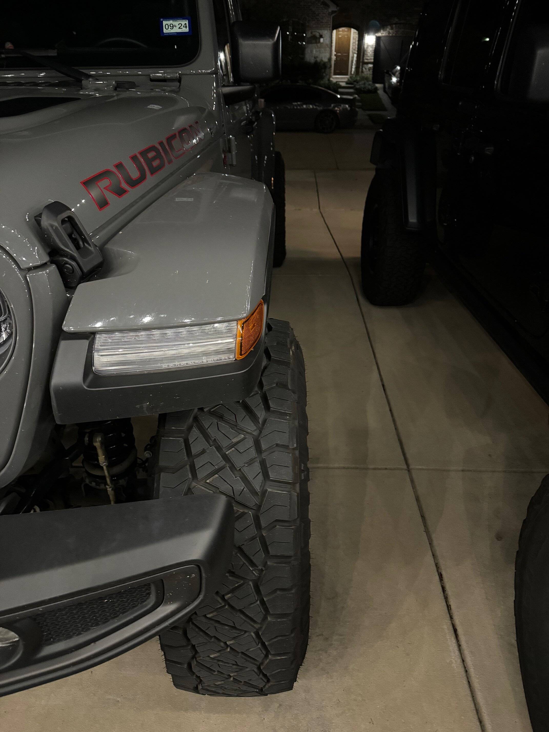

Ended up going 38x12.50r17 on a Clayton 2.5” lift
The bigger you go with tire size the further out they need to stick to clear while turning. I’ve got 17x9” +1 offset wheels and it’s really pushing the clearances. I probably should have gone 17x9 -12
how much wheel poke do you have?

Still an inch or two with the +1 offset, was as tucked as I could do though
I’ve decided to go -12 with 37x12.5x17 tires
I’m putting on a 3-1/2 in Clayton overland plus lift
Nice! Here’s the poke on the +1 offset with a 38x12.50
Thanks,
I like that amount of wheel poke!!!!

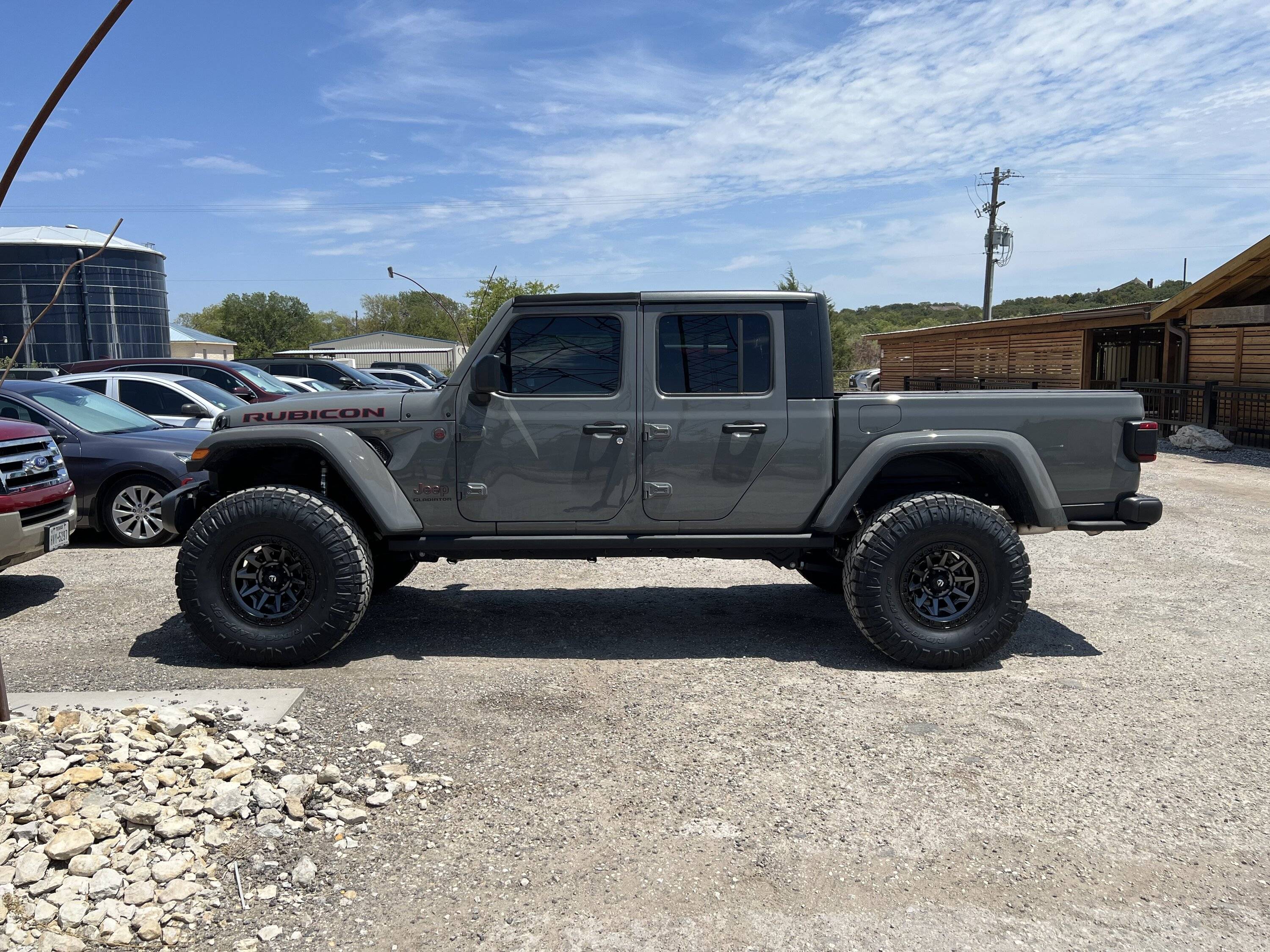

Do you have a pic with it straight on to show offset?
Not sure if this helps you, but I have the Clayton 2.5" Overland plus lift, KMC 17x9 -12mm wheels and Baja Boss A/T 37-12.5R17 tires ... the last picture in this post shows a bit of what poke I have (look to the rear wheel to see this) .. note that I do have 2" fender extensions. I can try to get more pictures if you want them. Gobicon Build Log
