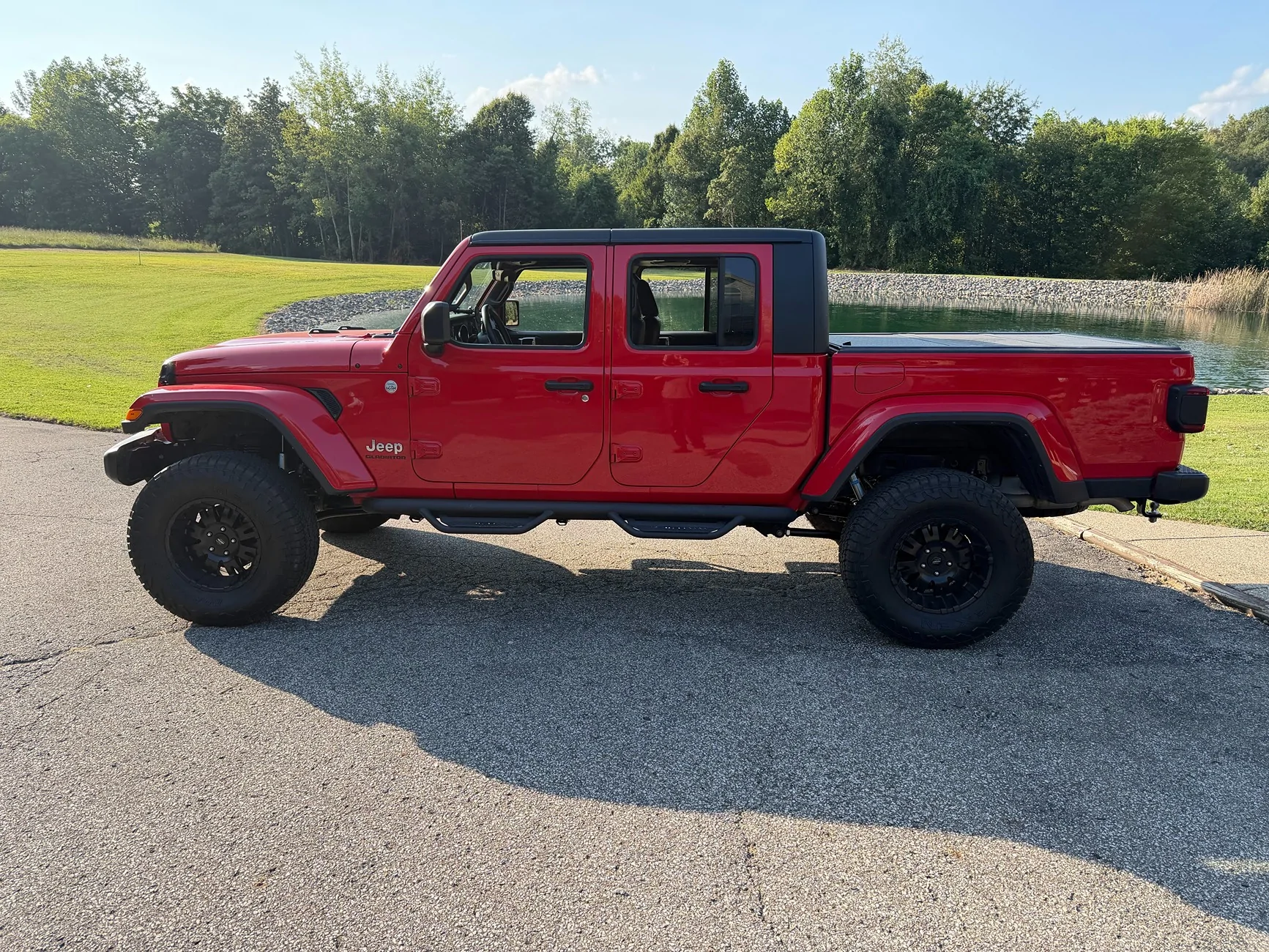

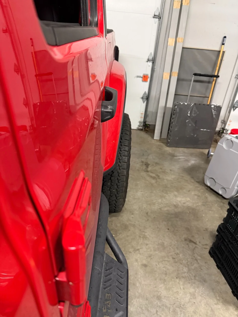

Got this JT secondhand with a hodgepodge lift. Just replaced all suspension components with Rock Krawler with a triangulated 4 link (super cool) and now it's time to work on tires/wheels. Not of fan of how these look. I've always liked the way factory wheels look.
I want to go to a 35x11.50 vs the 35x12.50 that's on there now.
Can the factory wheel support a 35x11.50 without rubbing?
If not, what wheel backspacing should I be looking for? What's on there is an ET-6 17x9.0J

Help me understand backspacing... these wheels at -6mm / factory wheels are +44.
If I only changed the wheels and kept these tires, the tire would be 50mm more inboard?
