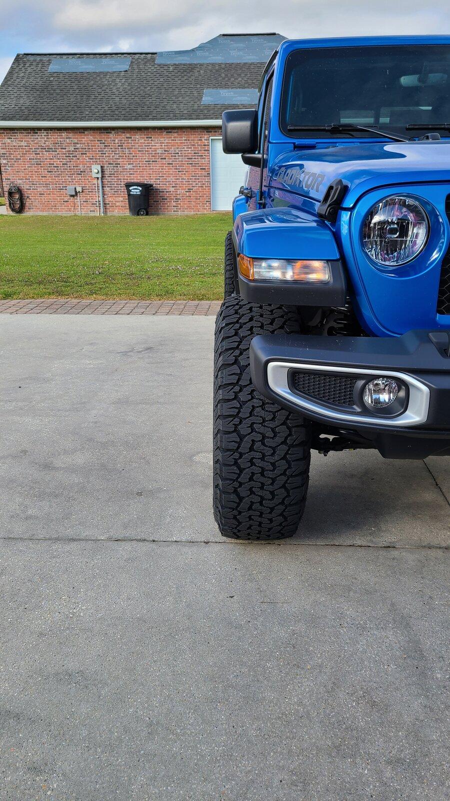

Well, I did 0 offset which pushed the wheels out by I think 1.7" or so. I didn't want the bro dozer look or rocks/mud slinging all over the side.....but I should've went positive offset to pull them in a bit more.... like a 12mm would've been perfect on my spoet s diesels regular width axels. 17x8.5" wheel and 12.5" wide 37.

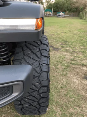

I hope these are going on a Rubicon or Mojave without a lift. Either way, I went with a 17x9 wheel with -12 offset. They pushed the tires out about 1.5in outside of the fenders. I went with 35x12.50 Factory wheels are +44 for reference.

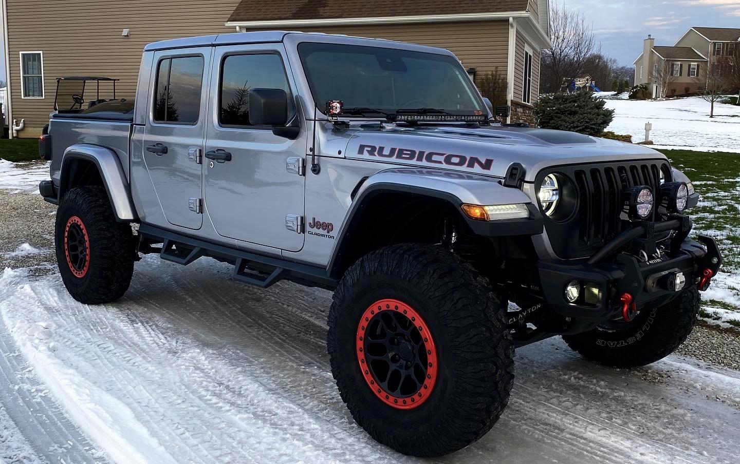

I bought mine from Trailbuilt. After shopping around it ended up being the best deal for my combination considering they came mounted/balanced ready to go. My wheels are 17x9 -12mm offset. Tire 12.50.

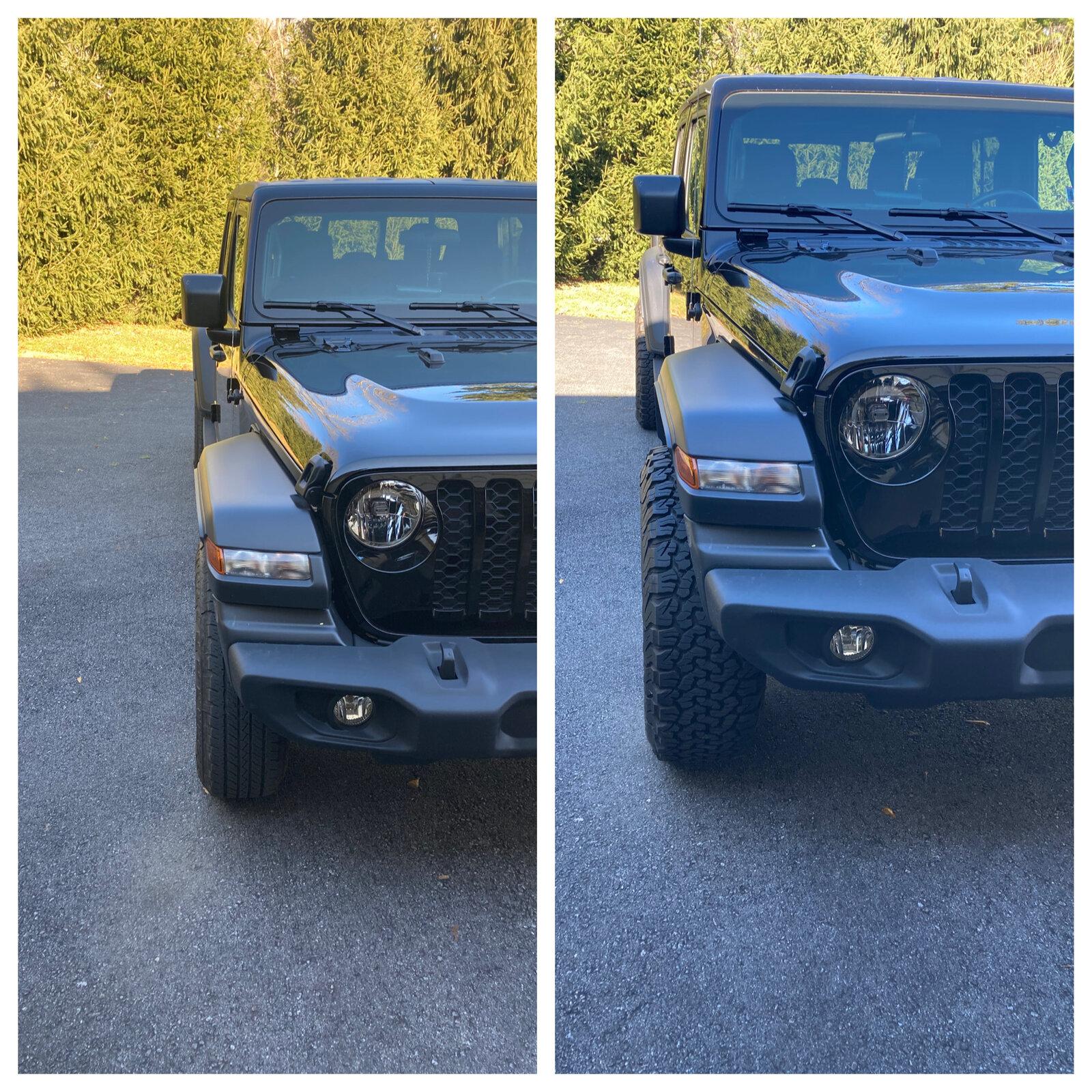

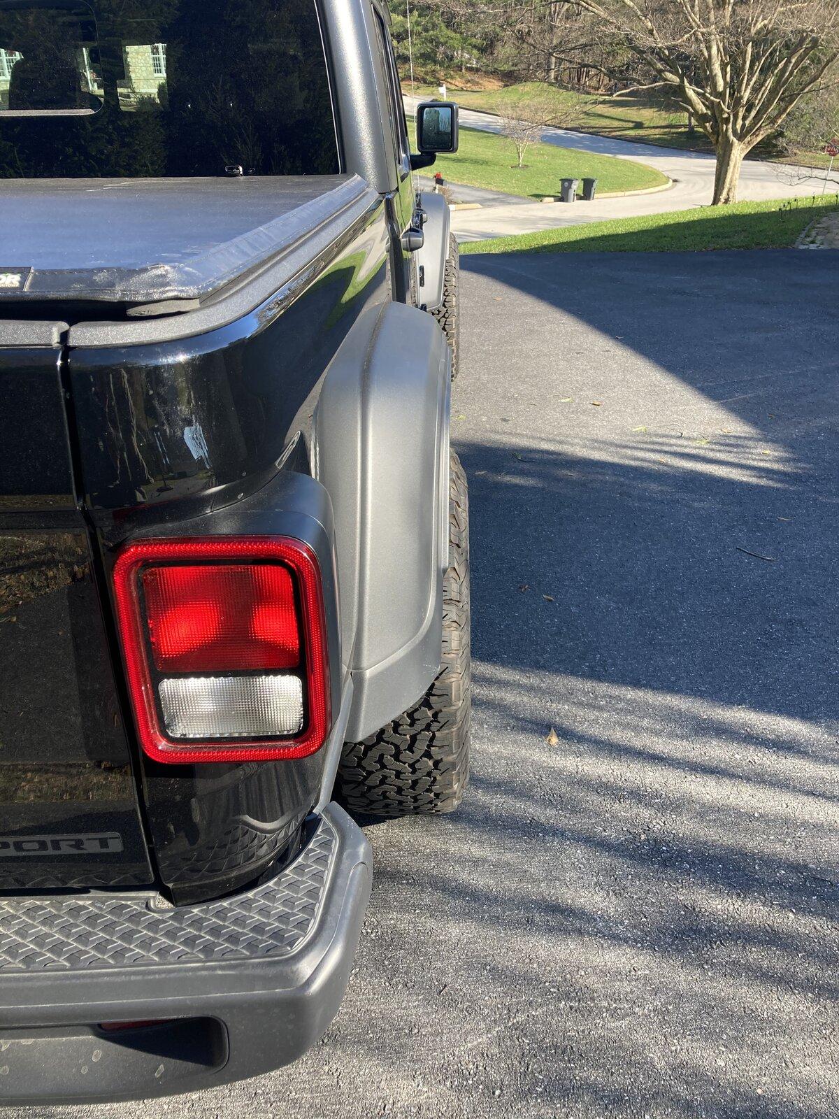

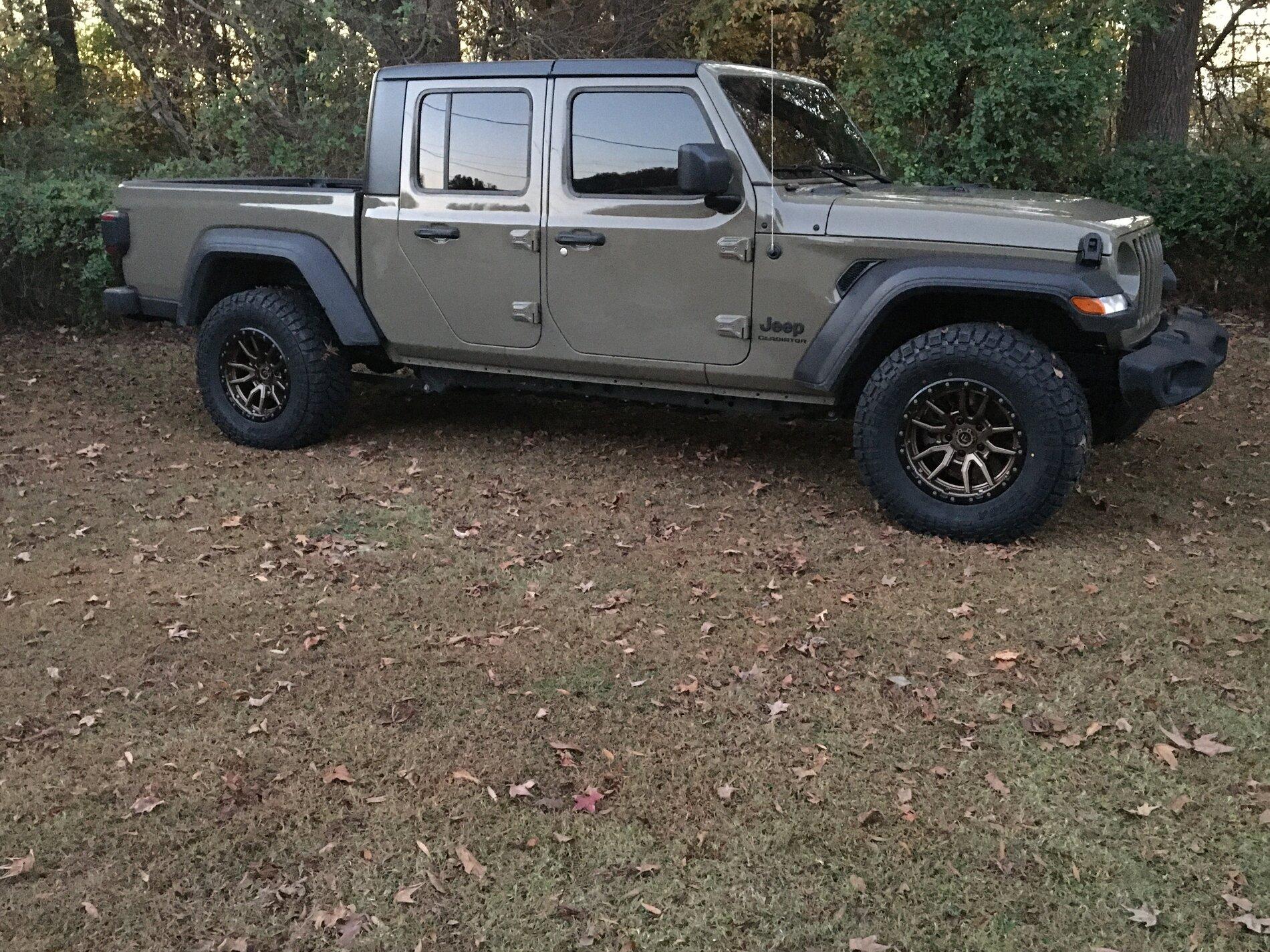

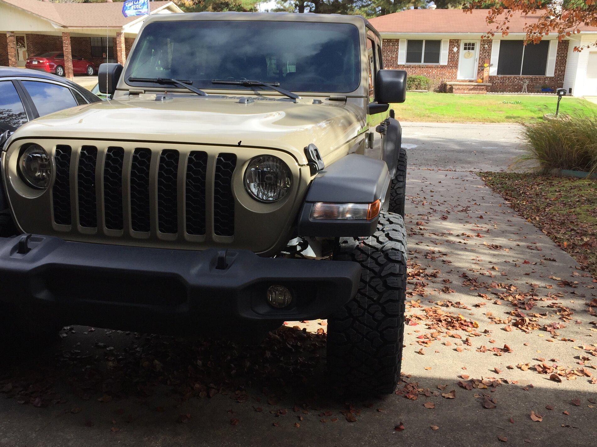

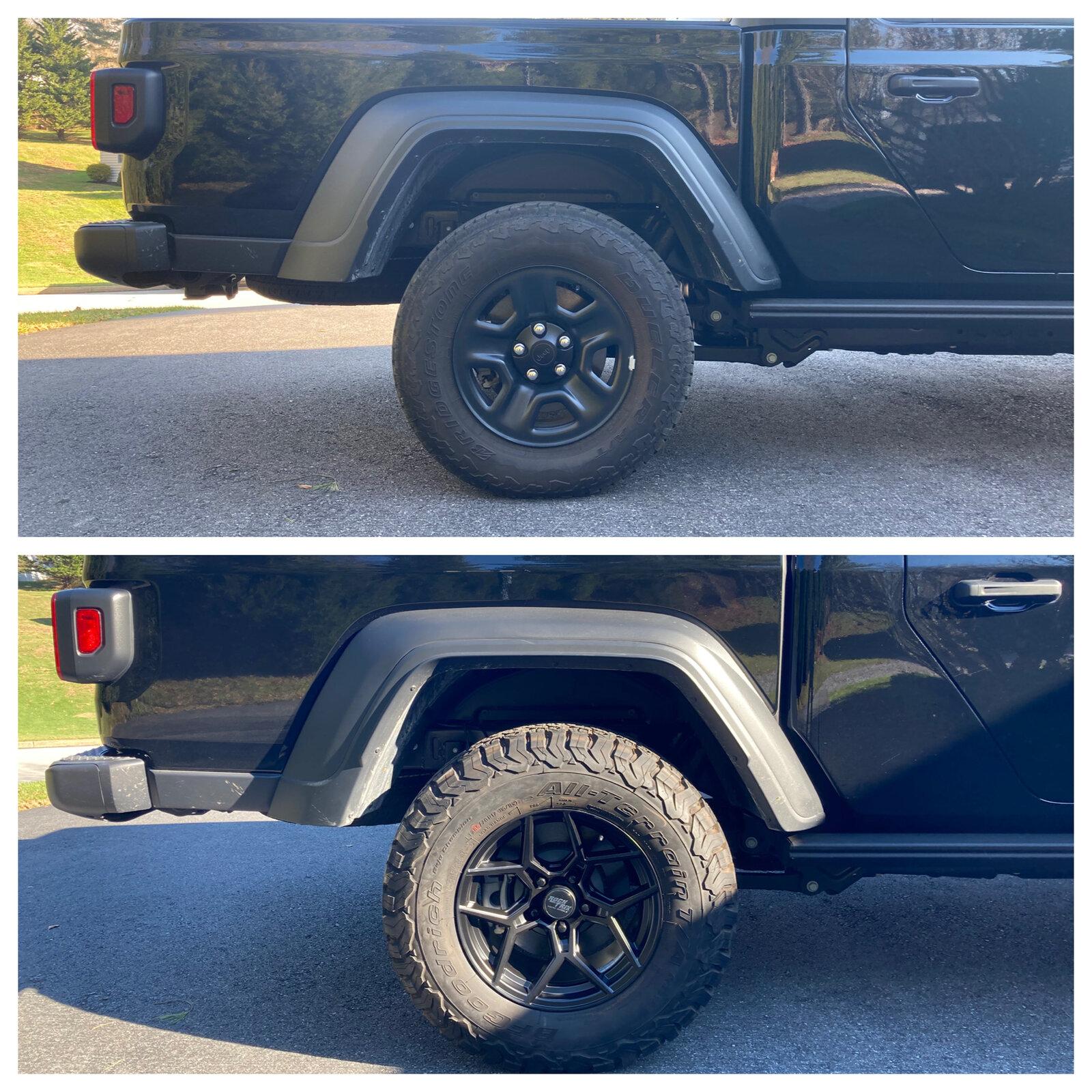

I shopped around quite a bit and ended up with the Rocktrix RT 105.
I chose the +12mm offset (5.5” backspace).
I ended up putting 285/70/17 KO2’s on them and it ended up being a great fit for me. I did not want them to stick out very much.
(below are some before/after shots)
The Jeep is a Max tow, 4.10 gear, wide Dana 44 axles, etc.

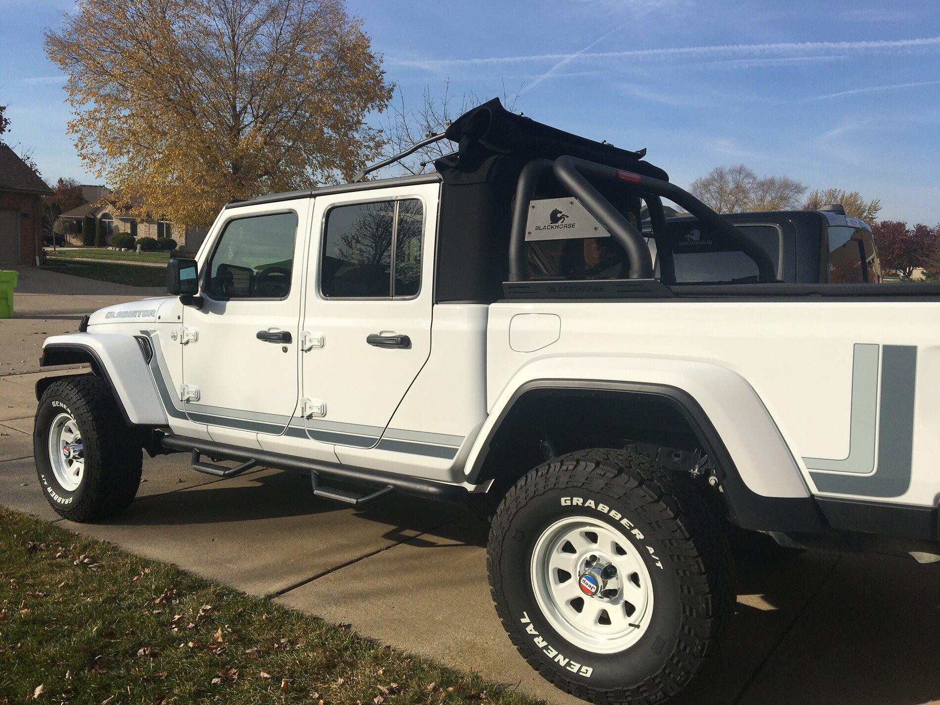

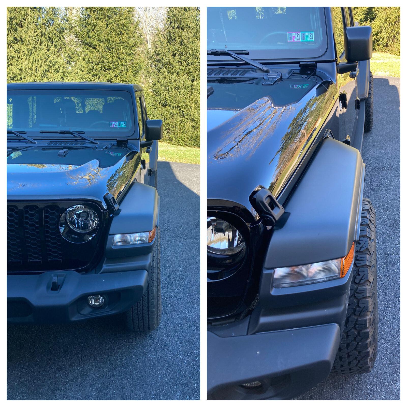

Quadratech 17x8.5 with 5.2" backspacing
