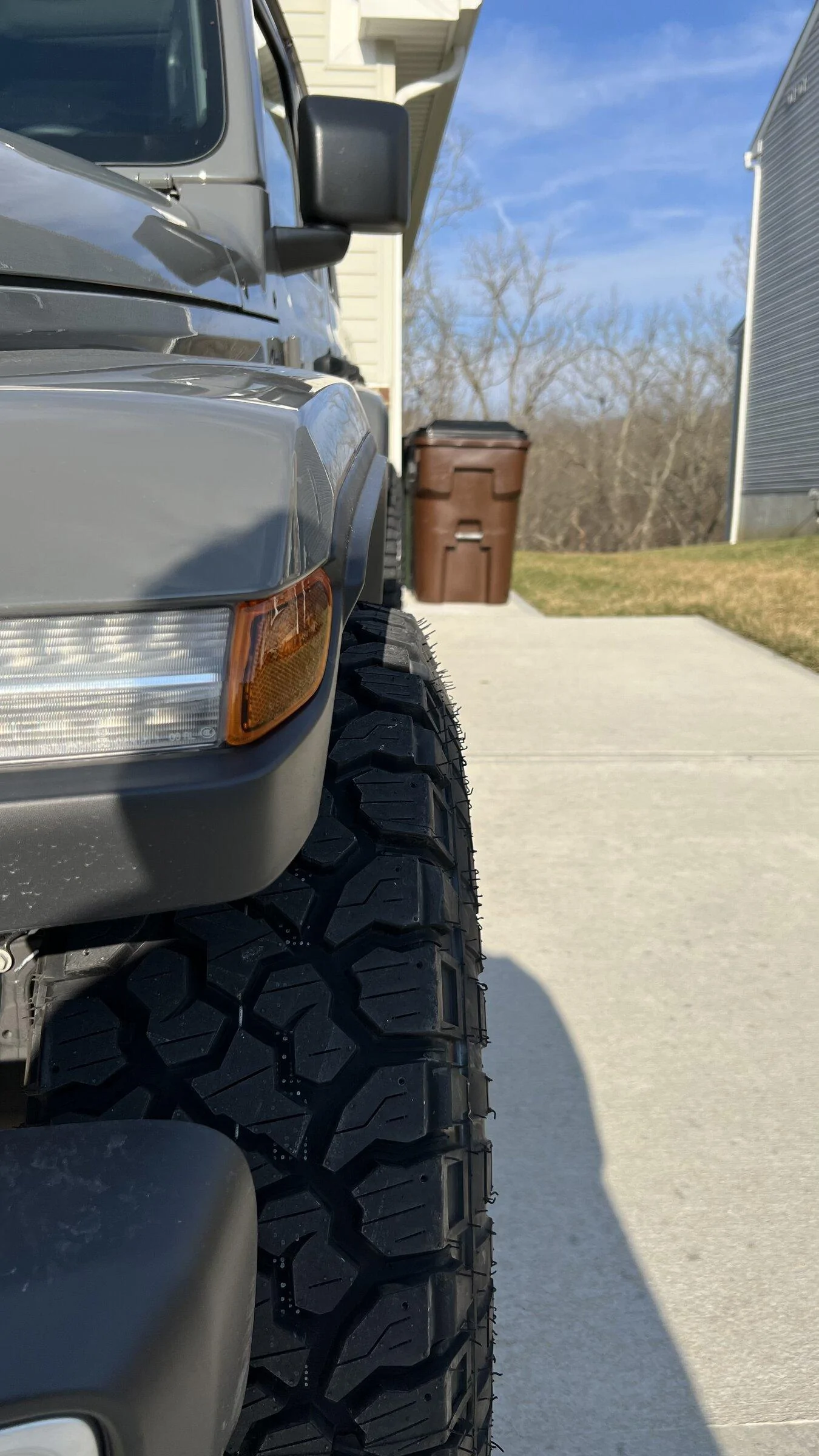

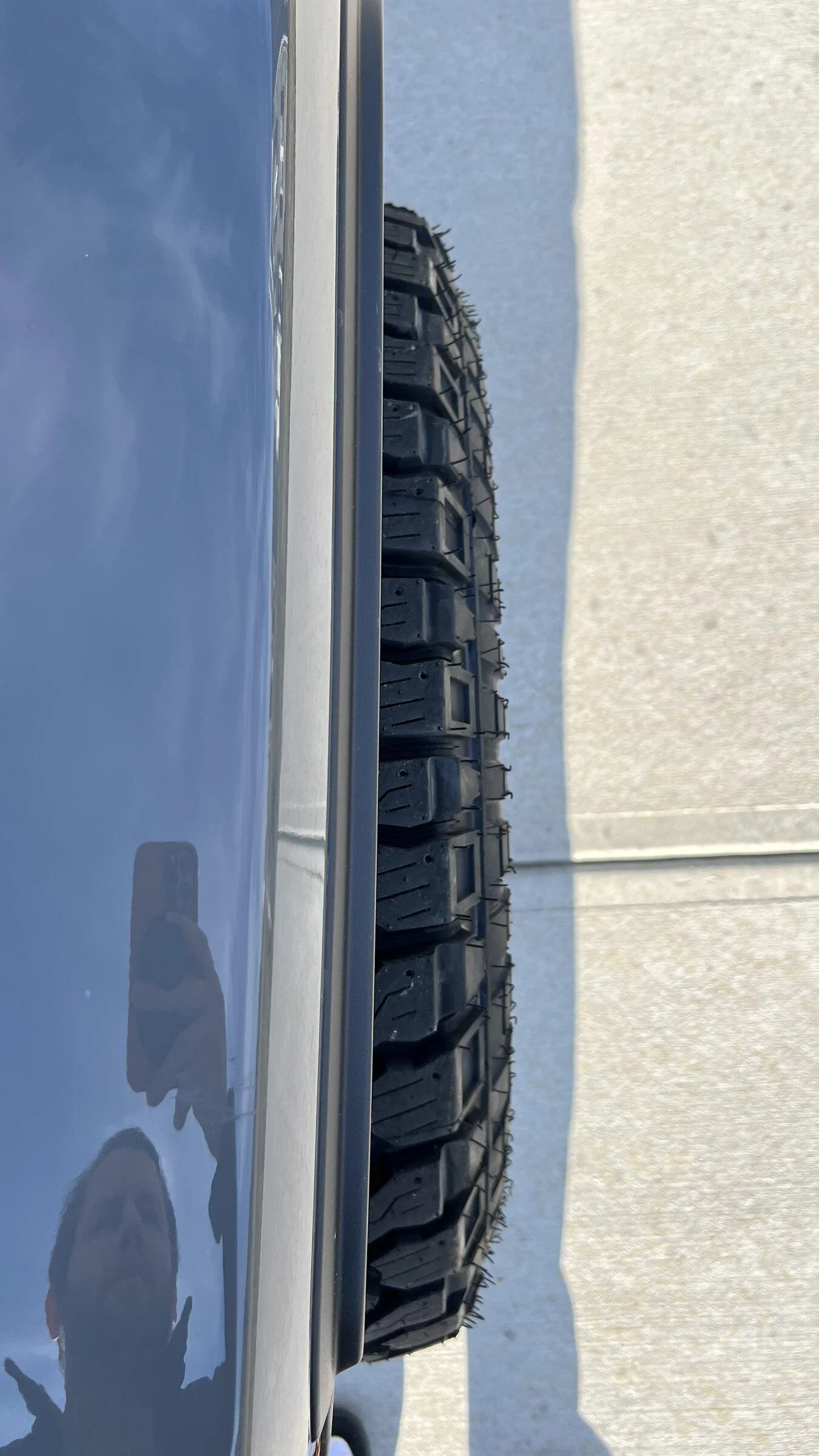

I run that rim setup with 35x10.5 on a wide track axle model Gladiator. So you’d have about 0.75” less poke with a 10.5 tire. More with a larger tire.

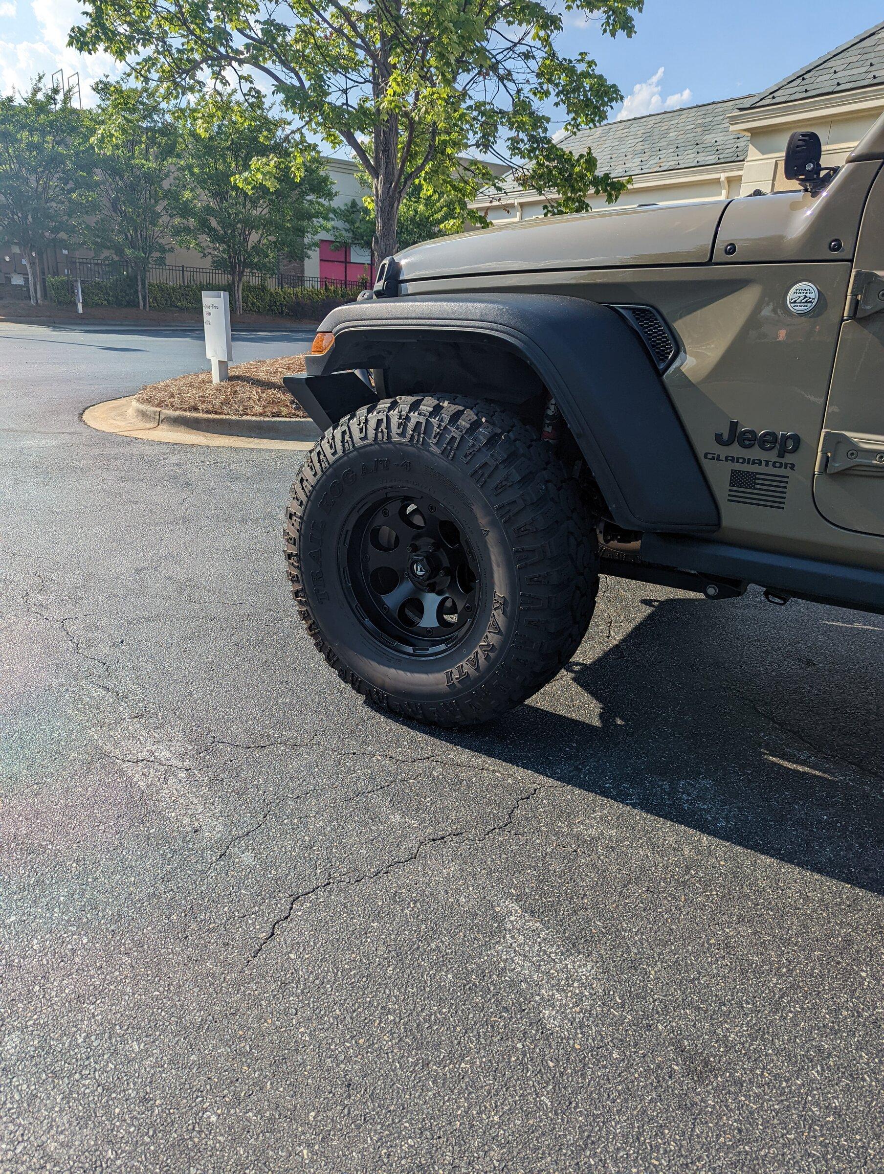

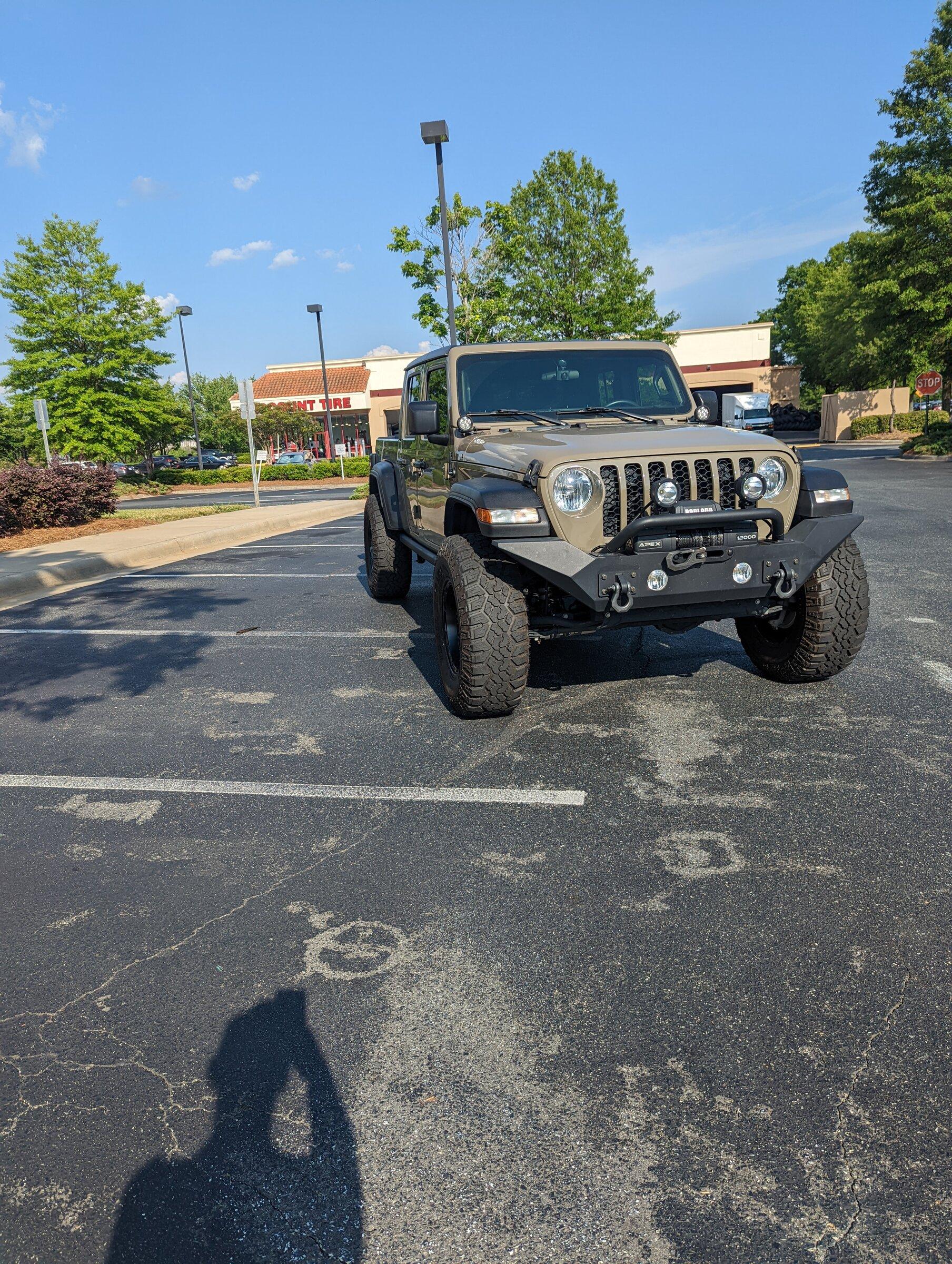

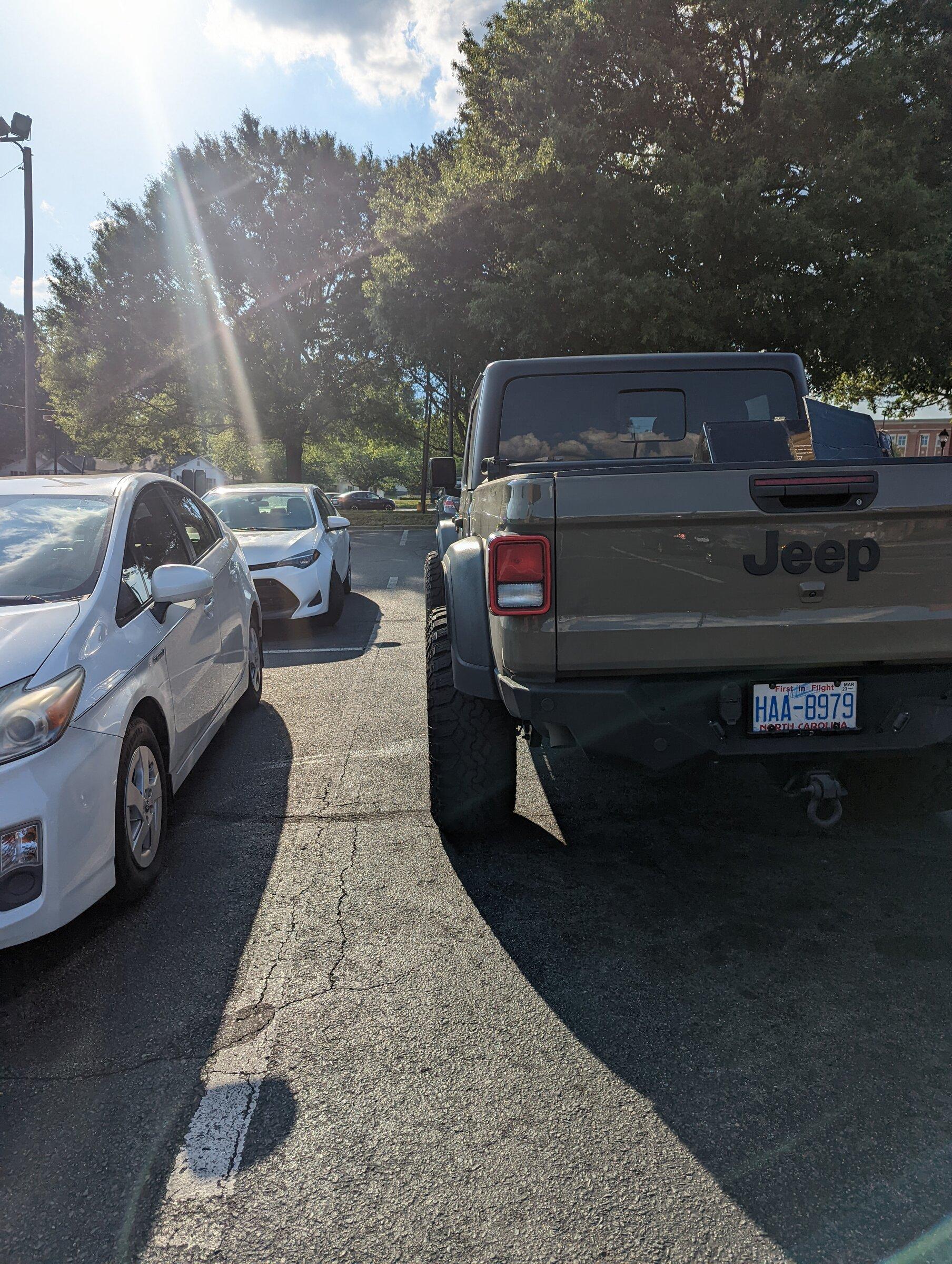

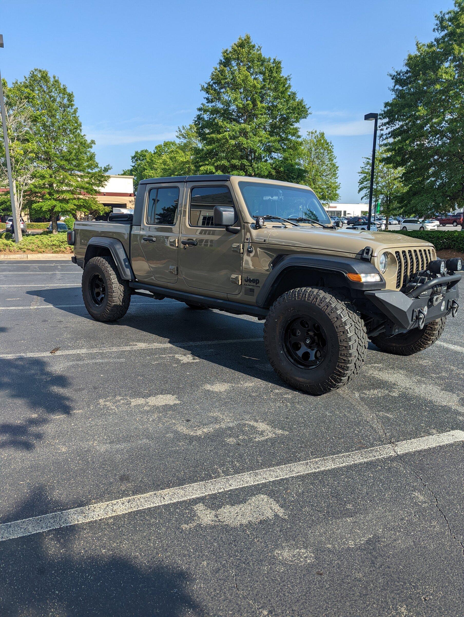

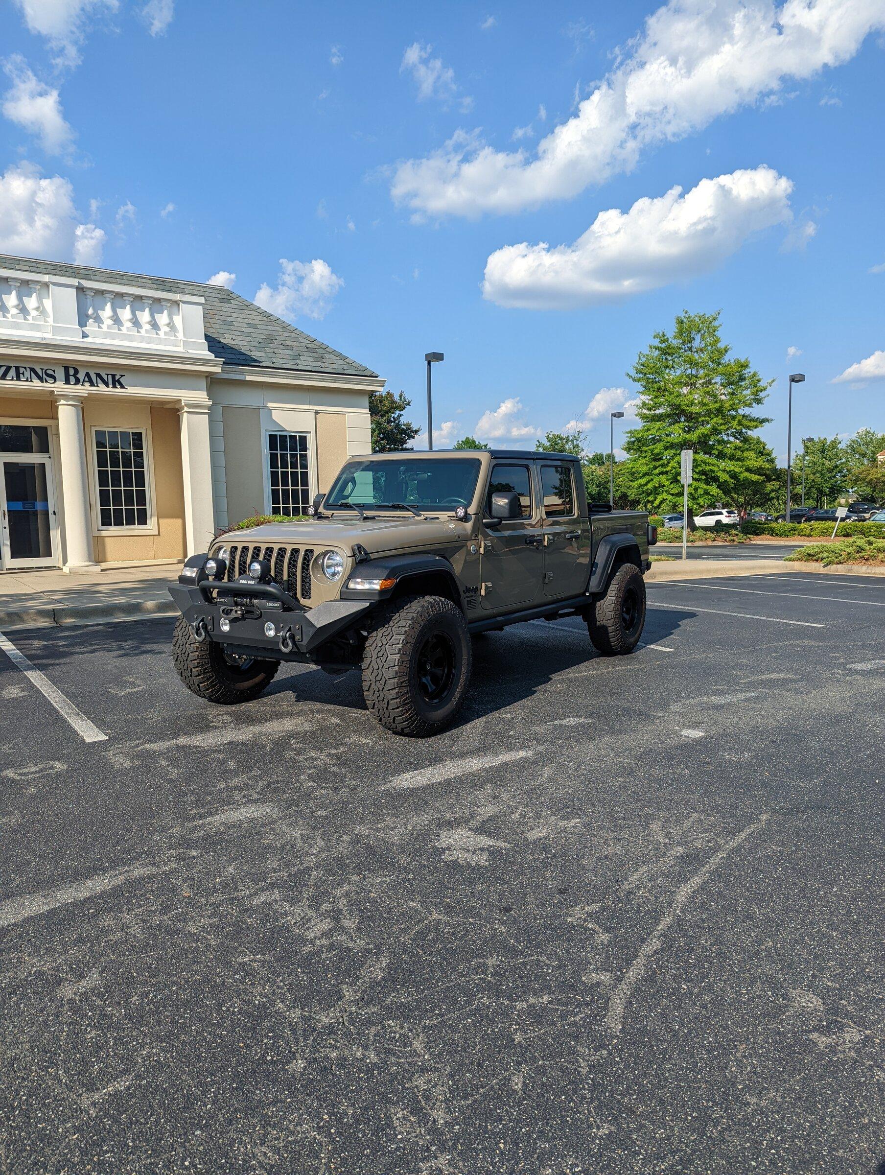

Just bought wheels yesterday. The offset is what you need to look at, that's going to give you poke or no poke. These are 17x9 4.5 backspacing with -12mm offset. Just the stance I was looking for. This is with Rubicon Front springs, 2.5" Readylift SST lift kit. Wheels are Fuel Enduro, mines a Max Tow sport also. Tires are 37 12.5 17 Kanati Trail hogs.
Jeep Gladiator What offset wheels?! PXL_20220601_213748271.MP
Jeep Gladiator What offset wheels?! PXL_20220601_213734217.MP
Jeep Gladiator What offset wheels?! PXL_20220601_213716054
Jeep Gladiator What offset wheels?! PXL_20220601_213703671.MP
Jeep Gladiator What offset wheels?! PXL_20220601_220812406.MP
