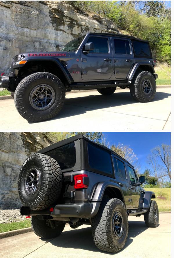

Here are some JK AEV Borah wheels on a JL Rubicon. They are 17x8.5 and +4. I don’t think the 2mm difference would be noticeable.
Jeep Gladiator +6 offset wheels DF2FE437-710E-4B92-8B0D-8B5C6287ECD0
there shouldn’t be issues with a +6 offset that size.
Thanks I appreciate the info.

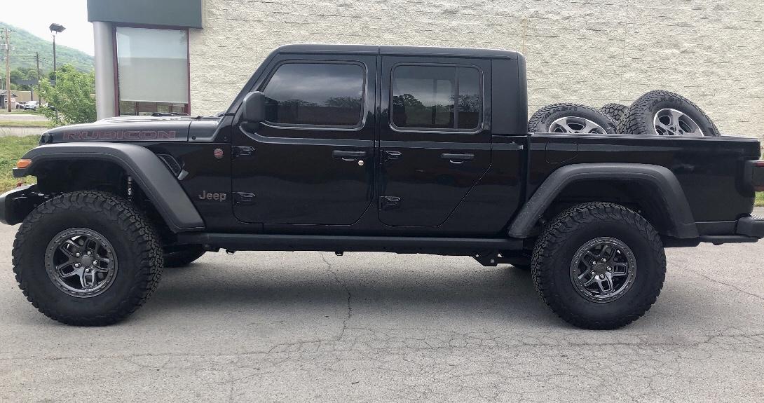

With a Rubicon you can run 37s on wheels up to +30 (per Discount Tire), without rubbing control arms. I have a friend with a Rubicon who has +25 AEV Borahs on his with 37" KO2:

ya it'll be awful close to rub, the 37 ko2's run notoriously short so they will be a 37" tire least likely to rub, and the rubicon/max tow axles already 1/2" wider either side which is essentially 12mm advantage over the sports to begin with
So that means no 37's on factory wheels or is that just a small shim the steering stop issue?
Or is that Discount Tire just being their over conservative self? I know the one near my old shop years ago wouldn't mount anything that wasn't within tire/wheel manufacturer spec so if the tire said 7.5-10 inches, they would not mount on a 7" wheel.
