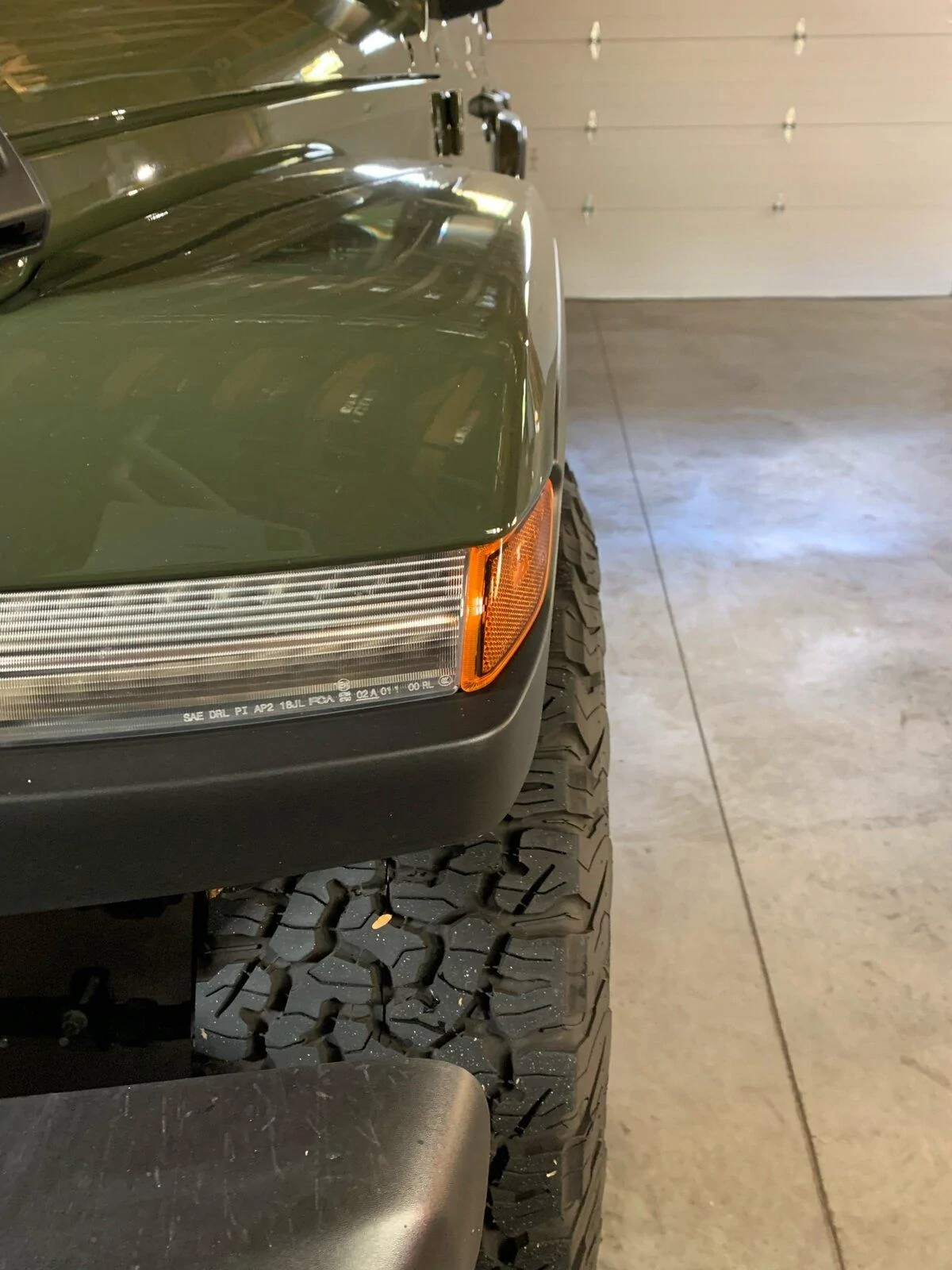

For what it’s worth…a +10 still sticks out a bit. I bet a +18 would be dead on.

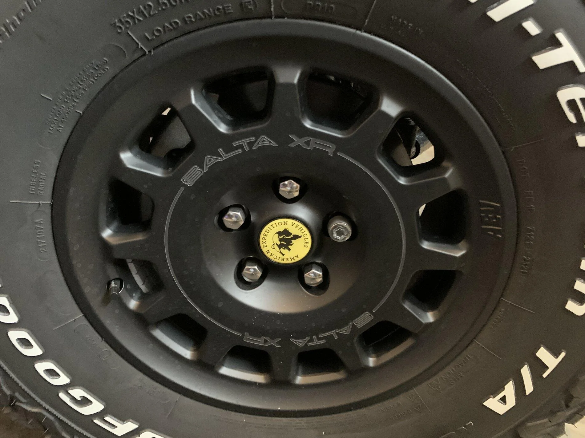

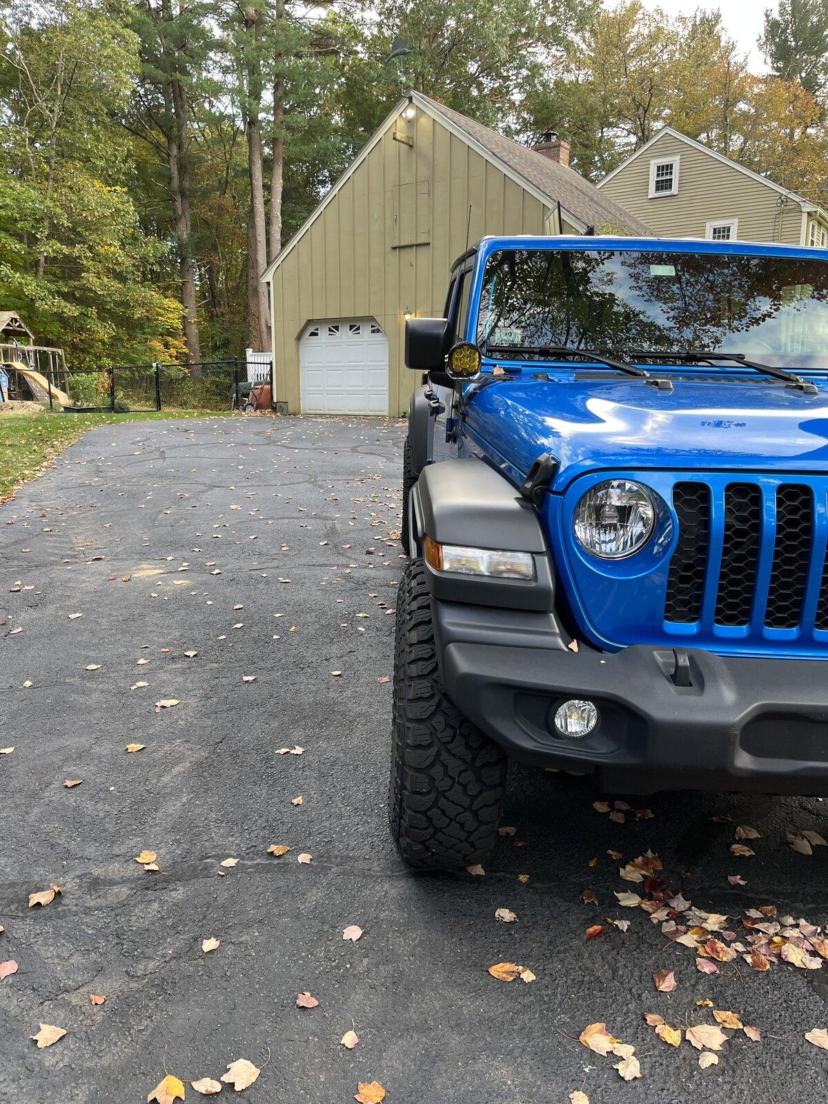

I just got the AEV 17 inch 8.4 Salta XR wheels +25 running BFG's 35/12.50/17 they only stick out about 1-1/2 inches.
Jeep Gladiator Wheels with +25ish Offset IMG_7847
Jeep Gladiator Wheels with +25ish Offset IMG_7849
Jeep Gladiator Wheels with +25ish Offset IMG_7850

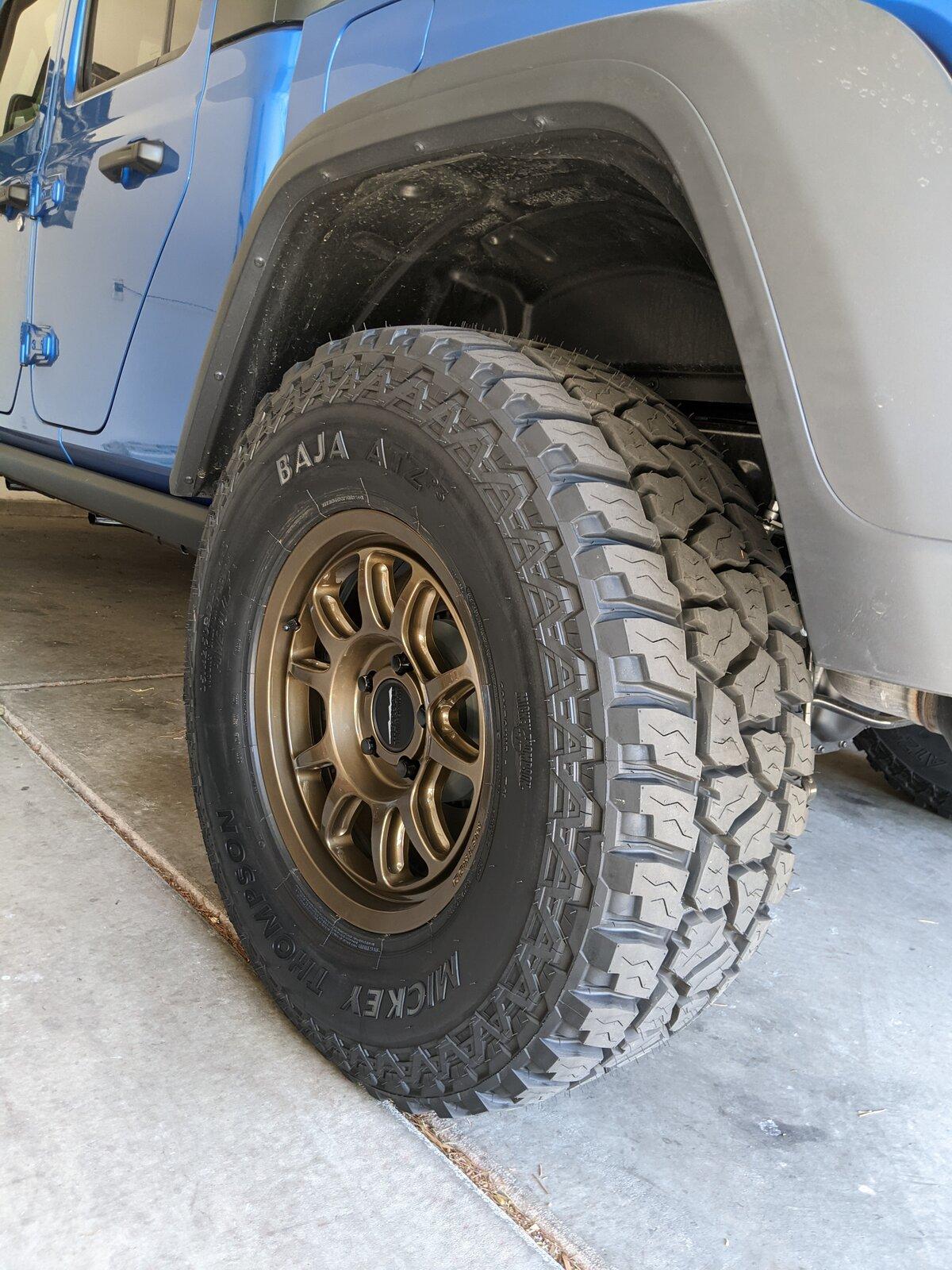

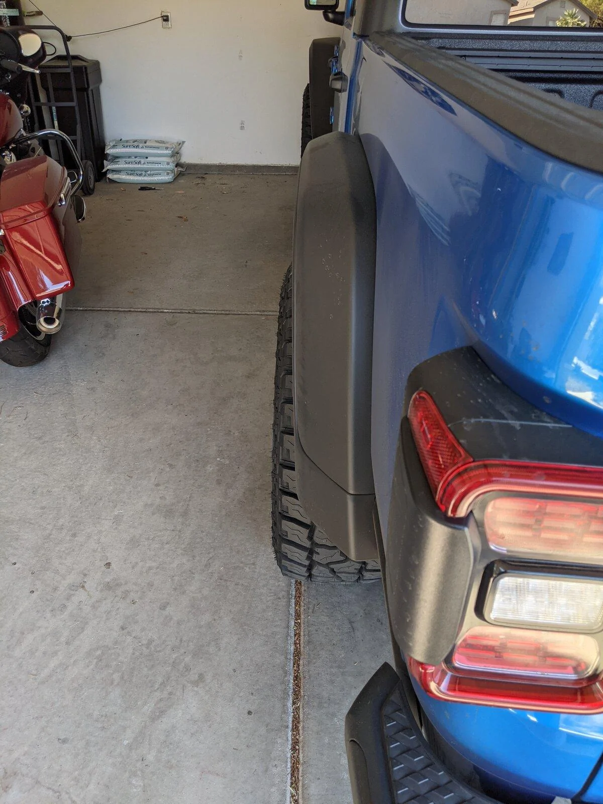

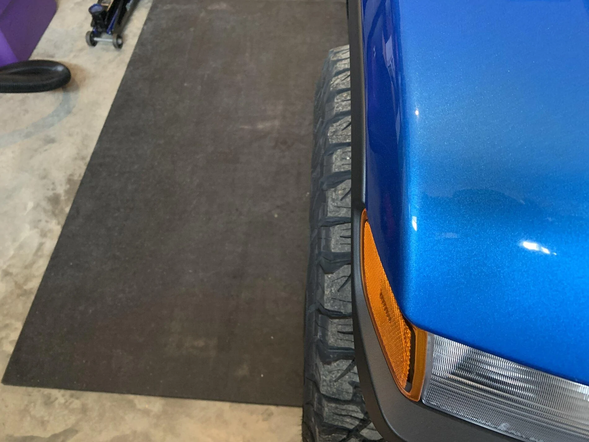

I have the Savegre II with 35x10.5 tires they don’t really extend beyond the fender at all.
Jeep Gladiator Wheels with +25ish Offset B039811E-7868-4E22-95F3-5B9BA639E975

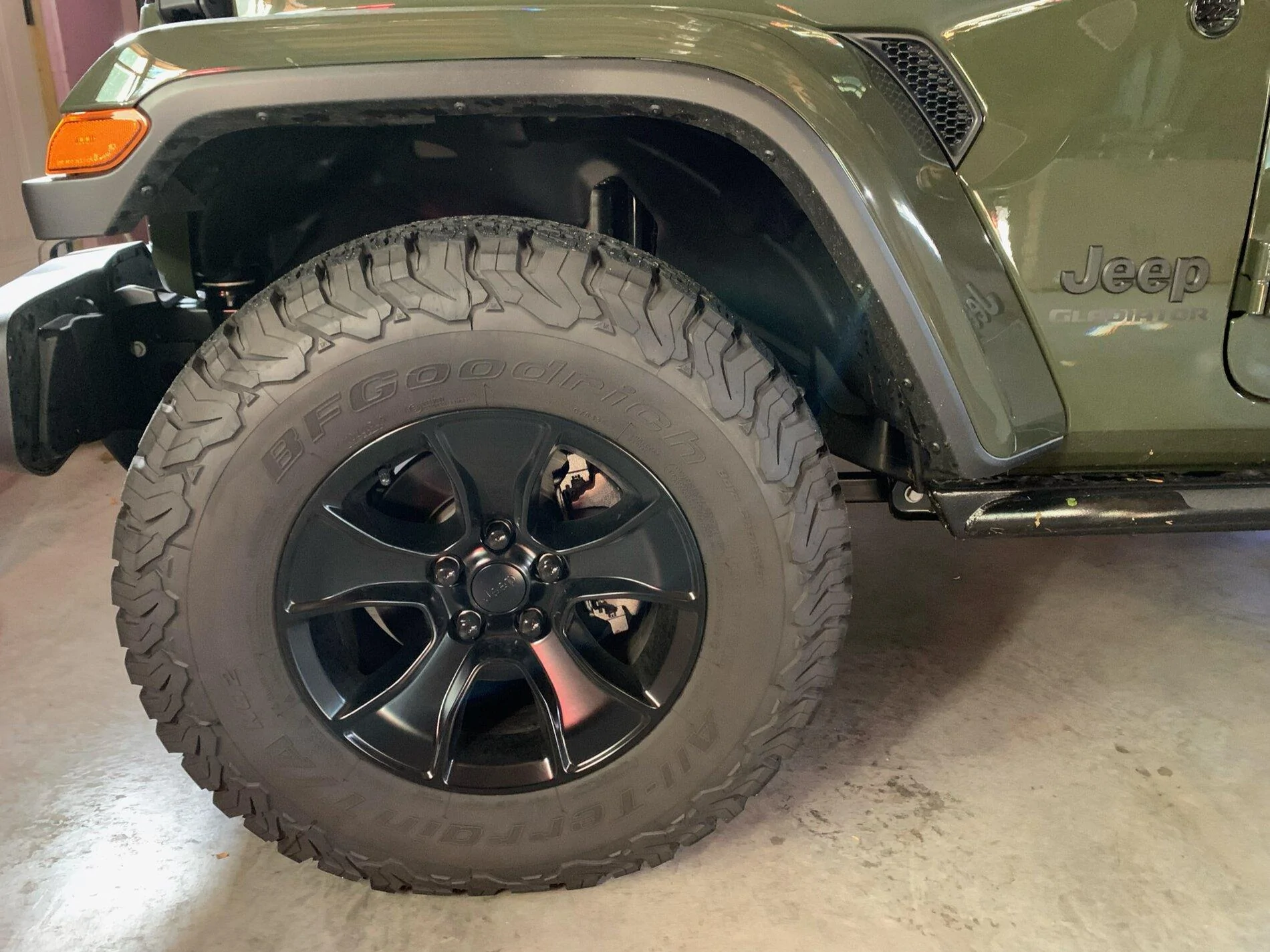

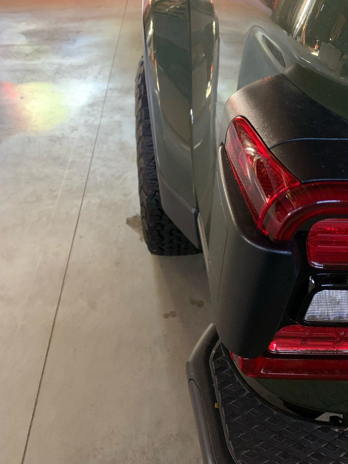

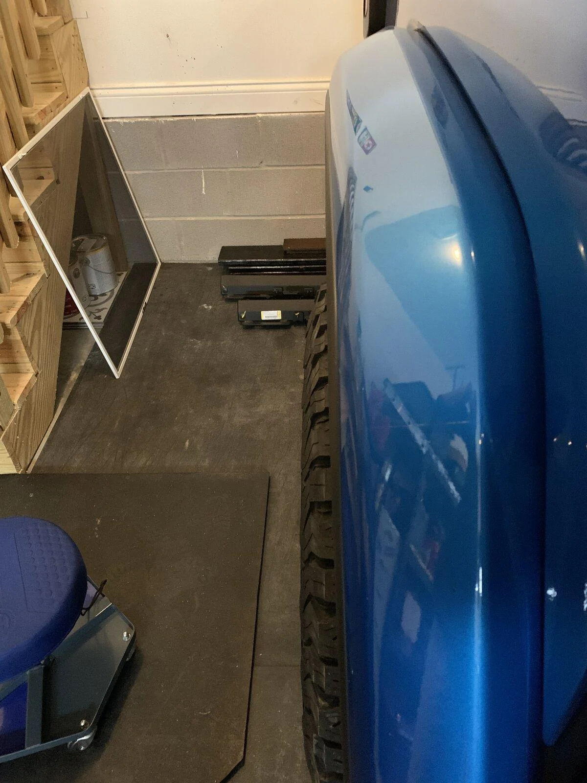

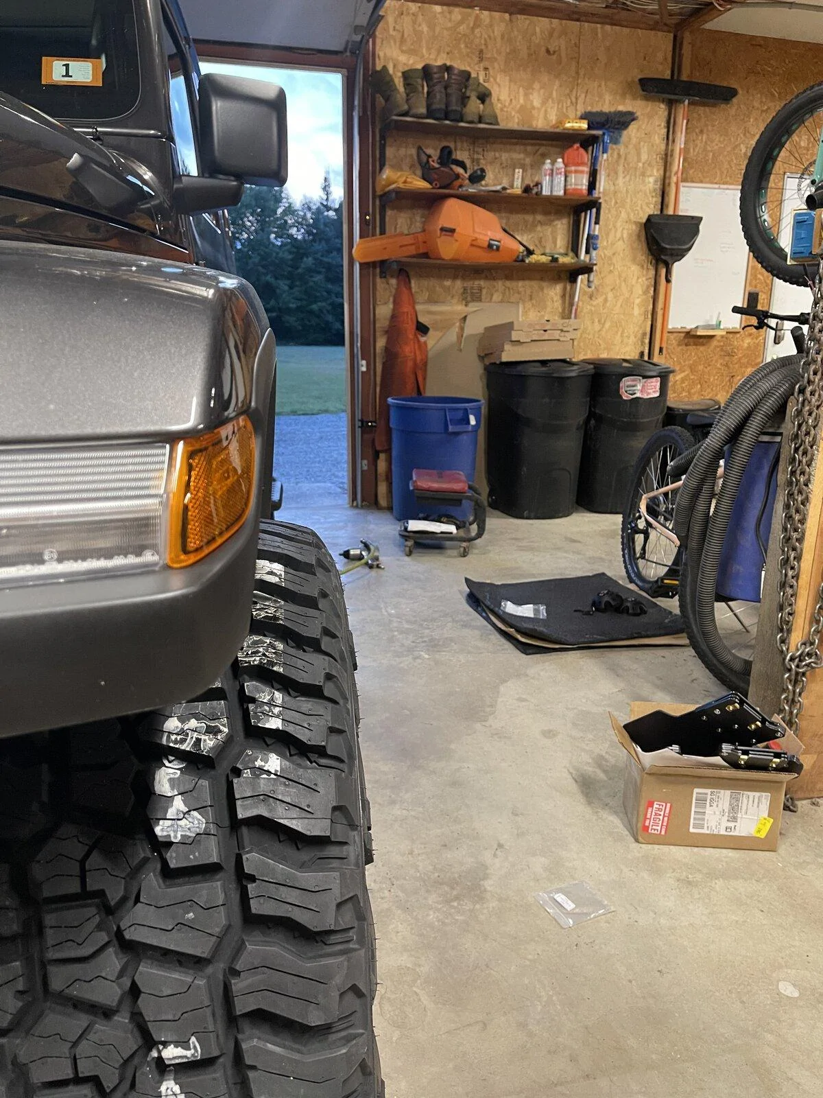

I got +12 offset Mopar Gladiator 17x8.5 wheels and the poke is just about perfect to my eye. Obviously since I have a Sport S without Max Tow, my axles are the narrow version and I am only running 285 KO2s at 11.2 inches wide, so my situation is a bit different than yours with wide axles and 12.5 in wide tires. But thought I would share example pics for others with narrow axles looking for similar +12 spec wheels.
Jeep Gladiator Wheels with +25ish Offset 1CA96C35-48D1-4D42-9490-997F8BDE7F77
Jeep Gladiator Wheels with +25ish Offset C6762304-3126-47AD-8A8F-EE93E160774D
Jeep Gladiator Wheels with +25ish Offset 63FB4712-3A53-4650-A412-58FB3EF44CDE
