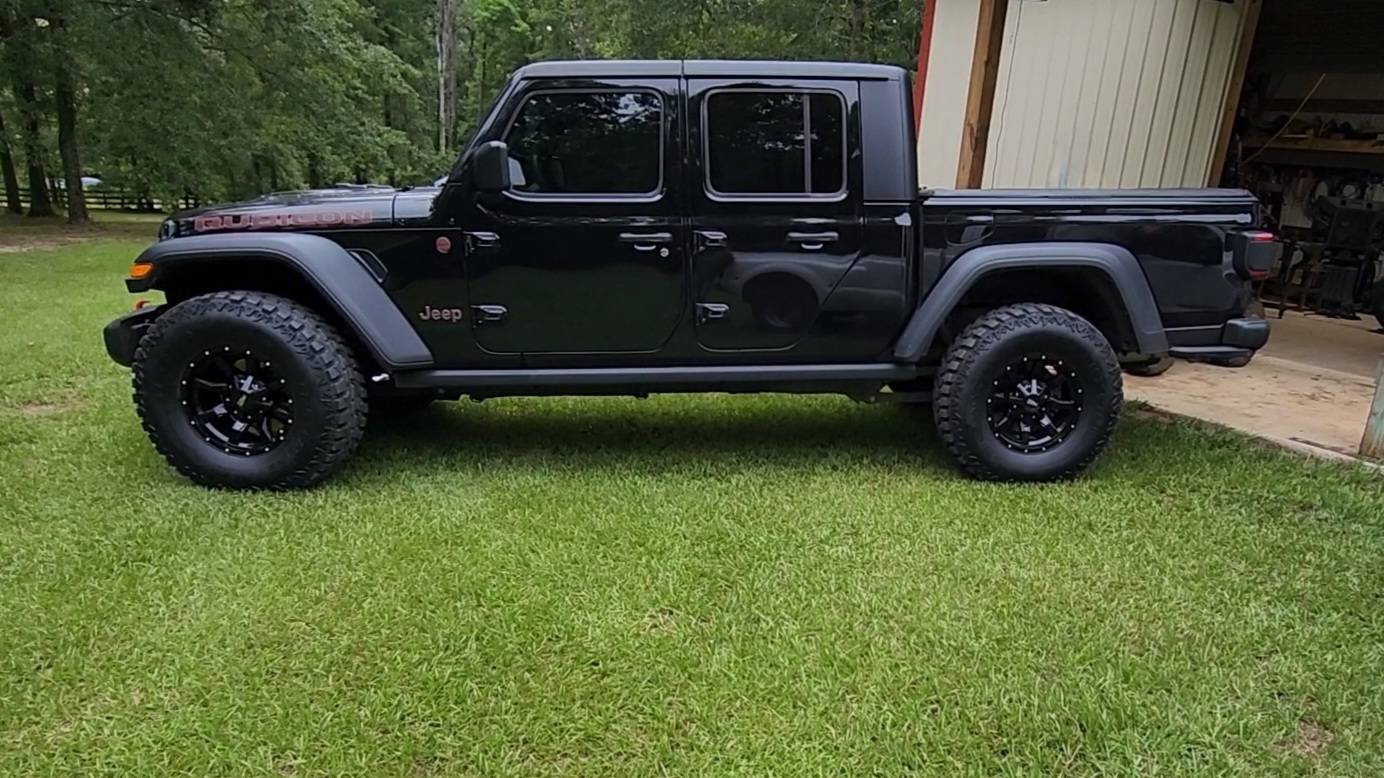

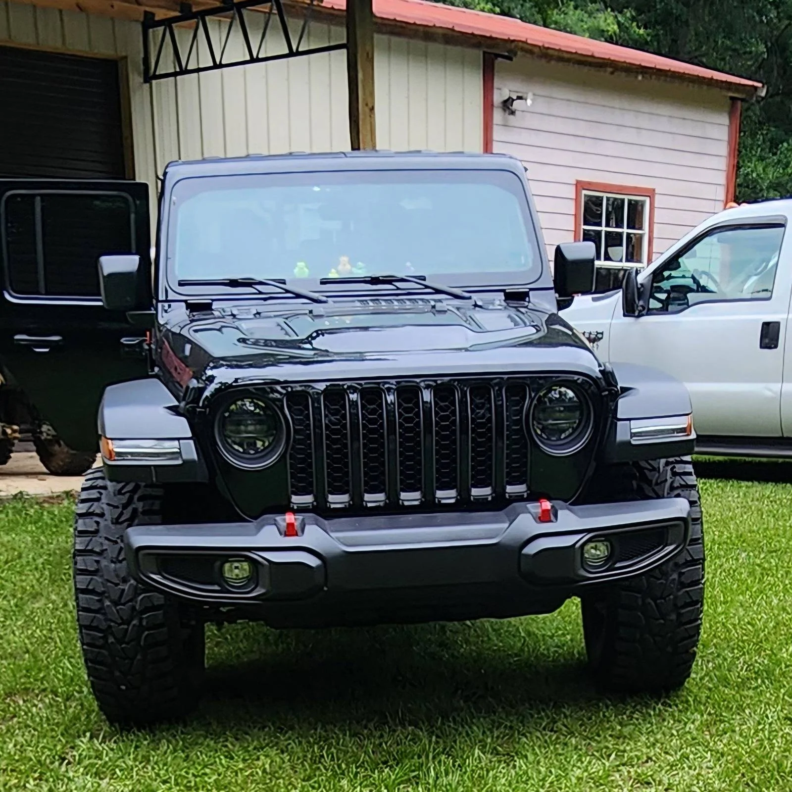

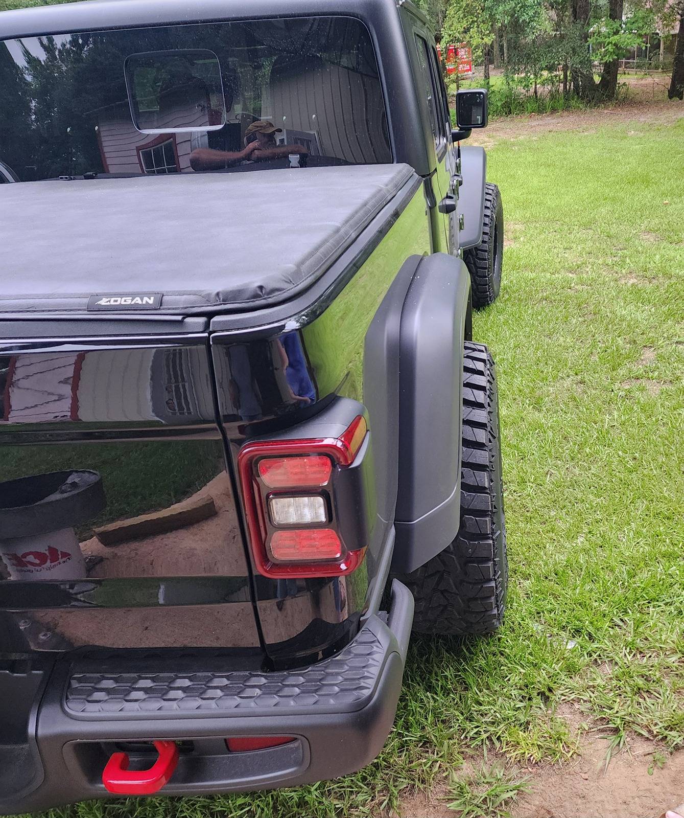

Thanks for all the advice. I ended up going with Moto Metal M0970 wheels with Versatyre 36x12.5r17 tires. Turned out pretty good. No rubbing at any point.

Jeep Gladiator Advice on Offset for 17x9 wheels with 35x12.5 17 tires. 20240602_183020
Jeep Gladiator Advice on Offset for 17x9 wheels with 35x12.5 17 tires. 20240602_182051
Jeep Gladiator Advice on Offset for 17x9 wheels with 35x12.5 17 tires. 20240602_182228

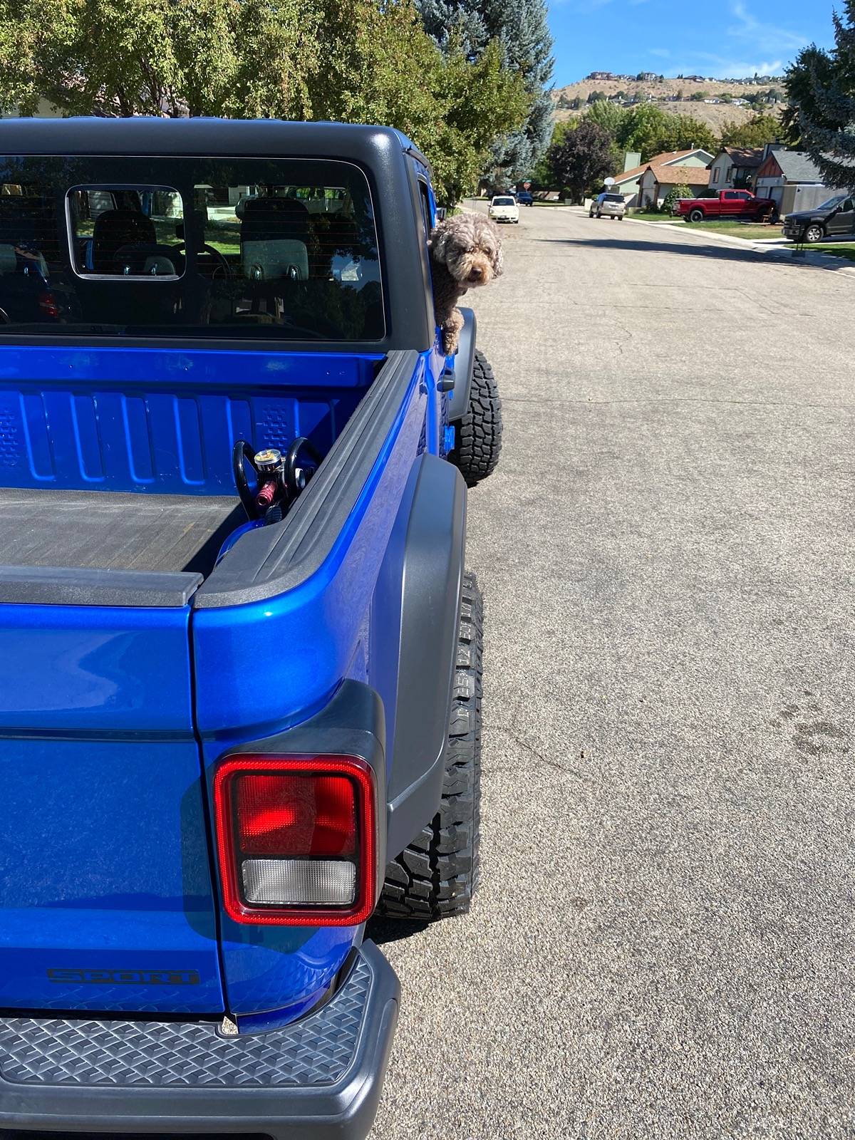

I did +18 x 9”on 35” 12.50 MTs, no rubbing at full extension or compression, here’s a pic of poke out and wheel well clearance
Jeep Gladiator Advice on Offset for 17x9 wheels with 35x12.5 17 tires. IMG_0922
Jeep Gladiator Advice on Offset for 17x9 wheels with 35x12.5 17 tires. IMG_0900

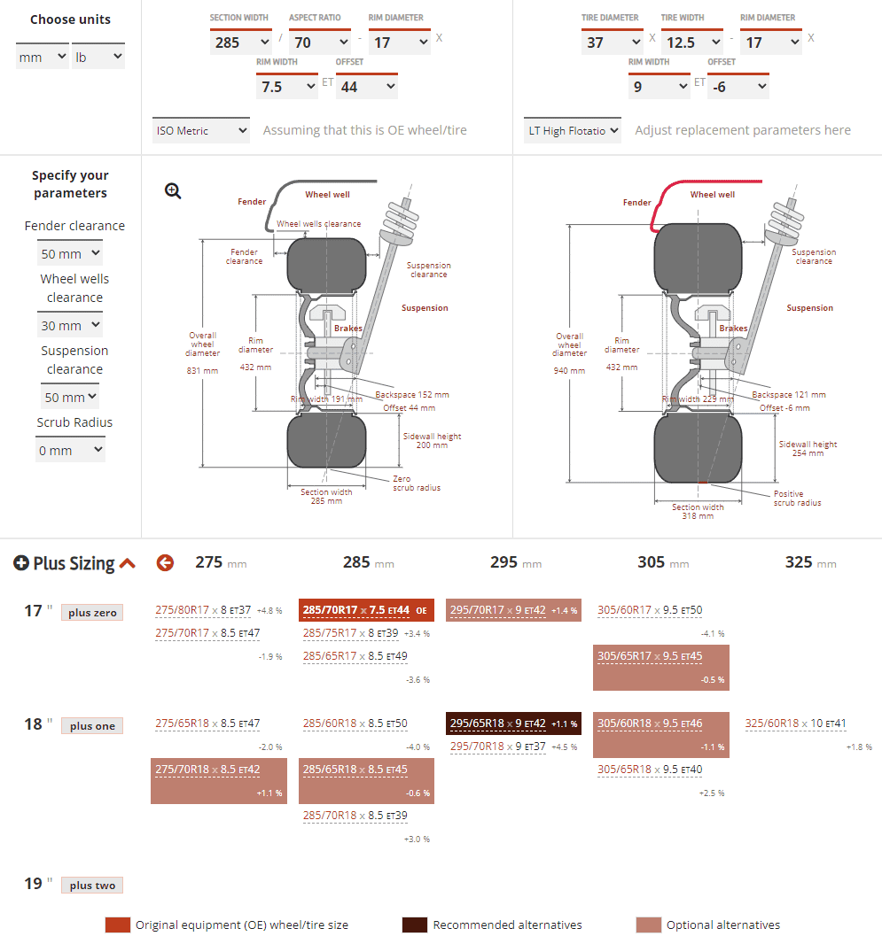

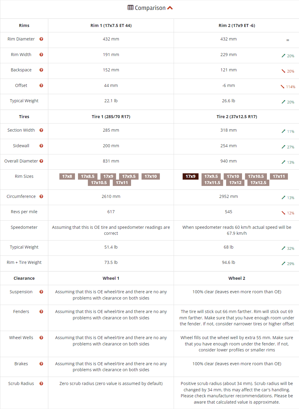

yeah backspacing is a game i always find confusing. I just go with offset cus its easier to me figure where the inner edge of the tire will track. which is all I really look for. The goal in my book is trying to keep inner edge of the wheel as far in or out as needed to keep the stock scrub radius with whatever size tire your mounting. 9in is wide AF for an offroad application and tbh introduces to much wheel to work around. 7.5-8.5 is my sweet spot range. I don't think i'll ever run any tire wider than 12.5 because of that as well. Then again this is all subjective to the tastes and requirements iof the end user. In OP's case, my minds eye says his scrub radius will fine but not great. assuming OE is 0, he'll add about 34mm of scrub and idk what the safe range is.

edit: stock scrub should be about 38mm. so 34mm with the 17x9s should be fine to the point of being unnoticeable to most people.
