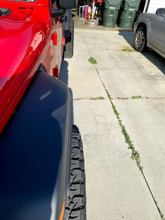

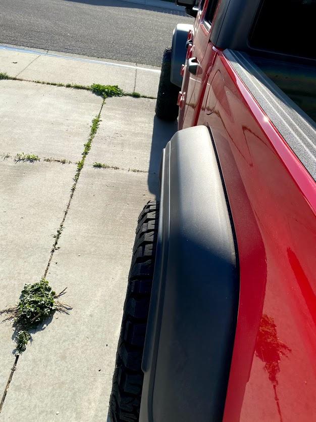

Oh and to actually answer your question +30mm would probably be about the sweet spot. =" wider then stock & stock is a good little bit back inside the fender. For reference mine below is a 0 offset on a 12.7" wide tire (per BFG specs for 315/70r17 ko2's) & its still not sticking out a ridiculous amount. Though it is a bit farther then i'd prefer. But with your much narrower tire even with a 0 offset you would be an inch farther in then I am.
I ordered my wheels & tires online & to do over again I would of probably done the same tire's on a positive 30 offset wheel. I would like a narrower tire too, but honestly I don't dig kenda's. Only ever had then on my bikes & never was impressed.

Looks good like the ko2's. I've always had the nitto ridge grapplers on previous trucks but tough to justify how steep the price is getting for them. I was looking at the black rhino overland wheels which have the +30 offset. I got the base sport with the black wheels I might even just mount them on those for a while. I had a beautiful 2nd gen ram that had the lower doors and rockers shredded from tires sticking out to far after a long hunting season and don't want that to happen again.

I almost got the Nitto's, but the price was close enough to the KO2's that I just got the little better tires.
The Black Rhino Overland's are nice, what I would get if I could do it again though are the Black Rhino Barstow's. I tried really hard to change my order before they shipped, but customofsetts is very slow to respond to emails so they finally tried 5 days after I requested it & they had already shipped. I am not unhappy with what I got, but I would of preferred something a little different. I got my truck on a friday night & had the wheels/tires ordered saturday so I was impatient & now I get to pay the price for it for a while.
