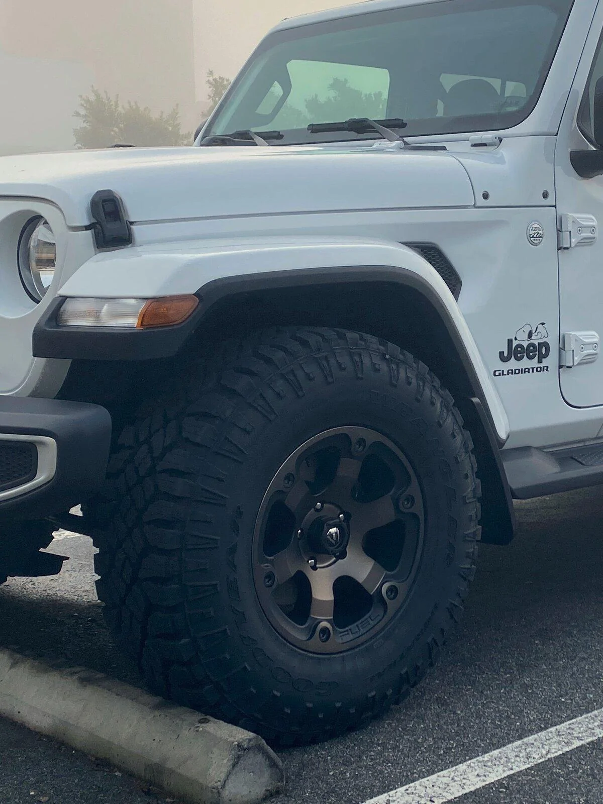

Wondering if anyone can help me?a lot of you guys are extremely knowledgeable about wheels and tires so here it goes im wondering if I can run a 35x12.5r17 tire on a 17×8 wheel with +40 offset ,my gladiator has a 2.5 ready lift level kit i understand that the wheel will be tucked under which is what I would like but will it rub or cause problems?thanks in advance
I'm running Goodyear Duratracs 35x12.5r17 on 17x9 +01 Offset 4.99 Backspacing Fuel Off Road, Beast. No Lift, No Rubbing and they poke just outside of the fenders.
Wish I had a little more Backspacing so they could tuck in a little more.
