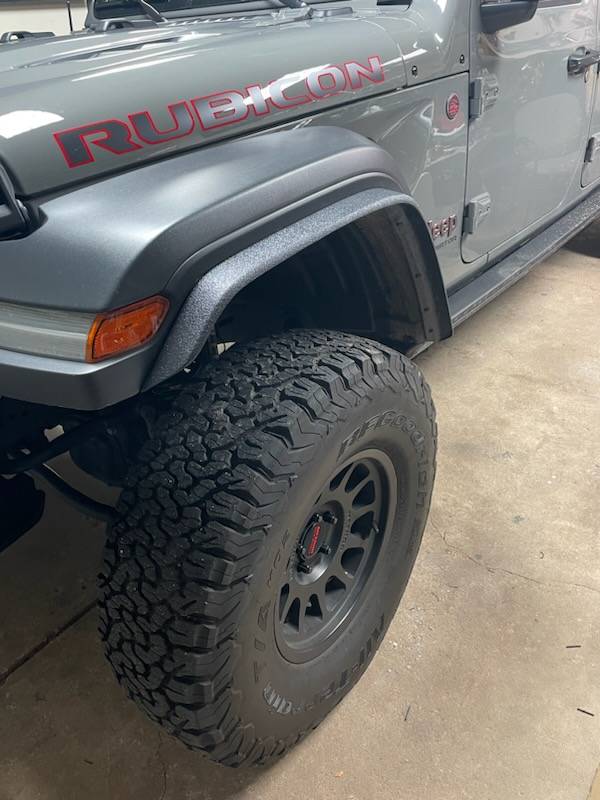

Hi all,
I recently purchased a 2021 Jeep Gladiator Rubicon. I plan on installing an AEV 2" spacer lift, 4.88 gears, and 37x12.50R20 Toyo RT tires on 20x10 Fuel Rebel D680 wheels. The backspacing on this wheel is 4.79" and the offset is -18. I'm not sure what that is actually going to translate into when they're on the jeep. I'd like the tires to stick out a couple inches past the fender flares, but not more than that. Will this wheel/tire setup accomplish that?

Don't push the center out any more than is needed. The farther out from center you go the more stress you're applying to your bearings, knuckles, etc.
You could easily do those tires with zero offset.

With that amount of backspacing-- ideally, you want a 0 offset wheel, which will give you about 2" of wheel poke outside of the fender flare to negate any potential for rub.
