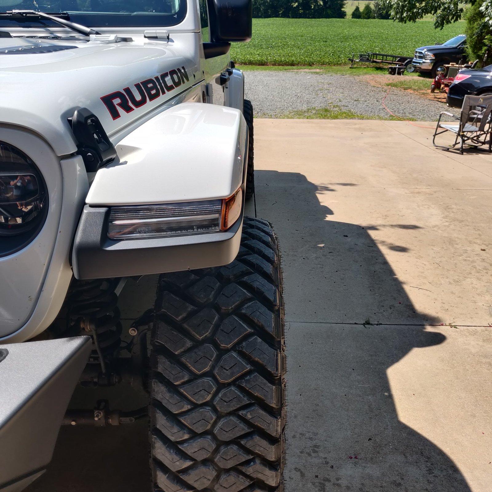

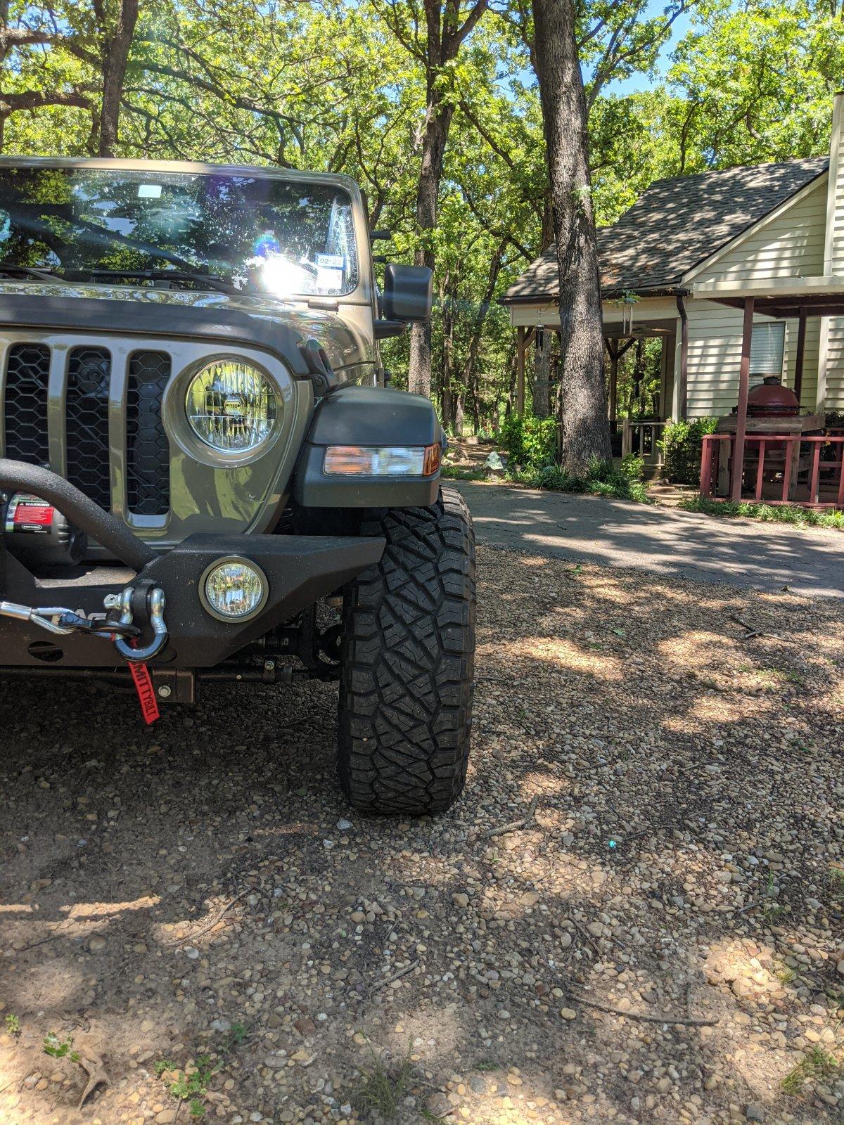

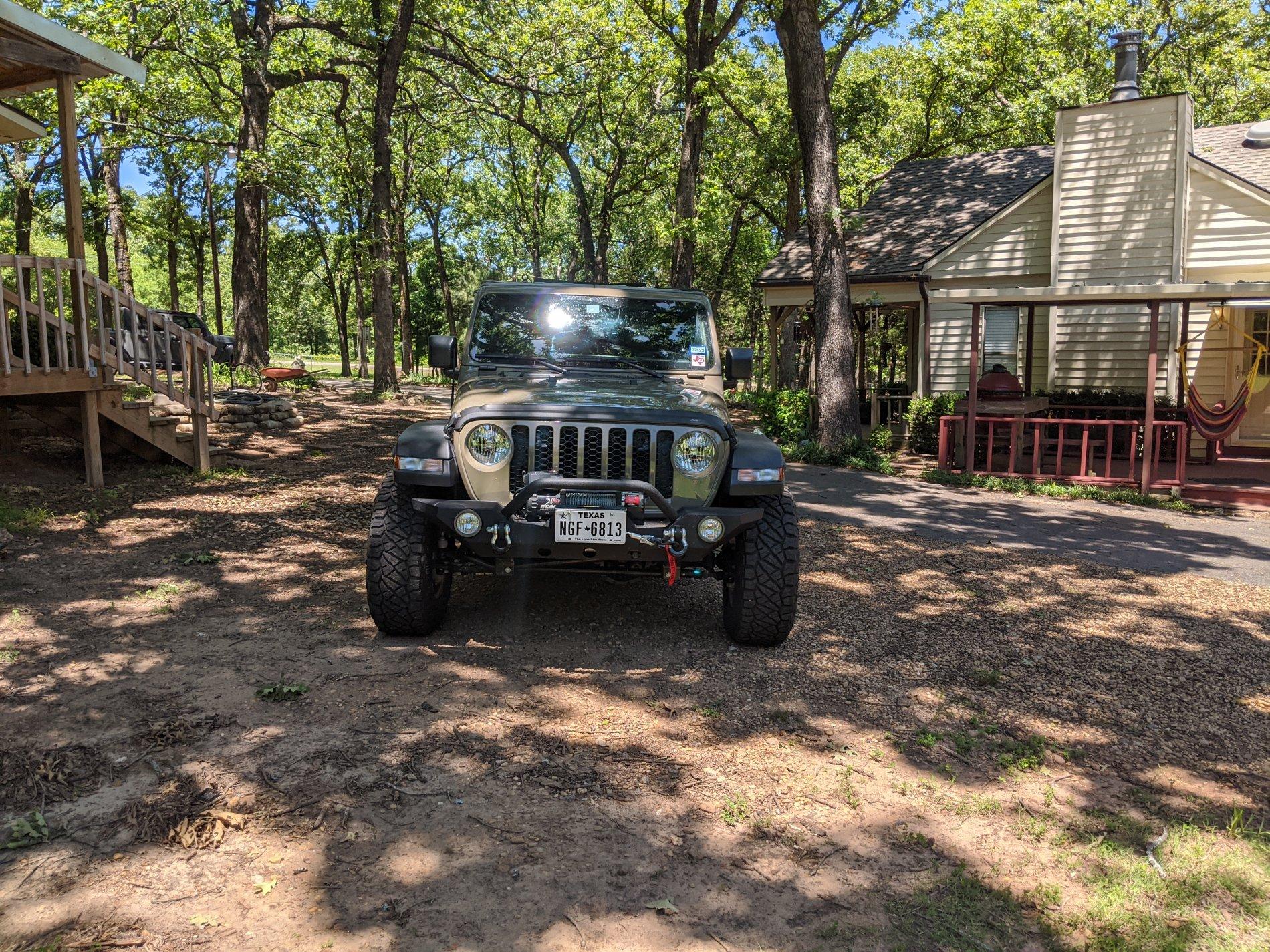

Great pictures, thank you!
Man that looks like just the right amount outside the fender. I’m getting the rubicon so the fenders are higher but I believe they are essentially the same distance out. From my understanding the max tow has that tiny extra big of trim flair you see around lip of wheel well. I’ve never seen any measurements to confirm though.
Do you have a head on shot from the front?
My wife's gladiator is not the Max tow and yes I measured the fenders. Mine with Max tow are an inch wider.
Jeep Gladiator Gladiator Wheel Offset IMG_20200429_131134
Jeep Gladiator Gladiator Wheel Offset IMG_20200429_131120

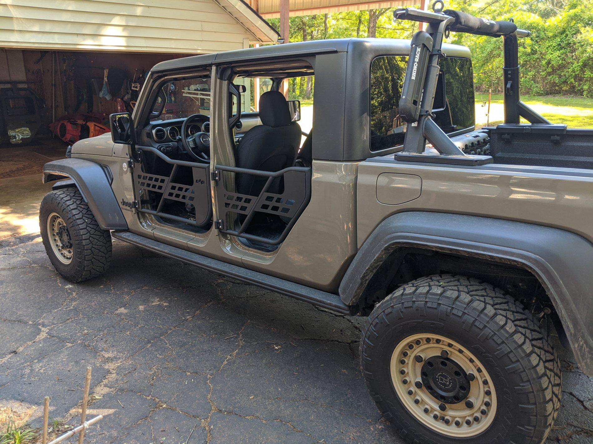

20x10 -24 offset 4.56” backspacing with 37x13.50’s... Only sticks out a couple inches. I was surprised and happy with the outcome.
Jeep Gladiator Gladiator Wheel Offset E1EBFAA5-FB33-40C8-BD46-A9F5D4F2936C

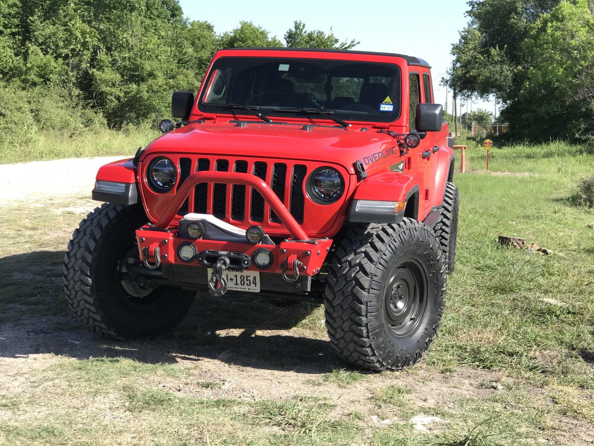

0 offset 4.75” BS 8.5” 17” wheel on Trail Grapplers 37/12.50/17
Jeep Gladiator Gladiator Wheel Offset F04FC6E5-8238-4076-B51B-33FDA25E5ACF

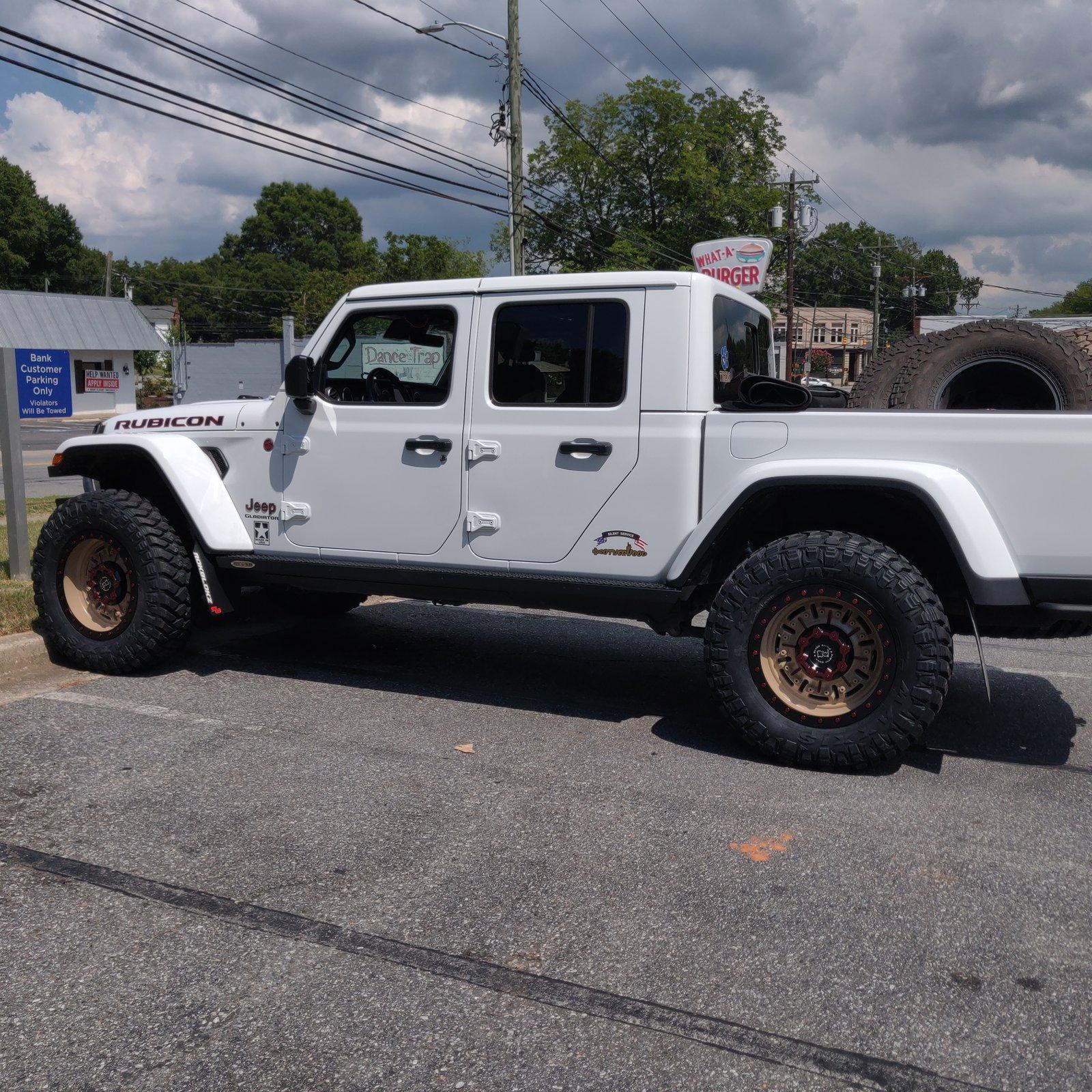

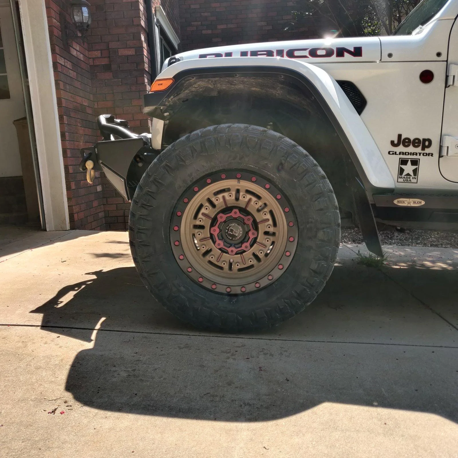

Black Rhino Abrams custom painted desert sand, Rubi red, and black. 20x10s -18 offset. I put 37x12.5x20 Maxxis Razr on them.
Jeep Gladiator Gladiator Wheel Offset IMG_20200713_155546
Jeep Gladiator Gladiator Wheel Offset IMG_20200713_153401
Jeep Gladiator Gladiator Wheel Offset IMG_20200713_155556
