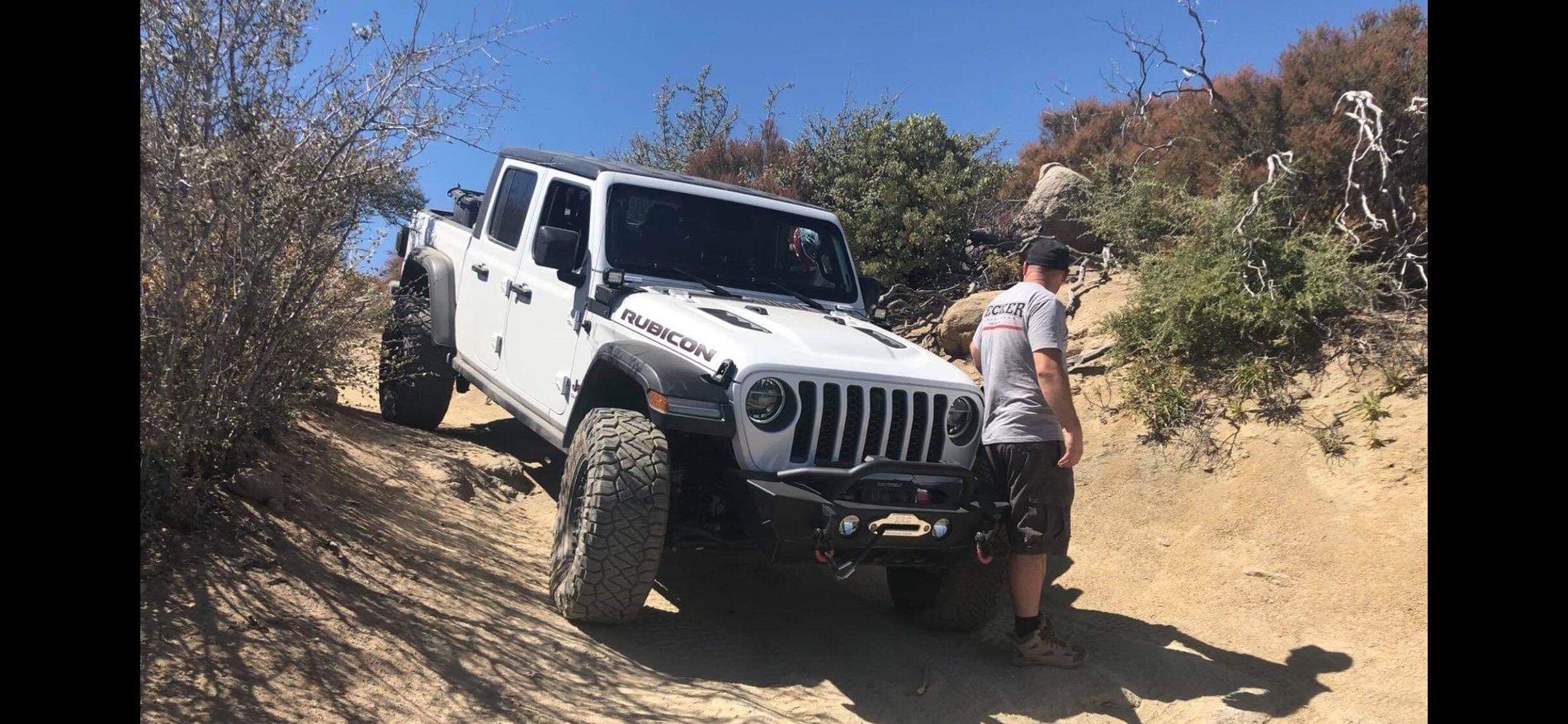

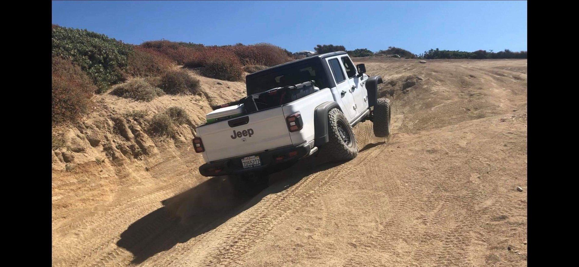

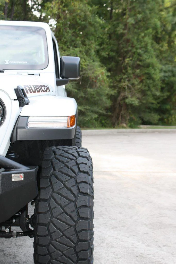

Here is mine one Black Rhino Armory rims. Nitto Ridge Glappler 35x12.5R17 also shows her flexing
Looks bad ass? I am guessing you went with the -18 offset?

18 x 9.5
-18 offset
37" Ridge Grapplers
2" Mopar lift
Thanks! Thats essentially exactly what I am going with and has the look I was hoping for! I appreciate it! Hows your ride hauling the 37"s around?

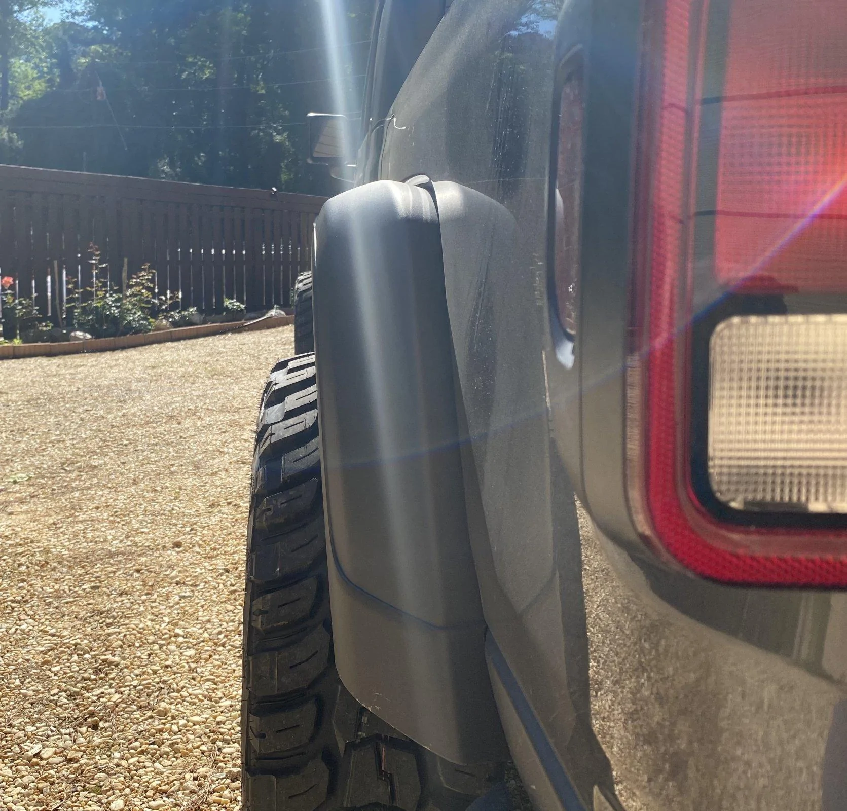

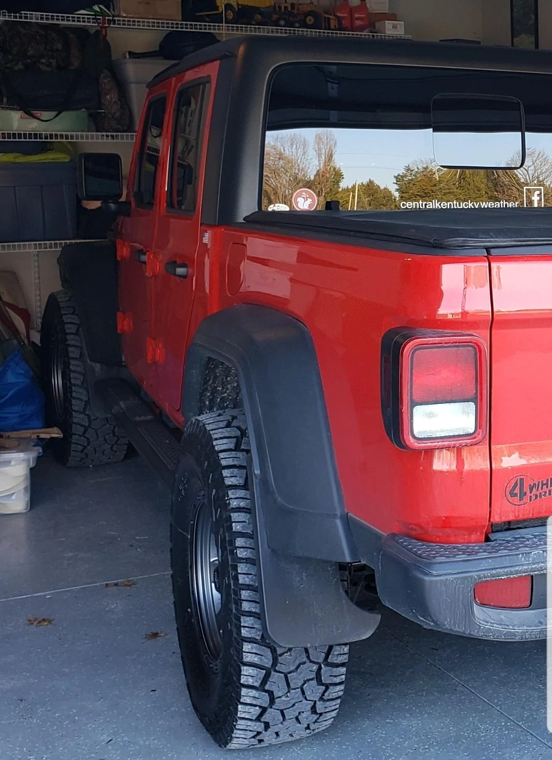

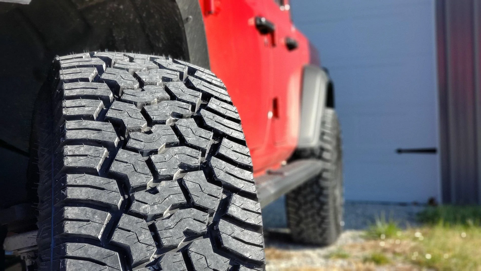

These I just installed on my Max Tow are +6 offset and there's a lot of tread sticking out beyond the fenders, particularly in the front. So much, actually, that I have a set of Rokblokz on order for the front. Gravel is already going "BANG!" when I leave my gravel lane each morning.
Jeep Gladiator Gladiator Wheel Offset Screenshot_20191211-135122_Gallery[1]
Jeep Gladiator Gladiator Wheel Offset 20191207_133126[1]

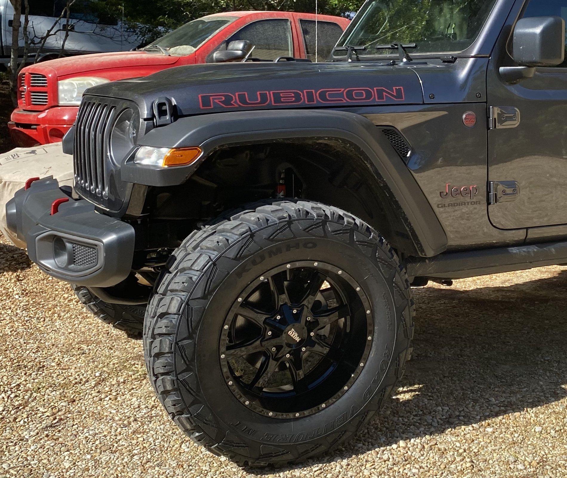

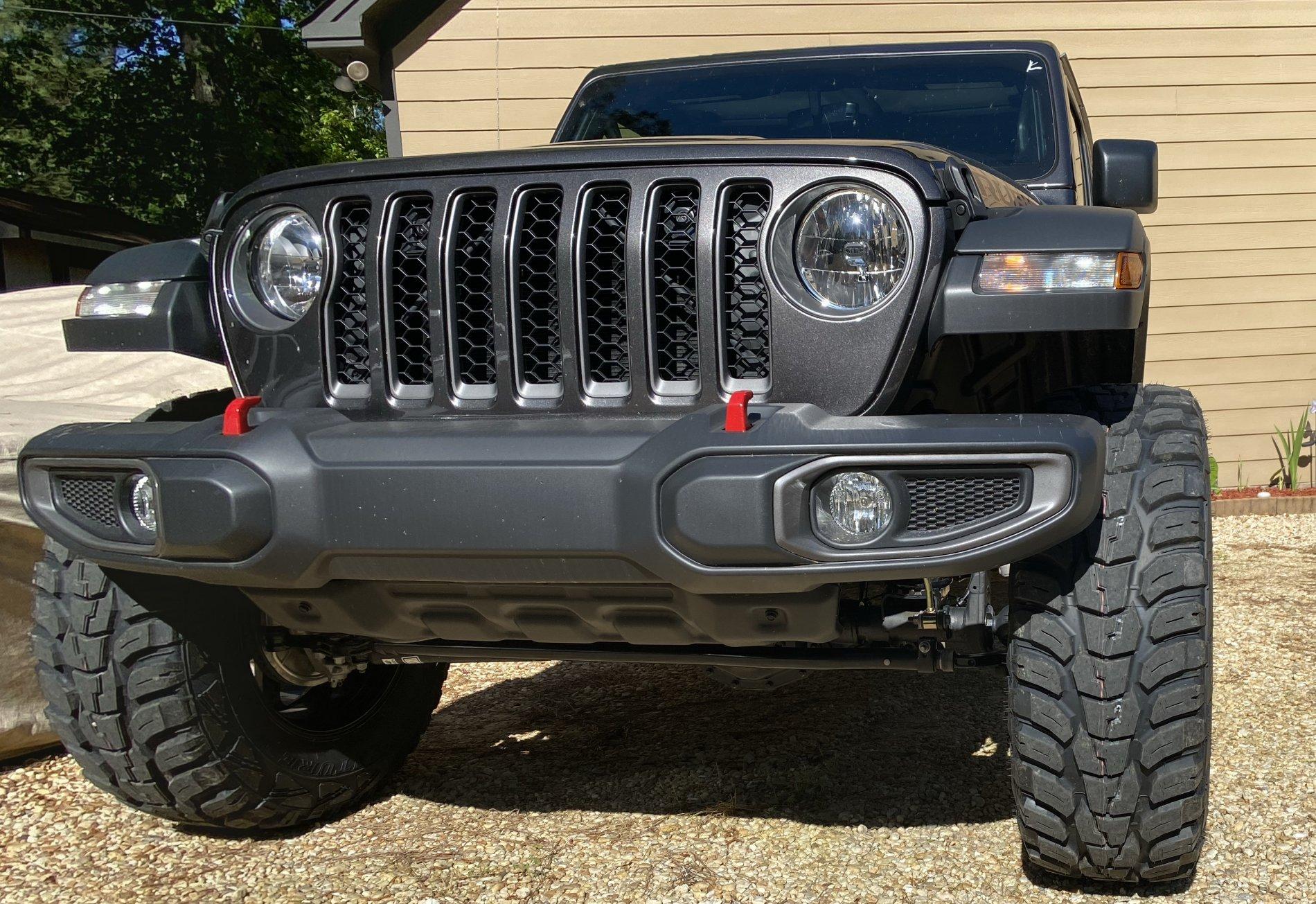

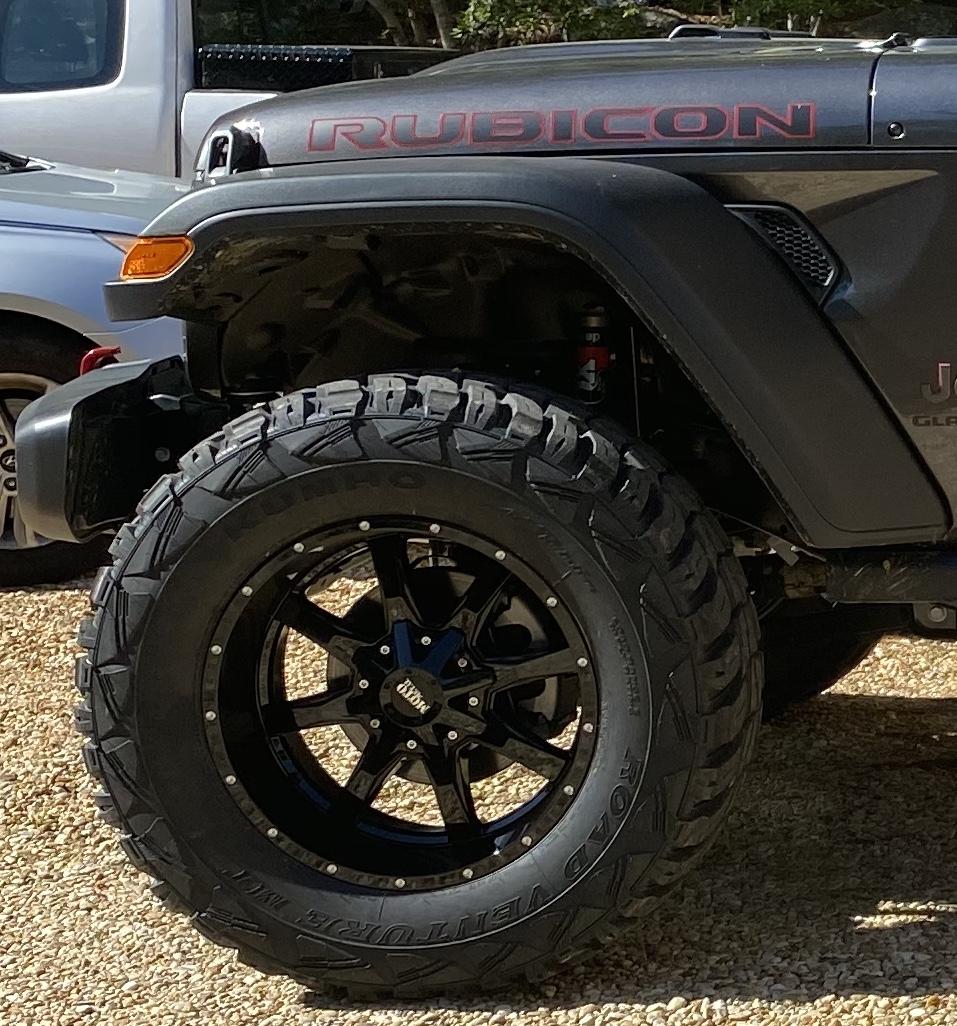

Here's my setup from several different angles...
Moto Metal MO970 20x10 4.56" B.S. -24 Offset, wrapped in 37x13.50r20 Kumho Road Venture M/T KL71 tires.
Jeep Gladiator Gladiator Wheel Offset IMG_1197
Jeep Gladiator Gladiator Wheel Offset IMG_1099
Jeep Gladiator Gladiator Wheel Offset IMG_1100
Jeep Gladiator Gladiator Wheel Offset IMG_1101
Jeep Gladiator Gladiator Wheel Offset IMG_1103
