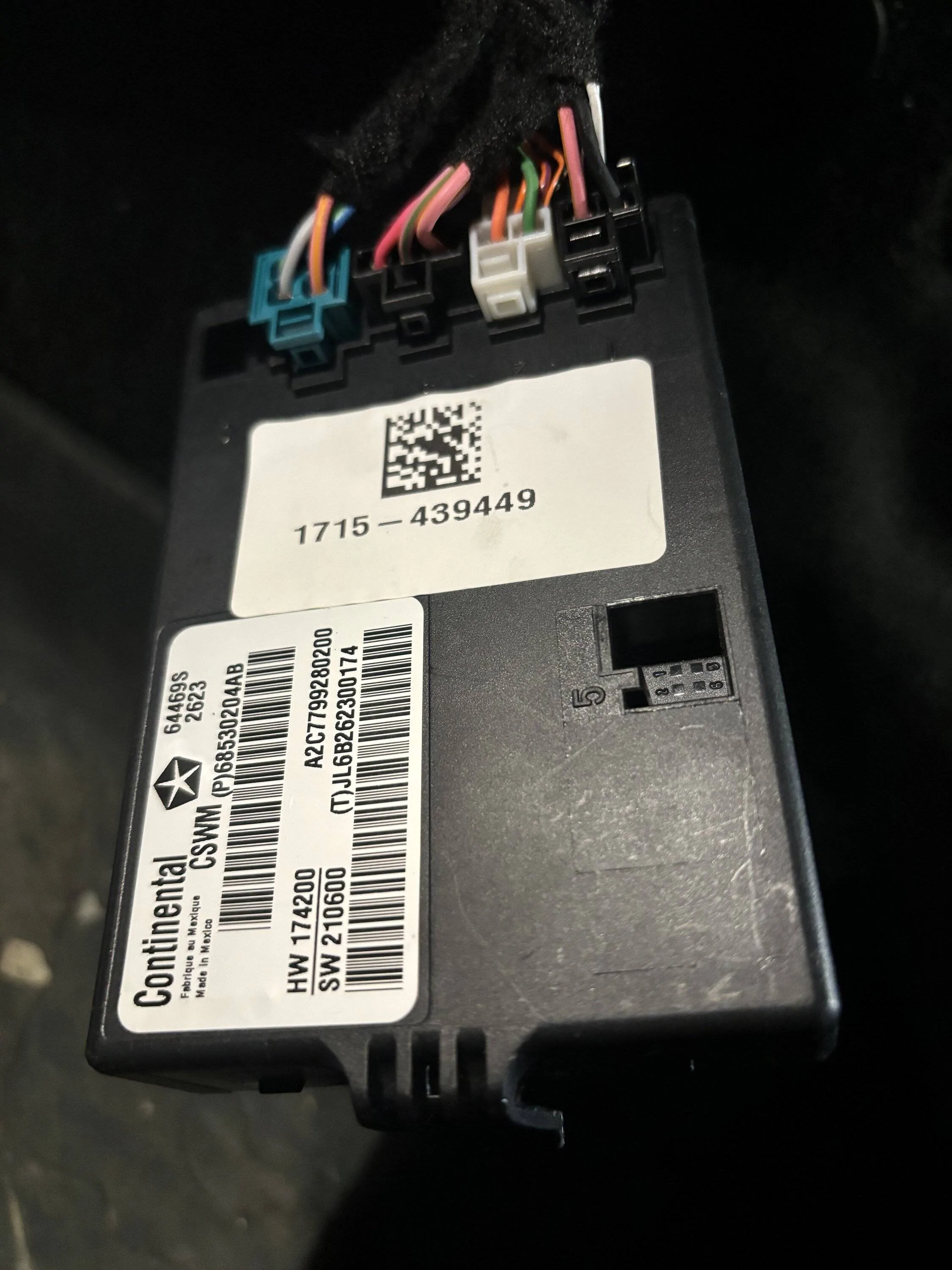

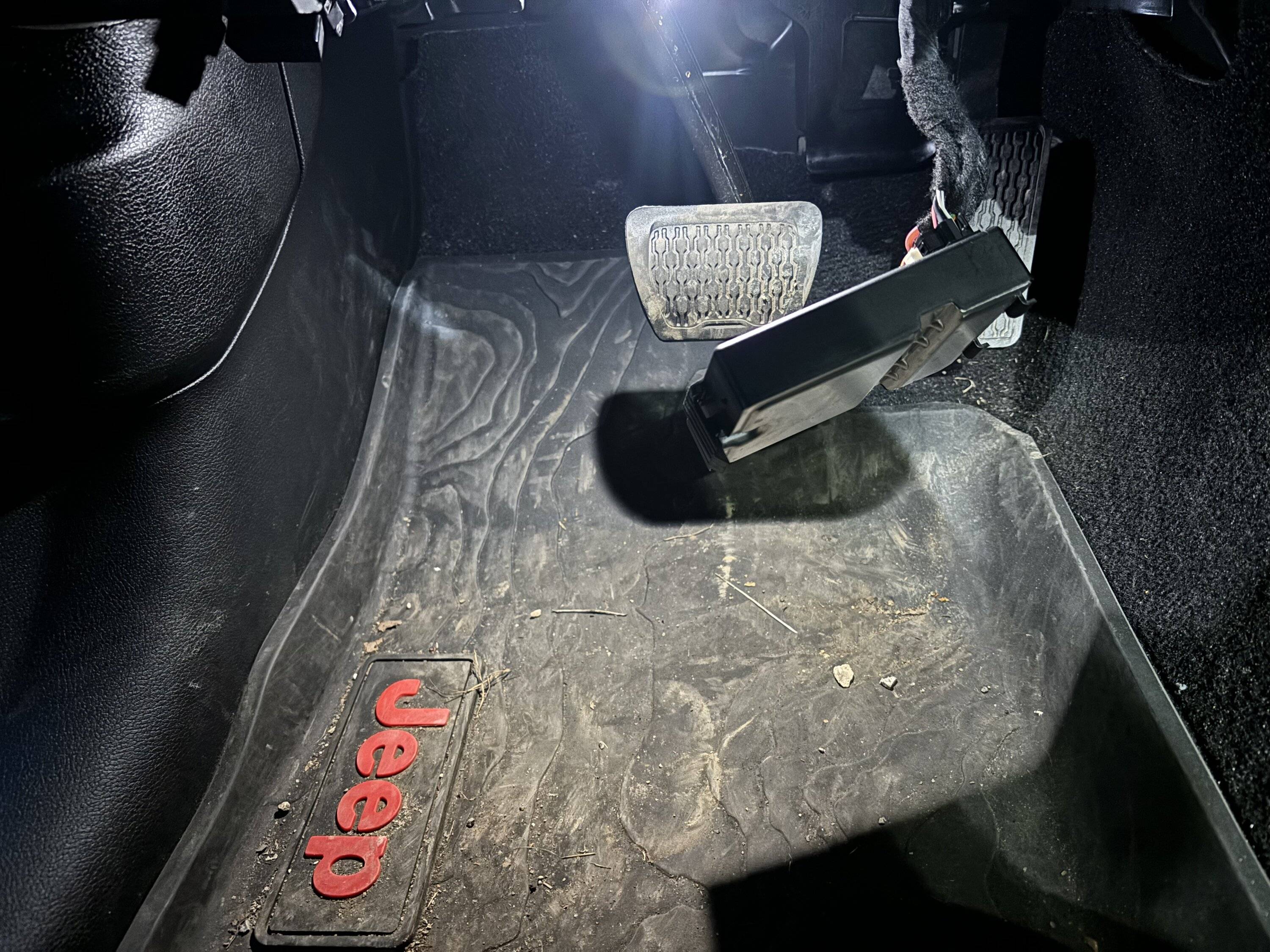

Does anyone know what this is or where it goes? It fell out from under the dash last night. I looked but I don't see where it goes. I might not be getting my head in there far enough though.
*edit* It's the module for the heated seats. I finally searched the right combo of numbers.

Serial # 68530204AB from the module links to Heated Seats.
I grabbed a second number A2C7799280200 from the pic and that too leads to a heated seat module.

I just get curious with all of the trackers that fall out but once I saw the Chrysler symbol I figured it was oem so I just started googling the first numbers from the unit. I'm working from home right now but bored!!!
A tracker was exactly what I thought when I first saw it. I've seen them in other new Jeeps as well.

I found pics on the JLU forum that shows it. It snaps in on the bottom of a plate under the steering column. I'm guessing they have problems with it falling out because all the pics show a zip tie around it as well.
