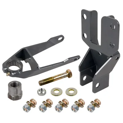

Keep in mind you can't align a Jeep for a hard pull. There's going to be something else.
Tire can cause a pull (but rotating left to right and right to left will test that), stabalizer, even the steering gear, can cause a pull.
But two things about alignment that can lead to a pull can't be changed in these - in respect to a pull. (unless there's damage)
Deleted member 51947
New MT tires, through shaft, etc. Didn't pull before the lift was installed and all alignment specs were in the green. I've rotated and cross rotated tires, to no avail...
