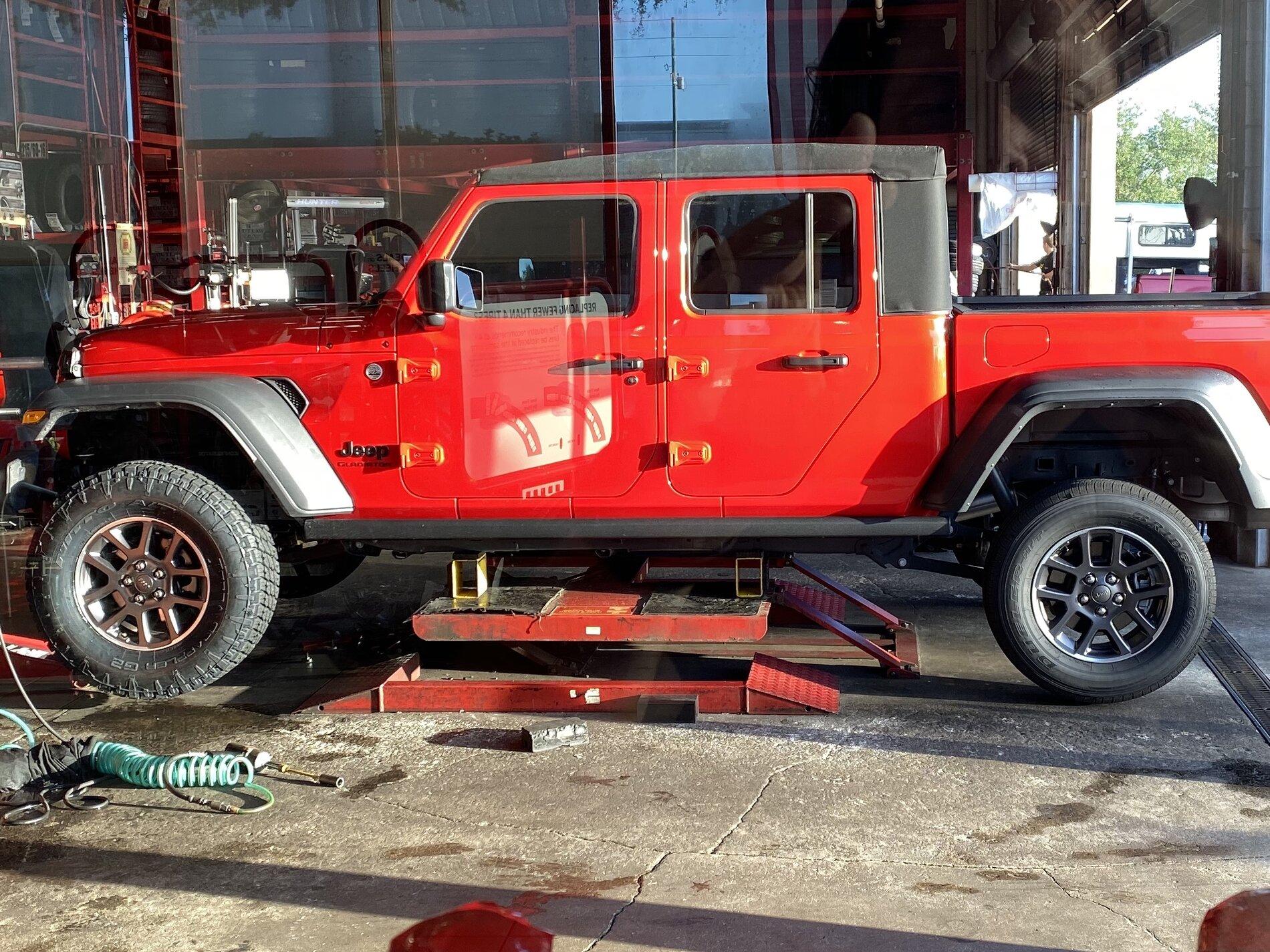

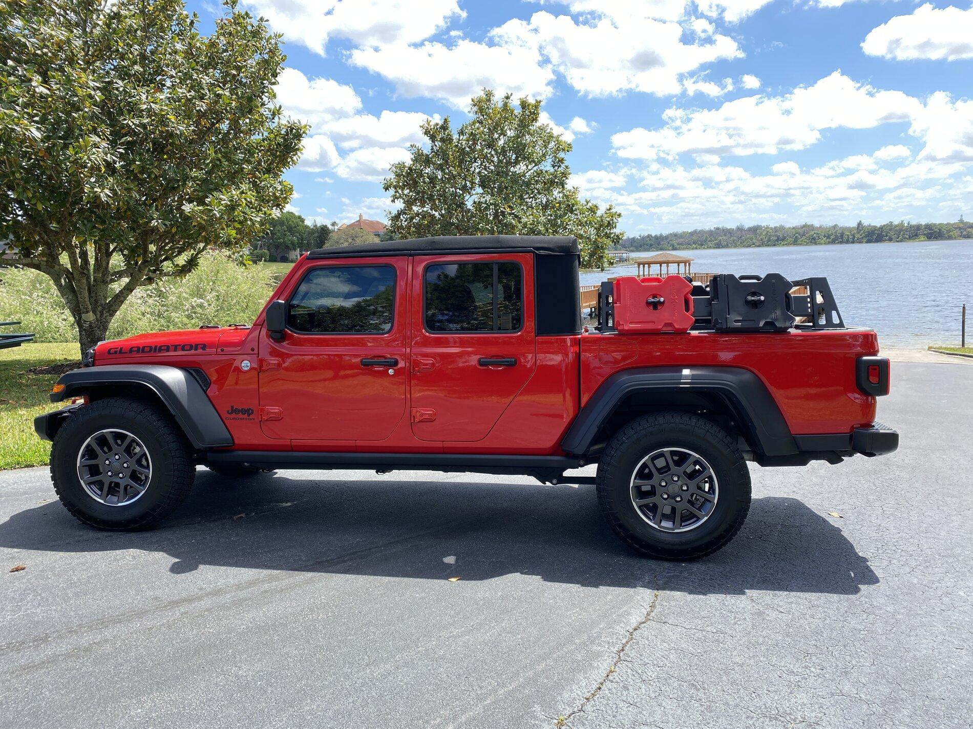

I went back and forth and just settled on the 35". For me, at this time, it didn't seem worth the expense, and the 35s" gave me enough of a better look vs stock.
Jeep Gladiator Lift and/or 37" for Mojave: cons and pros IMG_1983.JPG
Jeep Gladiator Lift and/or 37" for Mojave: cons and pros IMG_9967
