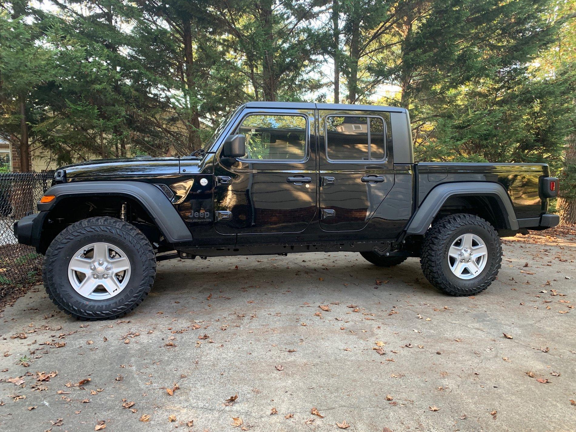

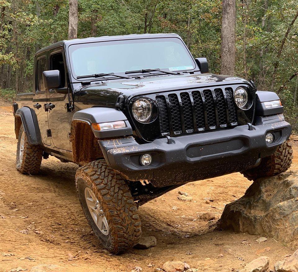

I have the Mopar kit. I bought it (for $1200) because at the time my choices were that or RK which was way over what I could afford. I added JKS quicker disconnects to my SportS and it flexes just fine.
I also knew I could add to it as I went along. I'm currently getting ready to add an adjustable front track bar because I'm going to do the Synergy brace so I figured I might as well while I'm in there. Eventually I'll do adjustable arms for even better flex and for adjustability if I want to add a spacer to correct the bumper/winch weight or for taller springs.
The ride is great. The fox shocks it comes with are full 2.5" body shocks compared to the small ones that come on the Rubicon. Only time I've noticed it be "bouncy" like some say is when I had 1500 lbs of top soil in the bed. It's my daily driver so I'm pretty conscious and aware of how well it rides. No complaints from me at all.
All in all, it's a great starting point. If you want it more complete to start, the JKS kit gets you everything you need including the shocks and adjustable lower arms for right at $2k. Beyond that, I'd go Clayton for a truly complete kit but that's at least $3k by the time you get shocks.

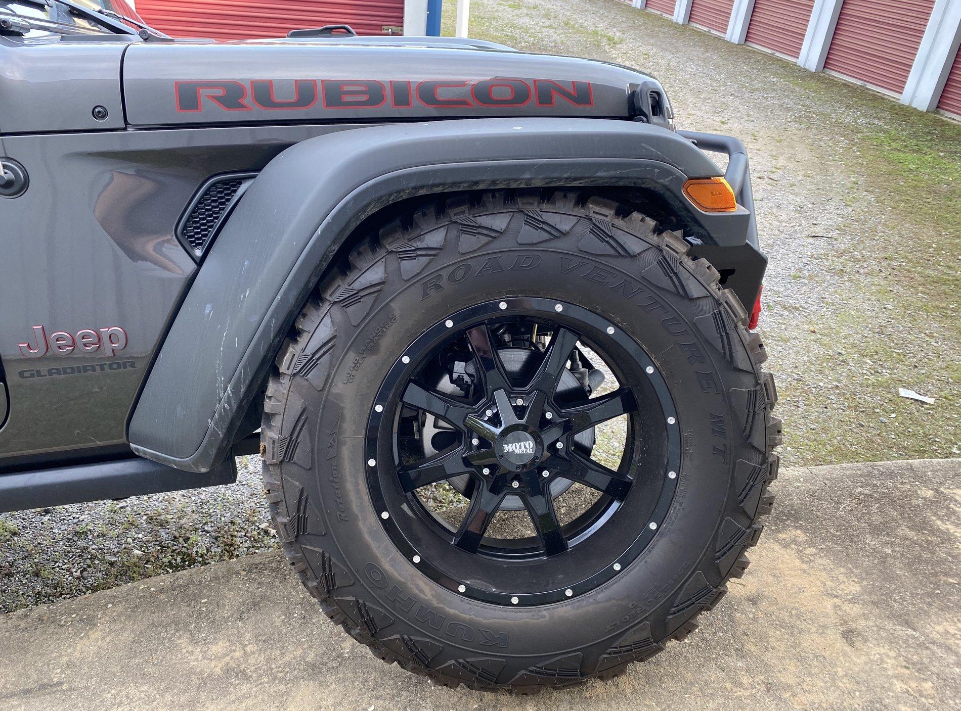

It seems it all depends on what you plan on doing. If you are going to be crawling over rocks maybe a more inclusive kit is better for you. In my case I do mostly dirt roads with some crawling but nothing major like some of these guys so the Mopar kit was my decision. The shocks for lack of a better term are beautiful and a great upgrade over the already extremely nice Fox Rubi shocks. I have a Rancho adjustable track bar arriving tomorrow to recenter the front axle. I have stock 33 MTs so when I bump up to 35s I will add a spacer to level it out. At that point I will likely add Rancho adjustable LCAs at the same time to correct the geometry from the spacer kit.
My main reason for the Mopar was it is Mopar and everyone said the ride was comparable to stock which I agree. Granted I've only had mine on for a week so things still need to settle in. I did not want to risk lifting with a different brand and risk having a harsh ride.
Mine is a Rubi also.

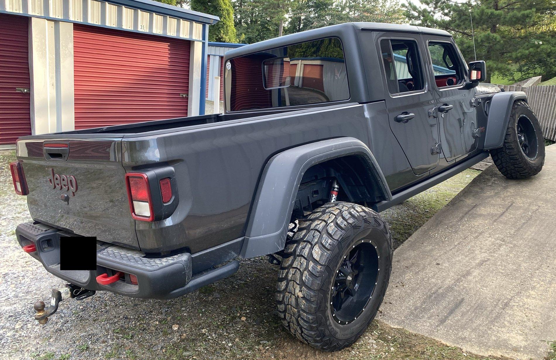

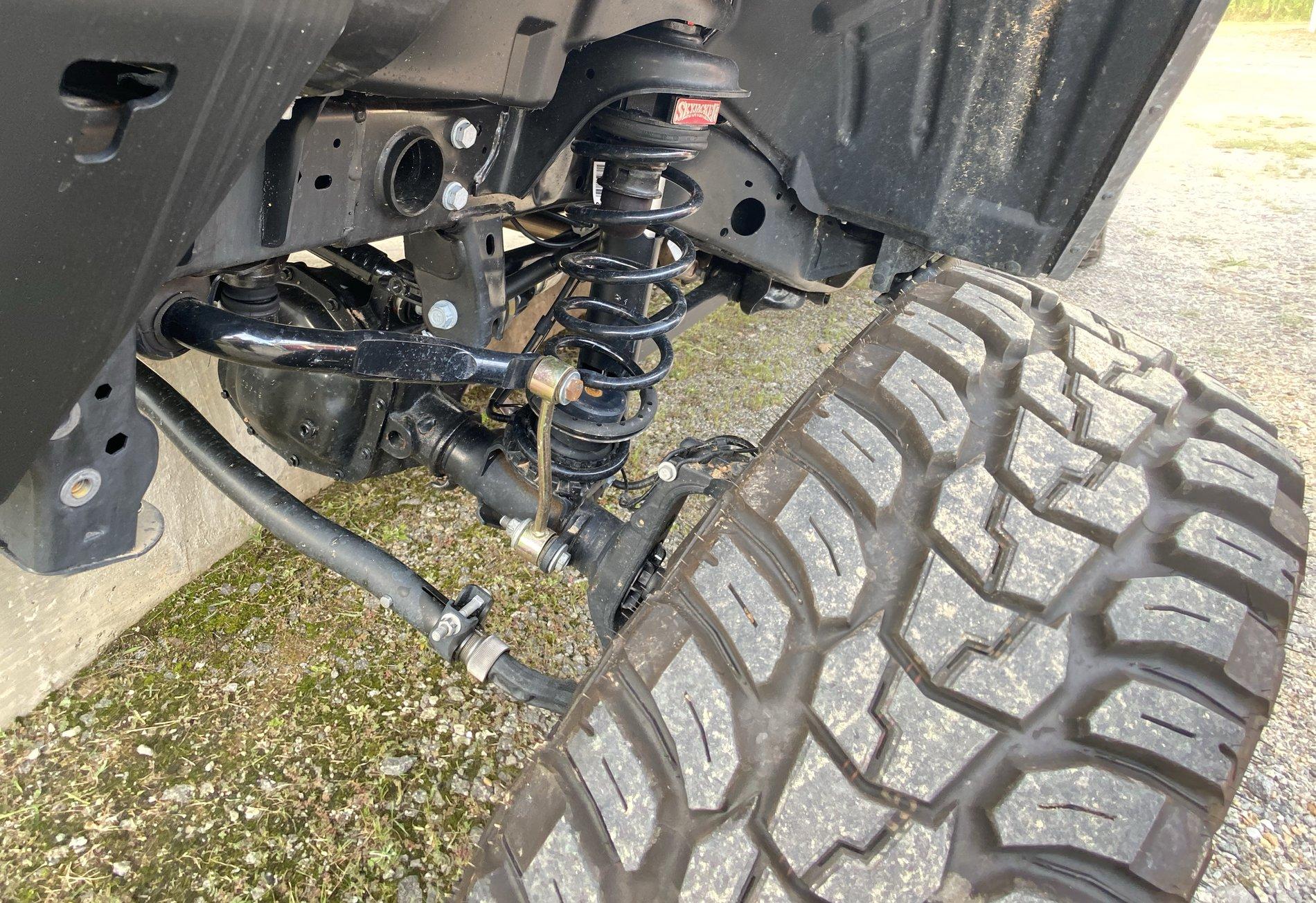

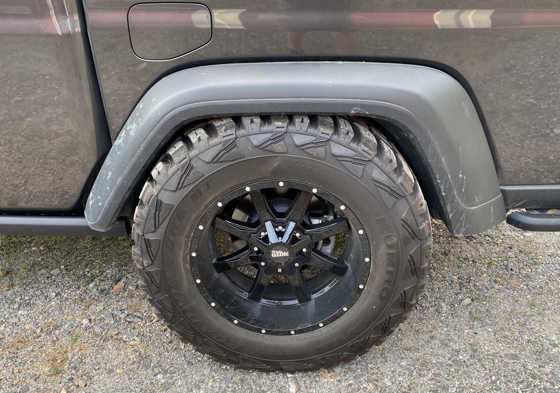

This is a stock Rubicon suspension with a Skyjacker G250MSB (2.5" front, 1.0" rear) spacer lift and 37's, with the sway bar disconnected. I'm getting just shy of 3' of flex (+/- 33") from a flat surface. Not bad for a stock Rubicon with spacers...
I'm swapping all that out for an EVO Manufacturing Enforcer 2.5" Stage 2 Plus suspension lift very soon. Then I should have no problems getting 3.5' of flex, which will be plain-ole' ridiculous for a "truck". ;)
