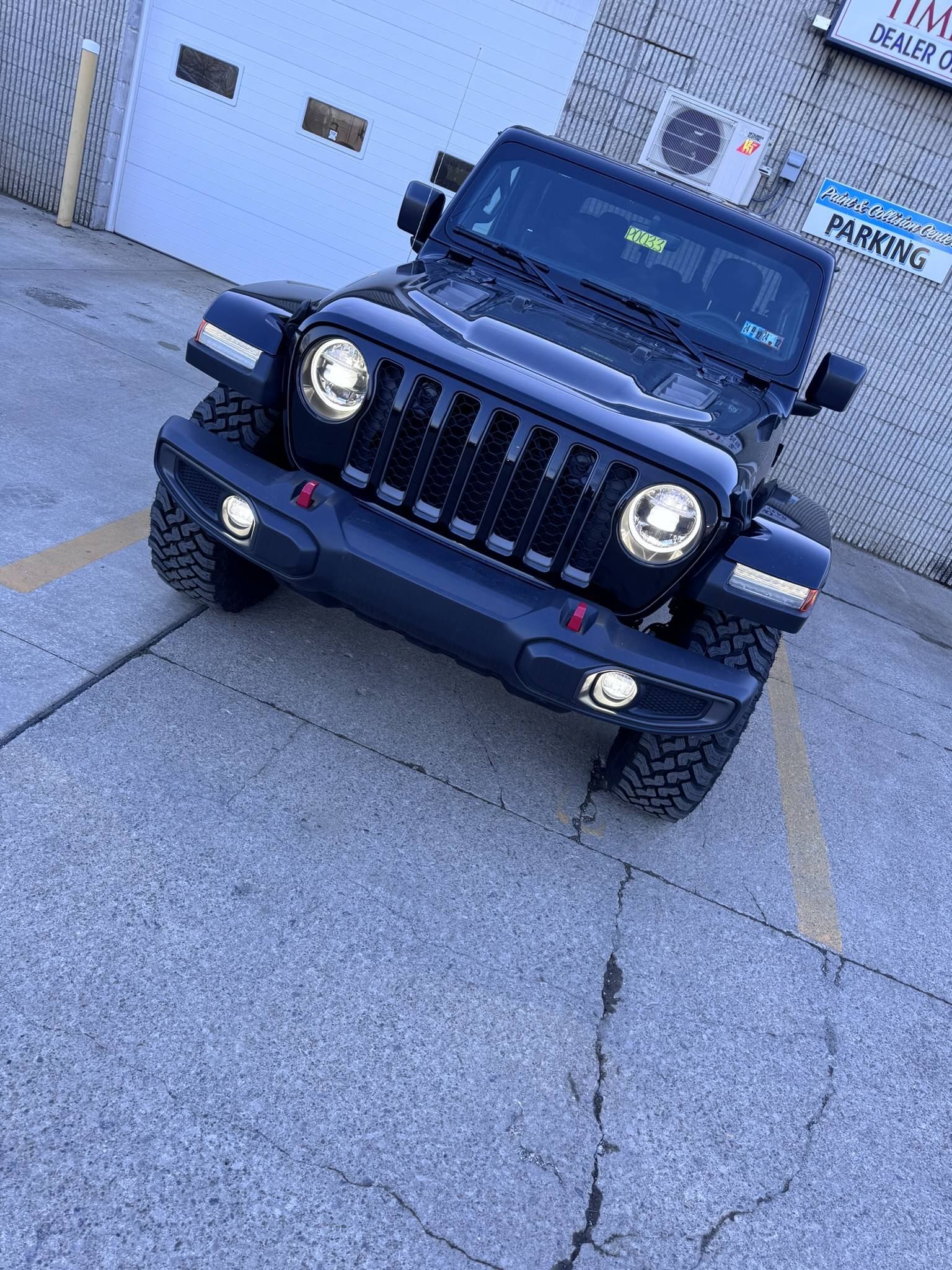

Keep in mind the Mopar steel bumper does not come with a skid plate. Which means if you find a Rubicon black or Mojave silver skid plate that come standard with their plastic bumper, it will not fit with the steel bumper without modifications.
If you find one used, hopefully it has the fog lights in it. Not a big deal but the ones in your plastic bumper require aftermarket housings to fit into the steel.
im likely going to go with the mopar one. It comes pre wired with led in it. I’ll save my led’s as backups. Easy install and no hassle. I’ve watched videos on the other ones and a 2 hour assembly and hour install I’ll pass. My time is worth more than a few hundred bucks.
Do you by chance know the mopar skid plate number? Or can you recommend a plate that will fit?
