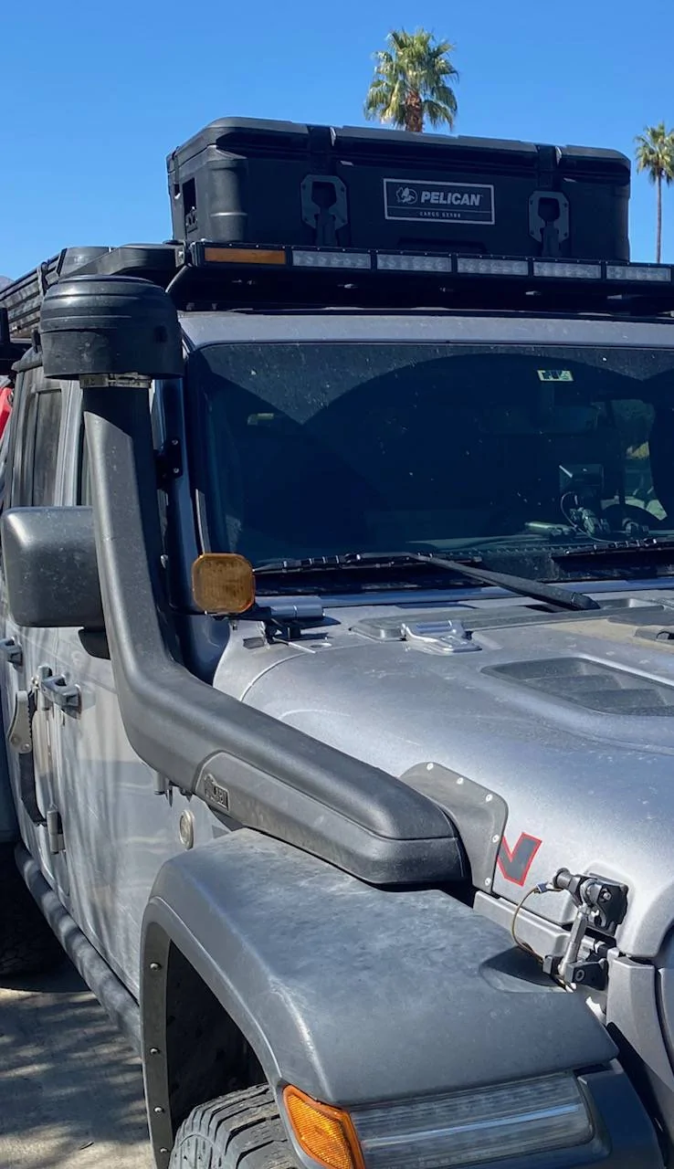

One option to consider if you want to avoid drilling is to use a KC Universal Wire Hider along your windshield then feed the wires through your cowl. This is what I did with my lightbar and has worked well for me.

Thanks for the suggestion.
The Bestop rack is designed to only cover the rear of the gladiator hardtop so that you can still remove the freedom panels. The light will be back off the cowling behind the rearmost portion of the freedom panels.
I looked at the KC solution you posted. Looked like it was designed to be hidden with the mount that attaches to the fenders. Am I wrong, was there another way to use the wire hider I might have missed?
thanks for your reply though!
