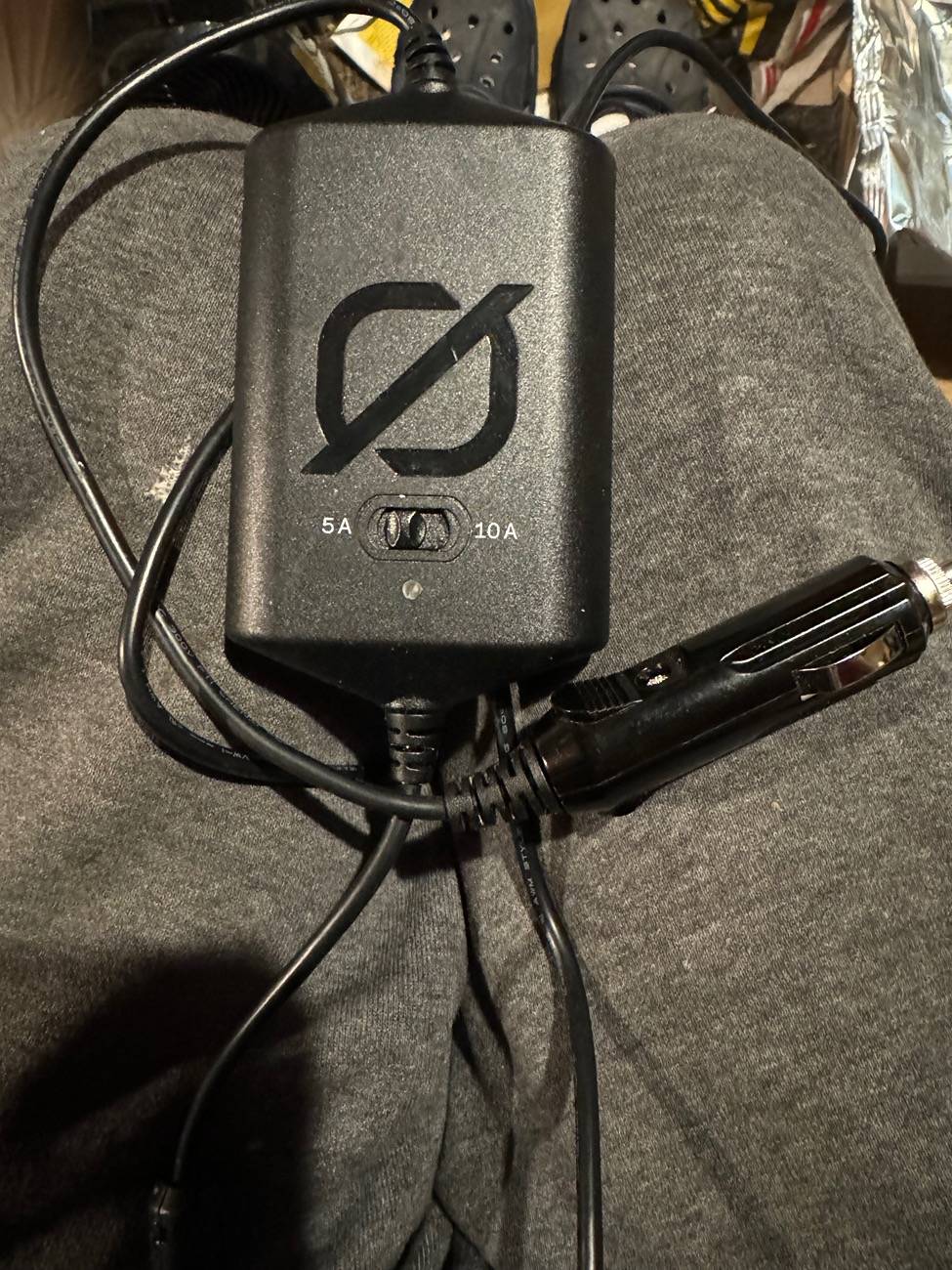

The goal zero DC charger has a 5 or 10amp charge rate setting. When driving between camping spots on a road trip, the battery (1000wh) was always fully charged. The refer which could be run on ac or dc, was at operating temps from the jeeps 400w inverter. Because the refer/freezer was already cold, it drew very few amps when plugged into the solar gen battery overnight. You could run the refer for 2.5 days without solar power input.
