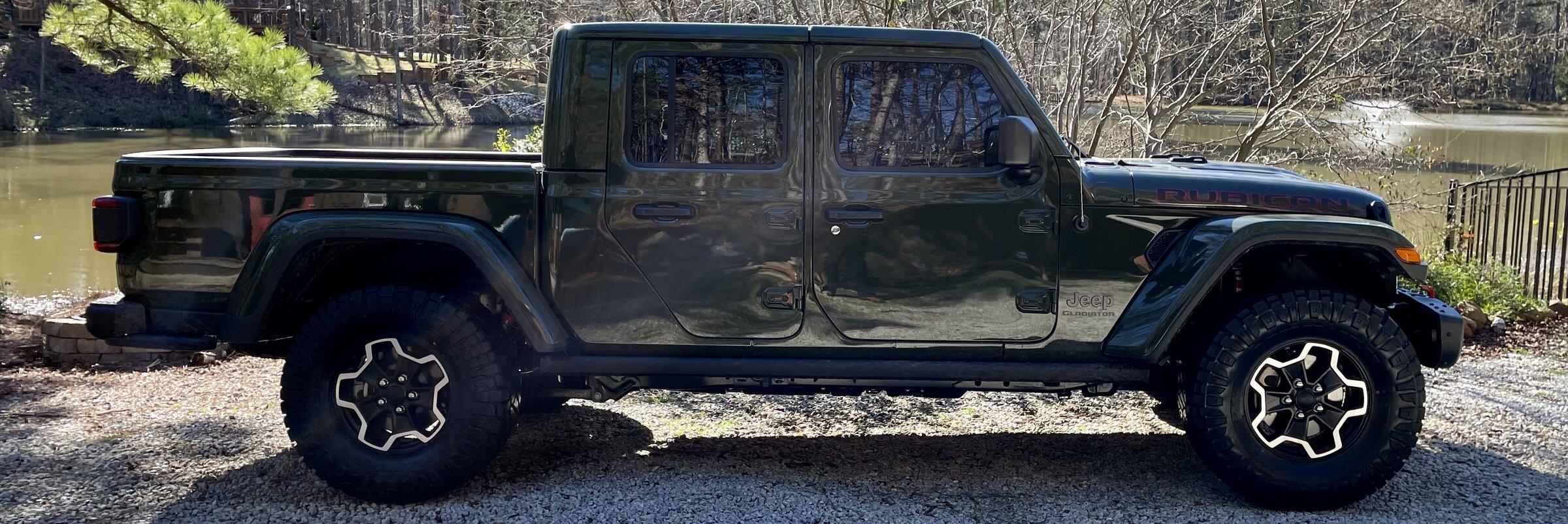

Installed the 35s today. I have wheels on order but given supply chain likely won’t see them before the end of January. These Nitto Ridge Grapplers are significantly more quiet than the stock 33” Falken M/Ts
