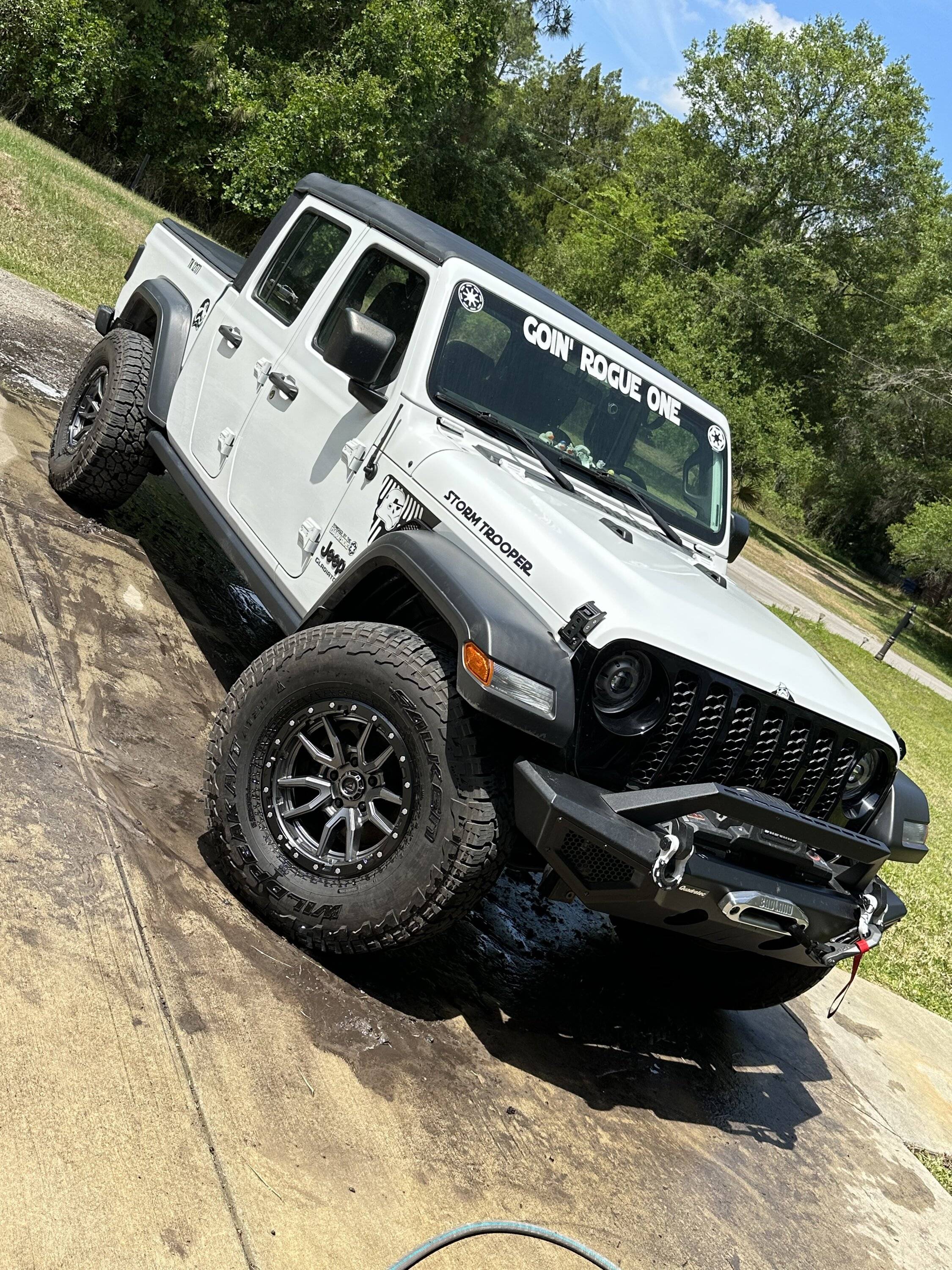

Had my '21 Sport for a couple years now, but it's my first Jeep and still navigating necessities vs. nice to haves as I open my wallet for more upgrades/mods. Currently it's on a JTR take-off suspension with Falken WildPeak AT3 35s and a 6MT which means it's a dog to get moving with 3.73s with the larger tires and extra rotational mass.
So, I pulled the trigger on a set of Spicer 5.13s this week and am now looking at lockers since it'll have to be apart soon anyway. I know 5.13s are a bit steep, but the goal is a 3.5-4.5" lift and 37-38s not long after the regearing and these 3.6s seem to beg for RPMs to provide any real power. I welcome any recommendations on lift kits or parts for a custom lift since I'm sure I'll be ordering something in the next 6 months or so, depending on when the gears arrive and get installed.
So, first question, how useful will it be to have front and rear lockers on a rig that will see mostly Florida trails with the occasional trip to areas like TN, NC, TX and perhaps UT to ride some different trails? Mainly looking for pros and cons to installing both front and rear lockers to justify the expense for both or go the single locker route and save a few bucks towards the lift, bigger tires, etc.
Second question open for discussion, does anyone have experience with OX lockers using electric actuation for shifting? I have a Voswitch aux panel already, so trying to avoid adding a compressor to go the air actuation route for what it's worth and have plenty of open switches. I've also been looking at Eaton e-lockers but am heavily leaning toward the OX lockers for the ability to manually lock if needed and overall pricing, though that may balance out some with the install cost. Any downsides to OX lockers that I may be missing here? Trying to spend money as effectively as possible so that I am able to tackle more than just the Florida mud holes!
Jeep Gladiator Regearing '21 Sport - Front and rear lockers too? IMG_1995

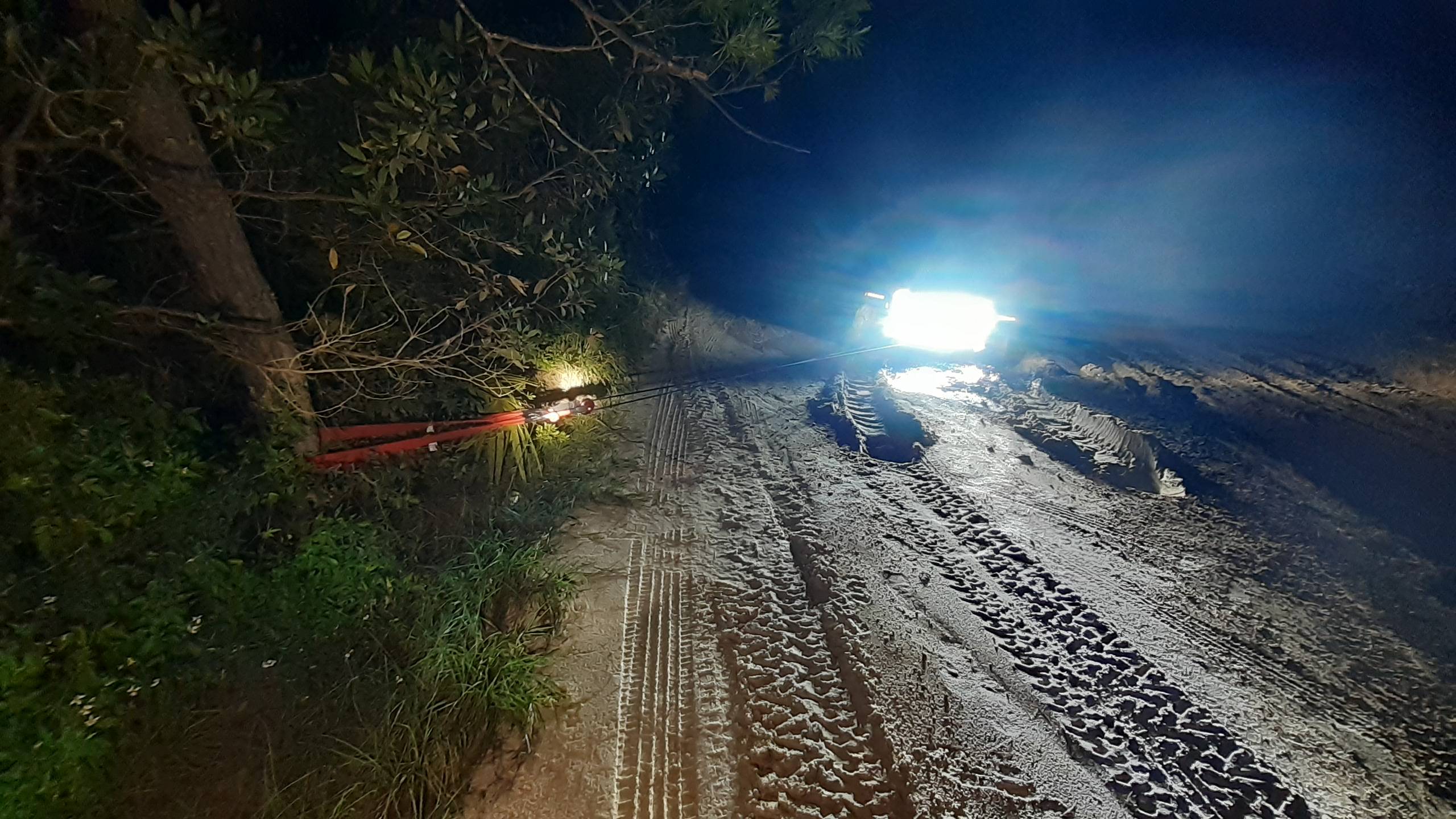

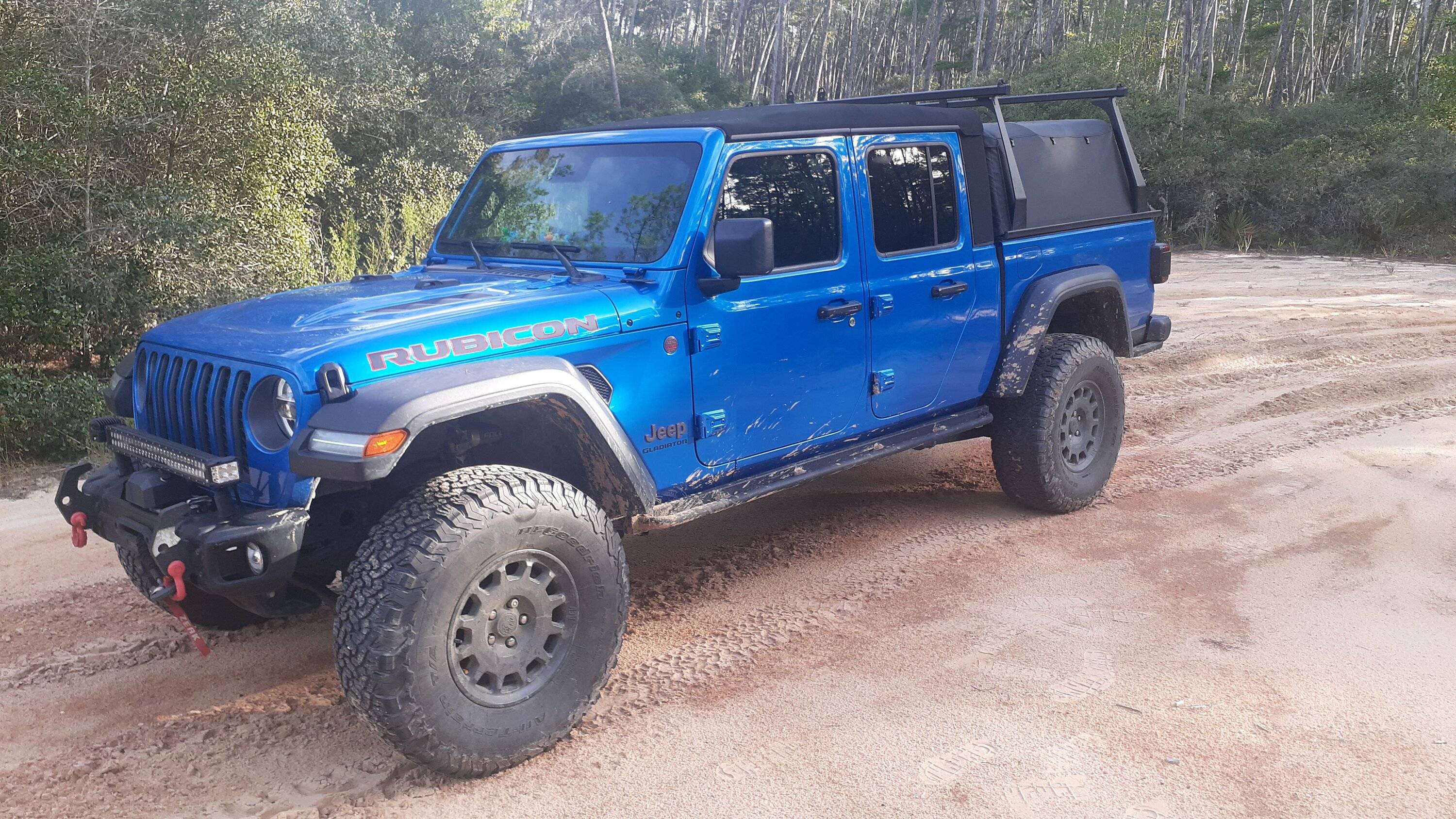

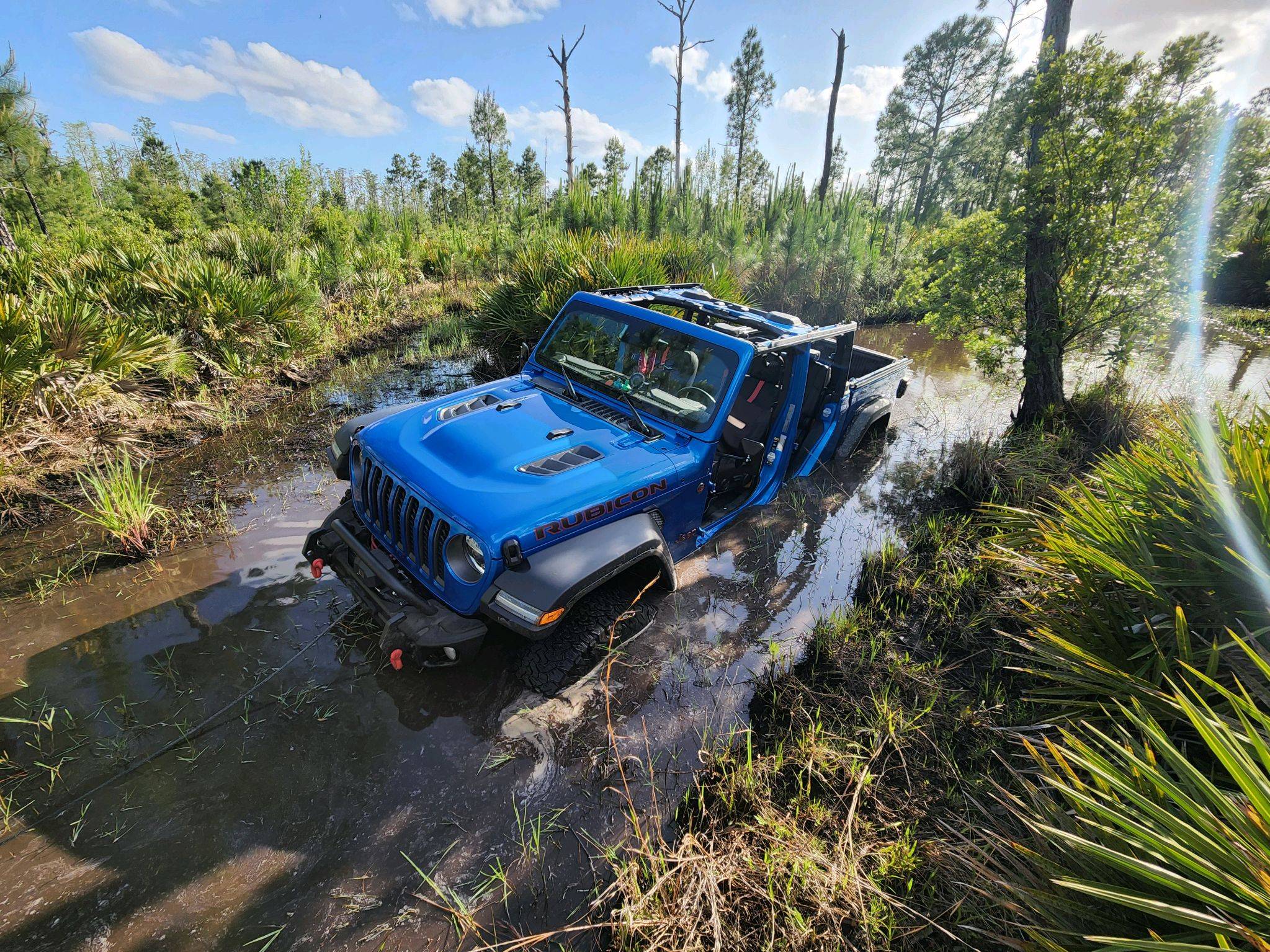

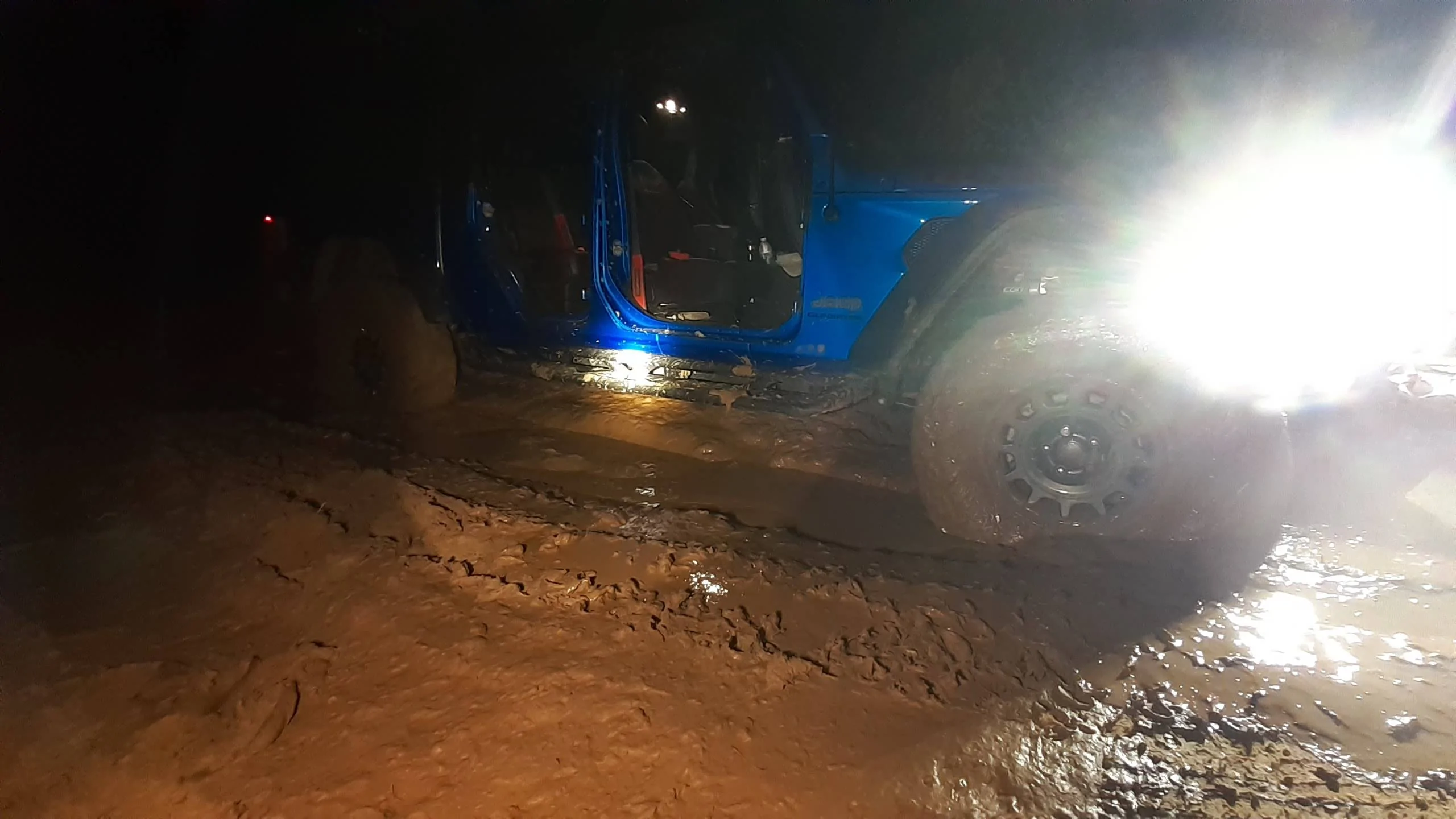

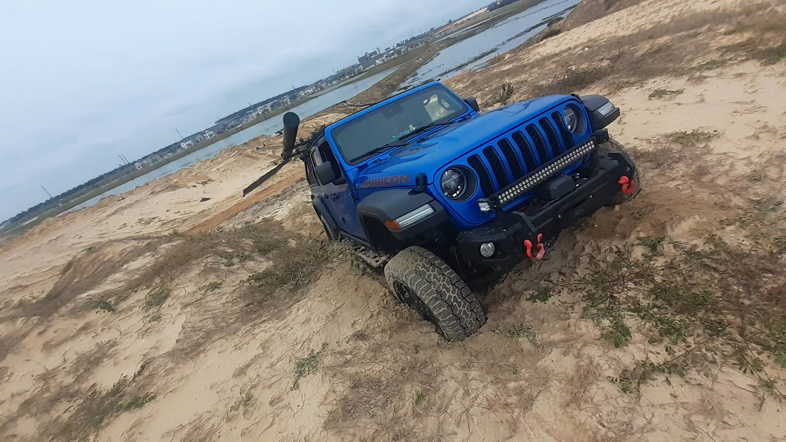

As a fellow Florida trail rider I can say that tires, lift, and a good winch are likely as much or possibly more necessary than lockers. Where your at I would consider budgeting a snorkel too.
It's hard to say if lockers have kept me from otherwise getting stuck. I can't recall a time when I've gotten stuck, then turned the lockers on and got out. If I see a place where I think I'll need them, I turn them on, so it's hard to tell how much they make a difference.

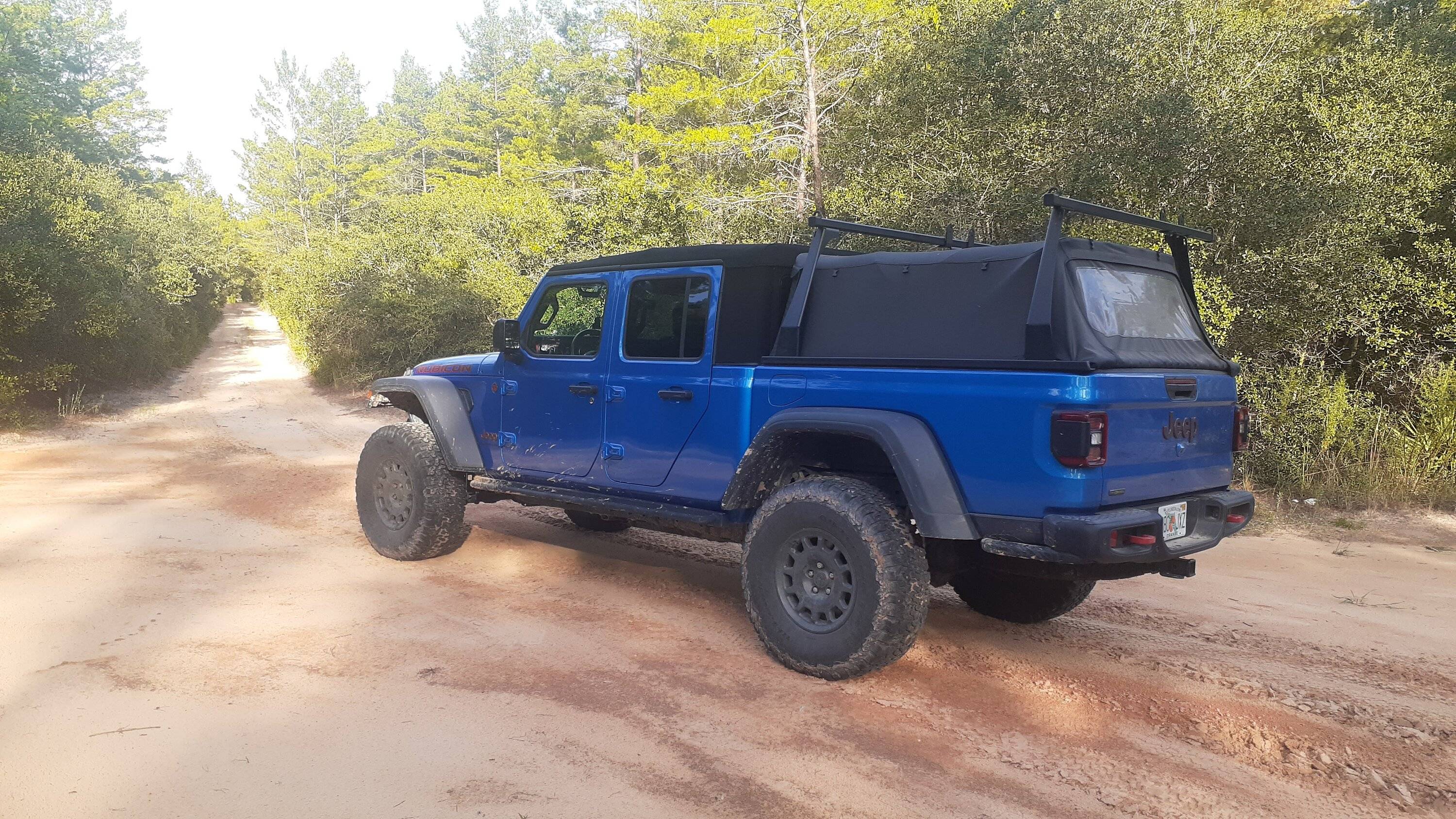

I've been stuck 3 times. Once on a sand hill, once on a clay dip, and once in a mud hole when I got hung up on a submerged log. On the 1st and 3rd I had the lockers on going in. On the 2nd I turned them on when I realized I was in trouble. The first one I had factory falken 33" A/Ts, the other 2 were with 37" KO2s. The first one I dug myself out of, (keeping a small shovel in the bed is very helpful,) and the other 2 I winched out no problem.
I think it's possible if not likely I wouldn'tve gotten stuck at all if I had M/Ts in all those instances.
I will say this- when I get off the blacktop first thing I do is lock the rear diff in 2H. If I see something that looks a little tricky (shallow mud, soft sand) I throw it into "Mojave Mode" which is 4H with the rear locked. If I see something really suspicious and no fresh tire tracks coming out the other side, both diffs get locked.
This is all on A/Ts. I just bought some M/Ts and am eager to see the difference. Truck has a 3.5" lift in the pics.
the Wildpeaks (in my opinion) are great all-around tires that can do some decent trail work as well.
I have found the Wildpeak A/Ts not a good tire for loose dirt, mud and sand, especially sand which we have a lot of. Instead of Wildpeaks they should be called badgers because they really like to dig right down.
In contrast, I don't even air down my KO2s in the sugariest of sand and they float right over (with lockers on.)
