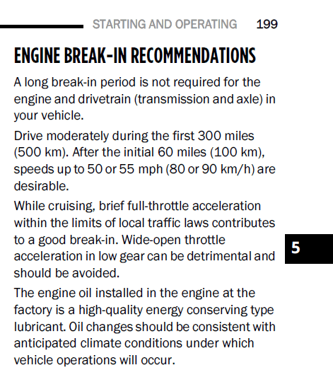

I've built more than a few dozen engines over the years, if anyone wants, can provide the info supplied by the manufacturers of rings (Federal Mogul and others), bearings, etc.
but pretty much ignore what the after-market cam companies talk these days. It's rubbish, not necessary.
Bottom line is to take the vehicle out on an open road, full throttle acceleration up to about 50-55 mph in as high a gear as possible - you want to load the engine but not lug it. It's easier in a stick - because you control the load on the engine.
Slow back down, do the same acceleration in a high gear but not lugging - up to about 55-60 - repeat about 10 times.
Rings are broken in.
You want to FLEX the rings and you want high pressure on the top side of the ring, lower pressure or vacuum on the bottom side.
The rings are made so they twist, a torsional force is applied, as they work. This forces the bottom edge of the ring out to the cylinder, literally twisting the ring and forcing it out as combustion gases get behind the ring from the high cylinder pressures, forcing it out hard.
This is why they don't want lazy driving, slow sustained speed or high sustained speed - you end up GLAZING the cylinder walls.
I can dig up some pictures as well, I suspect.
In summary - they want high cylinder pressures, such as an engine being pushed but not lugged, get up to speed, do this several times
They want the rings forced out.
Engine braking actually does the opposite as you pull a strong vacuum in the cylinder and flex the other way. High vacuum like downshifting and using engine braking won't accomplish forcing rings out - it lets them float.
Again, can pull from engine books and the manufacturers' info if there's a demand for more info. I've got some books on performance engine building as well.
No, break-in procedures are the same today as they were in the 70s. Technology has changed but the parts you are breaking in really haven't. Even the machine shop I last used said pretty much the same thing. Break it in like they talked 40 years ago and it'll be just fine.
The real "break-in" as far as rings and bearings is pretty much done. It's the high points that get worn down. There will be further "wear-in" over time, typically happens up to 10,000 miles - so you may see mileage improve over that time period as well as the bearings even out further. But once you get it - the bit about ring break-in is all done with. IF it's not done in the first few miles, it's not going to help doing it now. Cylinder glazing results.
