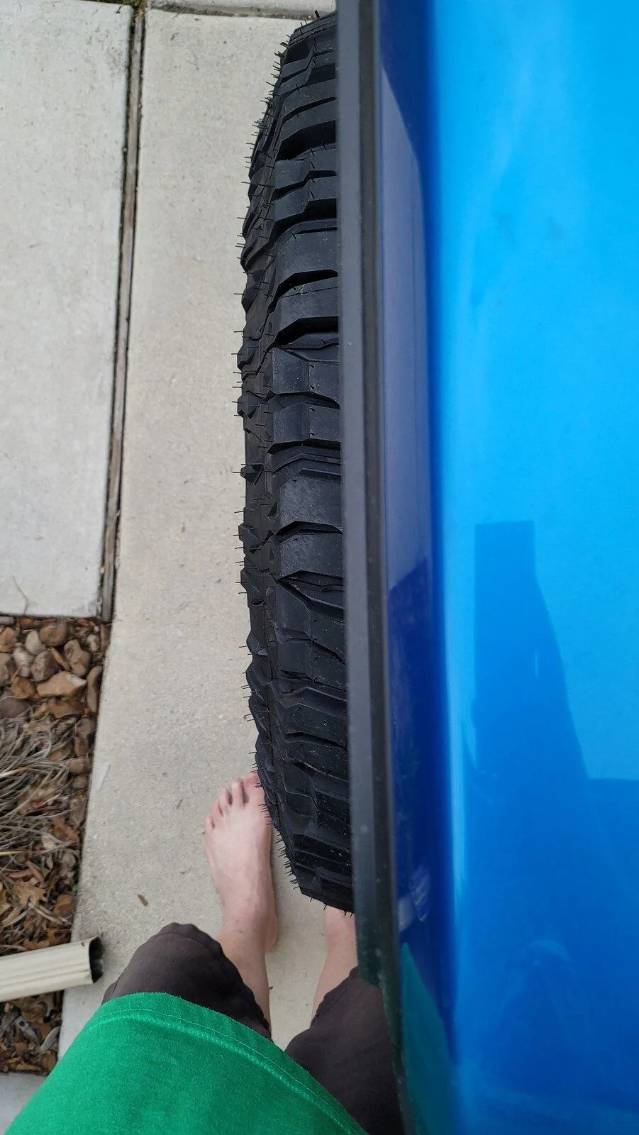

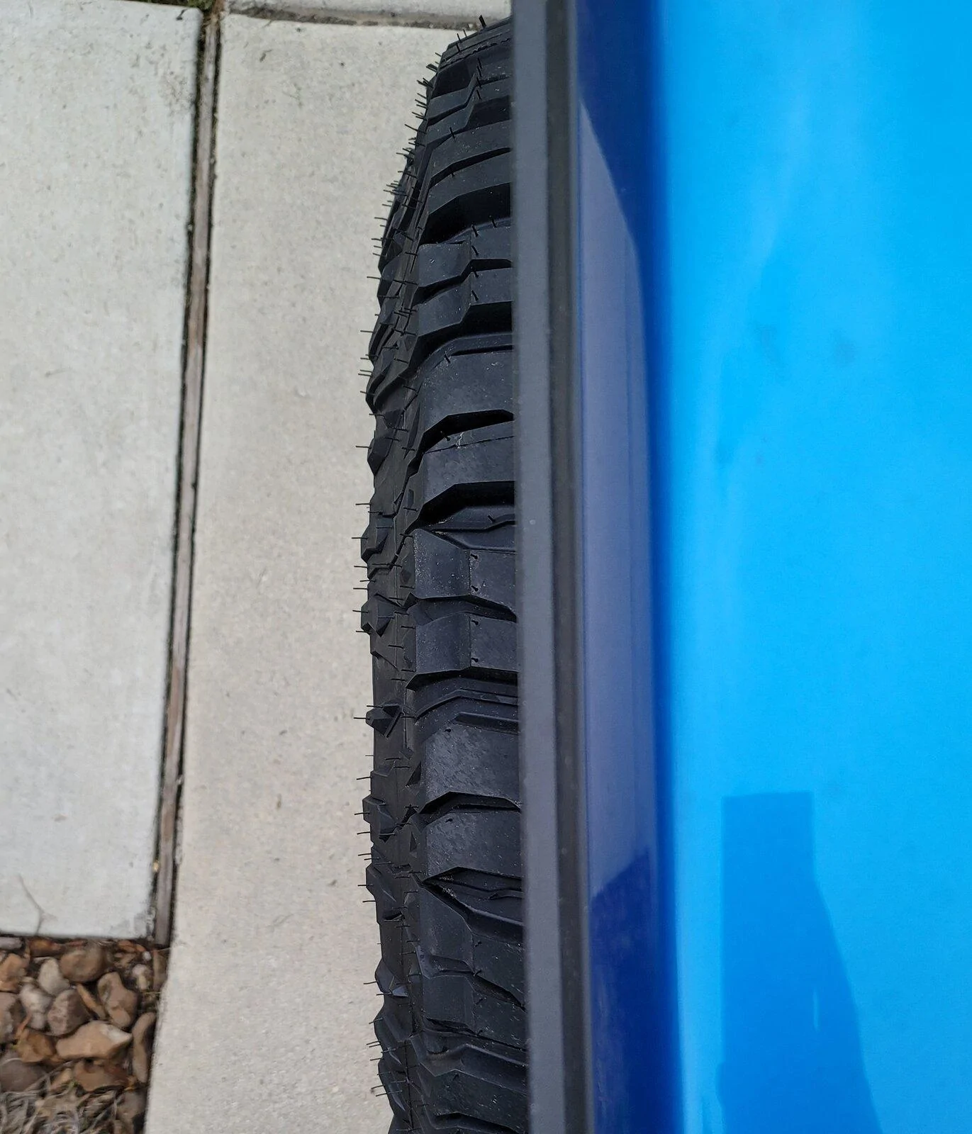

They will poke with -12mm on 17x9
Jeep Gladiator 17x9 -12 rims on wide track axles 20210523_195234
Jeep Gladiator 17x9 -12 rims on wide track axles 20210523_195215

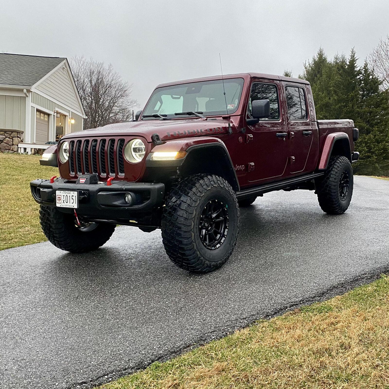

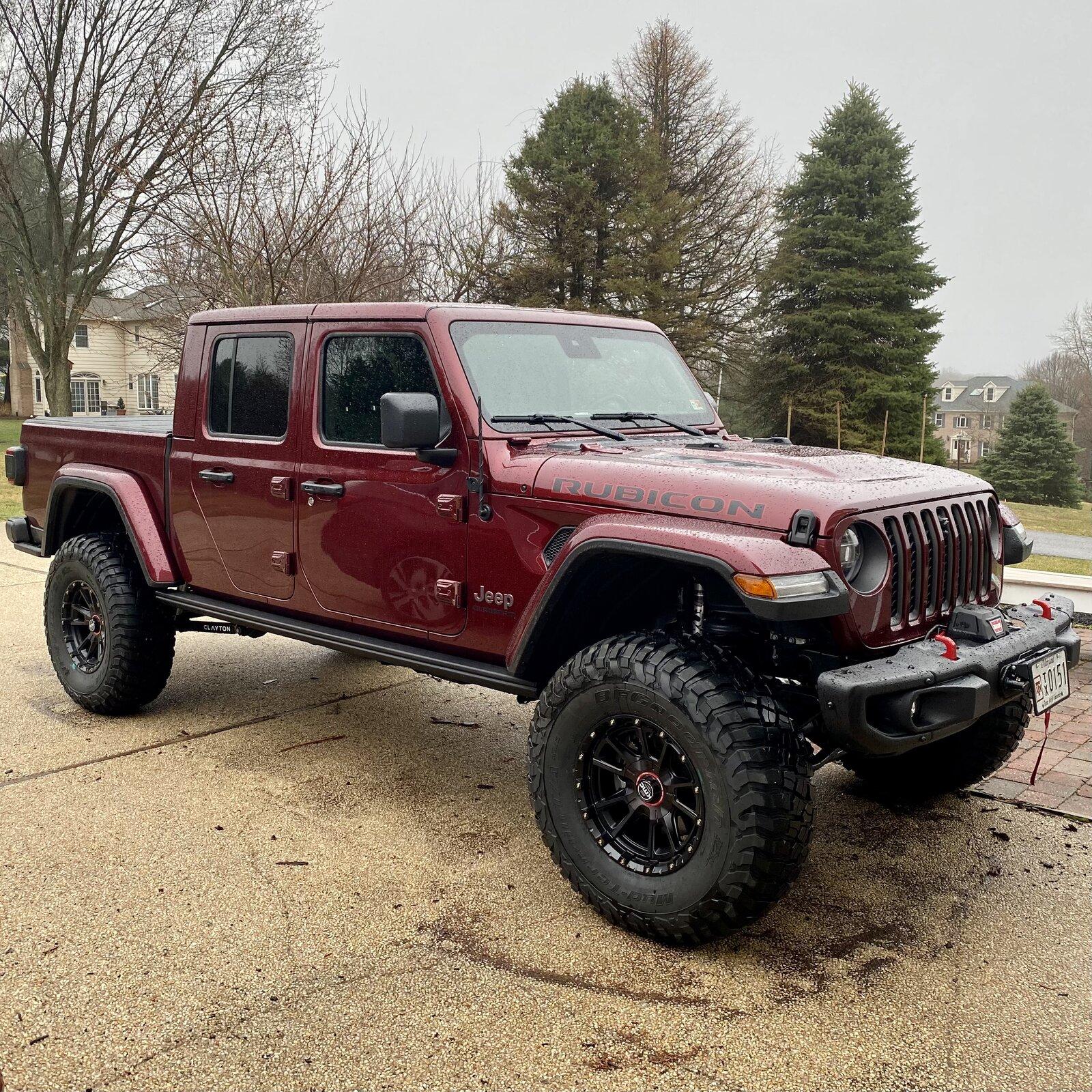

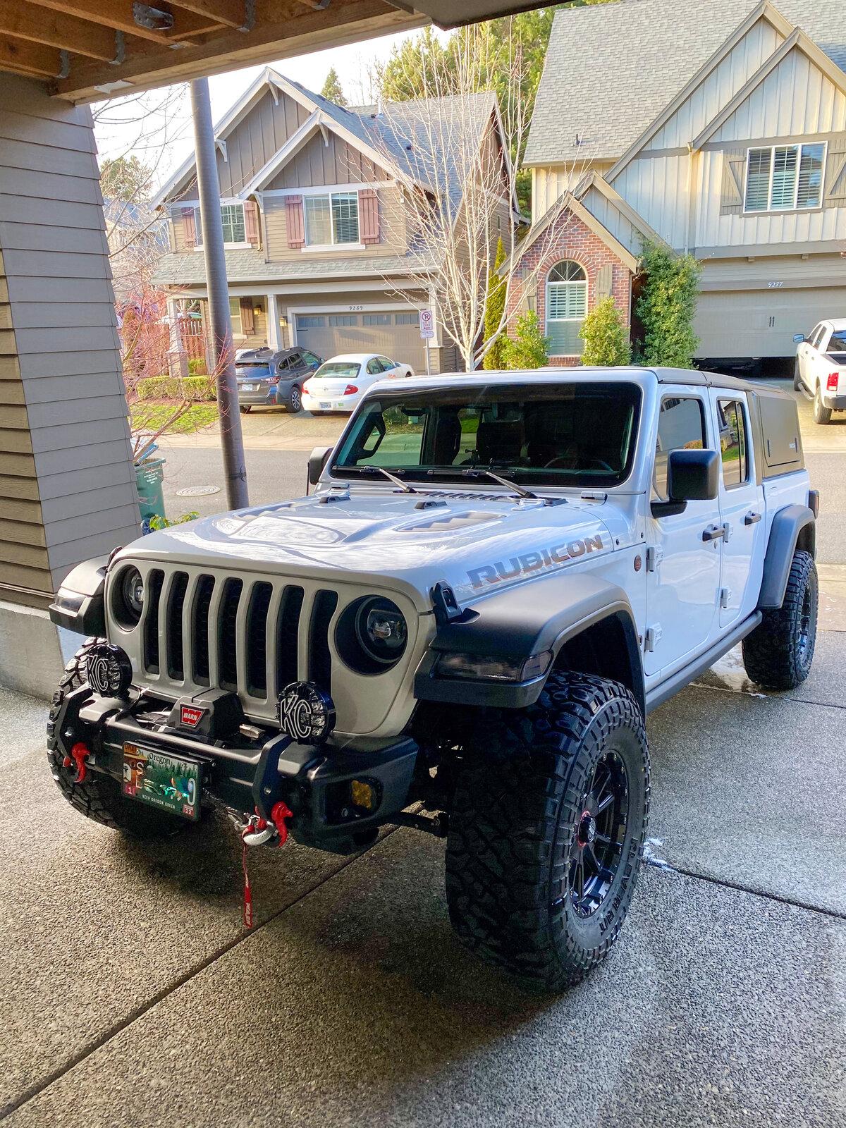

Hmm, I don’t have great pics of his showing poke, but his specs are 17x9 +0 on 37x12.5r17:
Jeep Gladiator 17x9 -12 rims on wide track axles 89990AEC-80A0-48D4-9FA5-A73D0C148B40
Jeep Gladiator 17x9 -12 rims on wide track axles BCC8B1CE-01C8-45F4-9F0D-47E35E936A62

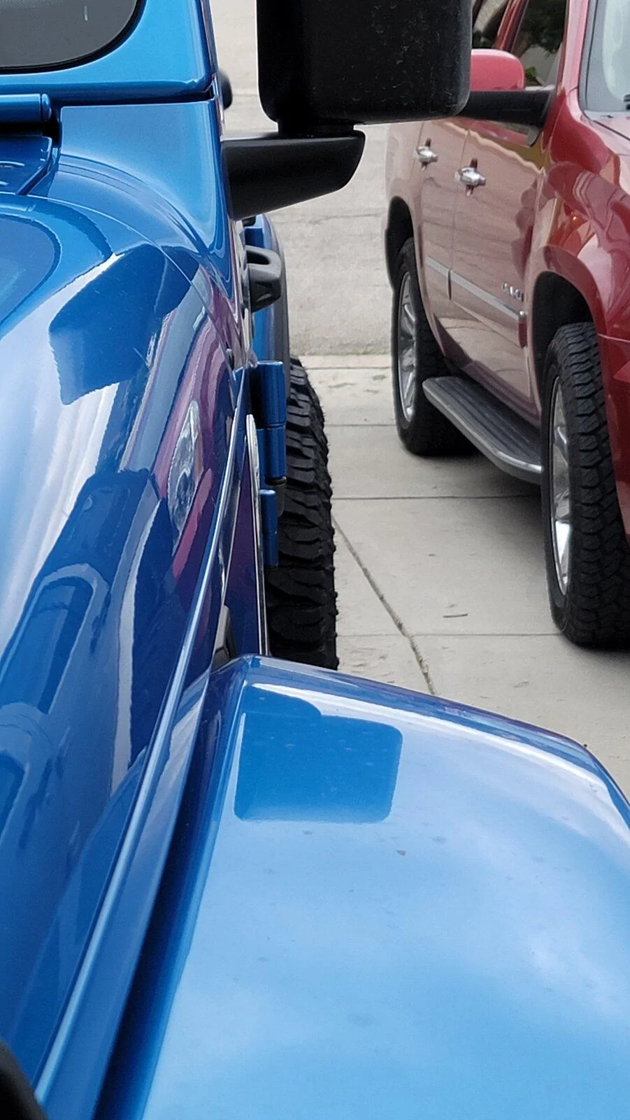

Mine are 17x9 +18 on 35x12.5r17 (Both are KM100 Sync)
Jeep Gladiator 17x9 -12 rims on wide track axles FA37A7C6-56EC-4E73-AF03-5C6312037313
Mine have some poke in front and hardly any in the rear. But, also a 12.5 inch wide tire compared to the 11.5 you will run. The +0 will poke ~3/4 of an inch more.
