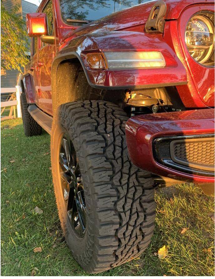

You can use either +12 or -12. You'll have enough clearance with +12 if you want to keep the tires more tucked.
Here is mine with 1.5" wheel spacers which makes it equivalent to +6:
Jeep Gladiator 33x12.5x17 Tires on Gladiator Sport Nighthawk with Wide Axles Ultraterrain on JT

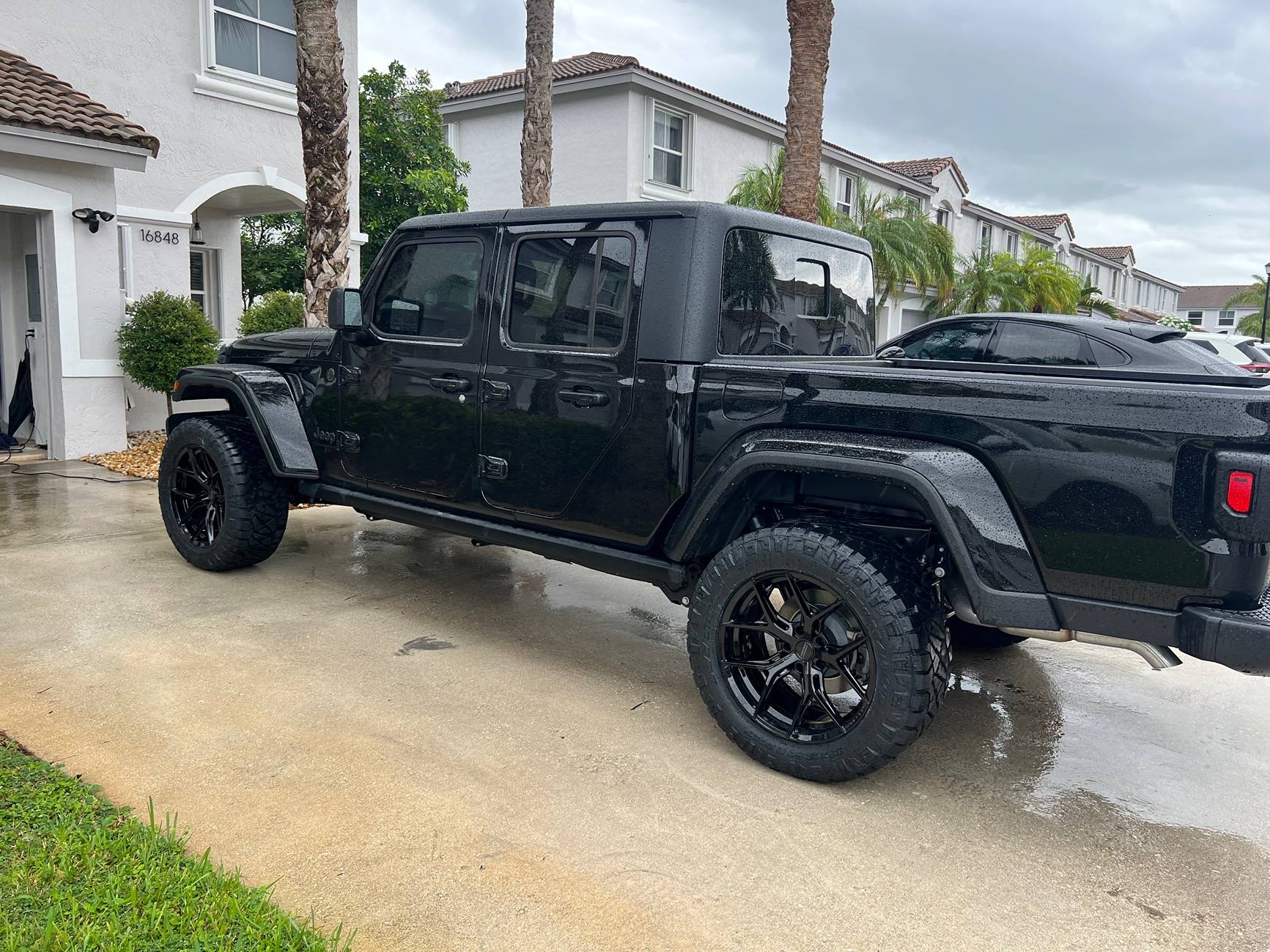

Not sure if this will help. I just picked up 2024 sport s i went with Vossen 20x10 33 tire
Jeep Gladiator 33x12.5x17 Tires on Gladiator Sport Nighthawk with Wide Axles IMG_9664

Thanks for your replies!!! I was able to visualize the changes with tiresize.com after confirming the stock wheels have a +46mm offset so i went with the +12 as to not have 2+ inches of poke, went ahead and ordered the wheels! Will upload some pics when done

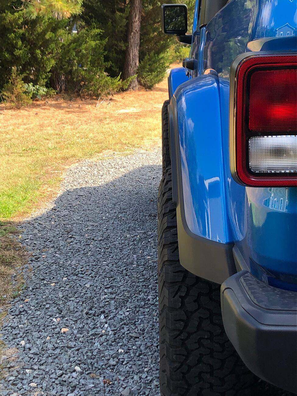

+12 8.5x17 5.22 BS with 37 12.50 17 KO2s

booster84
Roberto
Oct 2, 2024
Columbus, IN
2024 Gladiator Nighthawk
Technical Service Manager
Thanks that’s not bad at all. This is my daily and I don’t want anything crazy.
