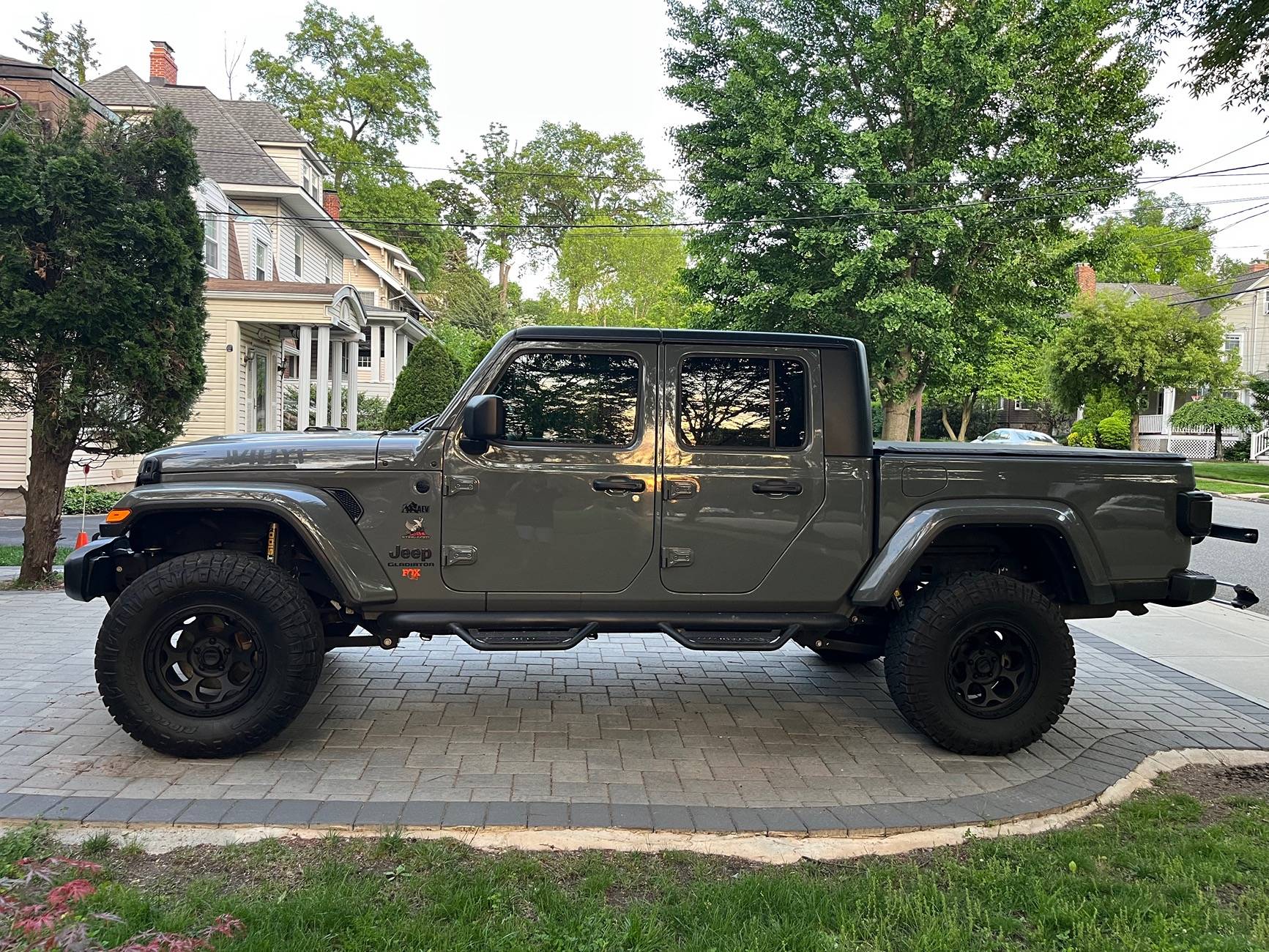

Jeep Gladiator 2-2.5" Spacer Lift - What variables to consider when lifting? IMG_0165

I ended up going with the 2.5 TF spacer lift with teraflex front LCAs, and TF adjustable front/rear track bar.

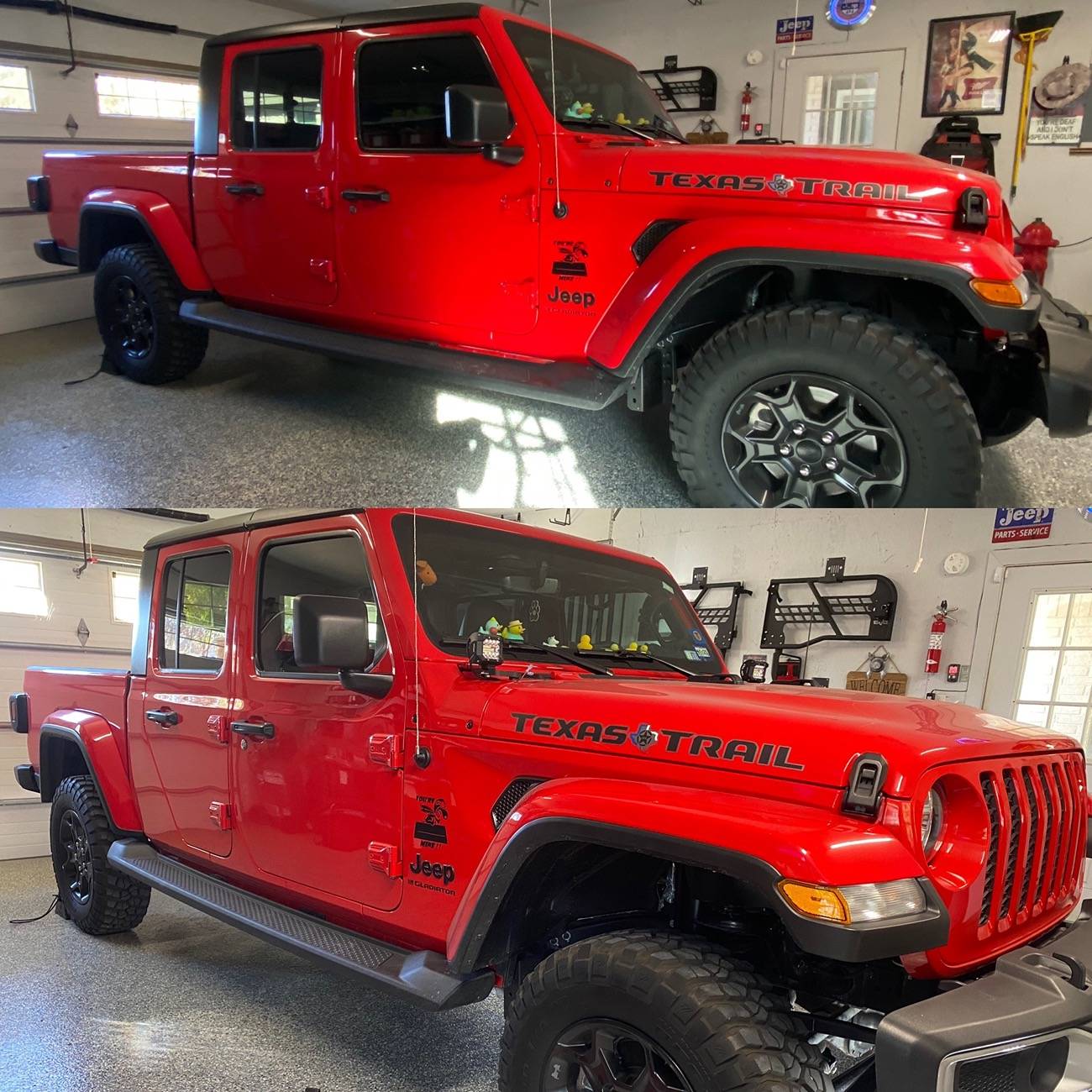

i put the 2.5 teraflex spacer on mine with falcon shocks. The back only came with a .5 spacer. I am really surprised by this as the front seems to sit higher than the back now. I think it should have at least came with a 3/4 or a 1" minimum. I feel like ill have to get something else in back to acheive the look I am wanting.
