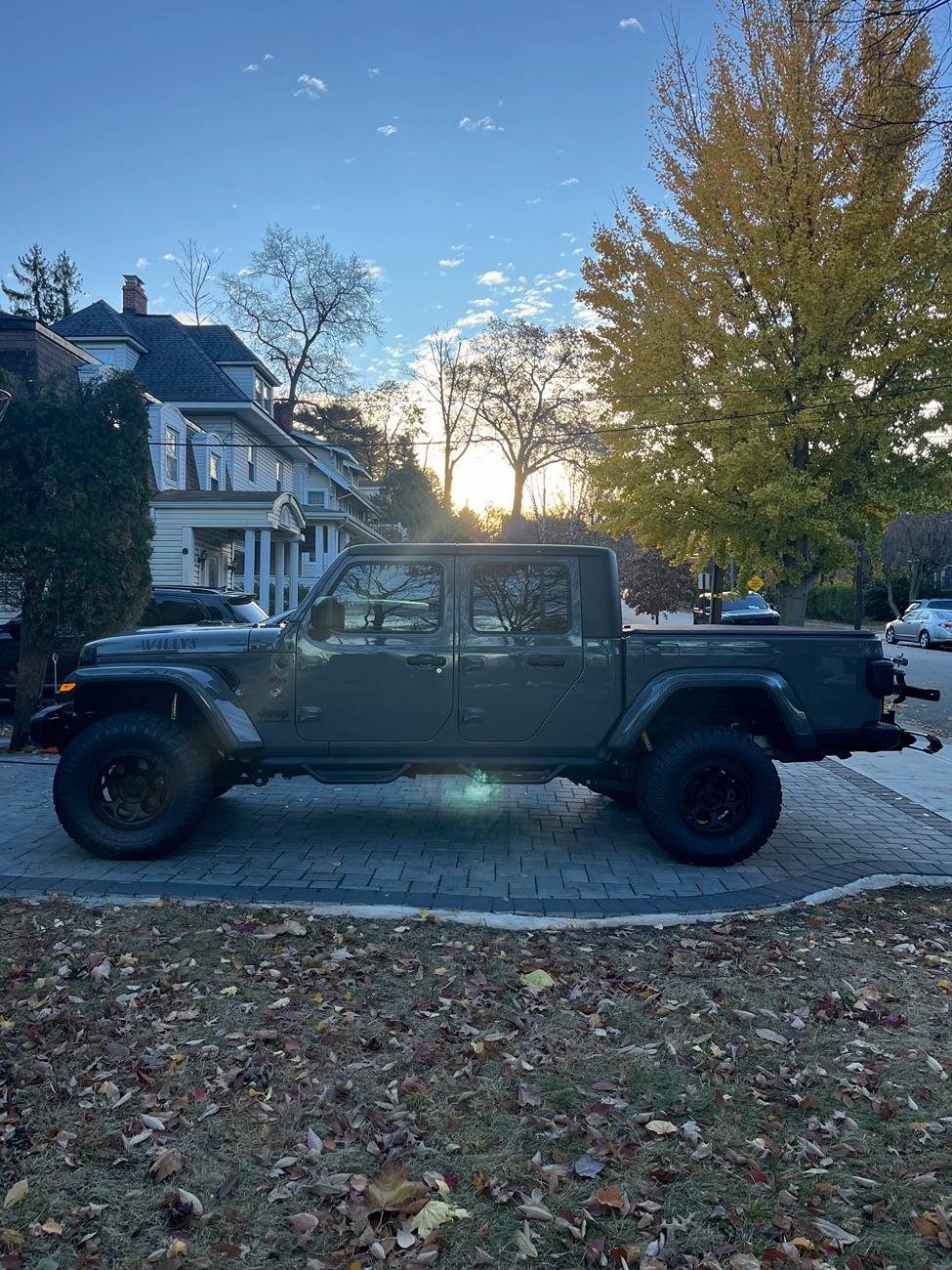

Jeep Gladiator 2-2.5" Spacer Lift - What variables to consider when lifting? IMG_9802

I got the AEV 2.5 lift not the spacer and it drives way better than OEM . So worth it. And is my daily driver as well .

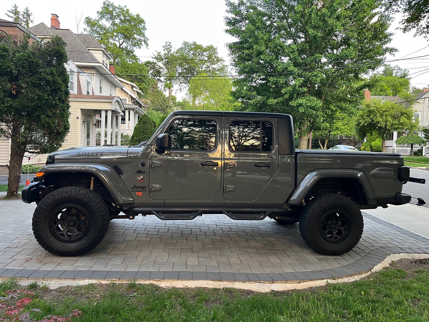

Great looking rig. Are those 35s?

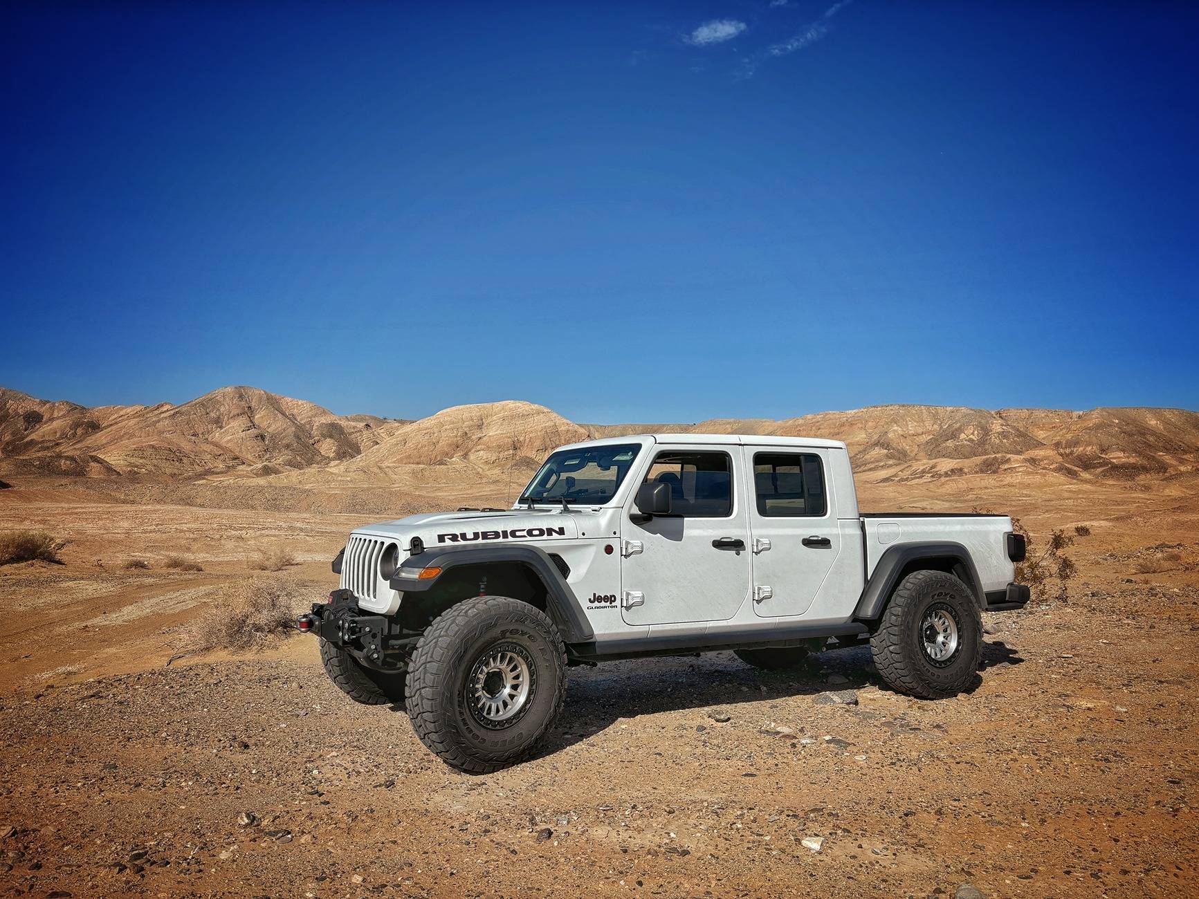

I found an 2" AEV used for $100 and only installed the front to fit 37s and get rid of the rake. I couldn't see spending full price for it. This is my daily driver/weekend warrior until I save enough to get a "real" lift. I'm happy with it until then.

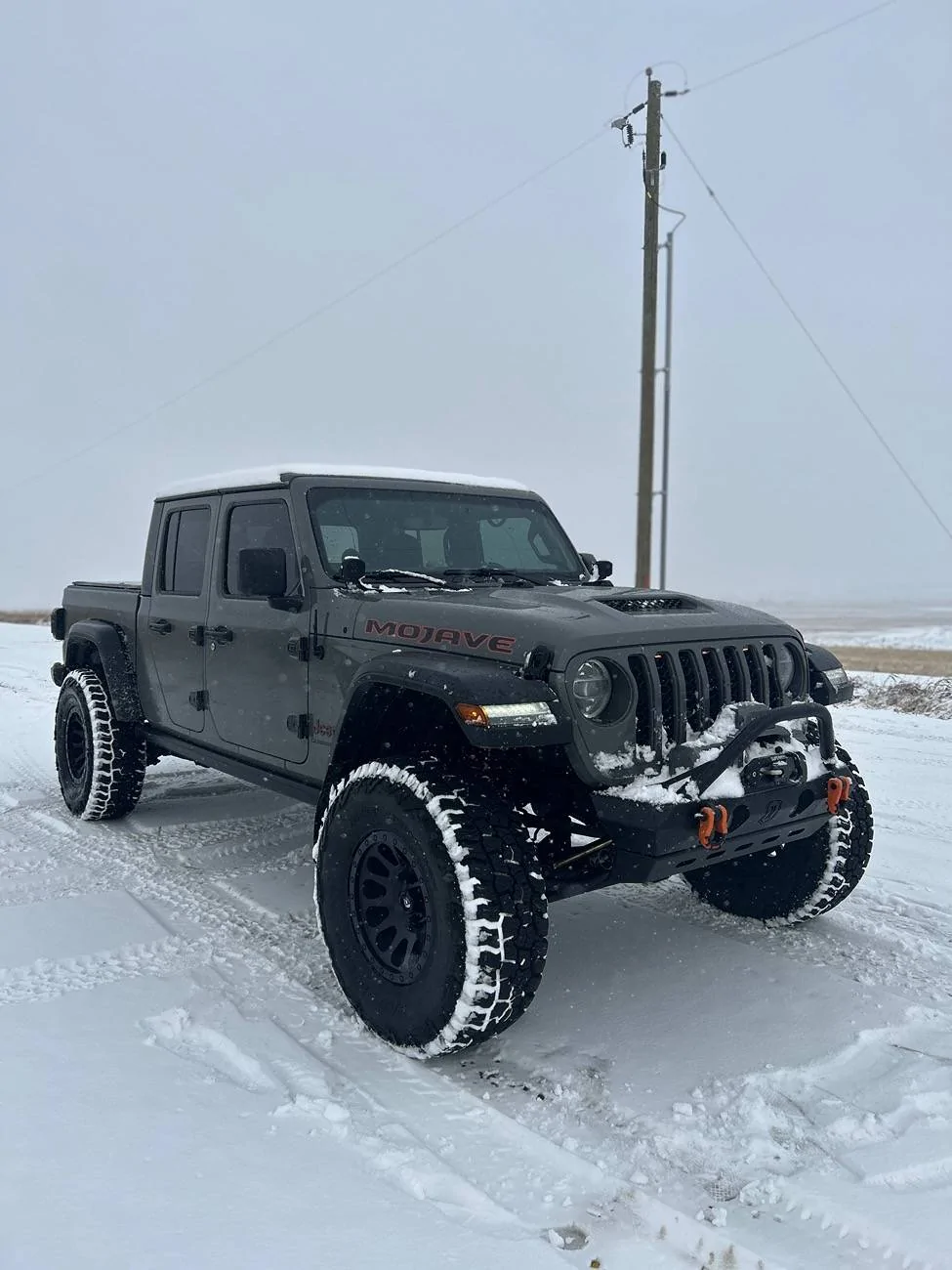

I have the AEV on my Mojave and I found with the weight from the metal bumper and winch I was bump stopping hard or everything. I swapped out the front coil springs for 2.5” Metalcloak and an adjustable Metalcloak track bar, it took the rake away and lifted it an inch. So I have longer shock extensions coming to make up for the height. It rides good and gives it an aggressive look. Just passing this on in case you had to much sage in the front. Cheers
