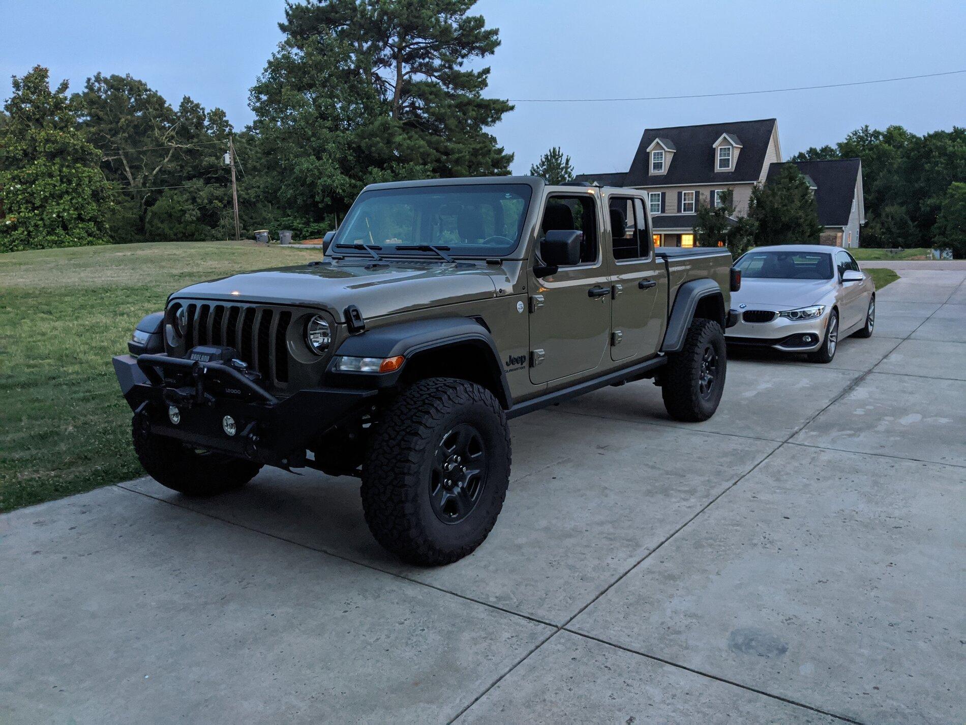

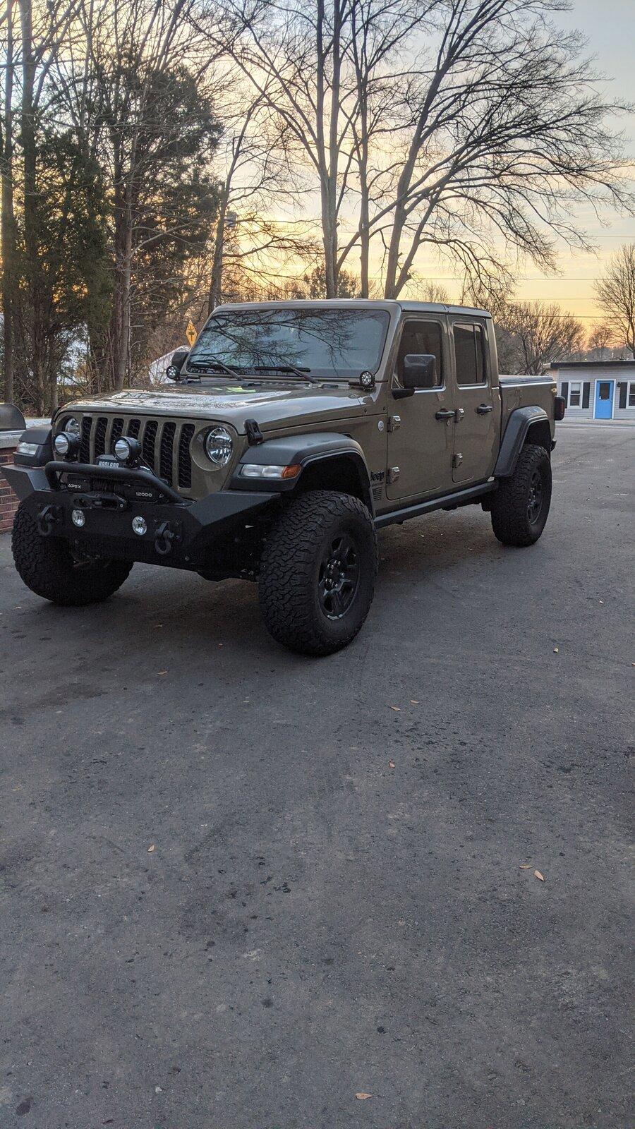

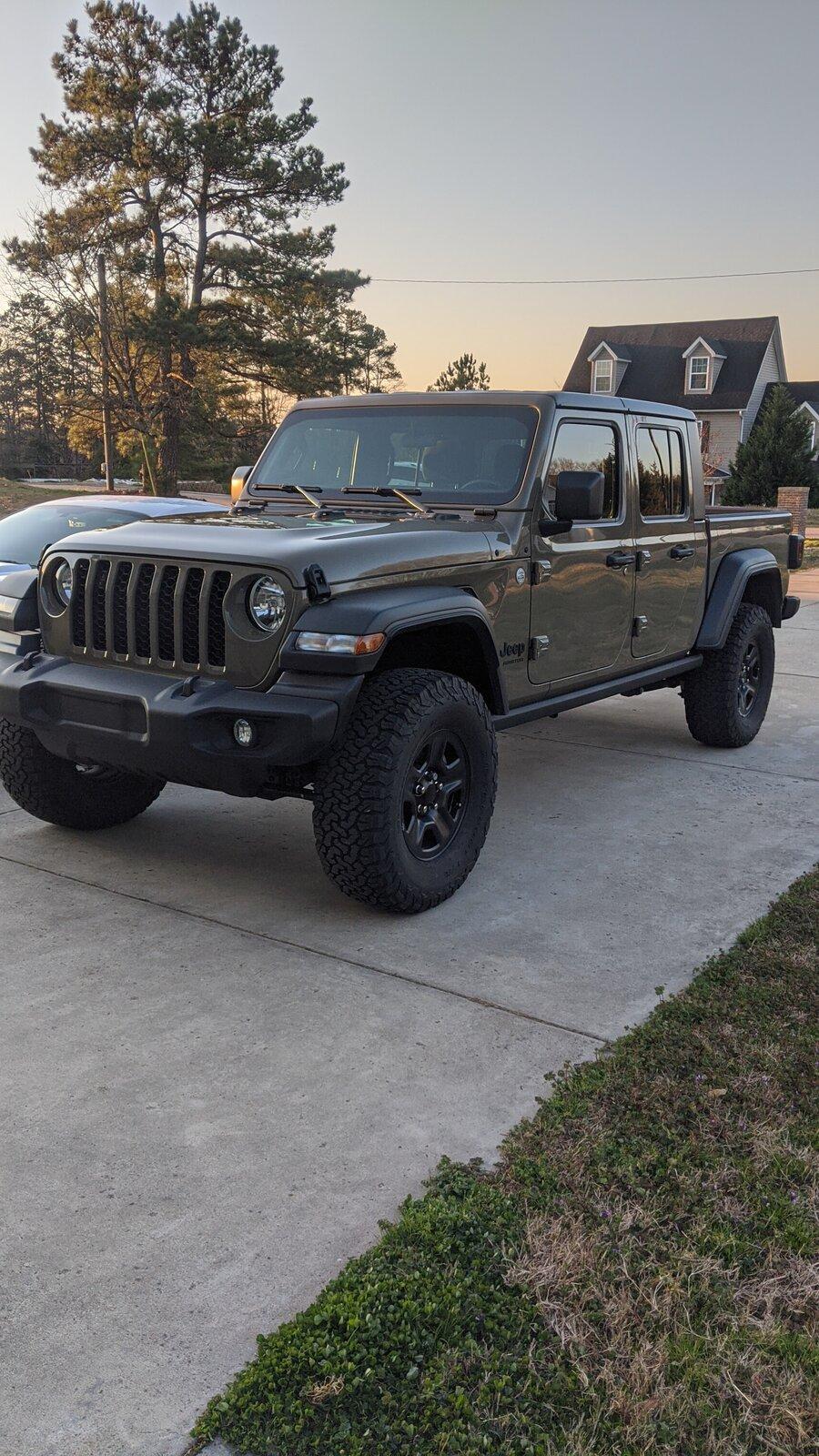

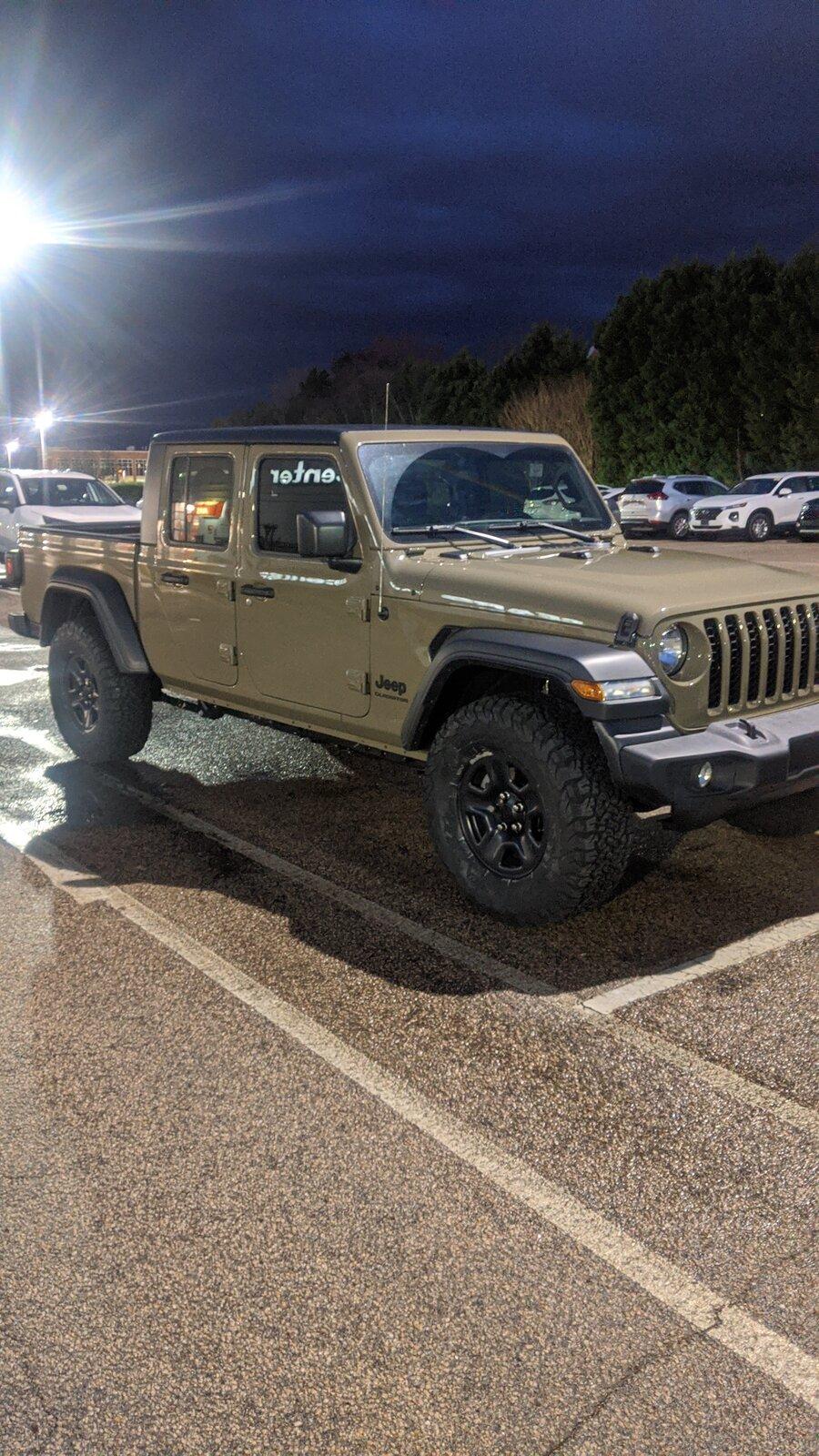

ReadyLift SST 2.5" lift is what I have and I'm running my stock wheels and 315 70 17 BFG KO2S which are pretty much the same size as yours. I ran them without spacers and then added spacers about 2 months later because I want some more poke but it did great without the spacers as well. Here some pictures of it installed without the spacers and with the spacers and without lift and with the lift. For reference I have a Max Tow so I got the same wide track axles you have.
With no lift no wheel spacers and BFG 315 70 17 BFG KO2S
Jeep Gladiator 2.5 lift with stock rubicon rims IMG_20200213_183207
With 2.5" ReadyLift ,BFGs, no wheel spacers
Jeep Gladiator 2.5 lift with stock rubicon rims MVIMG_20200307_071308
With 1.75" wheel spacers, BFGs, 2.5" Readylift
Jeep Gladiator 2.5 lift with stock rubicon rims IMG_20200603_205538
Rubicon suspension Front springs and shocks, 2.5" ReadyLift, 1.75" wheel spacers, BFGs
