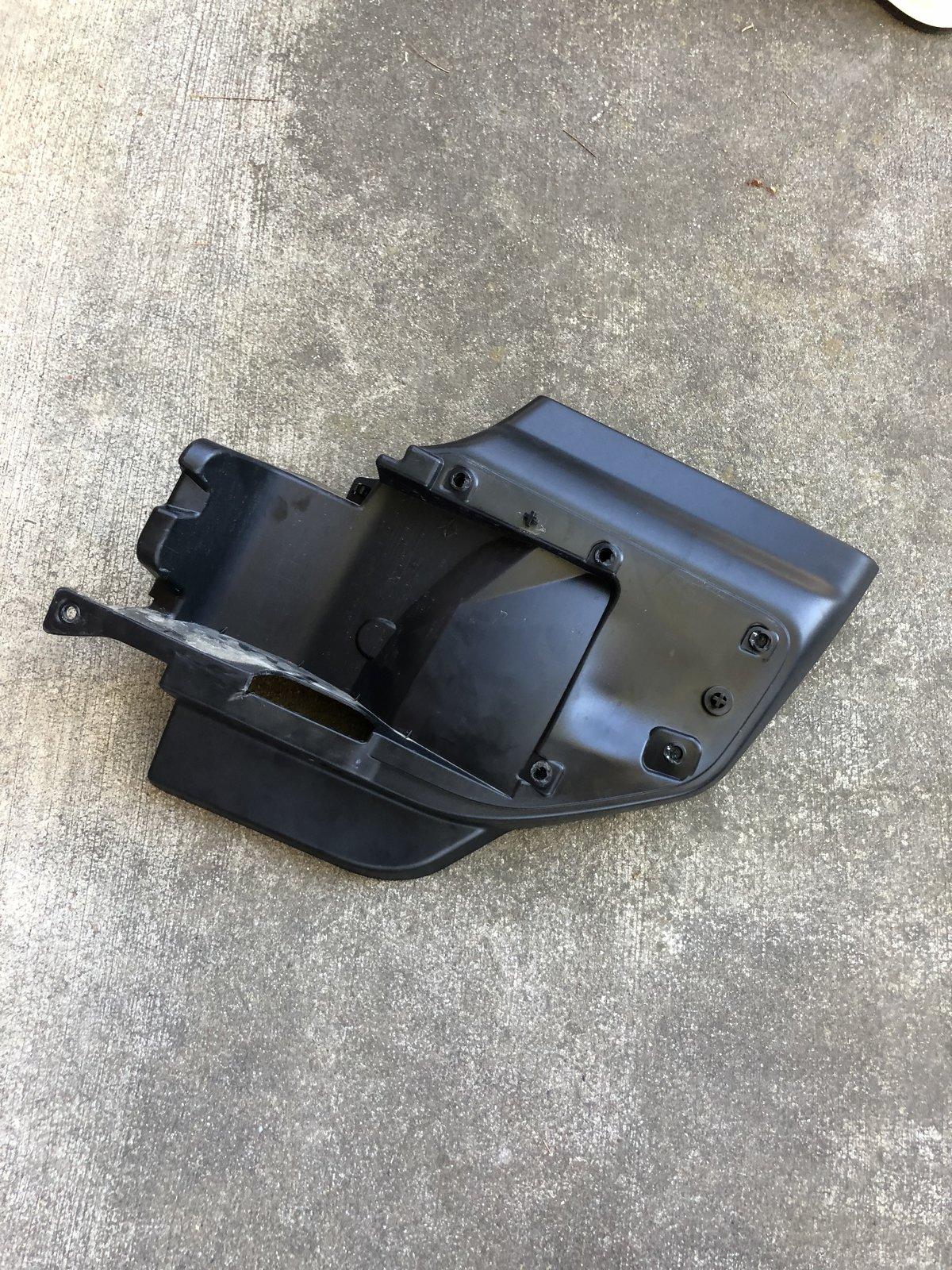

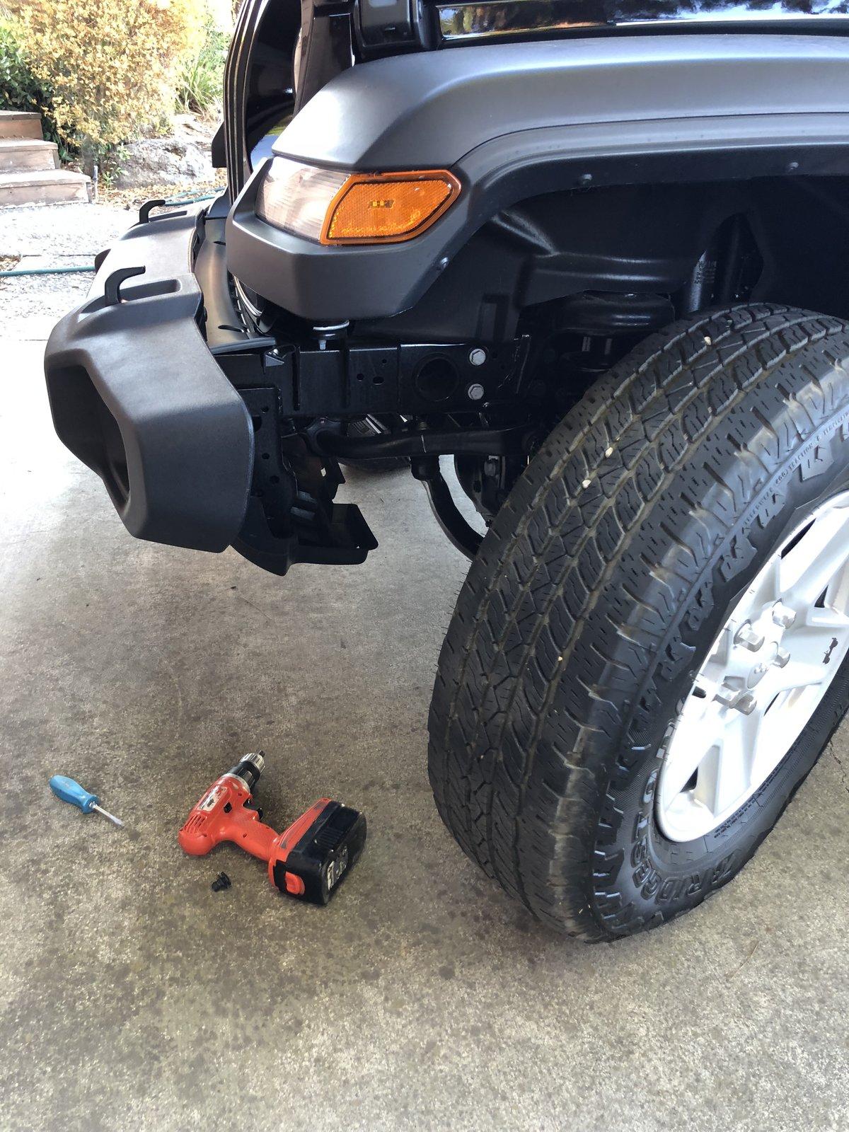

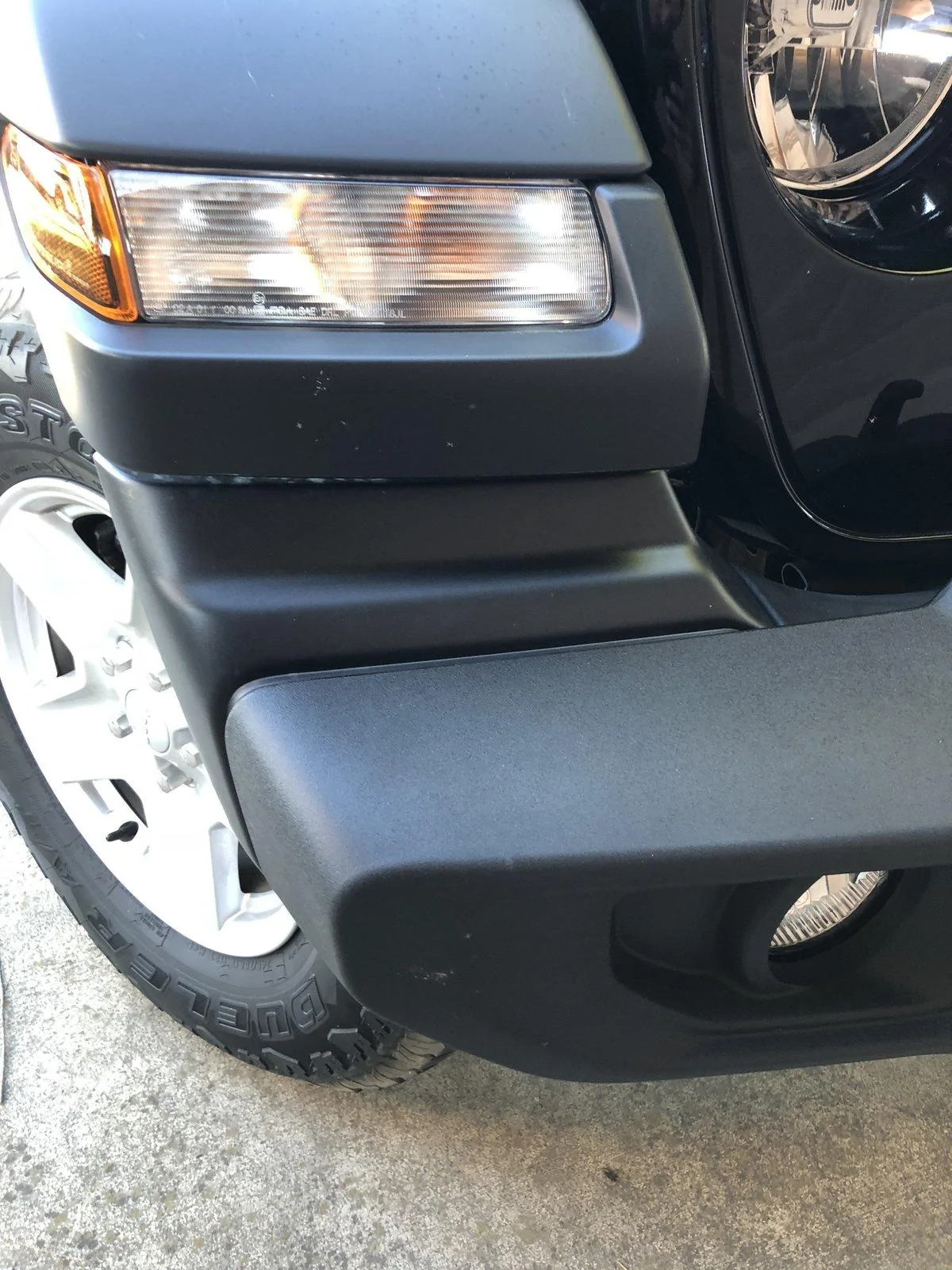

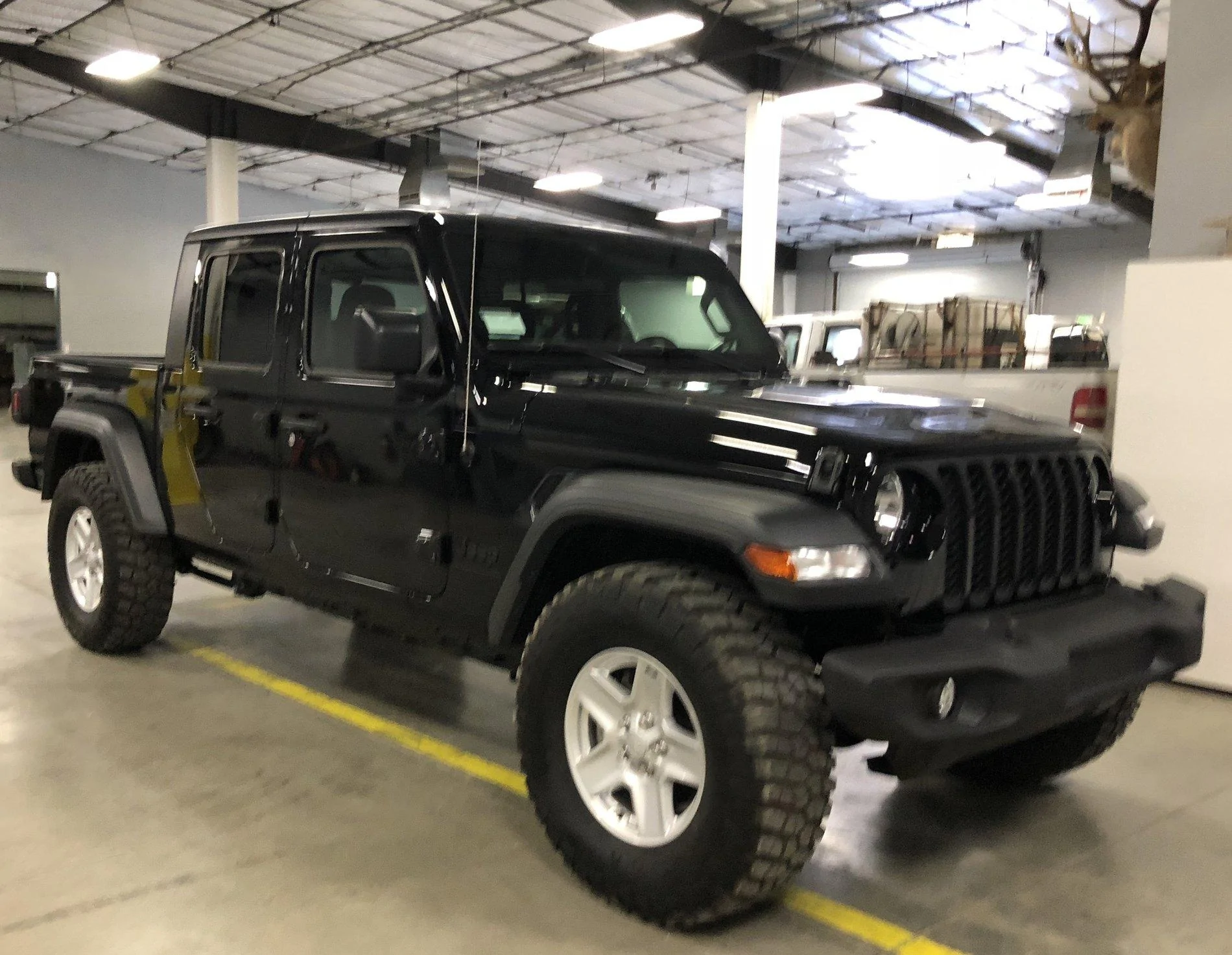

Installed 35x12.50 bfg MTs today on completely Stock Sport with plenty of room to flex and tow. As mentioned you would need to trim or remove the unsightly giant pieces of plastic between the bumper and the fender. Takes only 5 mins with a power driver 7mm socket. Mounted the tires on 17x7.5 wheels. Looks and rides great.

What is the dam purpose of that piece?
It serves two purposes. It aids with aero for fuel efficiency. And it protects the fog light wiring, housing, and bulb from road salt, water, mud, debris, and damage.
The last part is why I refuse to totally remove mine. So I shaved the bottom lip to clear my tires.

Its not causing any issues cramming a 35/12.5 onto the stock 17x7.5 rims!? F me...i hope thats the case. I have a set on some 17x9 rims and dont care for the width
