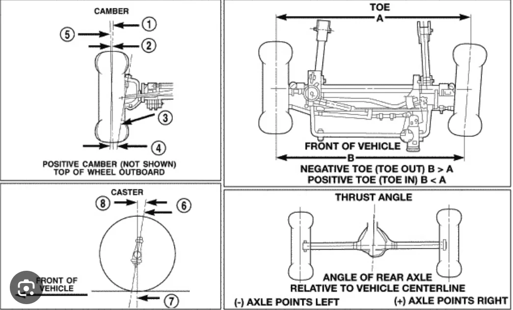

My understanding is camber is not adjustable due to solid axles unless something is bent or lose. Caster can be impacted by lifting the front end, but that would not cause the off-center steering. Most likely you need to recenter your steering wheel by adjusting the drag link. Lifting the front end will cause you to have to do this. Found this on a forum. Seems like toe and caster is what can only be adjusted due to solid axles.
Jeep Gladiator 2023 Gladiator Mojave Camber issue…need advice 1692320877112
If your toe is messed up, that could also cause you to have the issue you are experiencing. But, if all you did was add the spacer, then my money is on the drag link needing to be adjusted.
