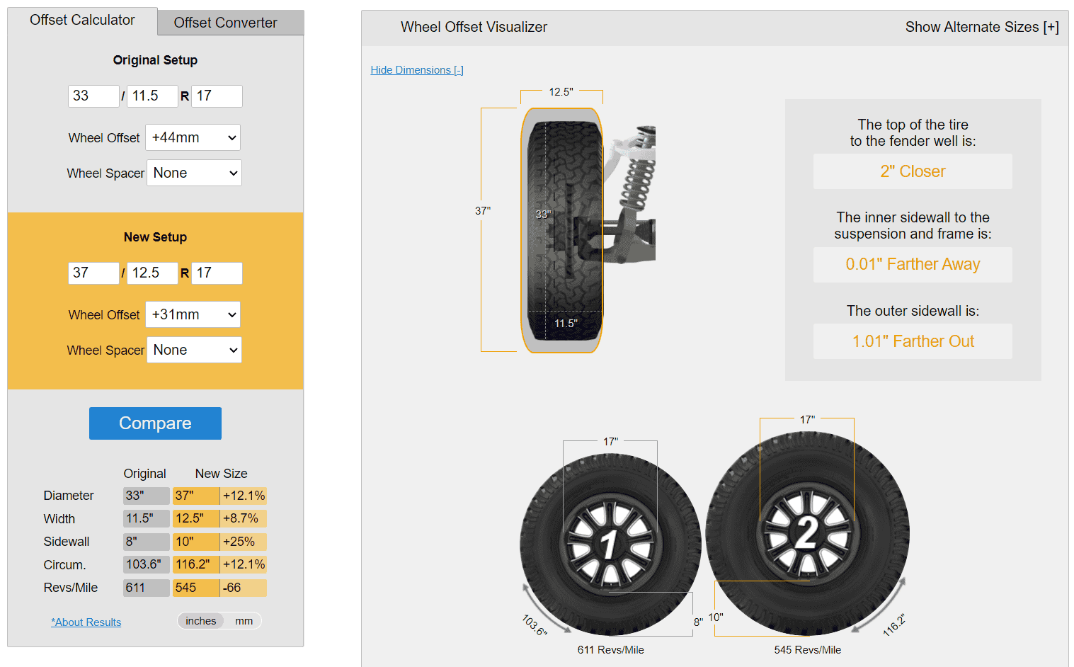

I have the Clayton 2.5 overland + on my 2022 Rubicon. I believe Clayton Offroad recommended 4.75" of back spacing. I went with their recommendation. 8.5" rim 0 offset with 37 x 12.50 x 17 Nitto Ridge Grapplers, absoutley no rubbing even with swaybar disconnected full flex. There is a bit of tire poke but nothing crazy,
Jeep Gladiator 2023 Gladiator Rubicon Lift/Tire/Wheel Question 20231104_133708
