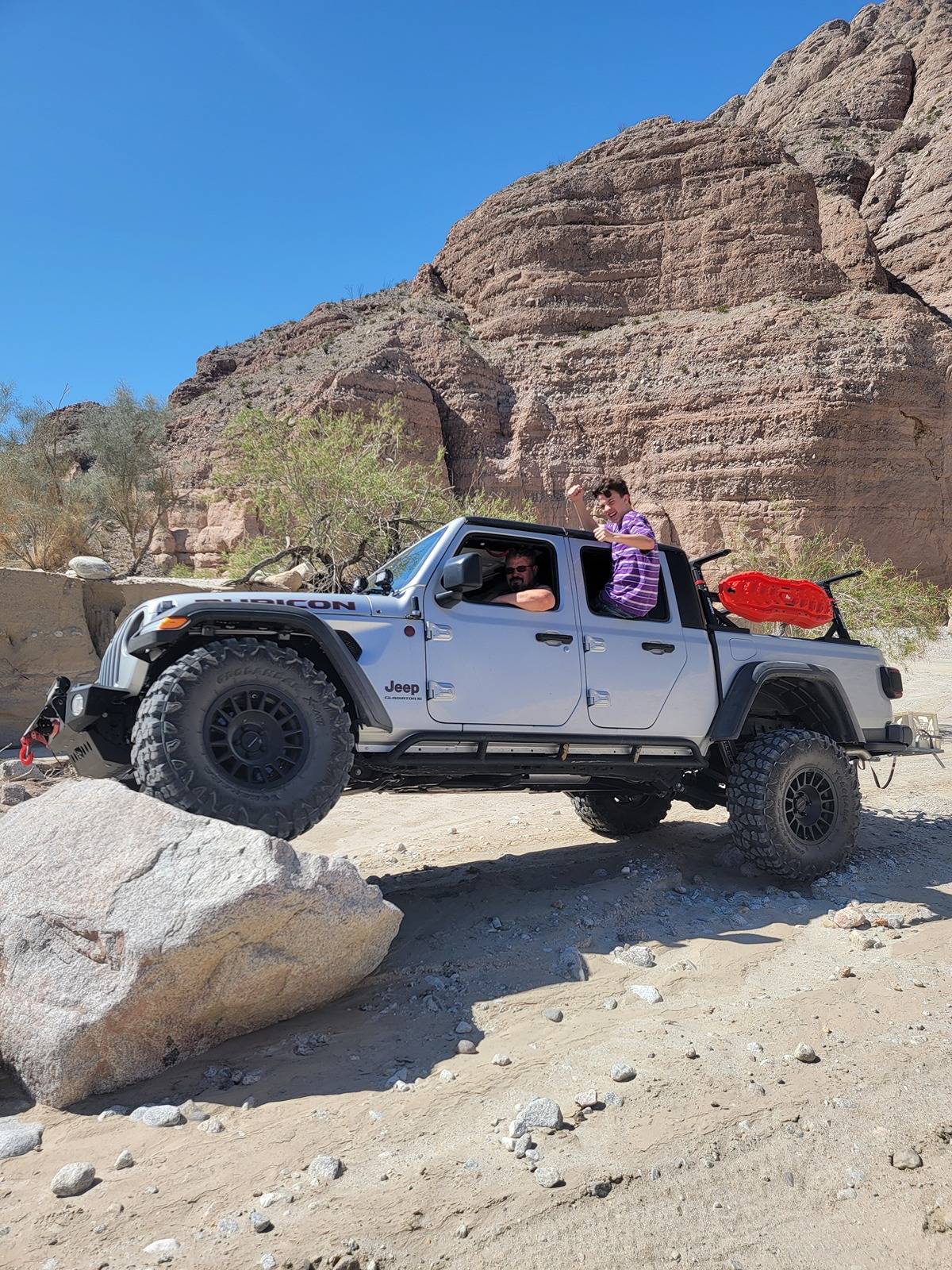

For perspective, here's my 2020 JTR with 37's and a 2.5" lift. Plenty of room to "get some" with 2.5" lift:
Nice pic! I have the same setup and it works great, Moab tested.
